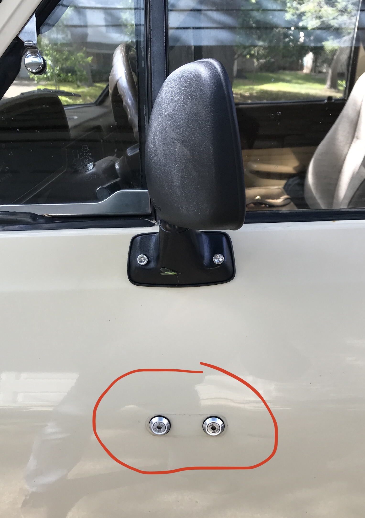

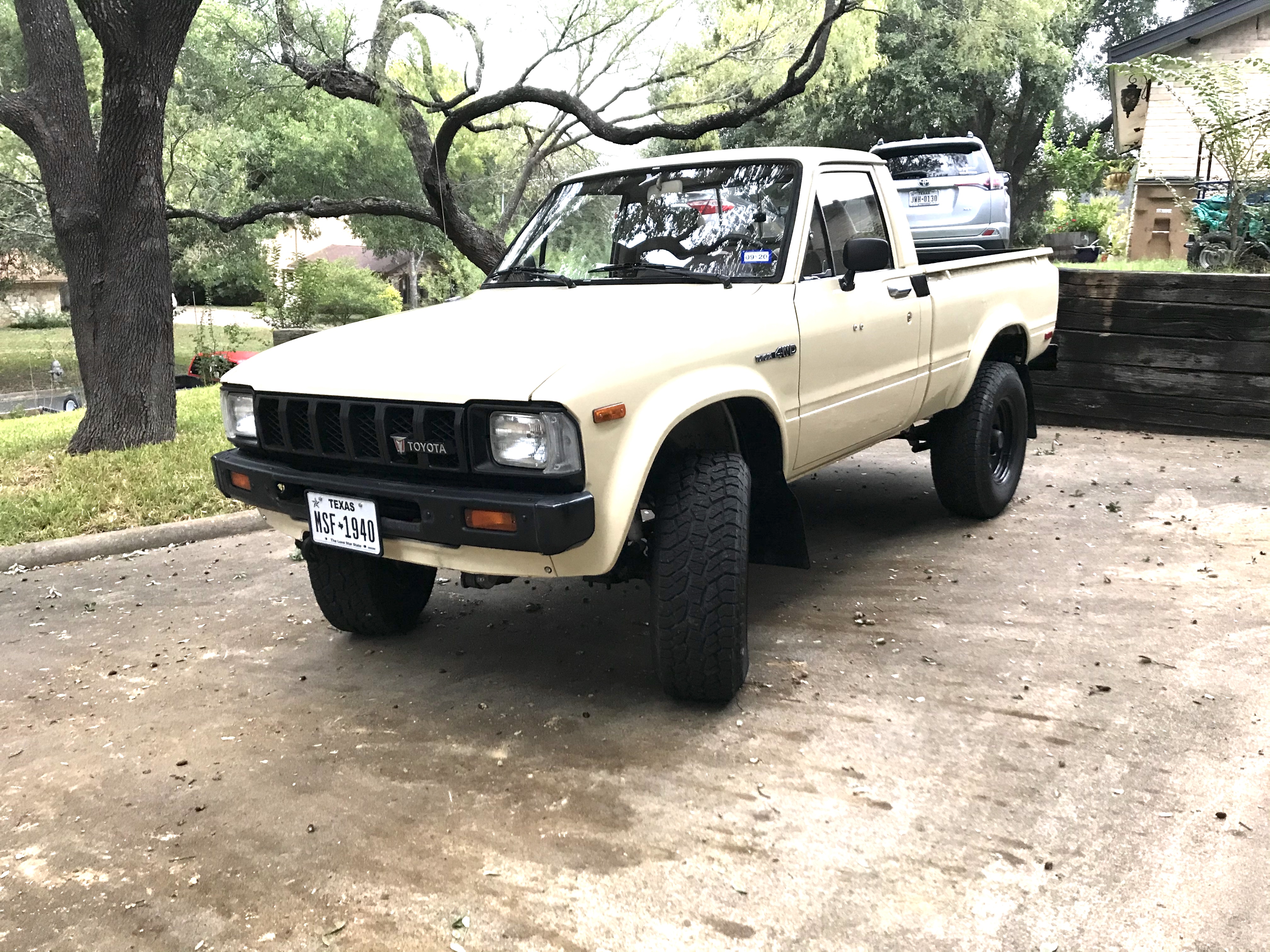

Love those! Where did you pick those up? They look like FJ60 mirrors.
Thanks! I got them off EBay.
Part Number: 1AMRP00219.
I think the previous mirrors were installed at the dealer. They mucked up all the factory weld-nuts and installed SAE hardware (and machine screws). I had to tap the threads M6 to get the new mirrors to work with my SS Metric hardware.
I’m also not crazy about the stainless fender hardware I added to plug the extra holes, but I think it looks better than the exposed riv-nuts in the door skin.
Very nice truck, congratulations! Personally, I like the black wheels. That is what I run on my truck with the FJ40 caps.
I vote no on black. Any one can do black wheels. Appears lazy...unless paired with hubcaps ^
I've been doing the same thing - deciding which color to powder/paint the new FJ40 wheels and hub caps (ordered this week!). My '84 is also Creme (at the body shop right now for body and paint - sticking with O.E. Creme)...
I considered:
- Gray, but decided gray looked better on the primary colors, i.e. blue, red
- Creme - body-matched; still like this... but dropped to 2nd place
- Black - nice, but sort of a strong contrast with the pale Creme
- Antique White. The winner. The white pops just enough - makes the Creme look sort of richer, more saturated. Yeah... probably thought about this a little too much ;)
Similar to this:
I do like gray steel wheels. That's what I have on my 100 Series:
I vote for the silver/gray! I honestly love when they're painted the same color as the truck. I think it looks rad on the steelies. But definitely go with the steelies, and the SR5 stripes. My pickup still has it's on the fenders/cab. Literally my favorite thing about the truck.
Do your wheels in the same brown metallic as the stripe.....would look really cool. The brown would look great with the creme color of the body. You could match the vinyl to the powder coat or the powder coat to the vinyl to get it really close. Have the stripes custom made out of the vinyl colors you want....would look really cool on that rig....it's gorgeous!
I ran 40 Series on my 86 and now my 89 Runner...but would vote white or creme OE steelies (no clips or caps) on your particular truck.
I’m still vacillating on the color. Powder coated says it’s $550 to change to silver. I kinda like black too. And the new OEM wheels are already black, so I could just mount the tires and go!
It had Ultra Mirrors fitted. Either at the port or by a dealer. Those were more common than the small plastic mirrors and SAE bolts were indeed run into the original threaded holes.

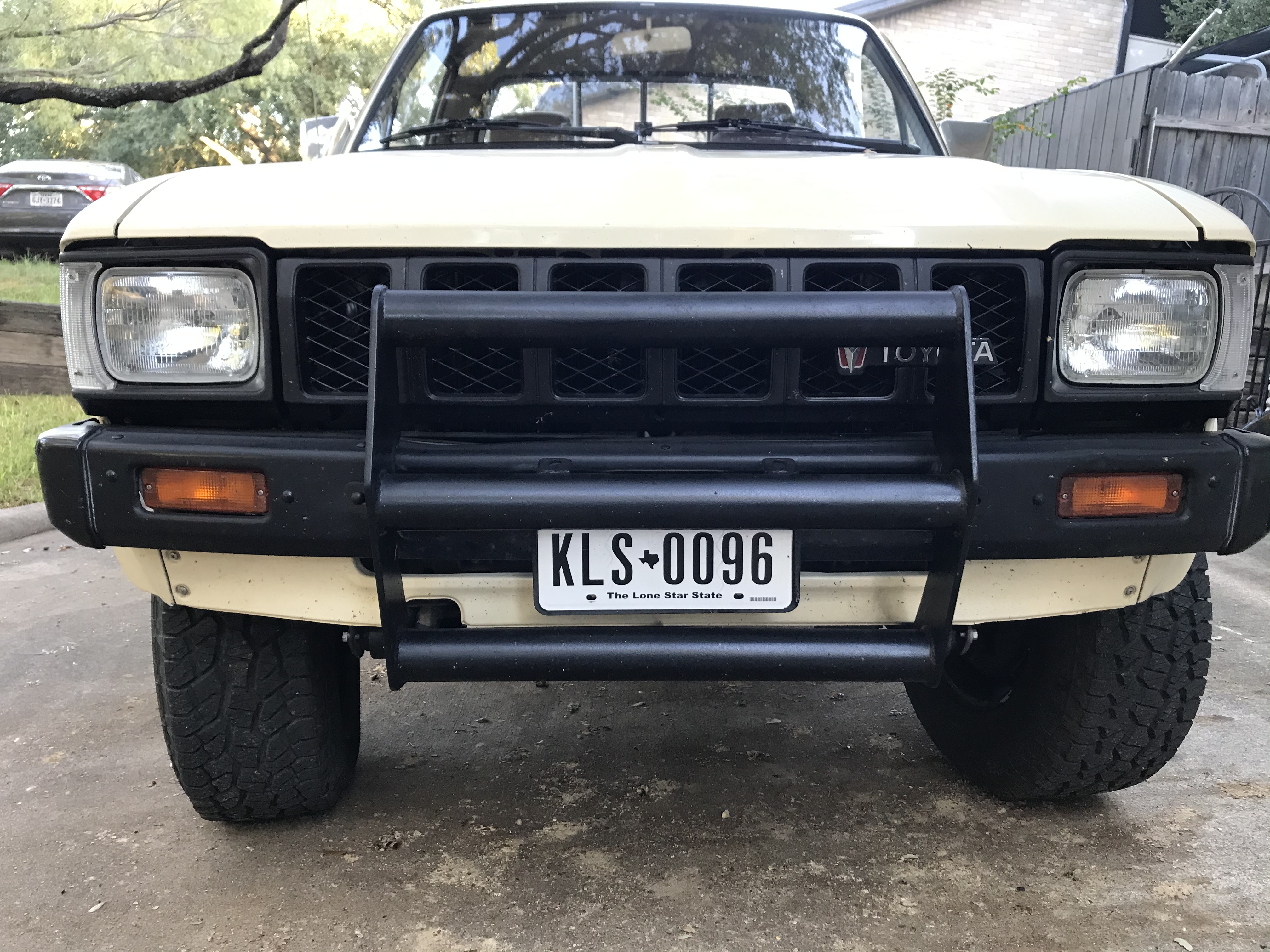

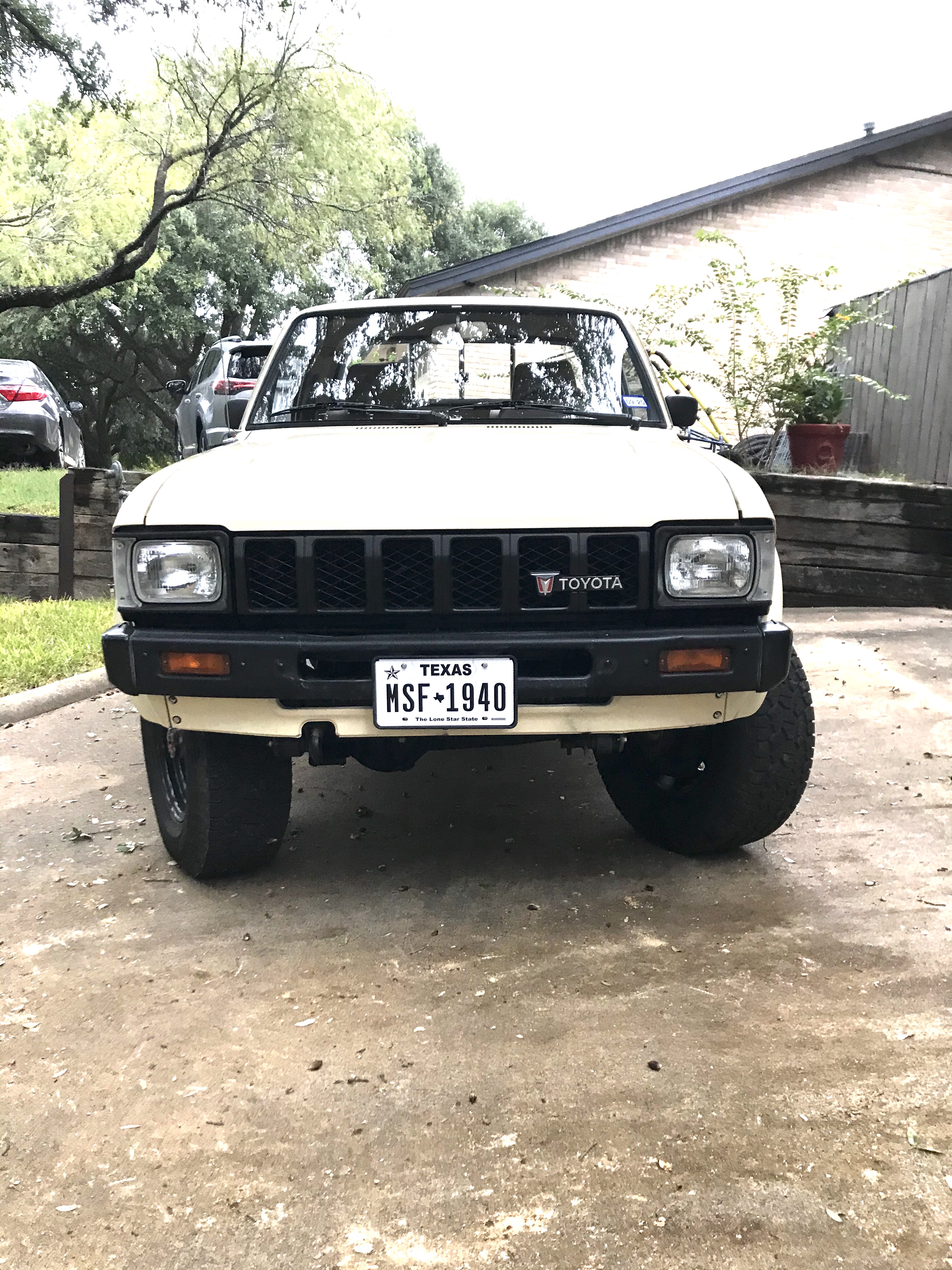

I pulled the silly front bumper off over the weekend.
Up next - 33" BFG Mud Terrains on stock steelies, round headlight conversion, repair/replace terrible roll-on bedliner, install SR5 graphics.

I’m confused by the talk of removing “the silly little bumper”? All I’ve seen in your pics is the OEM bumper, no?

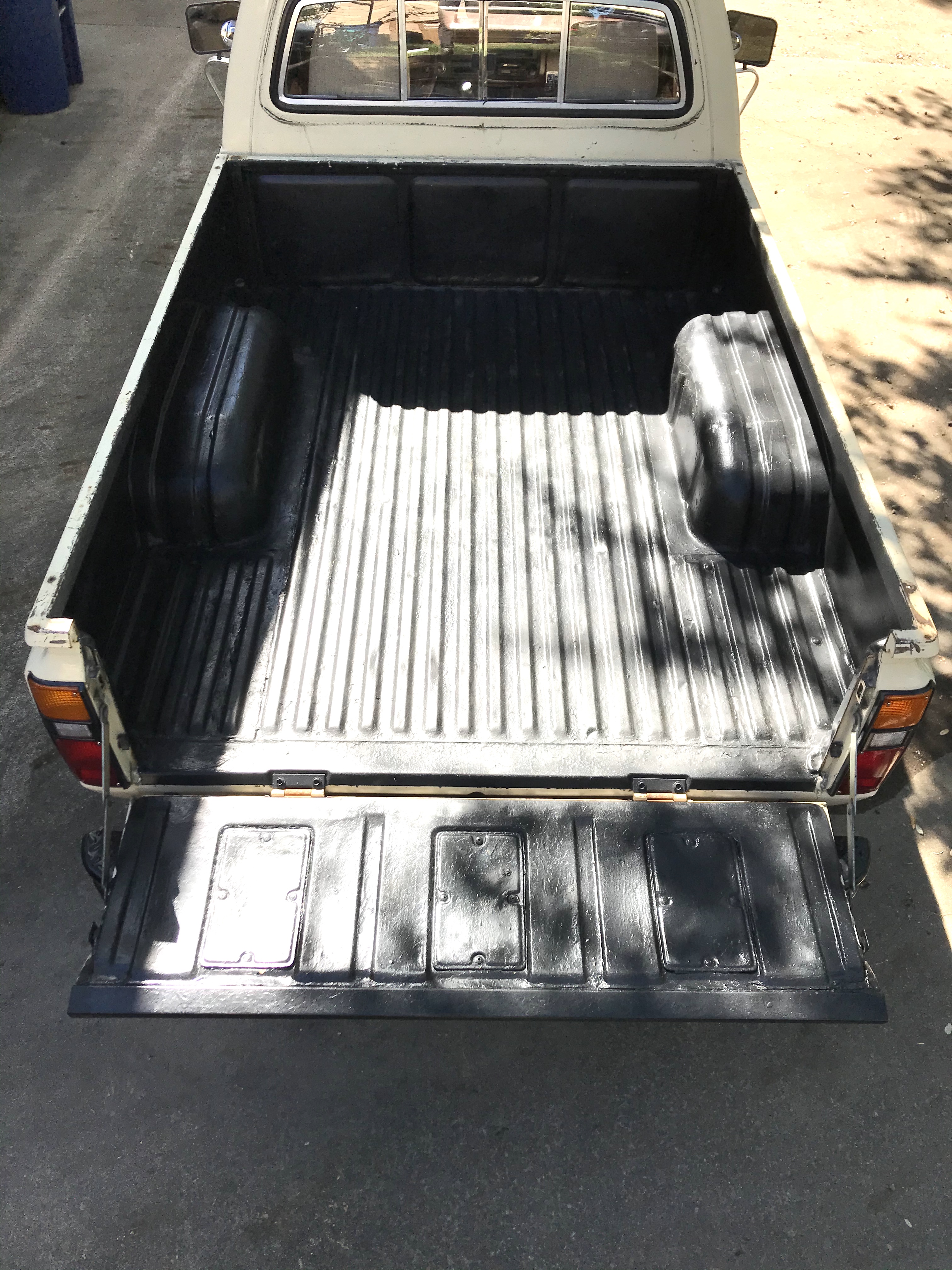

What did they coat in bedliner? That crap is made for lining beds. Period.

The truck originally came with a brush guard that attached to the factory bumper and the front spring hangers. I removed it. Here is a before and after.
On the mirrors, I hear you about the bolts. I'm not crazy about it either, but I absolutely loathe the Ultra Mirrors. They seem really out of place on such a small truck. Like they should go on a 1980s Dodge diesel. Not a Toyota Pickup. I still have the Ultra Mirrors in case I want to go back. But for now, the current small mirrors w/ bolts are staying on.

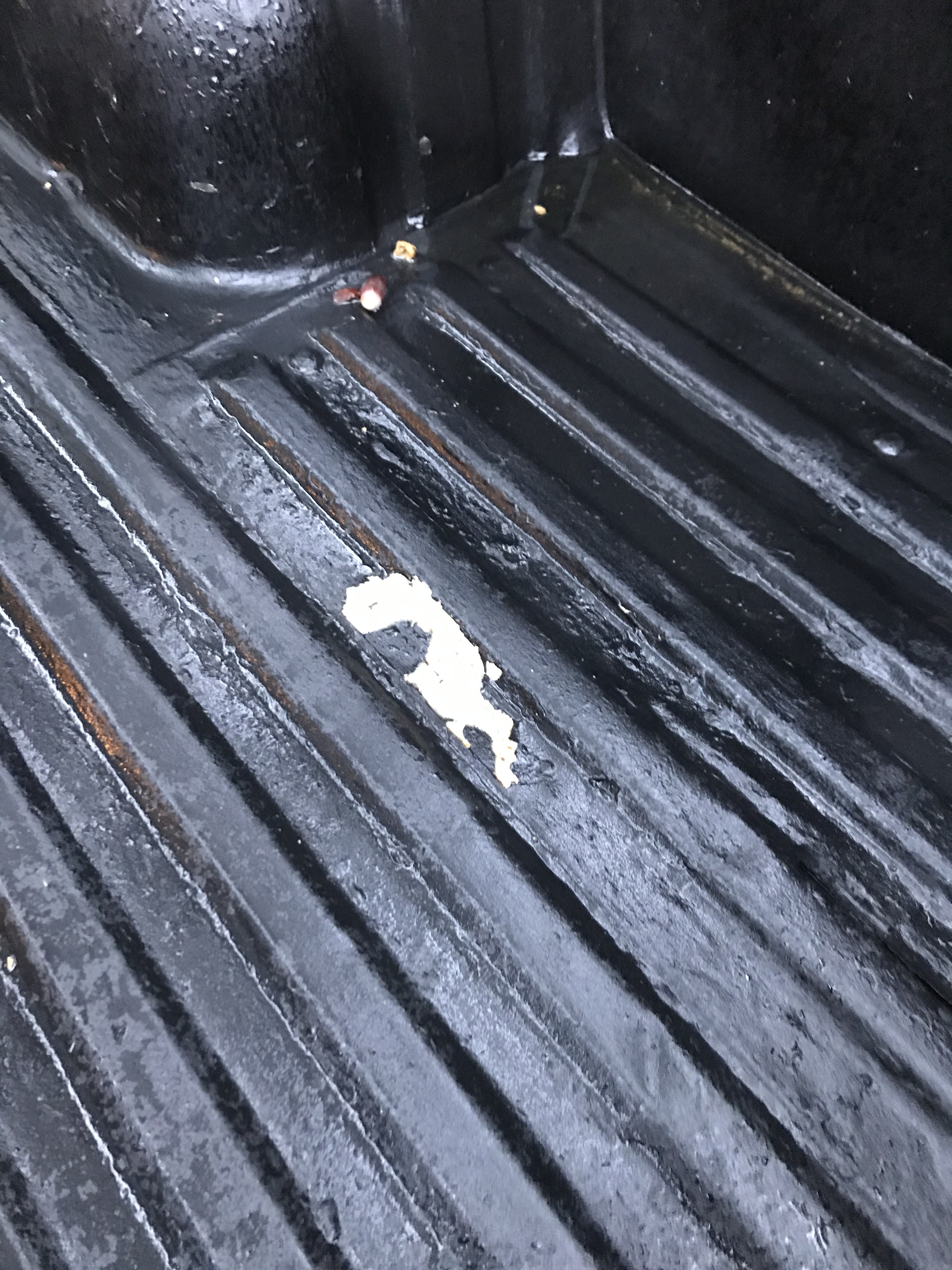

The bedliner is limited to the truck bed, but it was just poorly applied. I think it was one of the early DIY kits, and it is flaking off. I don't think it was prepped properly.
I am going to have the old bedliner sandblasted off, then primer, and a new high-quality bedliner reapplied. I will probably continue the black theme on the bedliner color. The Line-X provider can pull the original 557 Creme paint color, but I'm afraid it won't quite match the 37 year old paint on the rest of the truck. If it's not going to match, I'd prefer to just stick with black. I'm also going over the bedrails, so I think it would look odd with two different textures and slightly mismatched color. Quality black bedliner over the rails looks pretty sharp on the Marline Crawler truck, so I'm going to try it on mine.

I had hoped my “hope I don’t come across as” preface would clear up that I was only offering MY thoughts. I agree the bush bar needed to go. If you do the round lights with the proper grill etc, then that’s great. I would keep all the original parts too. Someday you or the next owner may want them. I also agree the black wheels would look best with your color, I just (as I asked) thought you wanted to put it back to original. The fact that they are already black would have me running them that way too.
And it’s nice to see bedliner in an actual bed. The trend to cover entire vehicles with it is alarming to me. Especially anything that is actually worth keeping for any use other than firewood or rock crawling. And frankly, on either of those uses, why waste your time and money?

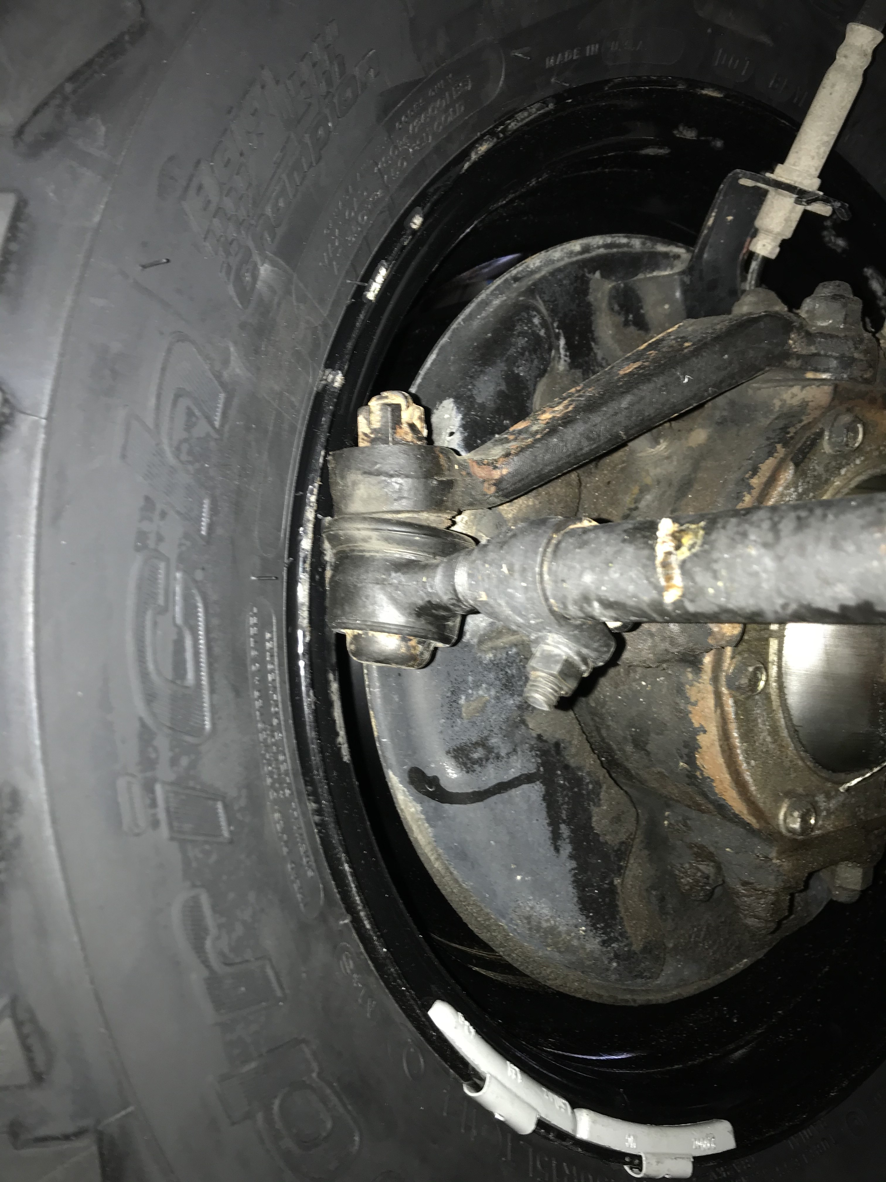

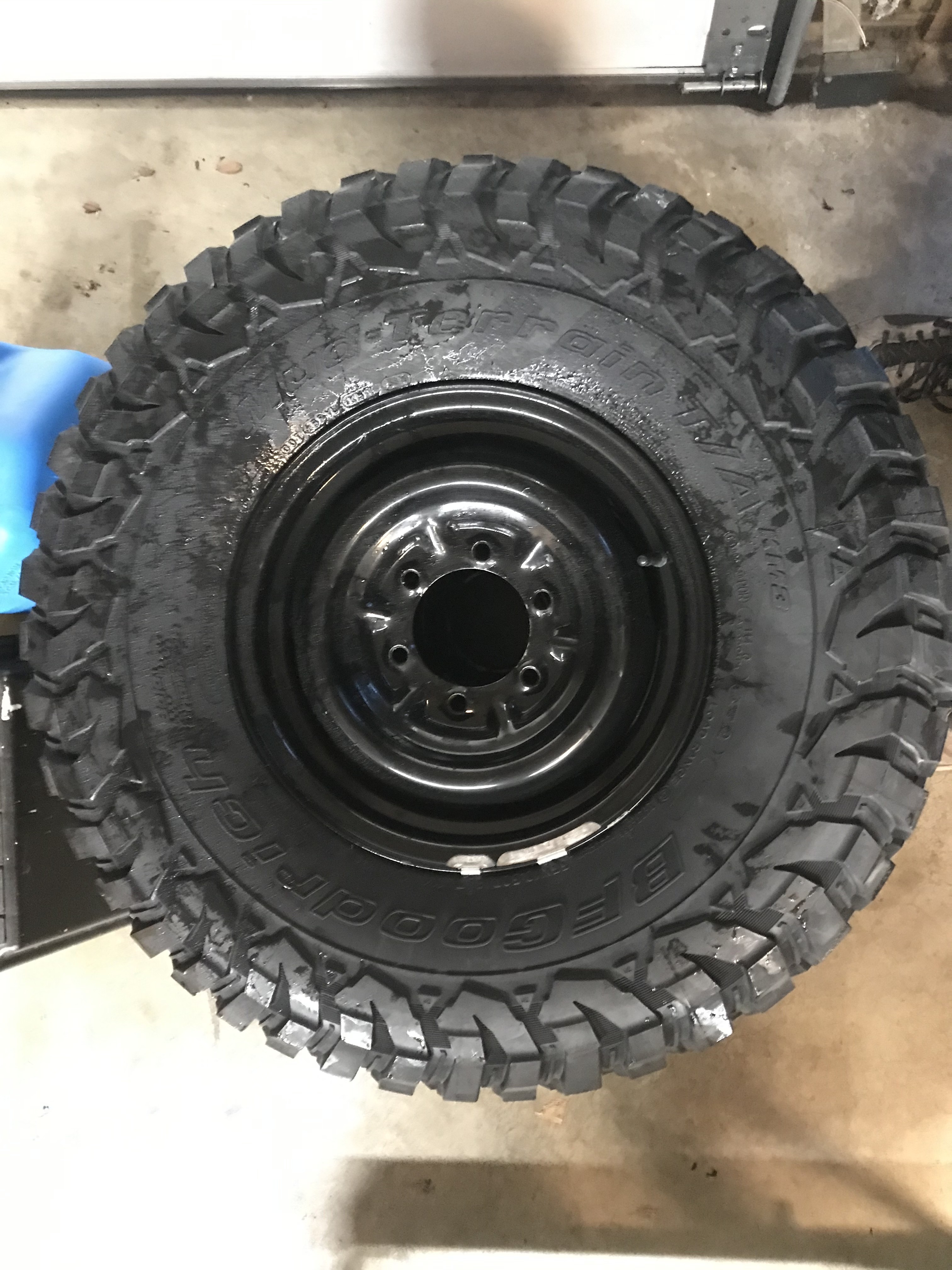

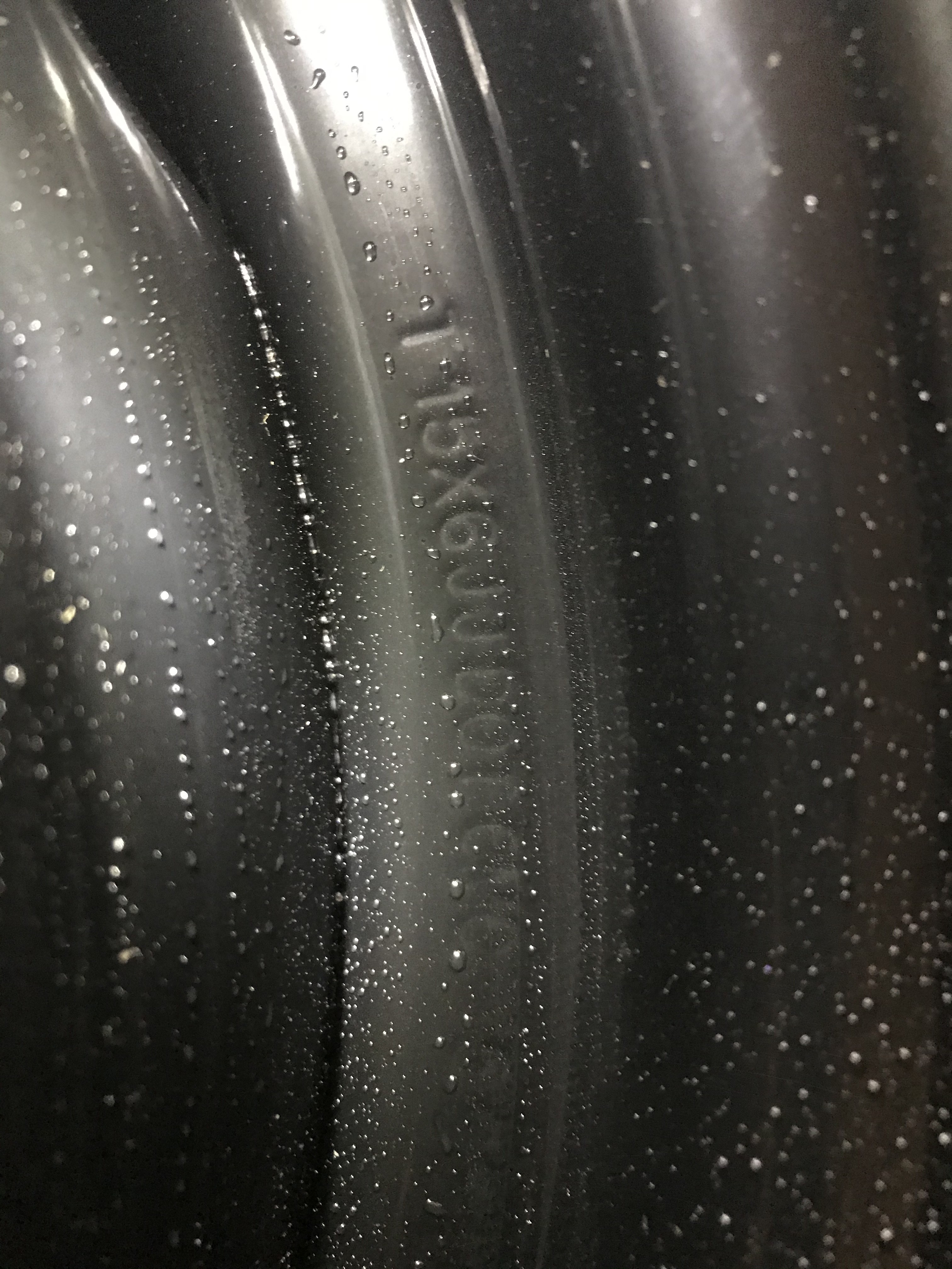

Well, bad news - I purchased a set of Toyota steel wheels that I assumed were identical to the wheels that came on the truck (and the spare under the bed). Unfortunately they do not fit. The wheels are too wide and the backspacing is incorrect.
OEM steel wheels on the Hilux are 15" x 5.5" with 3.75" backspacing (Toyota PN: 42601-60082).
The wheels I purchased are 15" x 6" with (???) backspacing and are actually designed for 1985 - 1989 Pickups and 4Runners (Toyota PN: 42601-35390-05).
The wheels fit in the back, but contact the tie rod in the front.
I'm going to keep researching and see if I can find refurbished OEM Toyota wheels for 1979 - 1983 Truck.
Edit: So it looks after a bit of researching, the wheels I need are Toyota PN 42601-60082. These are essentially Land Cruiser wheels without the tabs for the hubcaps. They are also NLA.
