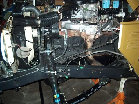

This is a 40 that I purchased last January that needed a little freshening up. After digging thru it a little bit, I was presently suprised of how little rust was present on the body and frame. I had a carb desmogged by Jim C and are currently running a vacuum retard distributer. I ended up with one vacuum line from the manifold to the choke breaker. All other lines and coolers are now gone. Attached are some pics of the freshen up. My plans are a body off down the road, but for now I wanted to stop some of the oil leaks and replace the suspension. I am doing this in such a way that I will be able to roll the front and rear axles to the side when the time comes to do the frame and body.

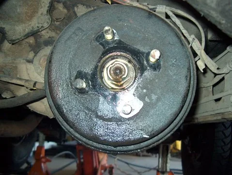

One of the first leaks was the tail of the xfer case that I Speedi-sleaved and used a Mudrack double seal speedo housing.
Before
New shoes
Assembled and restaked

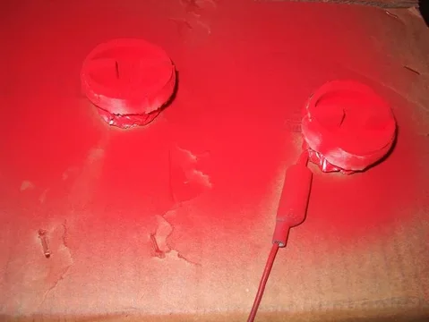

I purchased the 40 with Warn hubs and happen to find a set of Asco's. I dissassembled the hubs and had the bodies electroless plated, studs were black chromate and nuts yellow plated. I also powder coated the hub faces.
Dissassembled hubs
Powder coating selectors
Finished pic

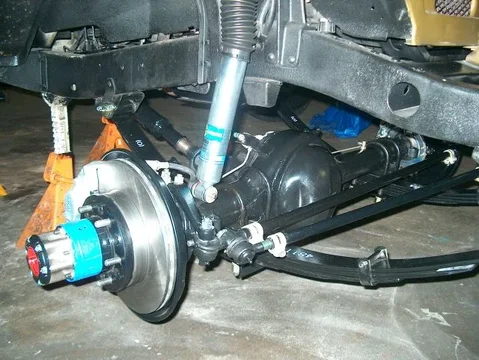

After installing Downey 4" lift with 1-1/2" front and 2-1/2" rear shackles. I ended up installing some bolt up steel shims along with Bilstiens.
Front suspention
Rear suspension

Yes, all the individual modifications made a world of difference. The steering is probably the most pronounced as far as getting rid of all the slop out of the linkage:steer:. It does get a little getting use to after having 32 year old manual steering. Its also nice to not have to monkey with the accelerator pump in order to start it:wrench::wrench::wrench:. Jim C desmogged carb ran great right out of the box. It's also nice not mopping up the garage floor from timing cover, oil pan, xfer case, steering box, steering knuckle leaks ect...ect...ect.......

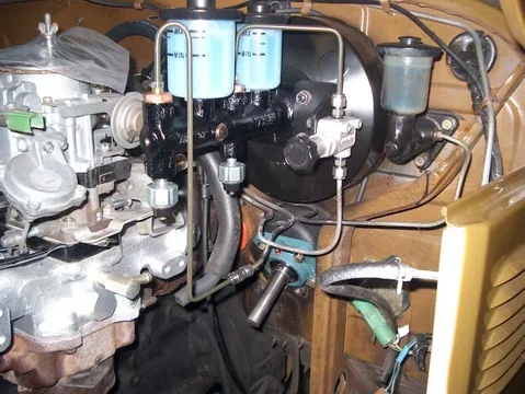

Proportioning valve and brake line reroutes.

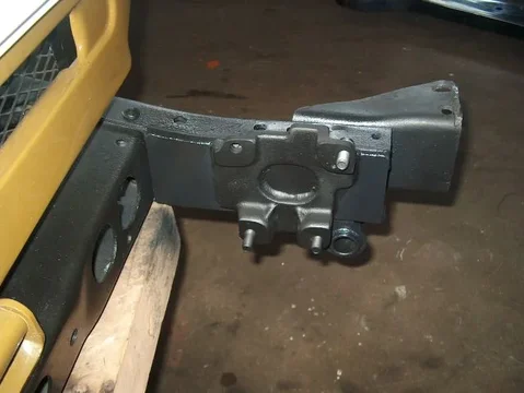

This is a pic of the front axle spring perch. I didn't notice this butchery until I got it back from the hot tank and didn't know if the shims would sit properly. I found a cheap front axle here on the east coast but with all the road salt it couldn't compare with the condition of the axle from out west. as you can see in the up coming pics, there is not even pitting on this axle.

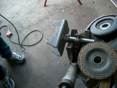

Removed the old perch with a 4-1/2" hand grinder and cut off wheel
Had my sheetmetal vender bend up a one foot long channel, cut and drilled it to match the old perch.
The hardest part was jigging up the perch on the axle to make sure it was square and level
