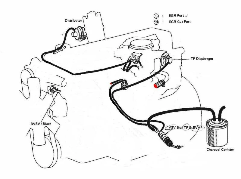

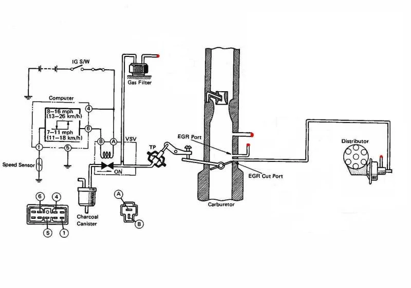

Now the challenge. While the vehicle is in motion, I'm not reading any vacuum when reaching the speed thresholds that should activate the VSV. I put the original controller back in, but same result. With the controller harness unplugged from the controller, the engine cranks and stops correctly with no apparent difference. The vacuum routing is exactly as listed in that great diagram from Subzali several years ago. Currently there is no TP unit, so that outlet is capped on the VSV. Are there any solutions out there I'm overlooking? I'd like to have the EVAP system fully functional, but wondering if it is possible.
The VSV can get stuck, will it pass air when energized? Make sure the harness between the VSV and emission computer is in tact. Those pretty restored emission computers are probably not functionally checked. I can do that for you, and repair if necessary.

I would unplug the emission computer and the vsv, check for continuity from pin 4 and 6 in the emission computer connector, should be open circuit. Then jumper the two pins at the VSV and check for continuity again at pins 4 and 6, should be 0 ohm or close to it. If its still open circuit, that might explain some of what you are seeing.

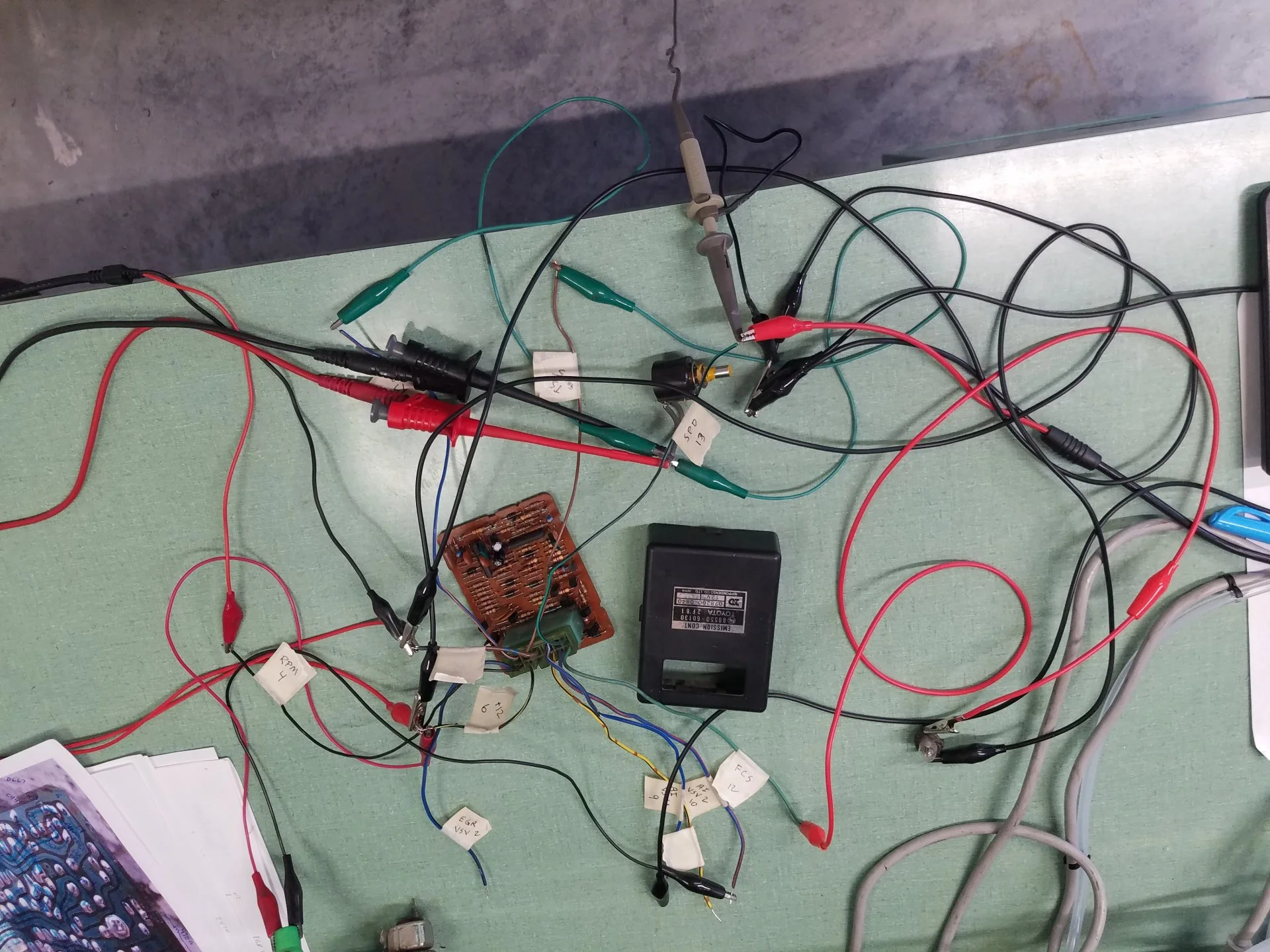

As far as the speed sensor (VSS) you will see some voltage at pin 1 of the emissions computer when the VSS is open, and 0V when it is closed. It is a square wave. I worked out the exact wave form frequency, amplitude and offset to mimic the VSS input to the computer. This is hard to test with the truck not moving.

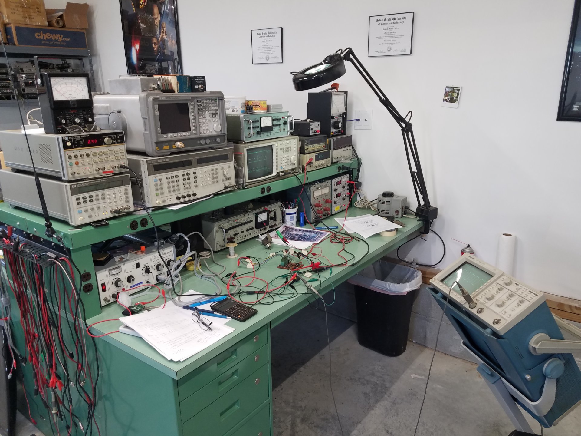

I just set up two function generators to mimic the rpm and vss inputs.
Send me a PM if you want me to check those modules out.

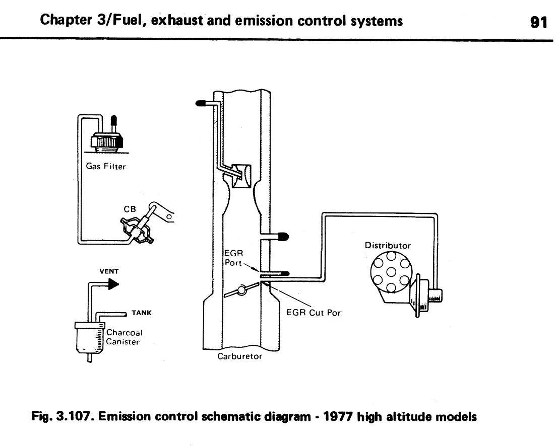

Just for those special occasions you may have the 'High Altitude' version and you want to desmog, here's the Jim C's diagram:
