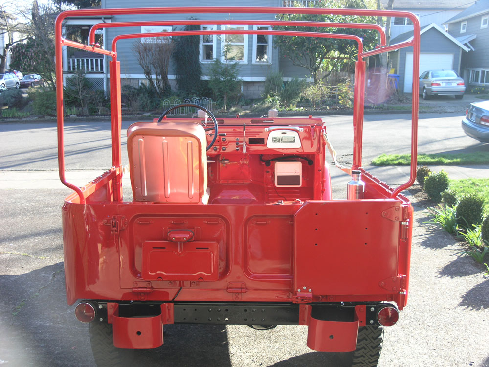

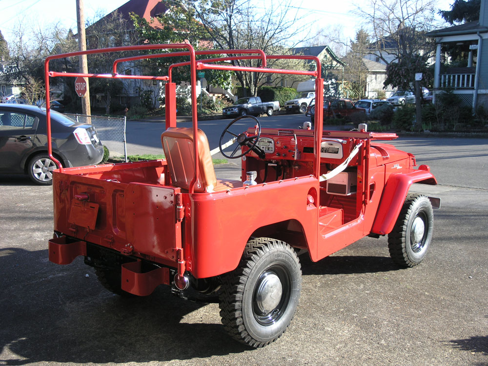

No holes for the center heater. No vent on the passenger's side of the cowl. The fire wall does not have the bolt holes or the cut for the blower.
I wonder why the heaters were always installed over the passenger's feet instead of the center. The only reason I can think of is fresh air off the side vent for defrost. Anybody seen a operation manual for the dealer installed heater.
Pictures added
The fuse block is moved to the driver's side even though it did not have the OEM heater installed.
John, I think they mounted the dealer installed heaters on the passenger side because a. Without the seperate duct work to bring air from an external fan, they didn't need the space, and b. the non-heater models mounted the fuse box in the center of the firewall, and it was less work to install the heater elsewhere than move the fuse panel.;)
