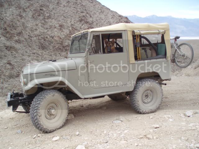

I had the same PO/Best top problem, I welded all holes shut and when I receved the top from Eshan I re-drilled the new holes after paint :crybaby: and used touch up paint to seal the steel to help with the rust.
the two atop the windschild are OEM pan head screws with acorn nuts.

btw Dusty, your rig looks baddass :D
