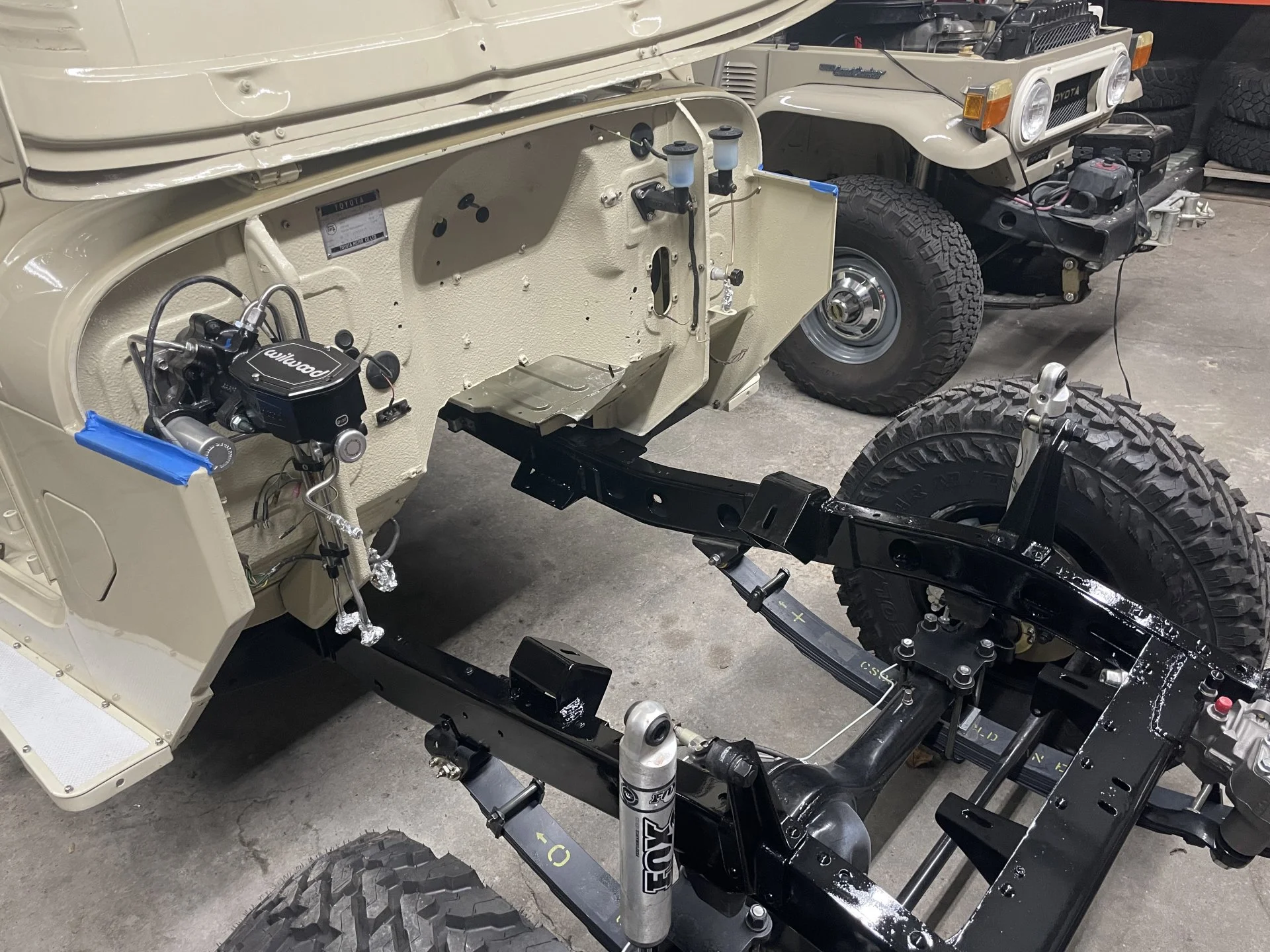

Beautiful hydroboost/steering lines. Those brake lines are temporary, right?

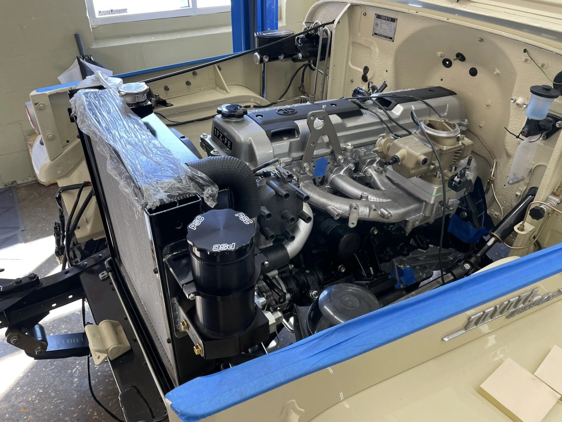

We made a simple bracket for the power steering reservoir and have it mounted now:

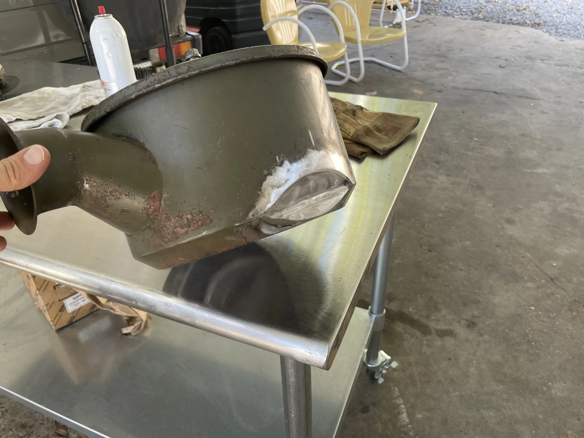

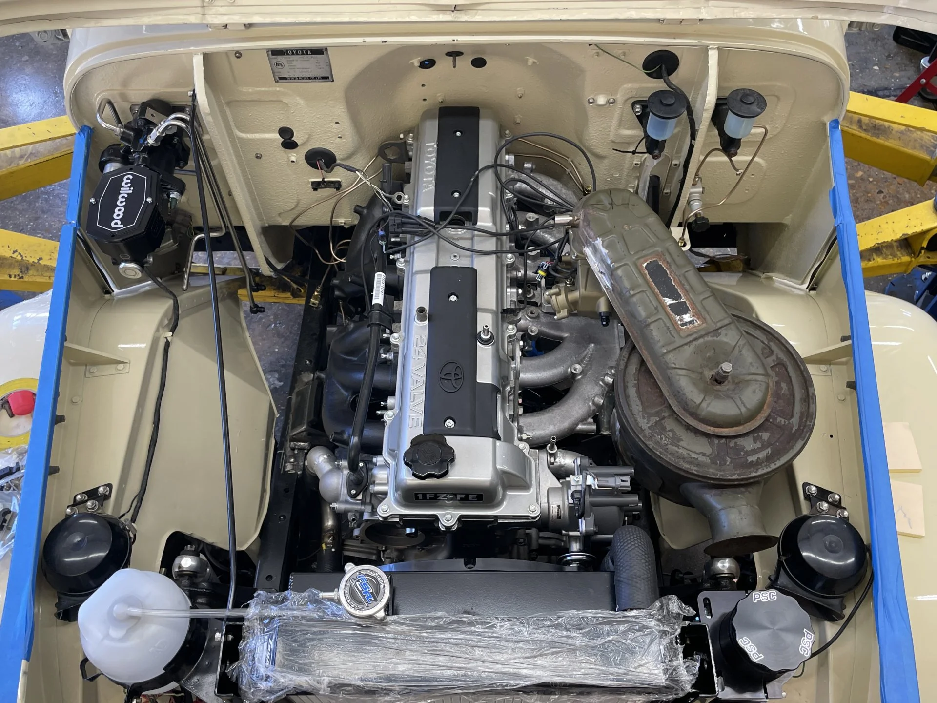

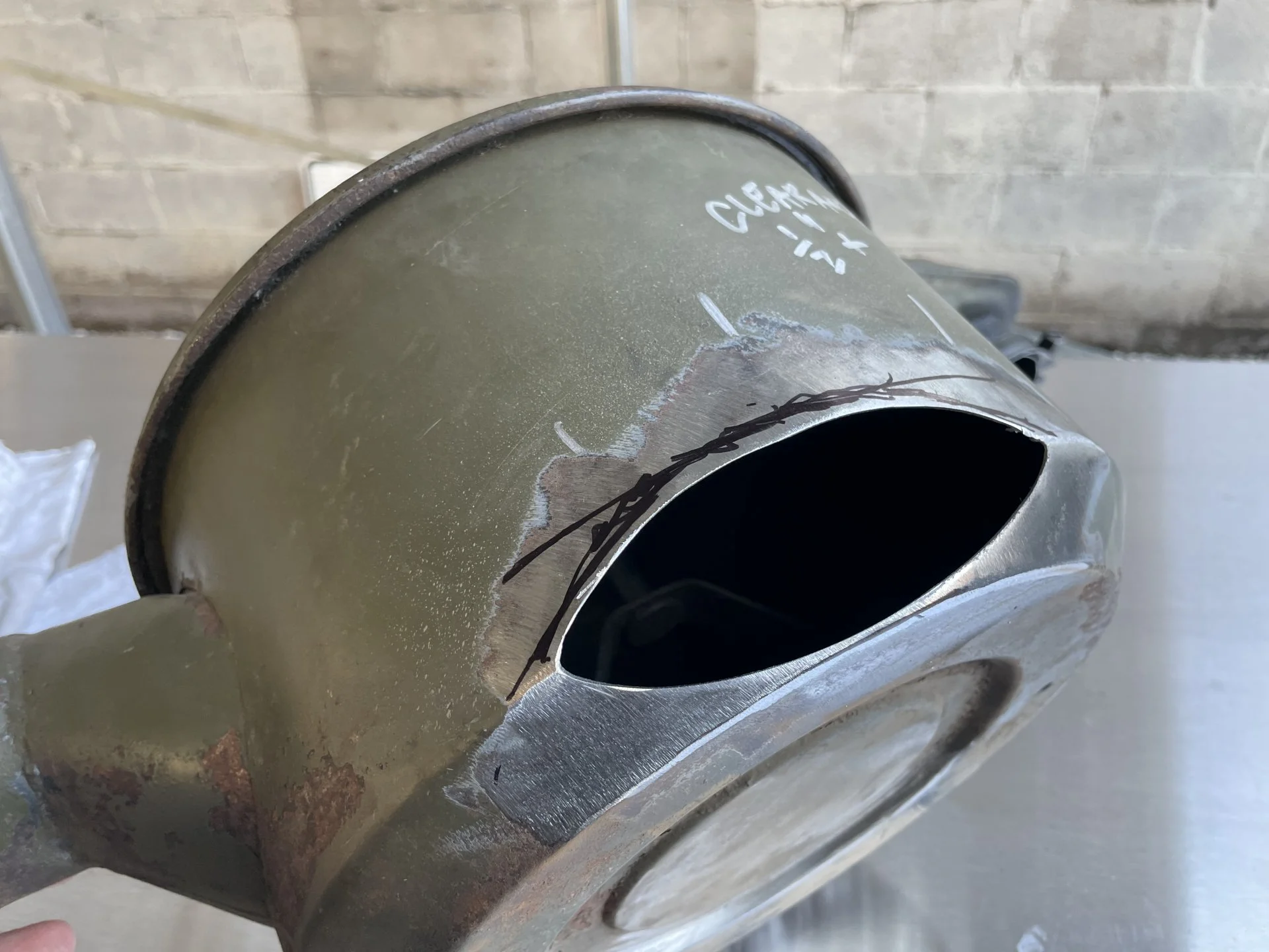

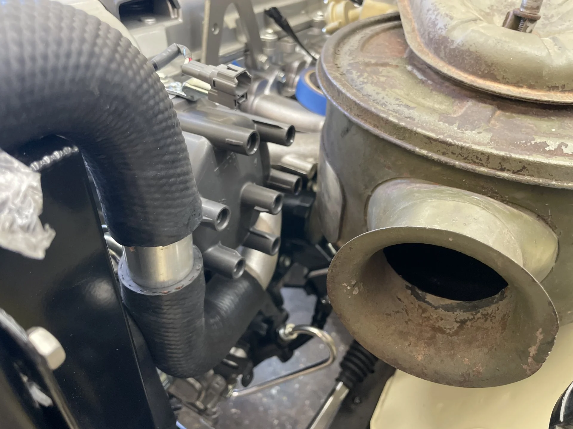

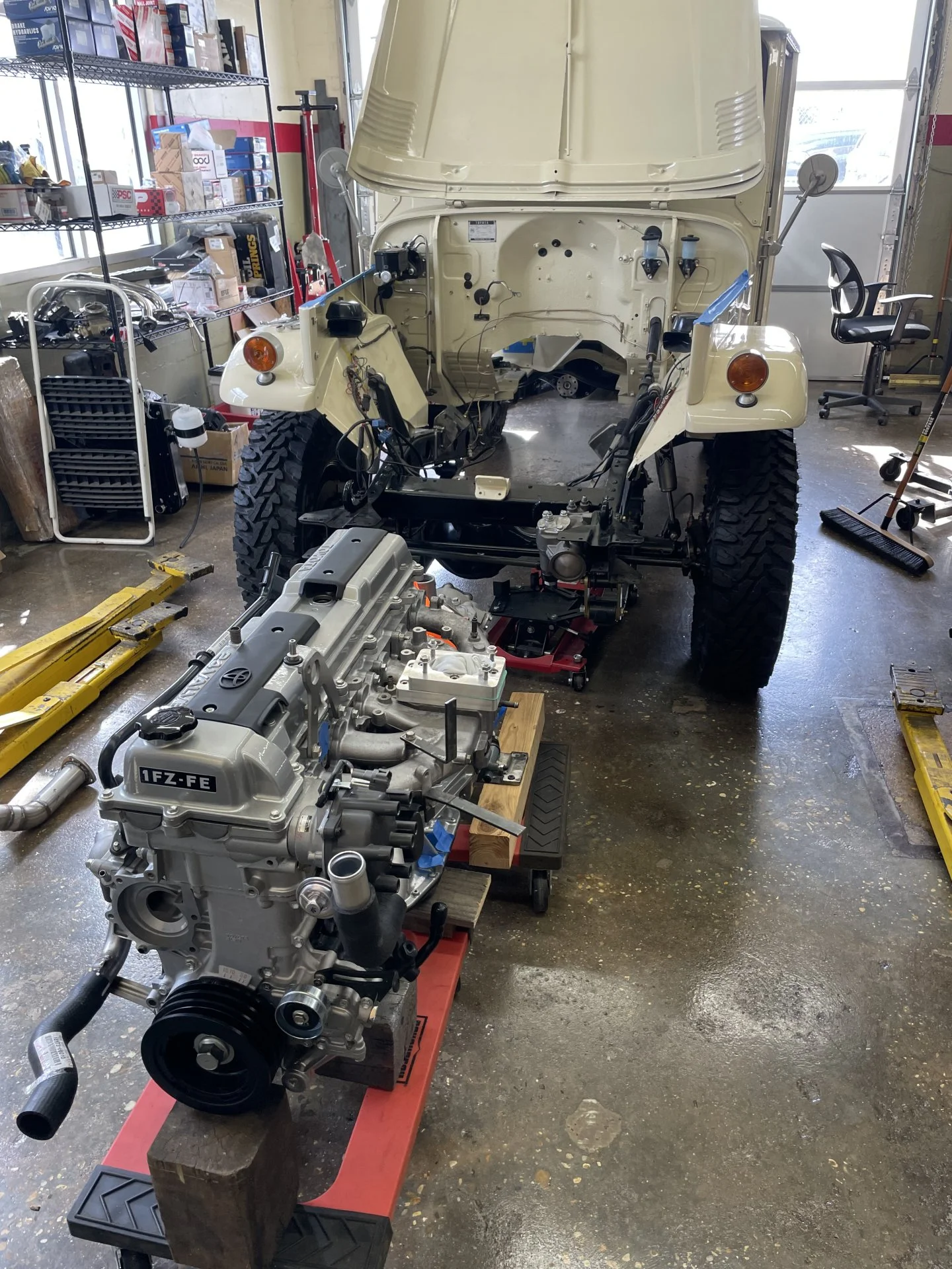

Next up was figuring out the air cleaner. We are dead set on using the old school canister style air cleaner, and were 90% sure we almost had room when we were fitting the motor. We didn’t have a choice, as it was as far passenger it it would go.
We got it mounted and giving the distributor room puts the canister right against the fender:

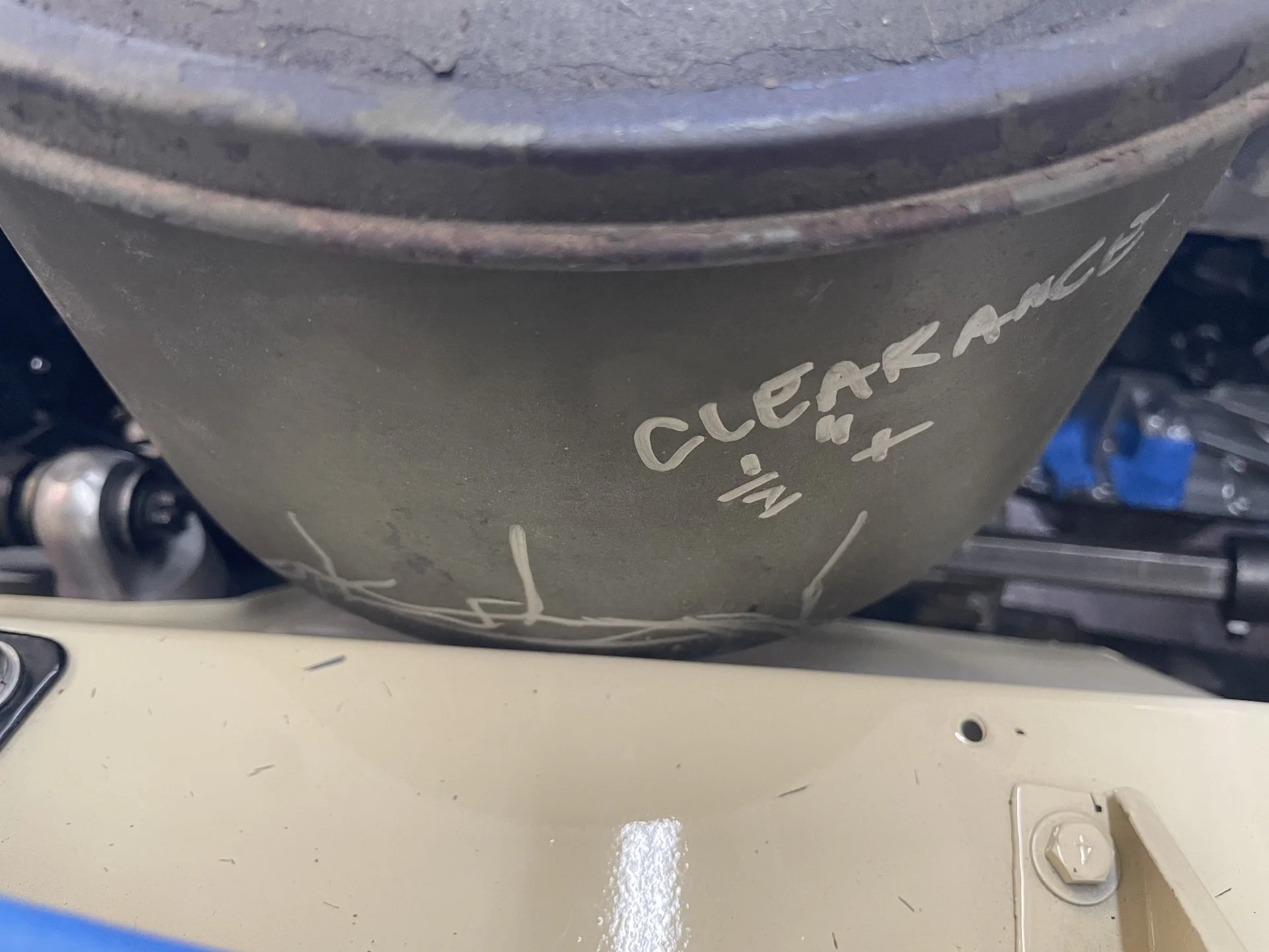

We’re going to put a nice dent right there for clearance:

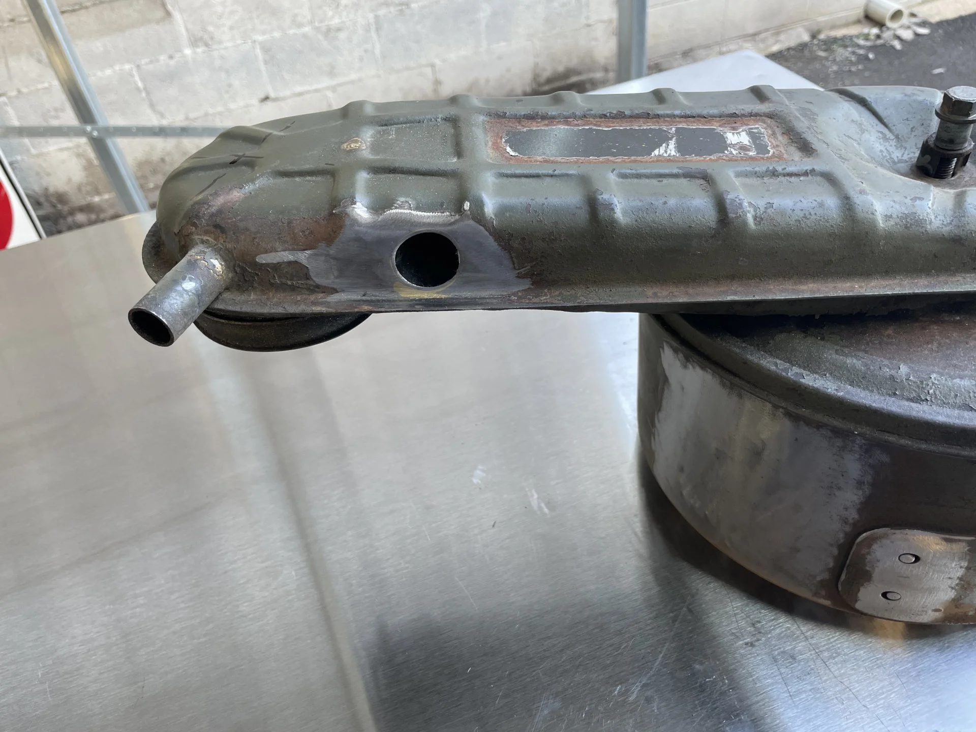

We’re also cutting off any unused brackets or smog tubes:

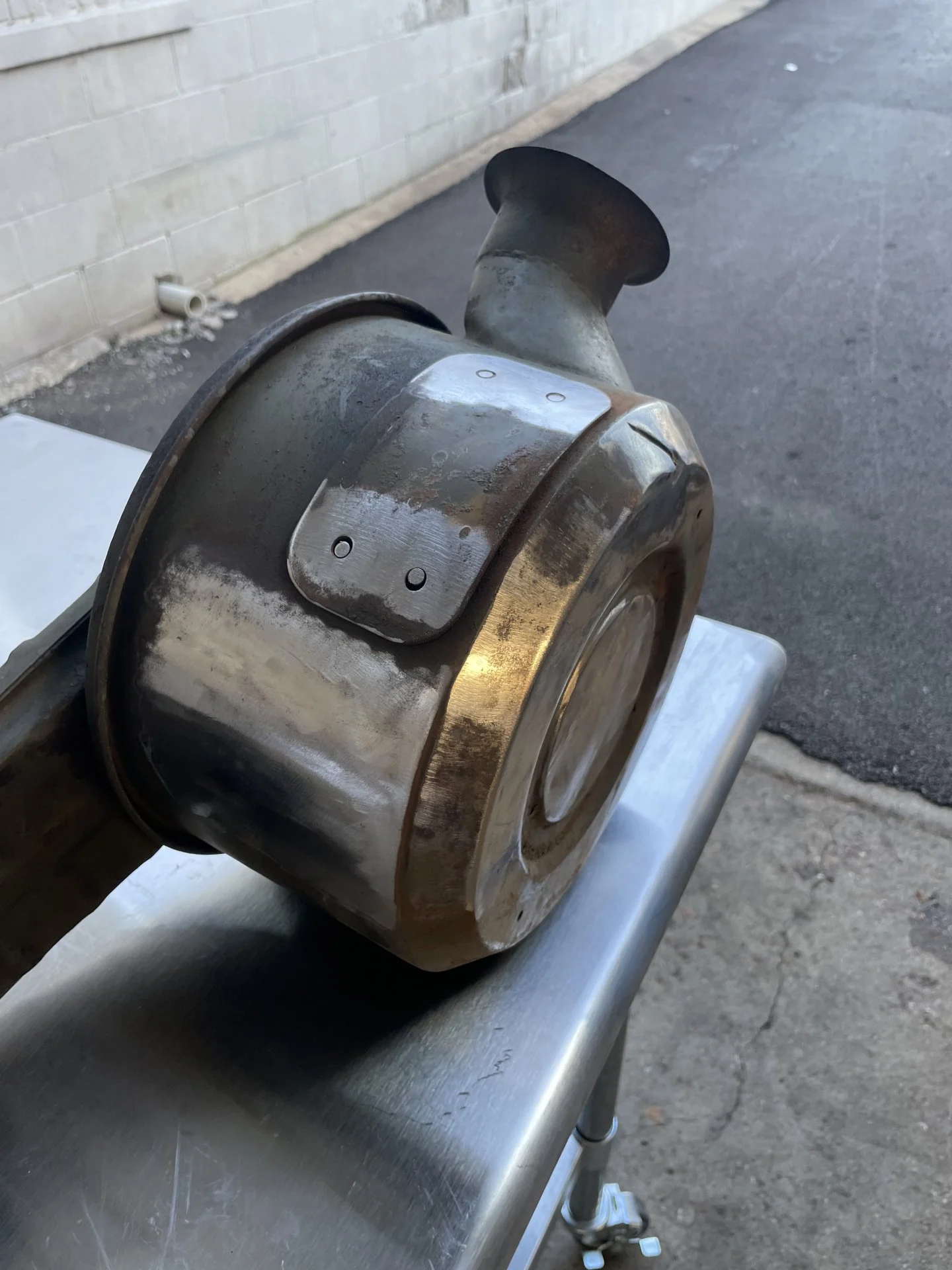

Hole patched:
Distributor & wires clear:
Dent installed:
…which gives some room to move vs. the fender:
Still need to make some support brackets for the canister, but it is sitting right where we want it. Just need to decide what color(s) to paint it :hillbilly:

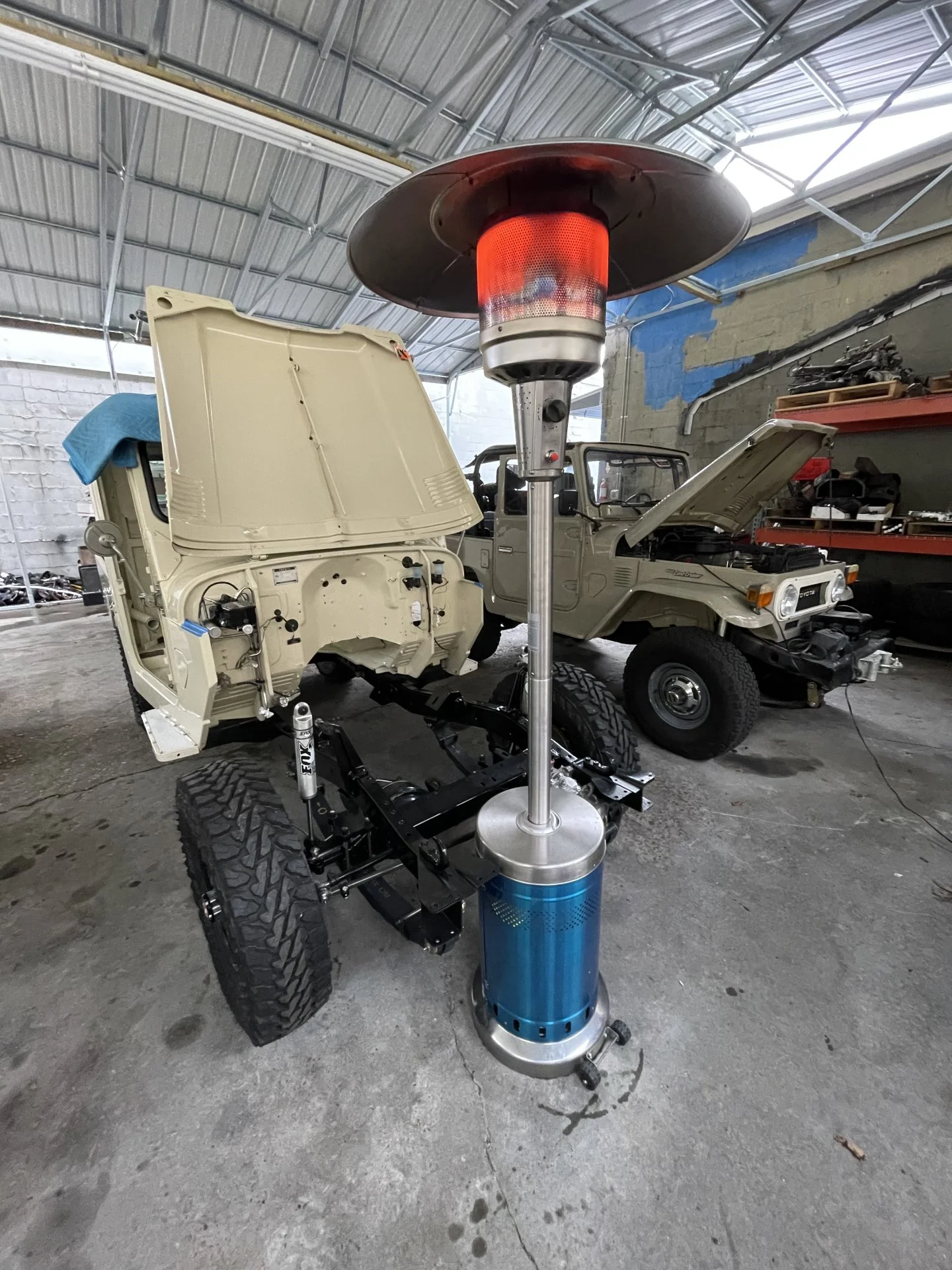

Spent the afternoon at HQ getting Johns other 40 series sorted out but was able to lay hands on Rotunda
We close to this one taking off again. Waiting on 3rd parties to finish things…..
