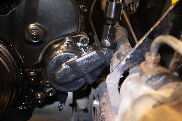

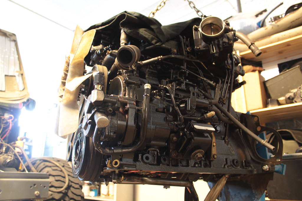

Ok. More updates. There is 3 more issues.
Issue.

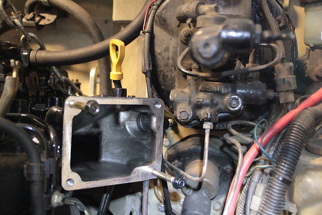

1. The inlet manifold interfers with the brake booster. Well, not actually the booster, but the brake balancer. Its not a big problem- the brake balancer is a separate piece so its just a matter of making a new holder for the balancer. (im gonna buy a new adjustable balncer anyway)

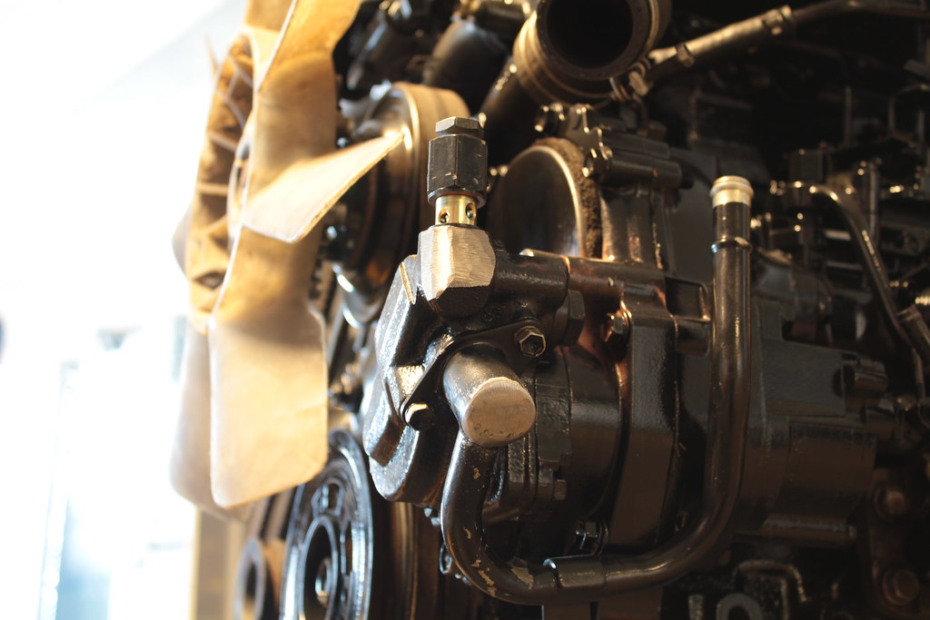

2. The vacuum/power steering pump interfers with the frame. (in my case it also interfers with the steering rod, but thats because i have used a HJ60 powersteering setup). Anyway, im working on that issue, it is soon solved, but not quite yet.

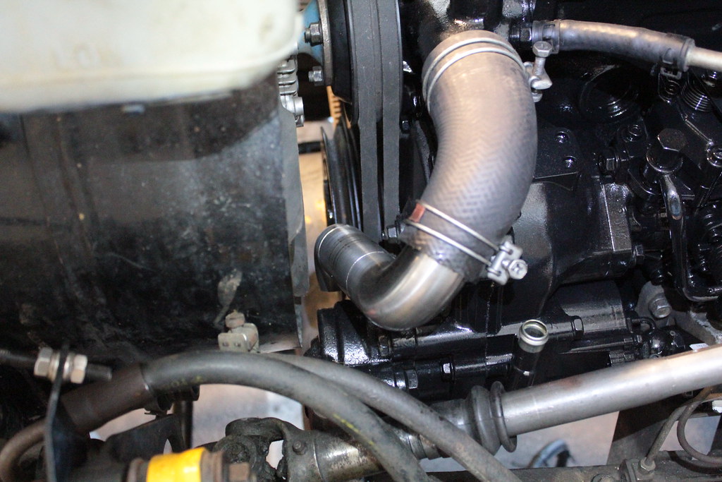

3. The alternator belt "tightener" is to close to the fron axle. Well, its not really an issue, but with full flex it may touch the axle. Im not sure, but i think ill modify this part.
Close
15BF by dieseldragon, on Flickr
Frame touch
Steering rod interference
Brake booster interference (picture is without the full inlet, i had to take it of to get the engine in)
Problem solved, full inlet is mounted. Removed brake balancer (havent relocated it yet, but thats no problem)

You are right about the grinding for fitment to the frame. ill post a picture of more grinding.

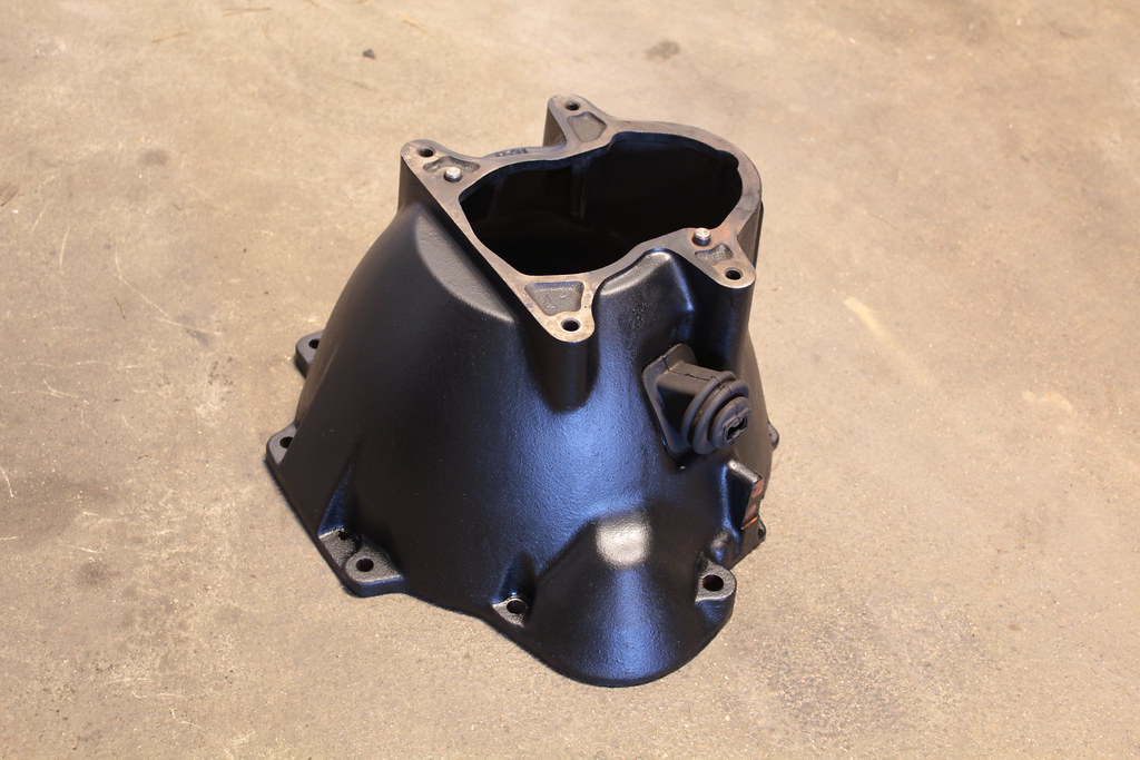

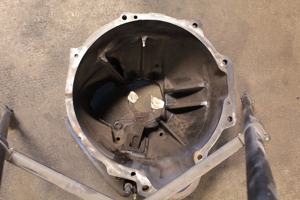

Anyway, im near finished now. I made a return diesel line for the diesel. The main issue now is that i need a bigger release bearing on the clutch. I got the bearing, but i have to "lathe" an adapter to get the bigger bearing to fit. Ill do that during the christmas brake. I also have decided to balance the clutch (wich i grinded down).
15B-F by dieseldragon, on Flickr
I had to grind some in the behhousing due to the bigger clutch

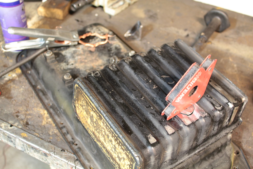

I had to modify the oilpan, cut of the "wings" and relocate the draining plug. I TIG welded it and tested it for leaks.
Modified oil pan 15B to fit BJ42 by dieseldragon, on Flickr
I had to relocate the brake balancer. I put a adjustable balancer there as i was at it. I want less pressure on the rear brakes anyway.
IMG_2195 by dieseldragon, on Flickr
What was the interference with the wings? How much oil capacity did you lose with the change?

The front drive shaft has to go through it :) So, it must be modified.
Im not sure how many litres less capacity i got now, but im not worried because now its pretty much identical to the 3 and 13B oilpan. But you only have to remove one of the "wings" (on the shaft side), but i wanted as little oilpan as possible at the bottom- because of offroading, and sharp rocks.
By the way, the 3/13B oil pan does not fit this engine, it has another bolt pattern and shape. It looks identical but, it aint. 14 and 15b has the same oil pan.
