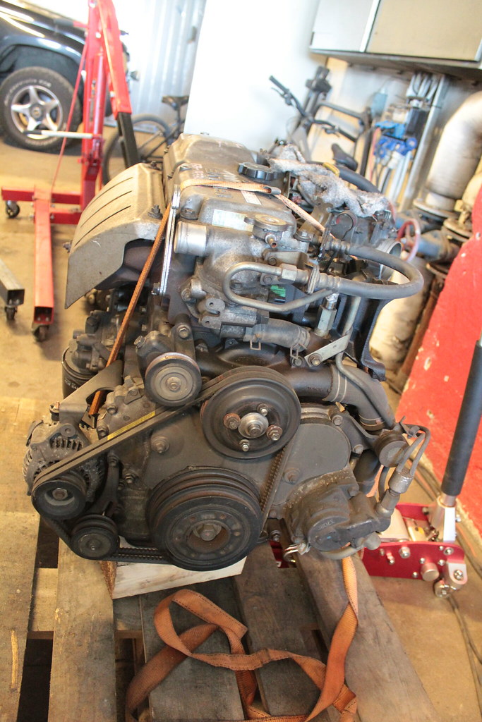

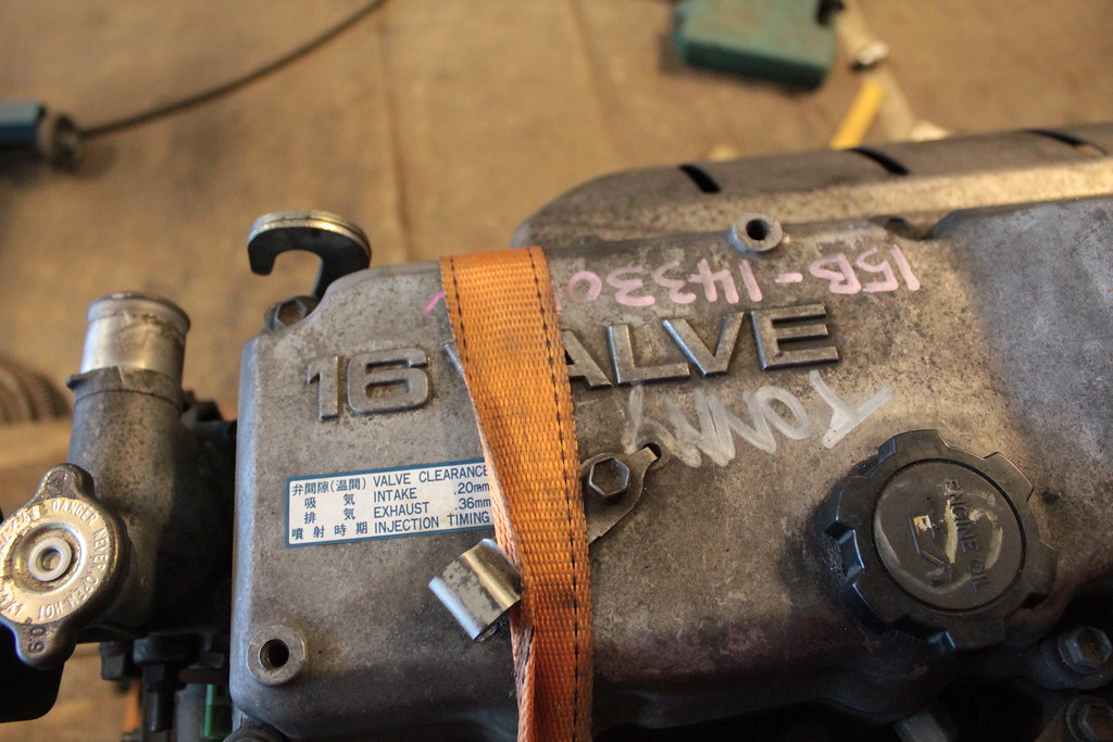

I was planning to put a 1HDT in my 42, but for many reasons i will not go into in this thread i ended up with a 15B (real name 15BF). I excpect most of you know what engine im talking about, but for those who dont know. Its a 4.1 litre inline four, 16 valves, direct injection and a rotation diesel pump.
Not alot of info is avalable on these engines, and even less info about what fits and wont fit when it comes to transmission and clutches. Im gonna solve it in this thread.

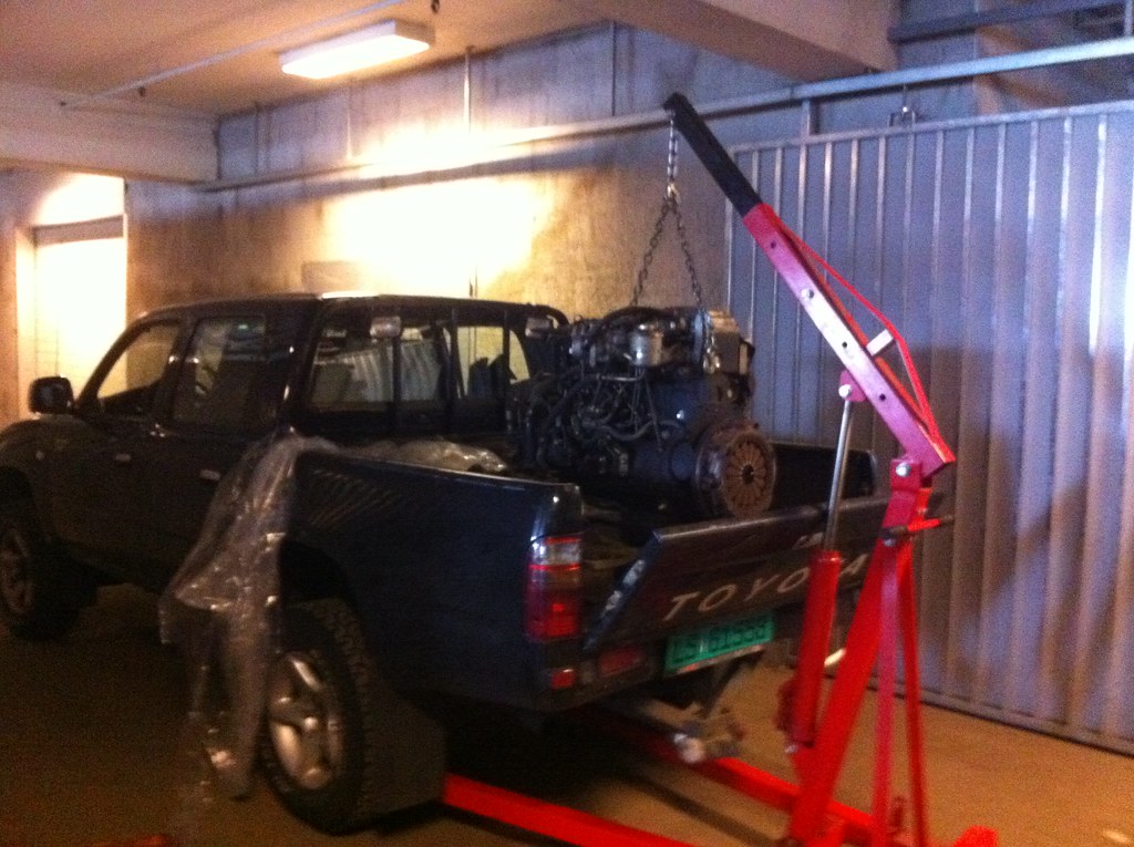

I said im doing it now, thats partly true. I baught the engine yesterday, but i have an extra H55 transmission to do some testing. I wont put the engine in the car until late fall, but the main problem is fitting a transmission and clutch (atleast thats what most people think).
So i went to Denmark and baught one. Denmark- if you plan to go there, dont. there is nothing there to see (maybe if you are into big citys, but i aint). My engine is a 1999 model from a Dyna. 109K (kilometers)

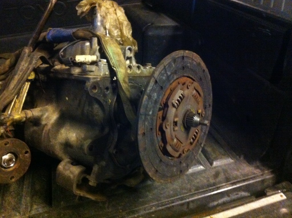

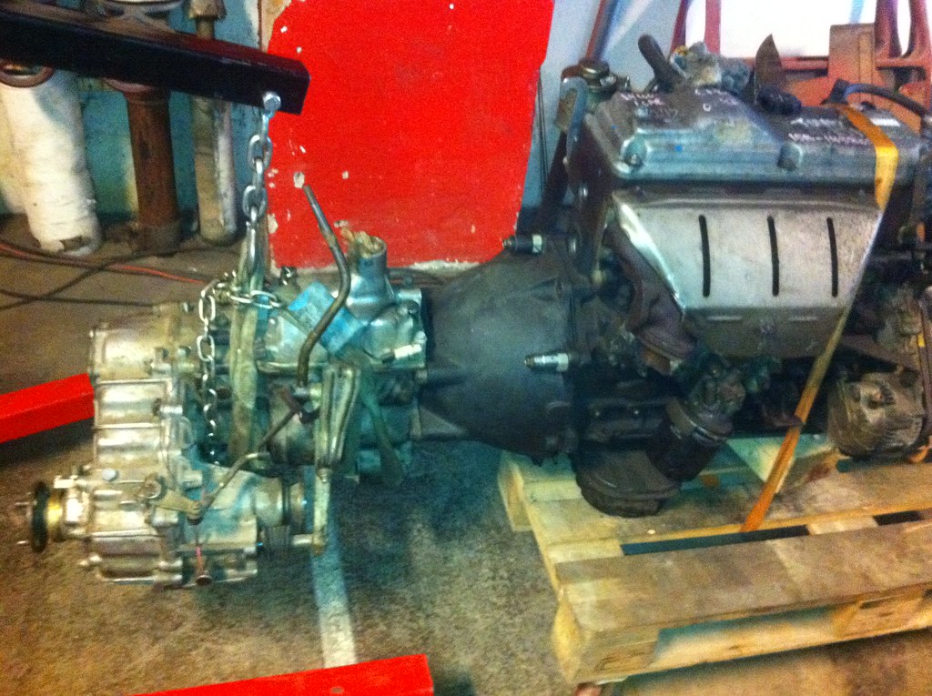

Today i tried to mount the transmission and clutch. Good news!
Solved issues :
1. The stock bellhousing from a BJ42 fits.
2. The actuall clutch disc has the same amount of splines as my stock BJ42 disc. Im not saying they are the same discs, but the 15B clutch disk enters my BJ42 21 splines. By the way. the 15B disc is 275mm, not 300mm as many others say it is. But there may be other configurations out there, i dont know.

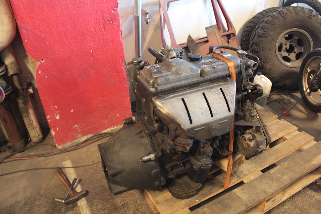

3. I also tried to mount the transmission and bellhousing together. Everything fits perfectly, but there is two minor issues..
Issues
1. The plate between the bellhousing and engine does not fit with the starter. To solve this you can either modify the plate, or just use the one from your stock B or 3B engine. Problem solved.
2. The pressure plate is a bit bigger, not much byt slightly bigger. It builds a little more outwards towards the bellhousing. Tomorrow (if im not hang over) ill "massage" the pressure plate and bellhousing with a grinder. i Think that will do the trick. The last solution here is to try a bellhousing from a 70 series cruiser. A friend of mine has a 70 series housing i can try, but first ill try some grinding.

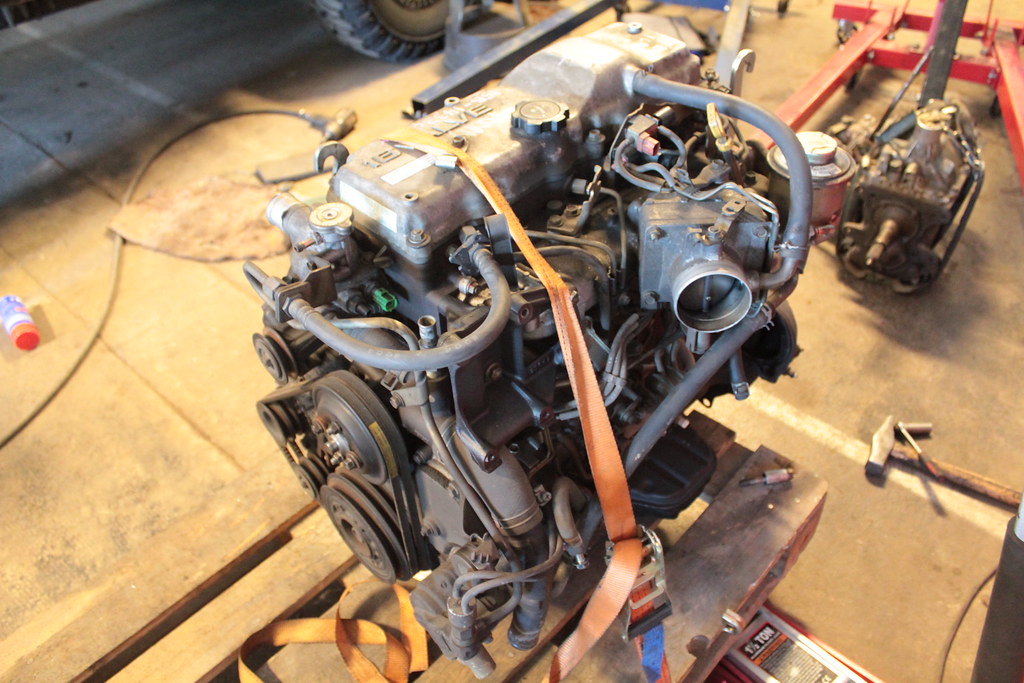

Here is some evidence so far :)
Untitled by dieseldragon, on Flickr
15B (F) Engine in BJ42 by dieseldragon, on Flickr

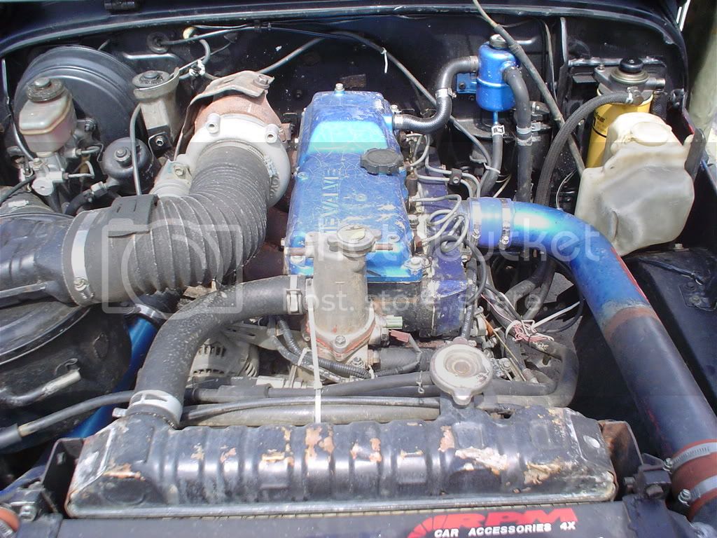

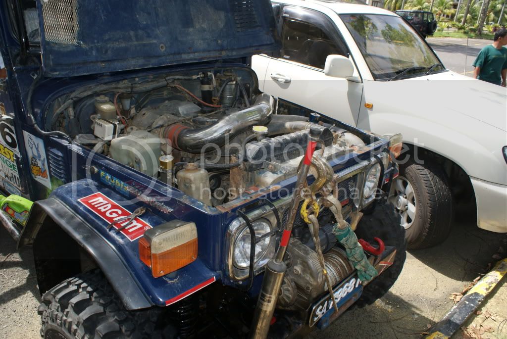

From my knowledge, the oil pan doesn't not fit into 40 series. Must be from the cruiser series, not dyna truck. Good try! We have heaps of 40 series with this engine mounted into their cruiser. Keep us dated! :grinpimp:
15b into 40 series
Here is a few sample photos

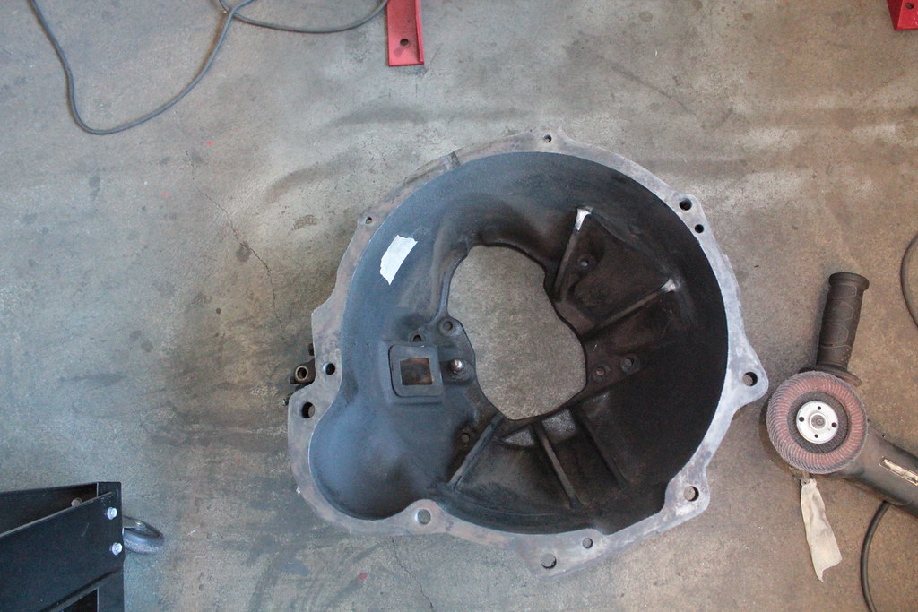

Ok. More updates.

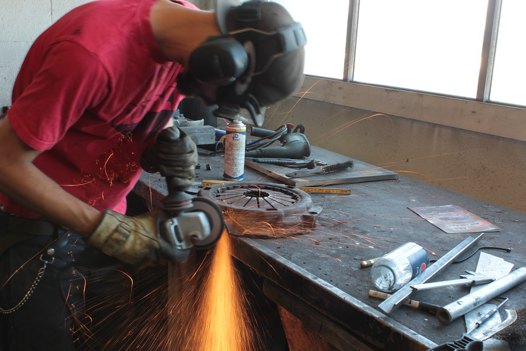

Today i grinded the pressure disc, and i also did some minor adjustments to the bellhousing, just to be on the safe side of clearance.

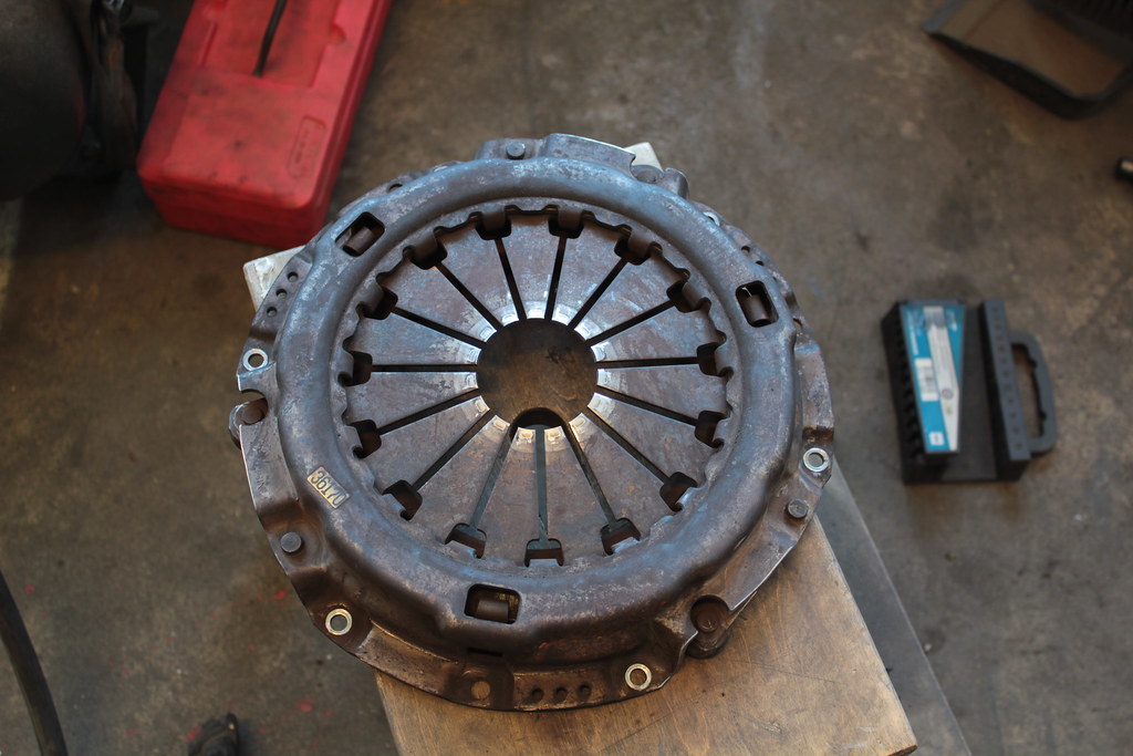

At first i tried to remove about 2mm on the pressure plate, but that was not enough. I trimmed of about 5mm on the most critical spot. I cant se any reason why this should make the pressure plate weaker, so im pretty confident that removing some steel is more than strong enough.
Anyway, now the clutch, bellhousing and gearbox mounts perfectly. The "hard part" is done. Next, i have to get hold of the clutch release fork, and test that disengaging the clutch works as it should. A friend of mine has a fork, so ill probably test that tomorrow.
A couple of pics of the engine (yes i will prettify it)

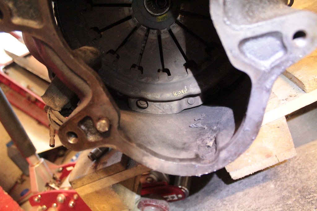

Here is the problem, the pressure disc interferes with the bellhousing (before grinding)
15B-F into BJ42 by dieseldragon, on Flickr

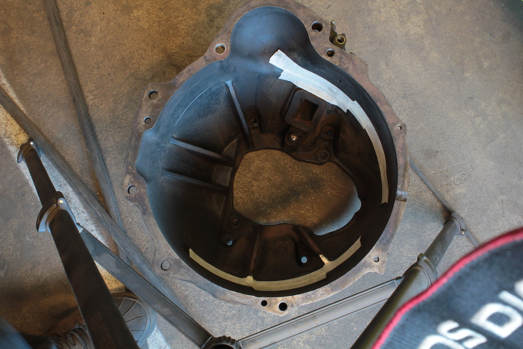

I did a couple of try and fit before i ended up with a total of about 5mm trimming. I used tape to check for contact

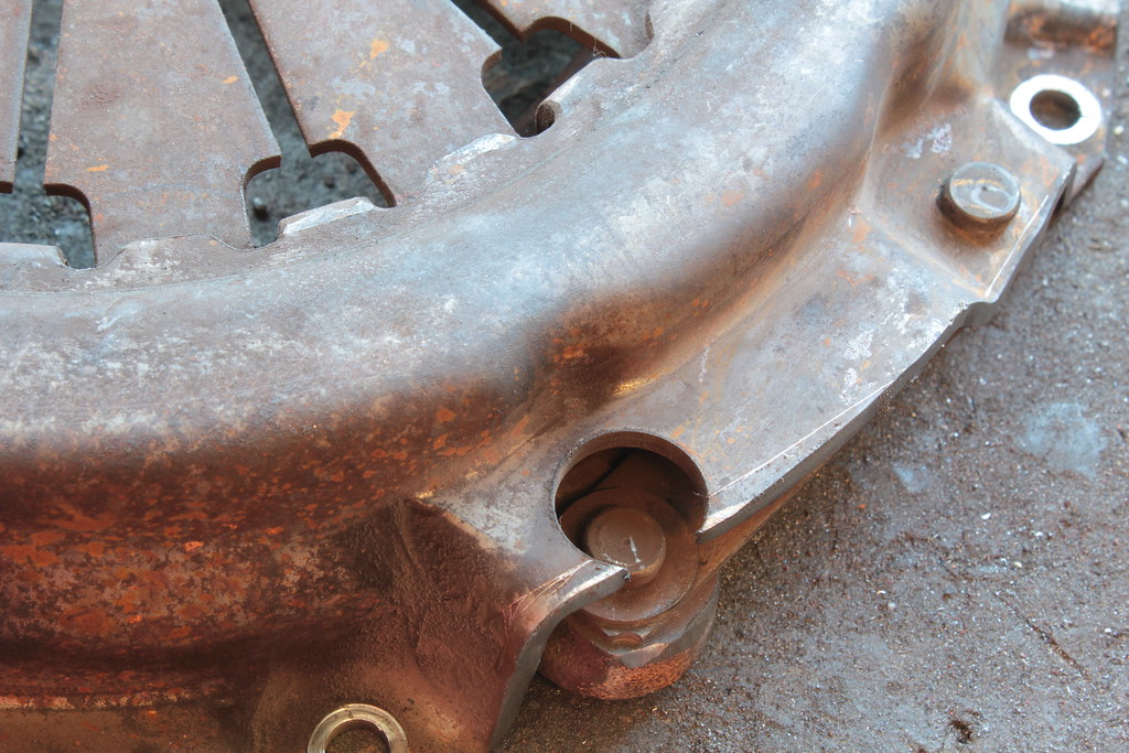

The grinded pressureplate

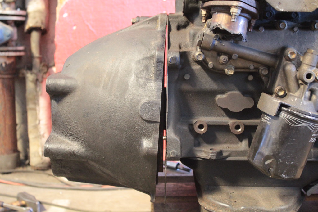

Its hard to see, but if you look closely i grinded a little of two of the "fins" inside the bellhousing, it might not be necessary, but i wanted to be on the safe side.
