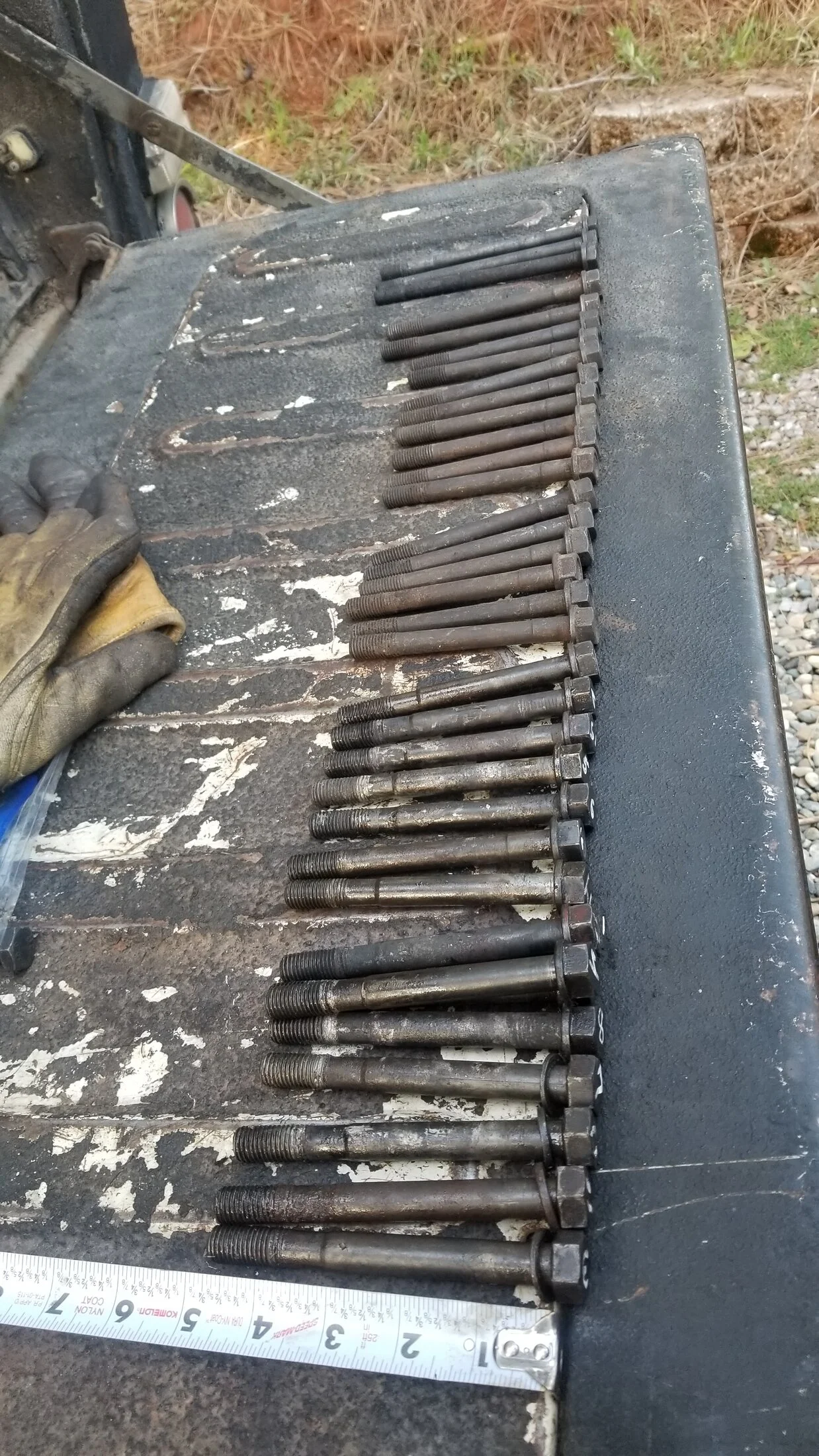

145mm head bolts for a 73 fj40 1.5F motor
I bought head bolts from the Fremont Toyota dealer in Lander, Wyoming.
I need to find a source for these head bolts to complete my engine build. Can anyone help me out?
I've got a few extra head bolts, probably not the ones you're looking for. I bet Mark A. has some too. What's that in inches?
Thanks for the reply. Sorry it took so long for me to respond. I have since recovered the missing bolt and am good to go once I get my pistons from Wiseco. It has been an agonizing wait for them to get my order done. They say February now before I will get them.

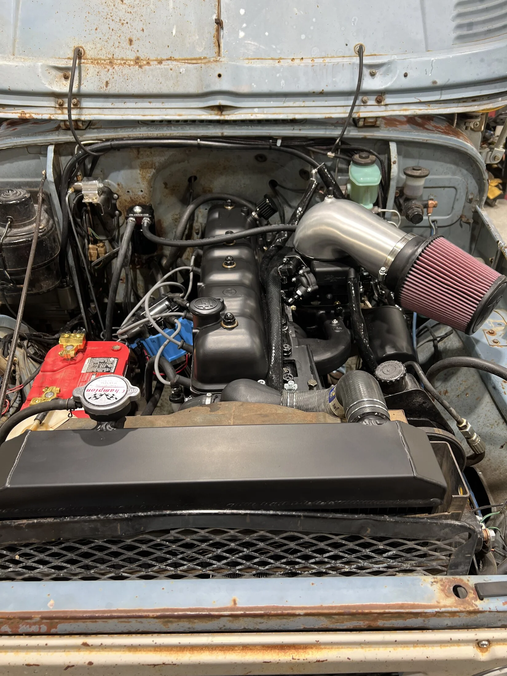

ARP studs actually makes a stud kit for the 1F/2F I recently just did a LS valves swap install in my 1F head and I was lil worried about the head bolts being fatigued and not holding torque, it had a bad head gasket and that's what got the ball rolling to do the LS valve set up so when I put it together I did studs, since my block and head were perfectly flat I wanted to rule out any issues of my gasket going bad. Very easy to install and torque down more accurately than a bolt. Also it sounds like your trying to maybe make a lil more power (wiseco pistons), I did a RV cut on my cam and man it woke it up, even before I had LS valves or EFI. Delta Cam in Washington very fast and fairly priced service. They take your stock worn out cam weld it and recut it. I also did piston coatings also, skirt and ceramic coating on top.
