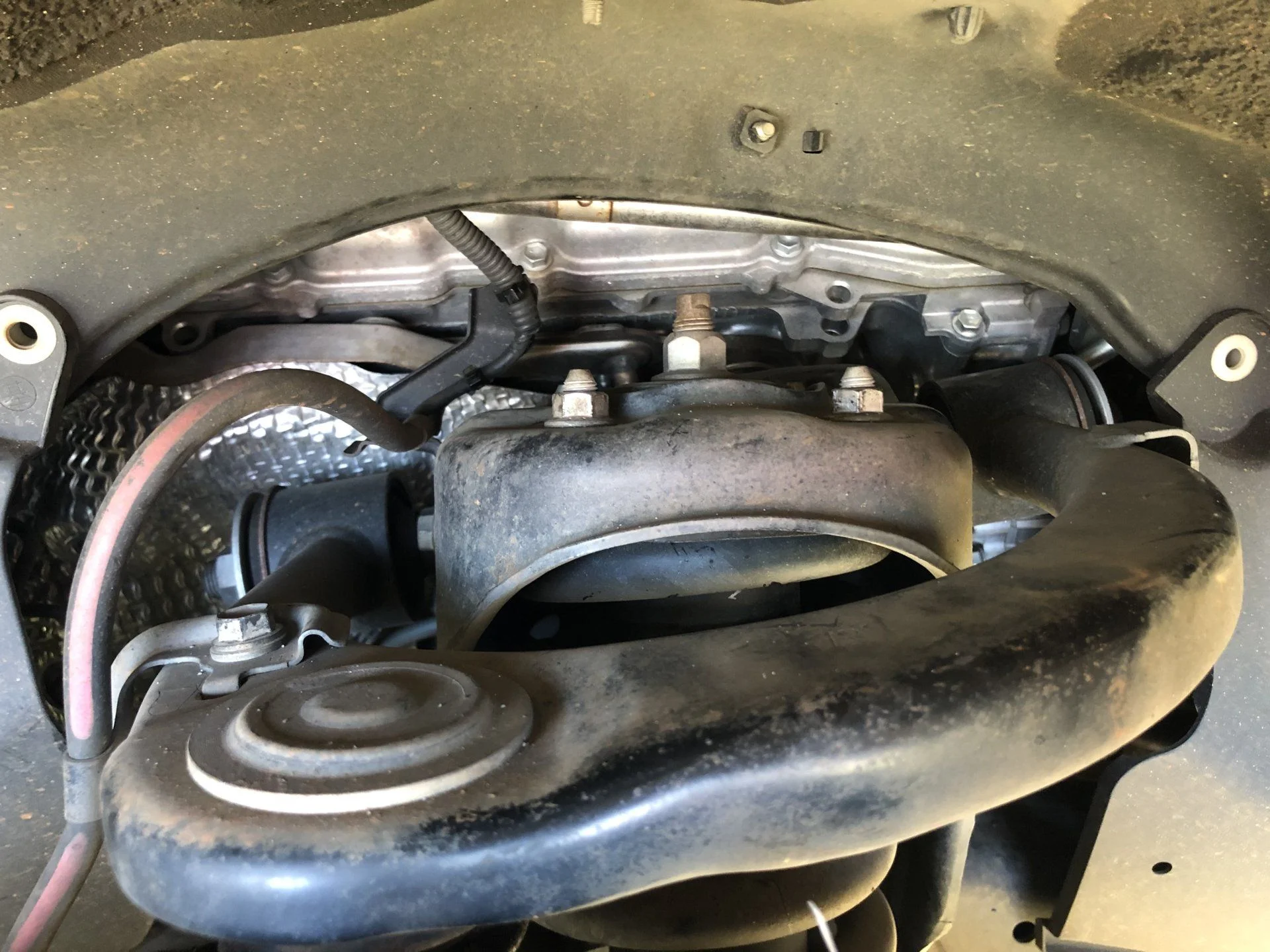

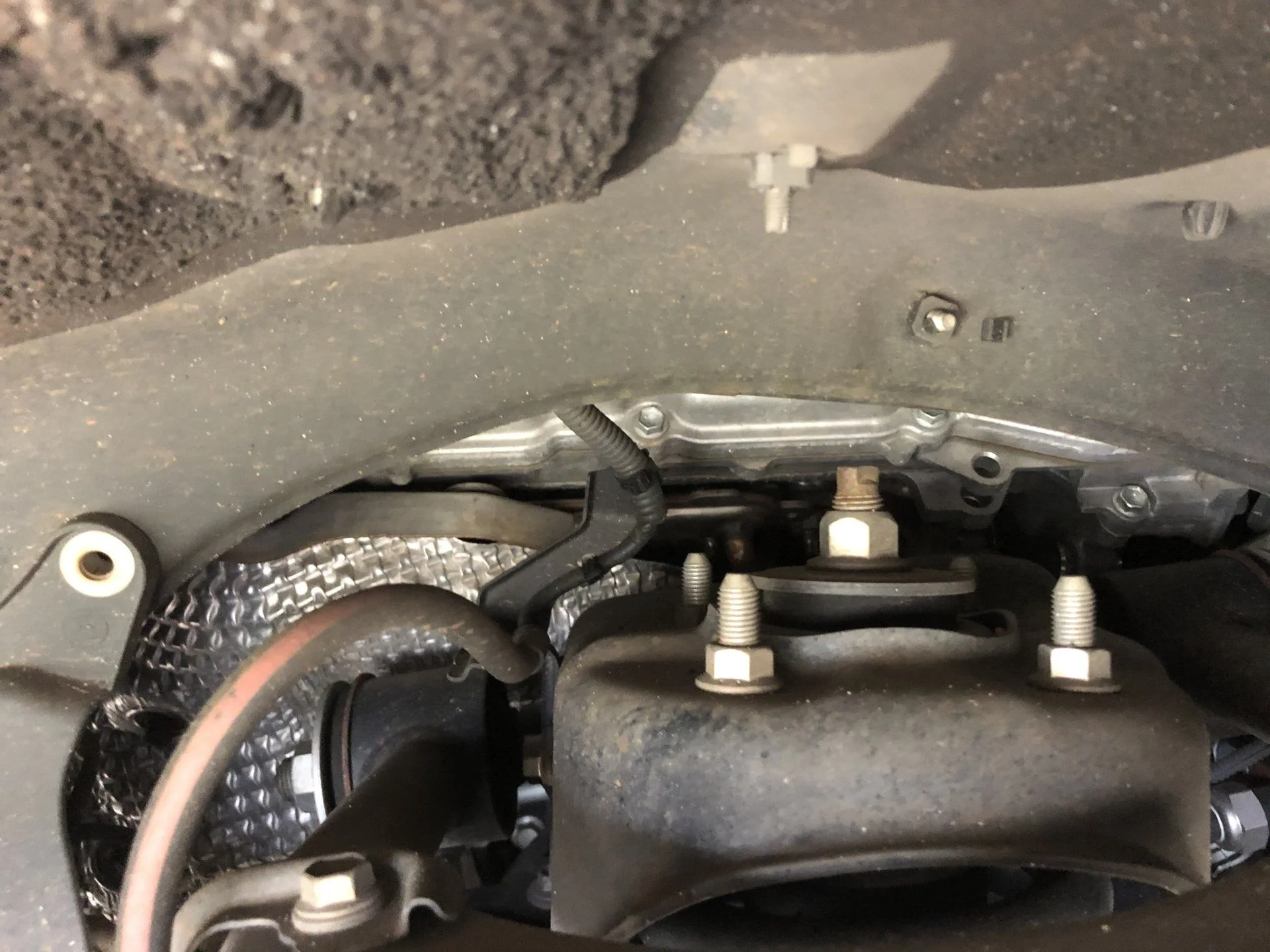

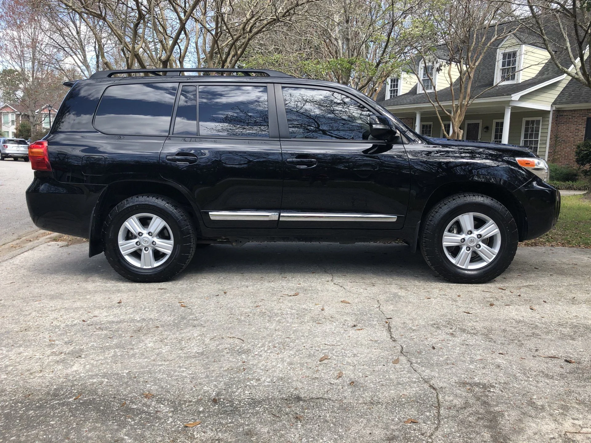

1) just did the oem spacer install - gained about 1” and really like the small improvement (pics below)

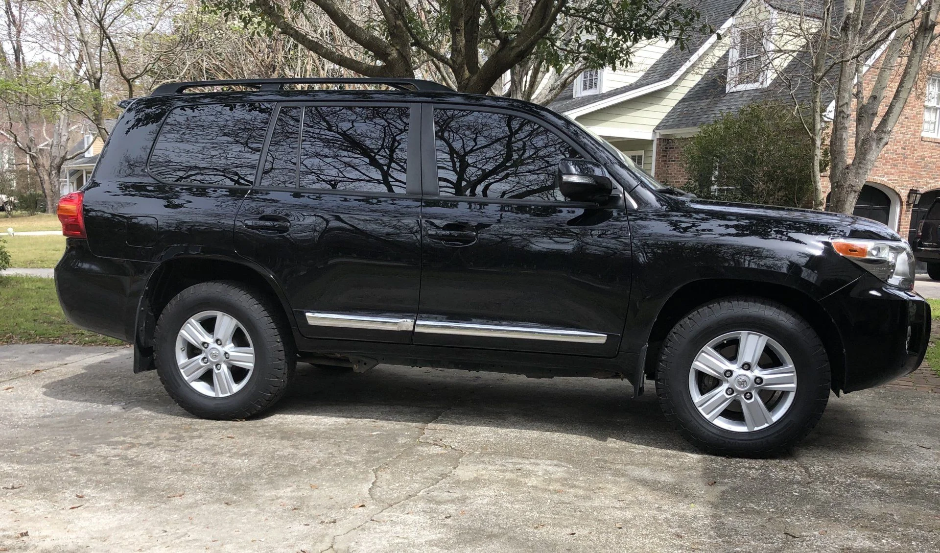

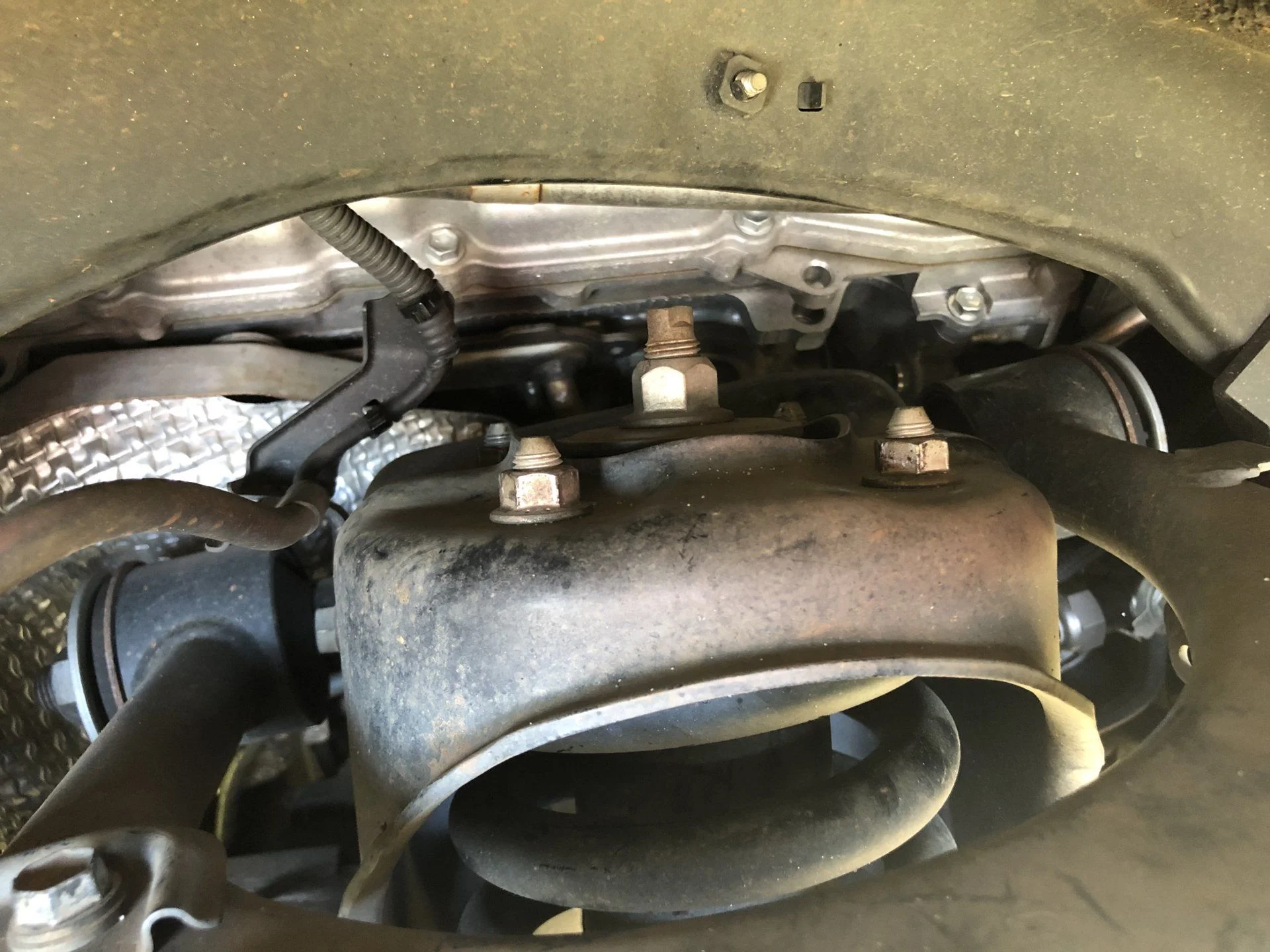

*Pre-spacer lift pics
/end befores

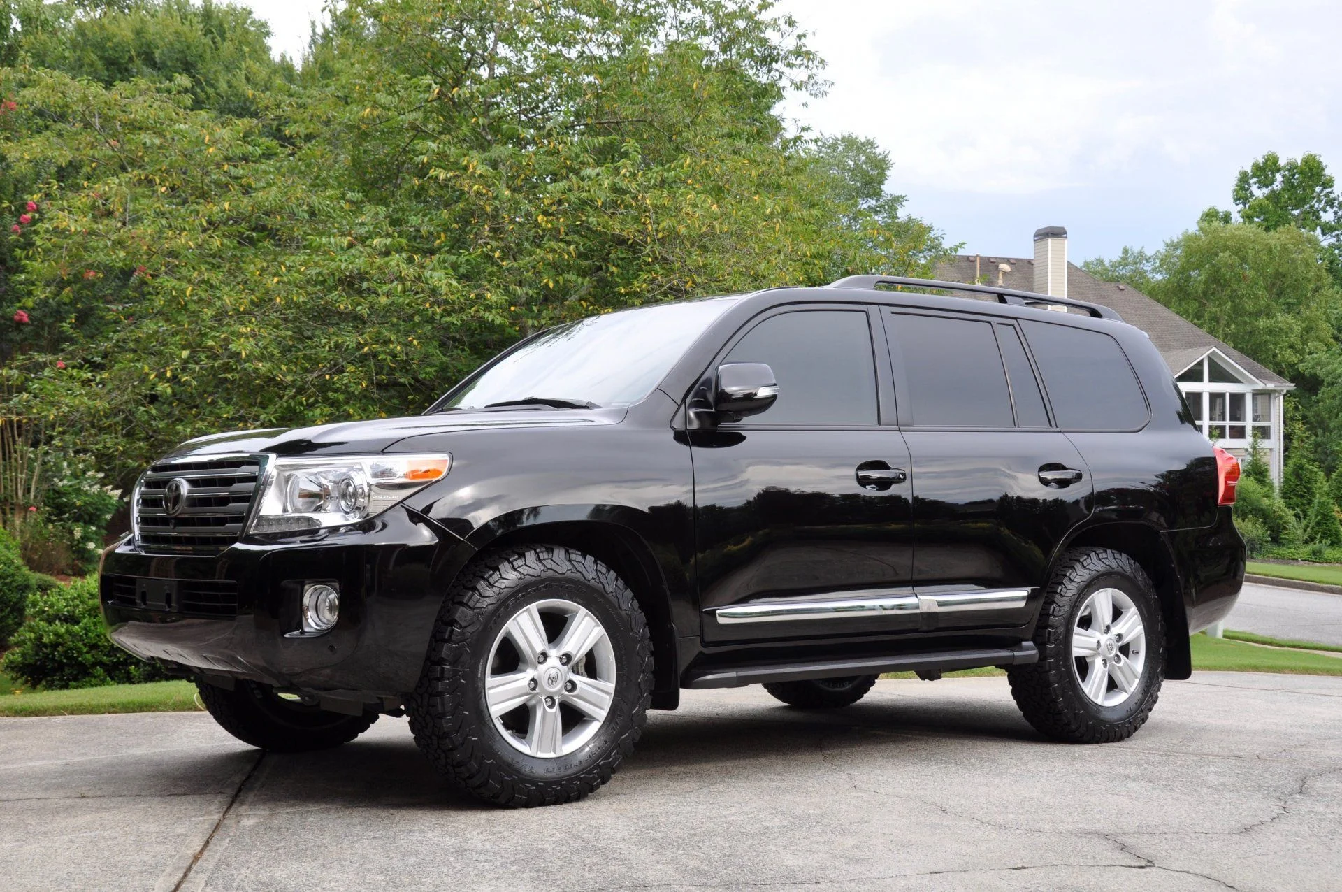

There are my favorite ATs by a long shot. I used them all summer in UT and in the Sierras afterwards and did great on basic 4x4ing and silent on the street. Not tires for rock gardens of course.
Glad to hear it. Any pics or link to an older thread w pics? Size? How was Tread life? Tia.
275/55/20, wearing pretty fast because of my cornering, 3-year tire. No chipping or tears.

On your close up of the spacer, can you circle it or point it out, I can’t tell where it is! Thanks
The cup shape of the upper strut/spring mount obscures it. Imagine those two clearly visible studs sticking through the nuts being 10mm longer. That is what you’d see without the spacer. It pushes the whole top of the assembled strut & spring down 10mm.
As for the big center nut on the end of the strut shaft, it doesn’t change protrusion, the spacer just moves the whole thing down.
