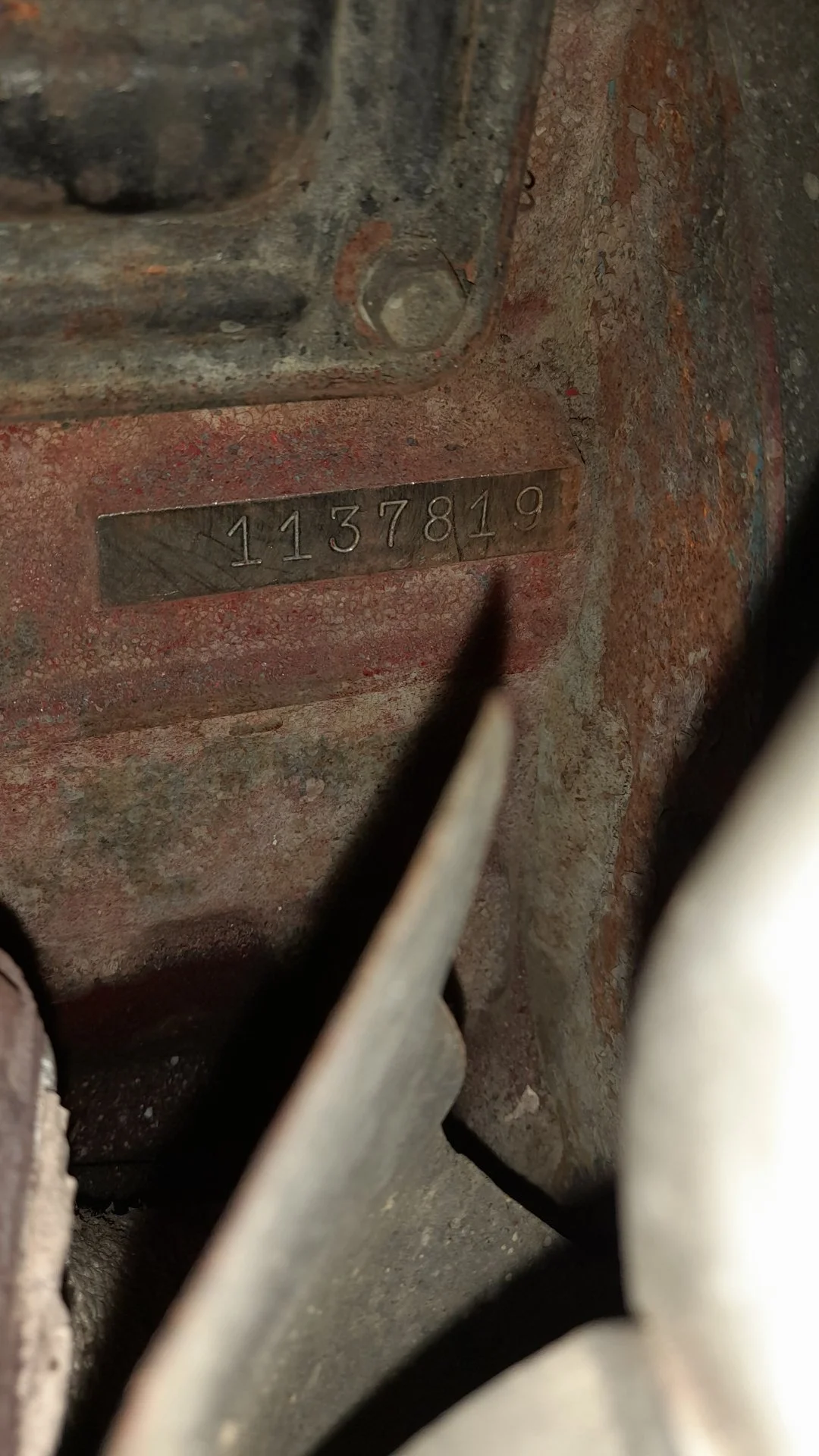

Hi Cruiserpilot,
the engine number is easy visible - but since I build a 3 inch knee behind the turbo I don't have that heatshield anymore. (seems to be very fine) Shouldn't be in the way anyway by the looks.
Unfortunately there is not much information at all about the engine number. I searched a while ago and it seems to be a big mystery.
The pic shows the rear end of the lifter cover.

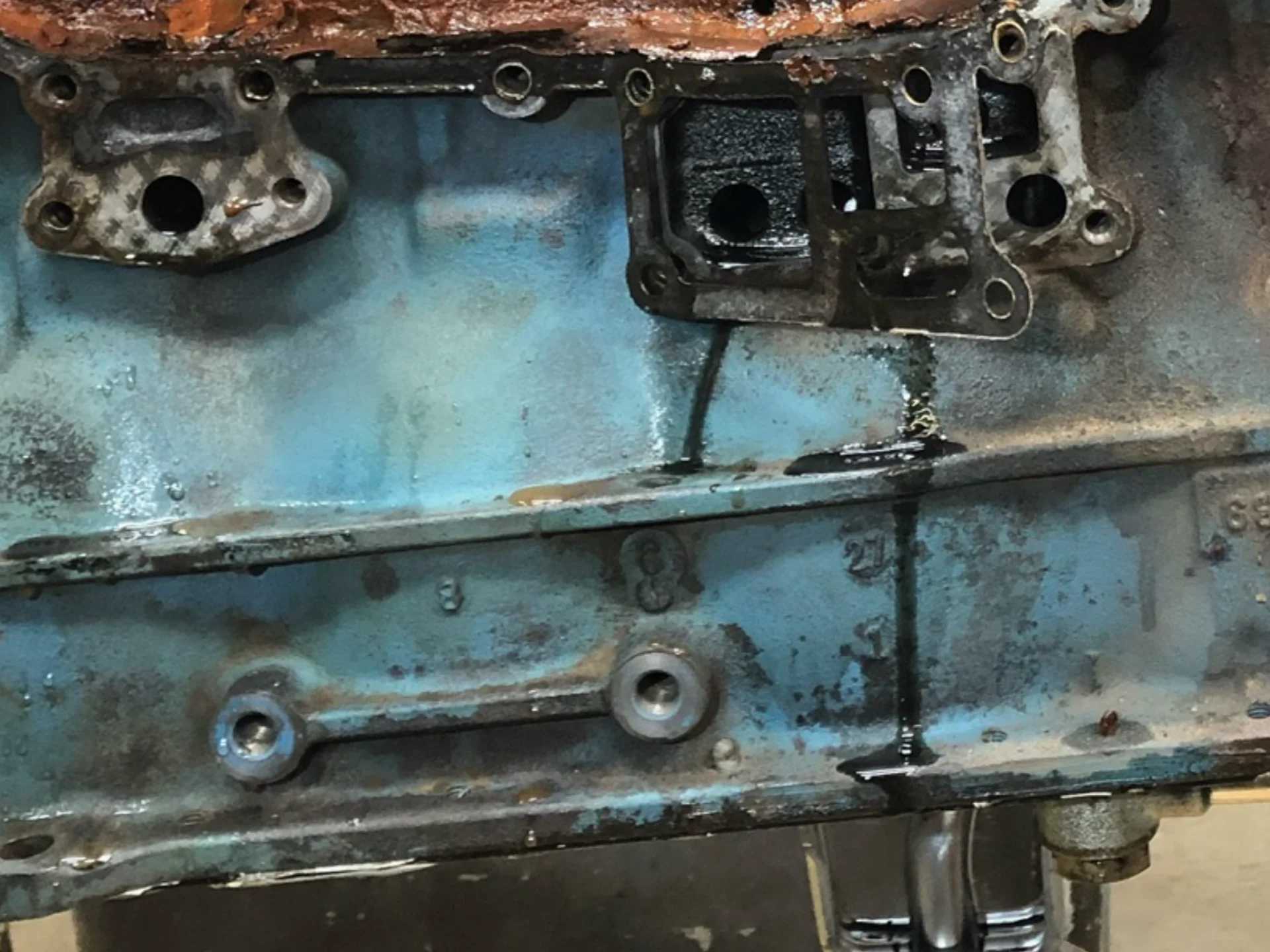

It's cast into the block. It's a numerical code system.
1st digit will be the year (in the below example, 8= 2018)
next 2 digits will be the month (05= May)
Last 2 digits will be the day (12= 12th day of May... in 2018 that was a Saturday)
The casting dates will be, generally speaking, within 1-2 weeks of the engine assembly itself. The 1HZ below was actually assembled on 5/21/2018 while the castings were done about 10 days earlier.

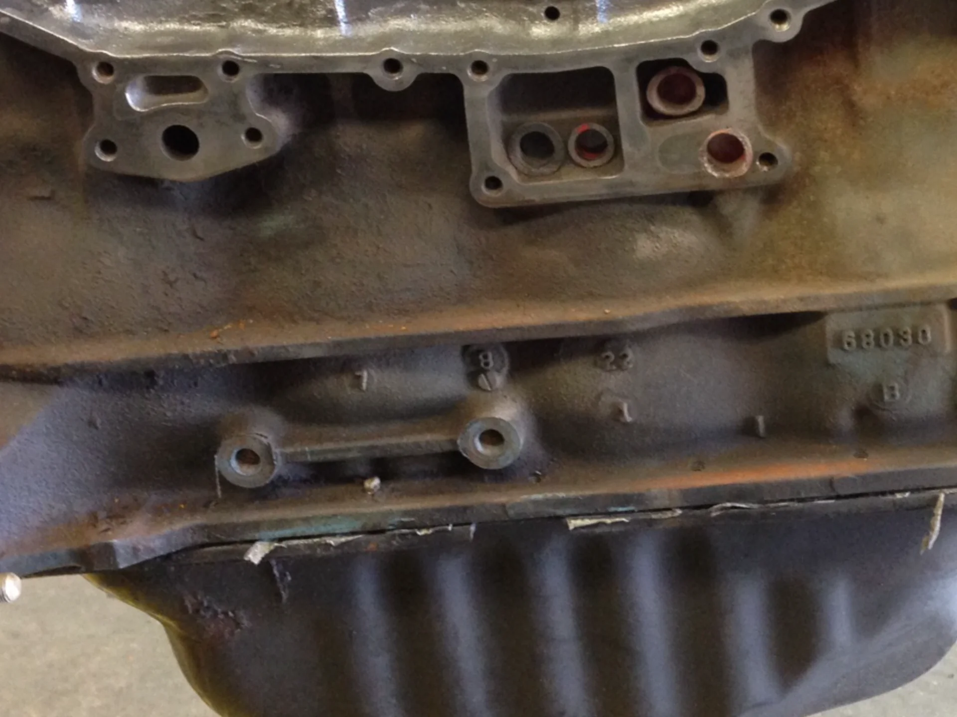

Good info guys, thanks. I’m just getting into doing a rebuild on my 2nd 12HT and have always been curious of the date code As I know that the serial numbers and stampings on the oil pan mating surface do not apply to the date so based off your info @OGBeno I think these numbers cast into the block might be what we’re looking for?
problem is they are not grouped together like the HZ. One is 8.6.27 and the other is 7.8.22. Wasn’t able to find any other #’s
thoughts on that?
the 68030 number is the same on both.
