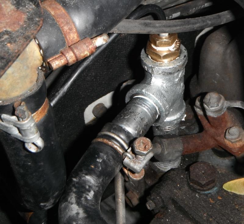

I did the same search and I scratch my head for a long time to find a good place to put an aftermarket water temperature sensor on my 12HT.
The glow sensor's hole is too small for a "standard" mech temperature probe and the probe make interference with the t-stat spring when using the hole in the thermostat housing.
I read someone drill and tap the thermostat housing but that afraid me ! (https://forum.ih8mud.com/showpost.php?p=8812527&postcount=43)

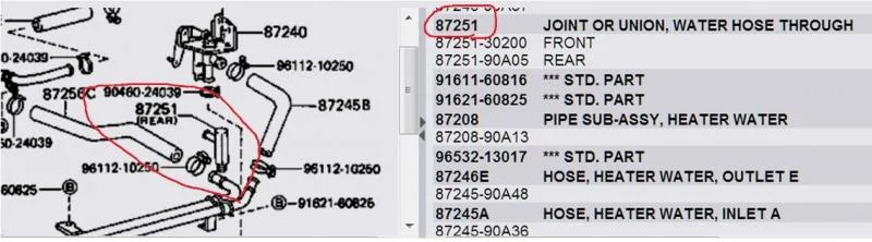

I figure that the only solution is to put it on an existing hose where the flow is coming out of the head. See the pics underneath.
I just have to make sure the rear radiator heater valve is always open to maintain the coolant flow. It should be accurate... but I did not know yet because the truck is in a restoration process and I did not start the engine since...
You can easily find these piping at your local hardware store. The pipe's thread patern is the same as the head thread patern..

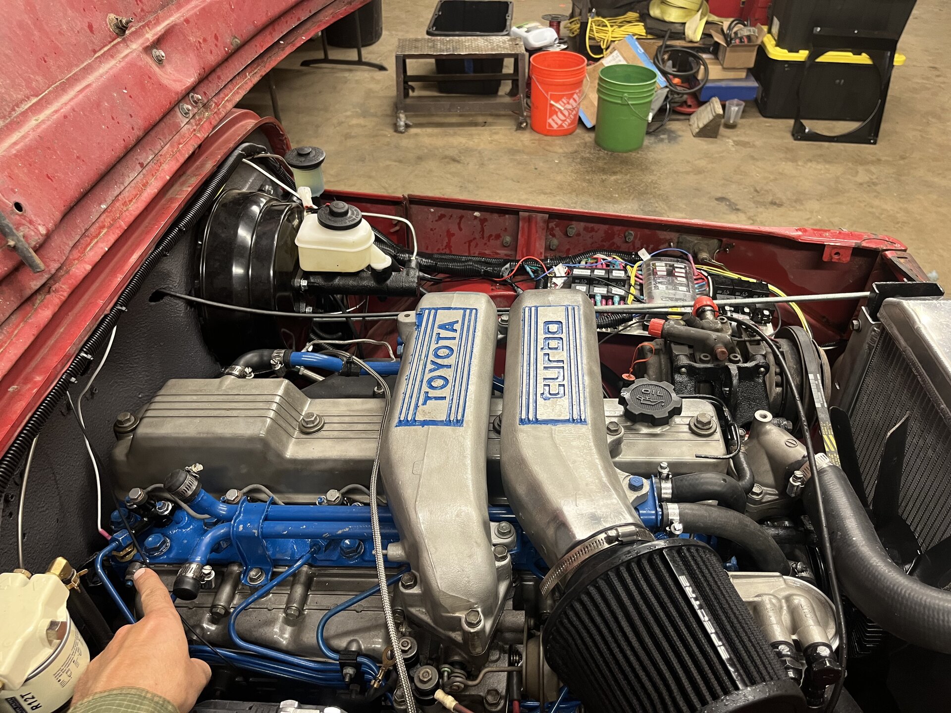

Hey guys. I mounted my temp sensor here on my 12HT (swapped in a 40).
I’m getting idling temps of 185-190F and driving temps (flat ground, 2000-2,500rpm) of almost 210F.
Do you think it’s the sensor location? Thoughts?
