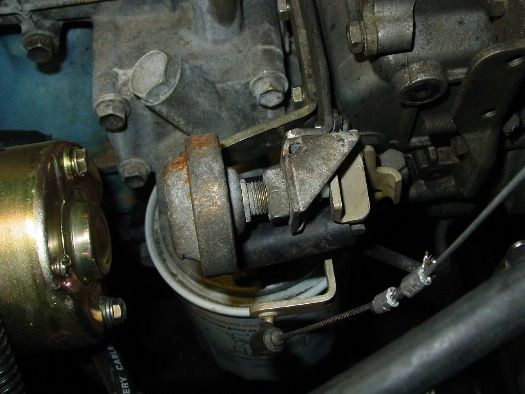

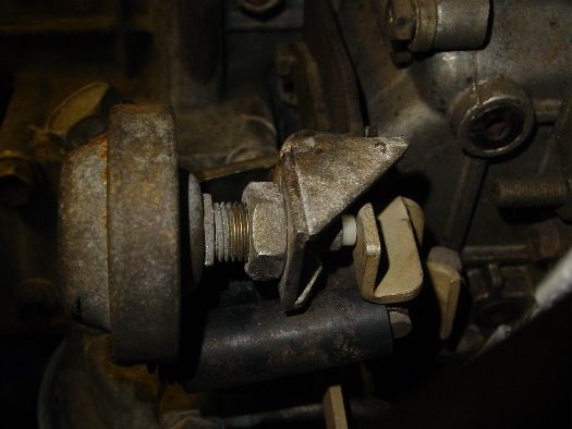

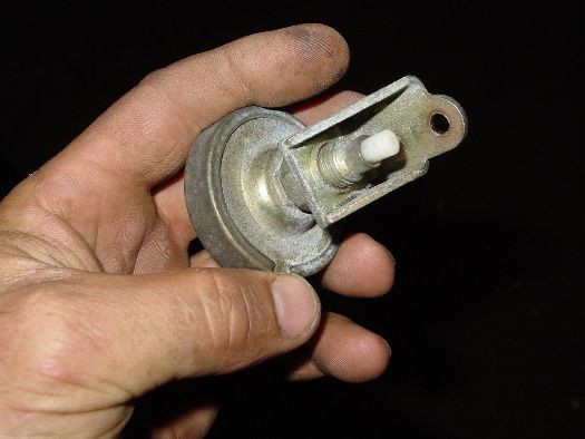

I have a 2H which also had a very twitchy throttle. I solved the problem by fitting a throttle damper to the side of the injection pump using a simple bracket I fabricated. The throttle damper is a part I raided off a Mazda 323. Works like a charm and has been reliable for 4 years so far. No extra springs required.
so that acts almost like a shock absorber? my concern is its twitchy both ways.. if you hit the pedal too hard it jerks and if you let it off too fast it jerks.. it has been covered in many a thread before that this is a common problem with the DI manual toyota diesels but there must be a way to make it more bare-able off road with out always resorting to the hand throttle.
