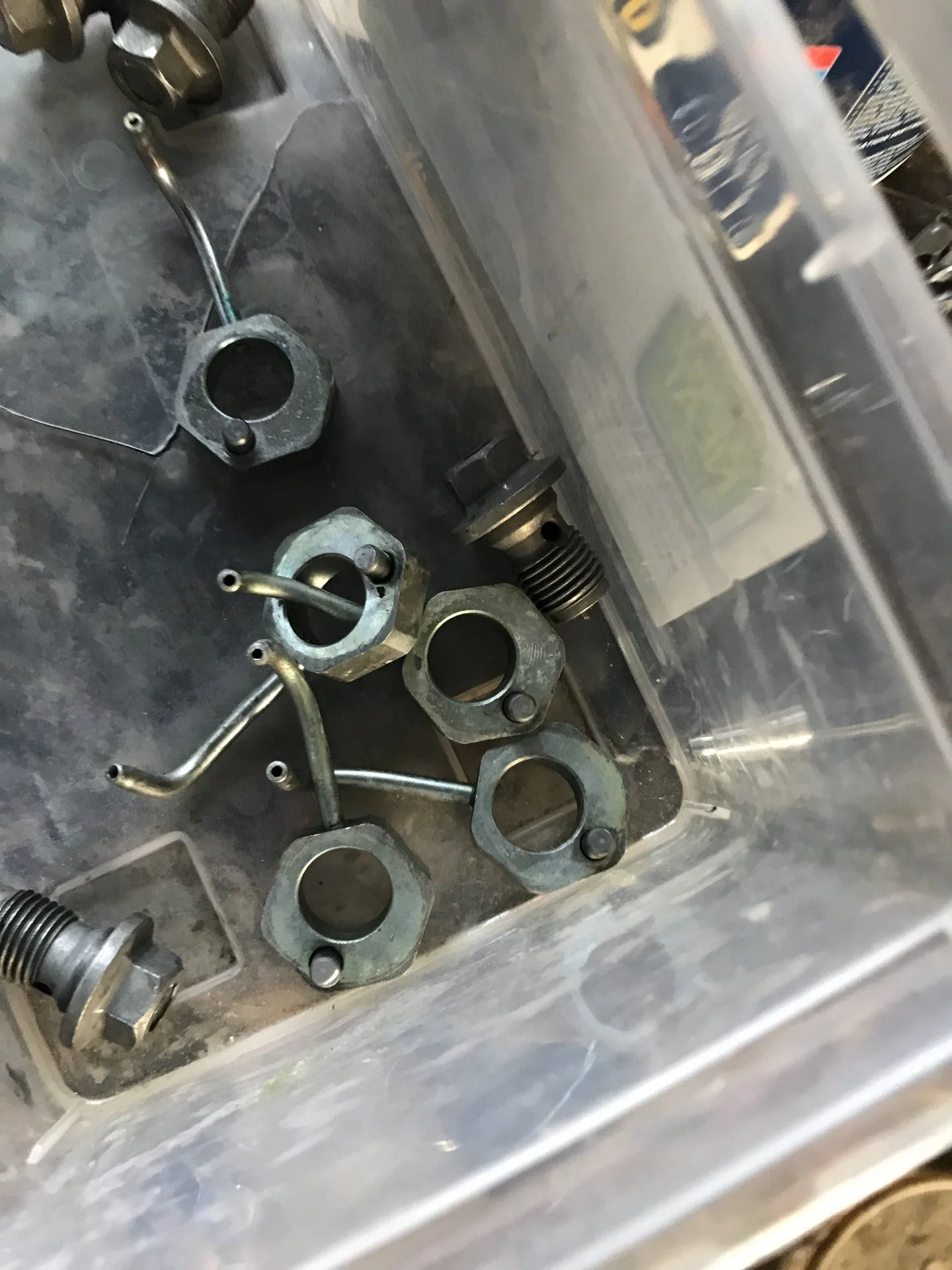

Currently rebuilding my 12HT from my HJ61 and have run into an issue with the oil squirters, in particular the dowels that align them.
Somehow from the process of strip down at home to packing everything to the machine shop, and back home again, I've lost 3 of the dowels, 2 are damaged and 1 is... okay.

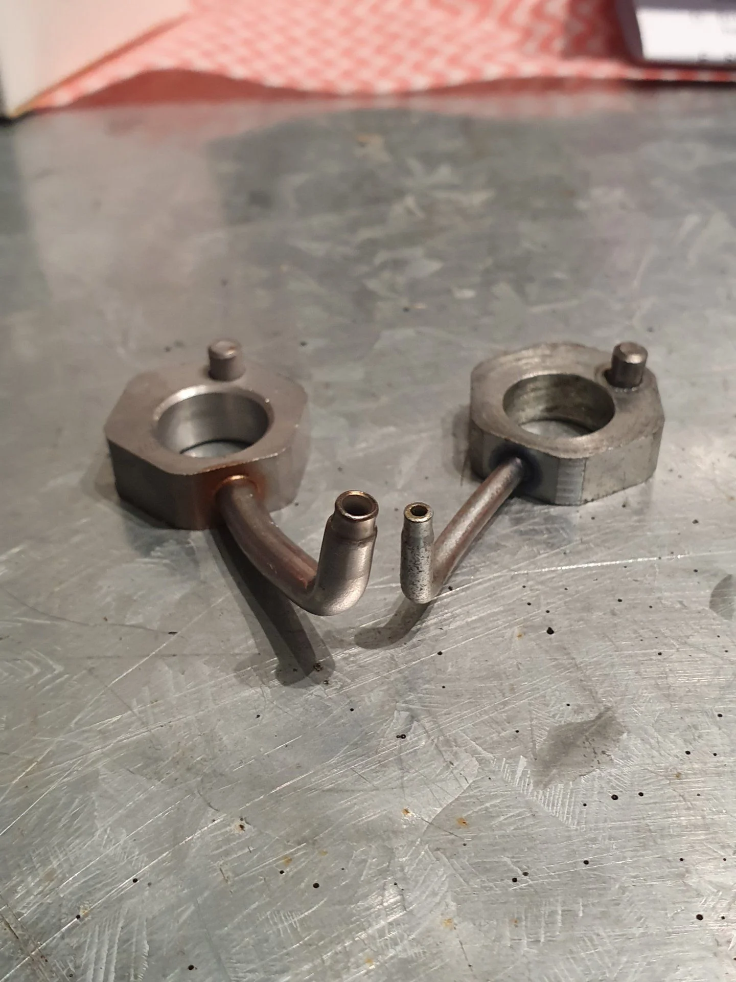

Not wanting to risk making my own and having them end up flying around with my crank... I decided to buy 6 new 1HZ/1HDT oil squirters.
They aren't the same however. The actual base is the same, and the dowels appear the same, but the nozzles are much larger.
I'm worried i'll run into oil pressure issues if I end up using these squirters. I can't just use the dowels because then i've spend $150+ on 6 tiny dowels...
Can't seem to find anything online for 12HT specific squirters.
Wanted to hear what you guys had to say and if anyone had any great ideas.

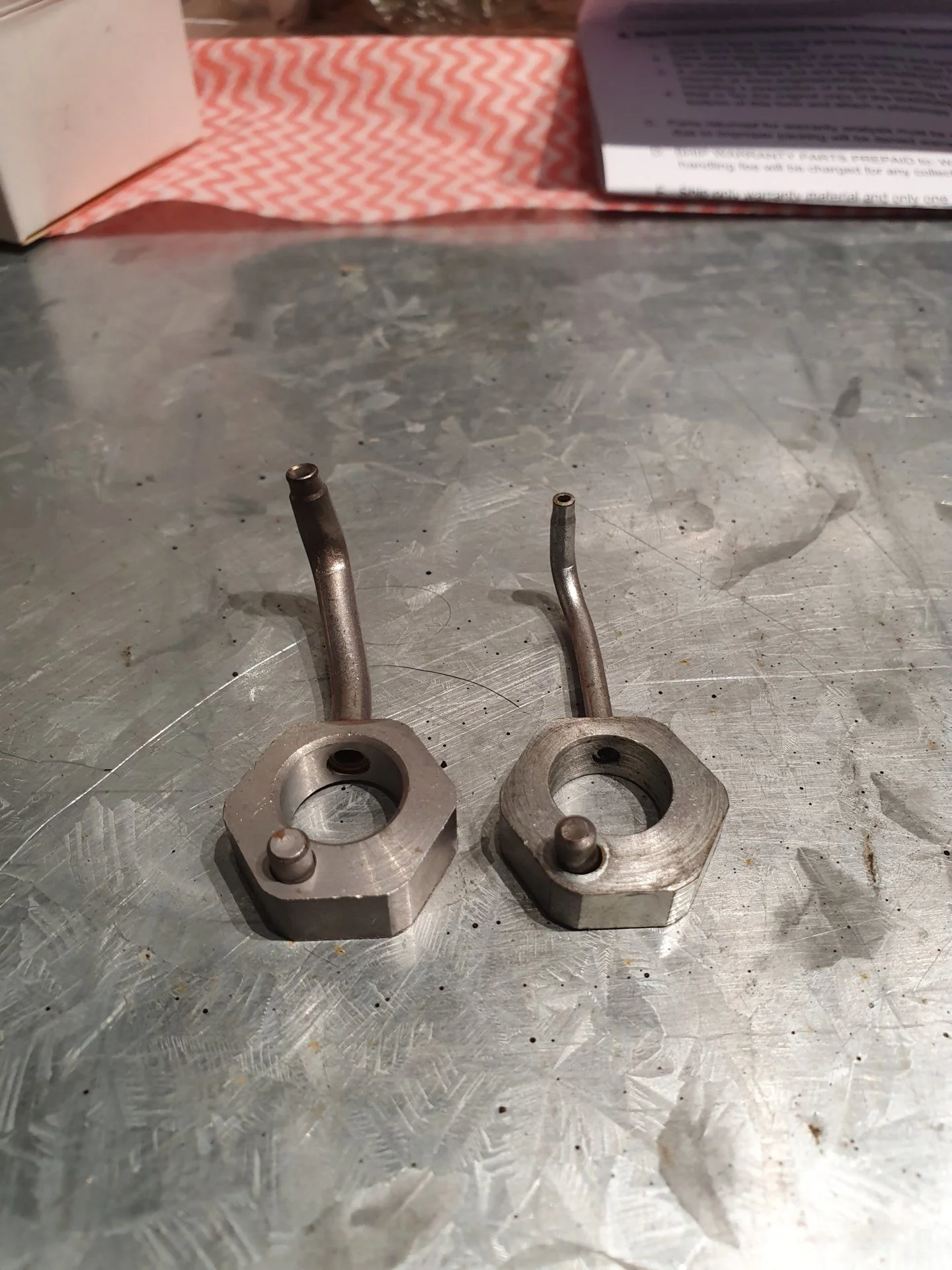

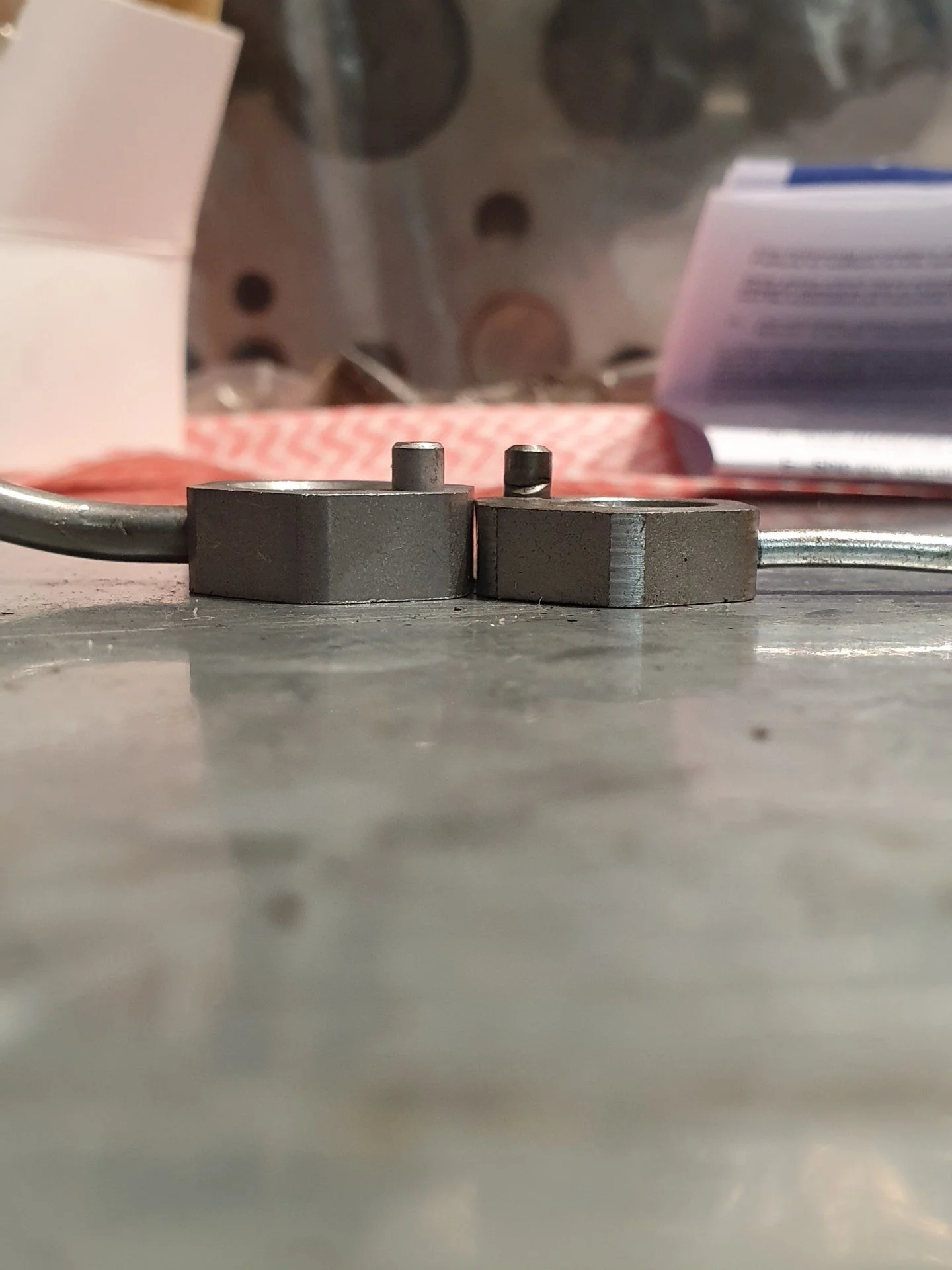

In your pic, it looks like they are different size?

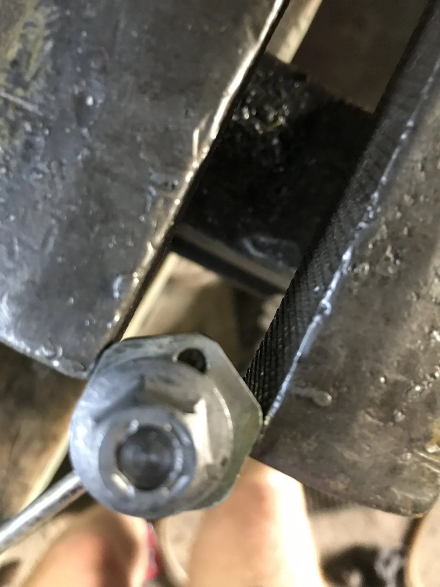

I hope you did not go out and buy anything, and I hope you can get your money back for the HZ squirters. Firstly the dowels can’t drop back into the sump, the bolt flange is too big to allow that,
So get yourself some cheap 4mm drill bits and cut the shanks to suit, the cheaper the better.
