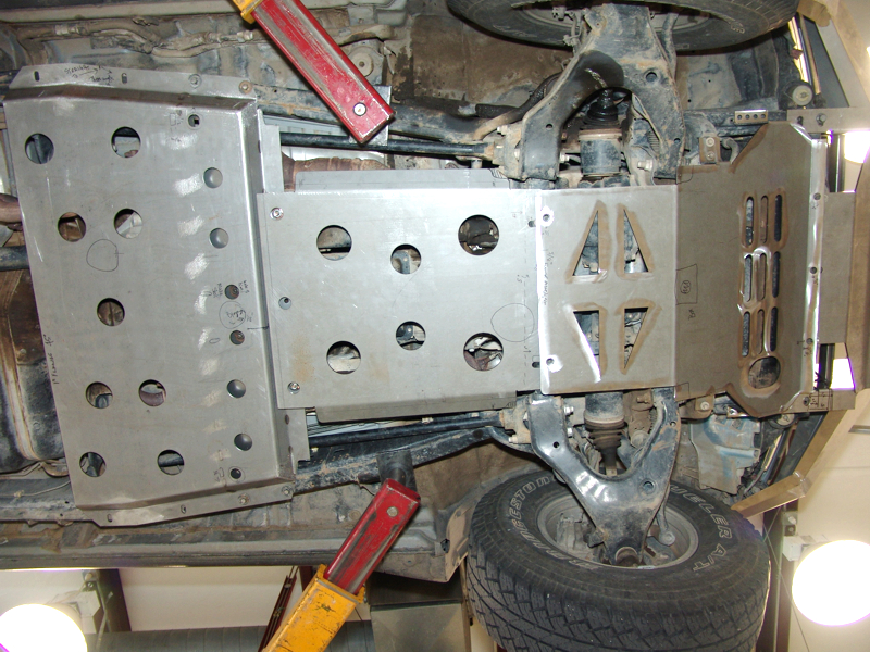

We have the skid plate system prototyped. The rear belly plan is complete and ready for production, the center plate close, but the front one needs a little work. Will update when we are ready to ship.
How thick are they, and what are they made of?

3/16", is that the same as the TC skid plate for the 80?
let's see pics of the tests. You know, where you drop it on a rock and stuff...! :D
Christo,
Will that front skid integrate with any bumper or just the Slee front bumper? I can't tell from the pic if it can be connected without the Slee front bumper attached. Just wondering if it can be installed with an ARB bumper.

What about installation with your diff drop, will that be an issue, or do you just use the spacers?
Access to the oil drain plug and filter? (I assume these are some of the holes that I see in the pics)

80 skid plate is 1/4" but mostly since it is not supported around the edges.

There is pictures of LexusBen testing it in Moab somewhere here.

The front terminates on the cross member right in front of the radiator, just like the factory skidplate. So any bumper should be fine.

It is designed to work with the diff drop. For those that do not have the diff drop, they would need to make spacers or buy the diff drop :D We figure that if you are needing skid plates, your truck is probably lifted.
Access to drain plugs are designed into the plates where we can. The big hole up front is for the oil-filter.
