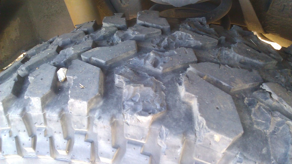

I was wondering if I am alone on this or not. I have been getting some tearing and chunking on my tires and I think it's due to the tires spinning over rough and rocky terrain. I'm also someone who is very, very gentle on the throttle. I try to avoid wheel spin, but sometimes you can't and actually need it for A-trac.
I don't believe the tires themselves are entirely at fault. I'm thinking its due to the characteristics of the 100 series to constantly lift its tires and the A-trac needing wheel spin to operate.
Anyone else experience this?

Possible contributing factors
Hard rubber compounds for long pavement tire life tend to chunk
Too high air pressure contributing to stiffness of tires
Too stiff suspension - tire lifts and spins on sharp rock
For part-time 4WD- 2 WD on steep rocky climbs will lead to rear wheel spin.
Too much throttle - going too fast
Too much weight -
Often hard to avoid.
Where are you wheeling? Up in Big Bear? I know they can have some sharp granite up there that will chew up tires regardless of what kind of tire or driving style. I haven't wheeled in Idyllwild, which is closer to you, but having been up there often and hiked, the material up there looks like it can do the same damage.
Although as noted above, airing down and having a very gentle touch on the throttle will help save the tires.
One last thing: was all that damage done on one trip/day??

Yeah...Big Bear, Calico, Death Valley, etc..
I usually air down to 20-22 psi. Maybe I should try lower, but I usually am loaded with 3-4 adults and lots of gear on trips.
My tires have probably 12K+ miles on them. The damage has slowly appeared after almost every rough off-road trip, not in one day.

We live in San Clemente, just north of you and my wifes Hundy with BFG A/T's eventually looked that way too by the time they were done. I'd say that's about normal, perhaps a little on the hard side. We wheel in a lot of the same areas too.
Airing down depends not only your vehicle weight (and all the "stuff") but also your tire and wheel size. You can air down more if you have a narrower rim and wider tire. That's why it's better to get a 8" - 9" rim instead of a 10" - 12" widths. I am currently running BFG 35x12.5x17 M/T's on 17x8.5" wheels.
The tires are 245/75 Firestone Destination MT... notorious for chunking. The tires are about 7 years old and just recently started chunking like that. They're on a Land Rover Discovery which is a bit lighter than the 100 Land Cruiser that I have on 255/85s. Those still chunk with all of the sharp rocks out here, regardless of tire pressure

So I guess the Coopers are of a softer compound than the BFG and Nitto tires alot of the 100 Series folks are running on their rigs?
My cousin who runs the same trails as I with a Wrangler TJ and BFG KM2 tires has no problems with chunking. However, he rarely ever lifts a tire or has wheel spin. Plus it's much lighter too.
yep tires.....no such issue on mine and not that gentle on her....softer compounds and lug design have impact on chunking.
