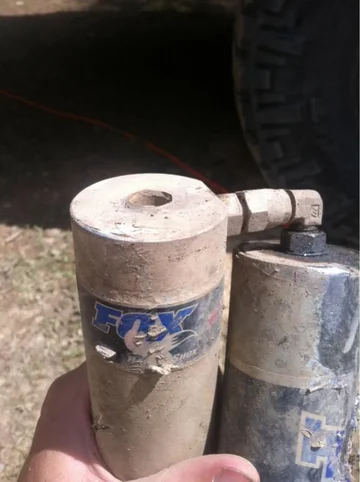

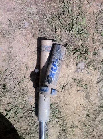

Broke a rear fox 2.0 piggyback. Was used when I got it Nd has endured 2.5 years of hard use. Wasn't really right for the application.
Looking at the 2.5" Fox when they come out, Slee, or King......
You just discovered the problem with pin style upper mounts
Would a pivot unibal style be better for the application, like my Slee fronts? That has it's own series of issues like more maintenance , play and noise but seems like it would take nearly all the stress off the joint.
Note, Slees rear's and indeed his new fronts do not have the uniball. He was receiving too many complaints.

Jon2 hit the nail on the head. The pin style is fine for OEM like suspension articulation but once we move to "L" shock territory, assuming properly bump stopped, etc., the additional angle at either limit puts additional strain/side loading on the pin mount.
If you are capable of cutting and welding one could replicate what I've done for the rear shocks. Its certainly not a 1-day dealio but I've been 100% pleased with the results. It permits eye style mounts for the shocks, moves them to the rear where they are much more protected from gravel spray, etc.. While you're at it...might as well throw in a real rear axle system :D
My original Fox shocks had a #8 size spherical bearing for the mounts. They would have been fine on a Prius :D but I had Glenn make my Radflos with #12 bearings and they have proven reliable and maintenance free for 2-years. One of these bearings has just the slightest amount of play...but at ~8klbs and too many miles of fast trail work to recount I'm perfectly fine with it. The #8's only would last 4-6 months!
