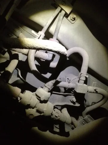

Do you have the Charcoal Canister in that location where the spare tire goes?
i'd have to check. It's close to midnight here and pouring with rain, but happy to check.
Where is it if you're looking at the tailgate from the back (left vs right) and then if i crawl under it will the spare block my view? I always thought my cannister was under the hood/bonnet.
Sent from my iPad using IH8MUD
For a non-US-spec vehicle your canister is likely still under the hood/bonnet. So you are probably fine in that regard. But probably a good idea to check anyway. On our trucks, it is located above the spare tire (right where the subtank would go) on the left side (driver's side for us). You can't miss it if it's there.
ok. soaking wet now!! no there's no cannister there. There is what's look like where two fuel lines come together.
I took some iPhone pics but i'll see how they turn out before i upload them.
edit: no i meant i'd crawl under there to help you guys install it as an Oz spec LC i have the two tanks already. The flash ruined the pics, so i'd need to take anything in daylight hours on a hoist.
one photo actually worked, but it's hard to see what it is without seeing it in place.
Thanks for checking. I guess I can ask about getting the charcoal cannister too but I think its going to get complicated and run up the costs.
98-02 U.S.-spec 100s do not have the charcoal canister back there, and you can add a sub tank without problems. It's only us unfortunates with the later trucks...
