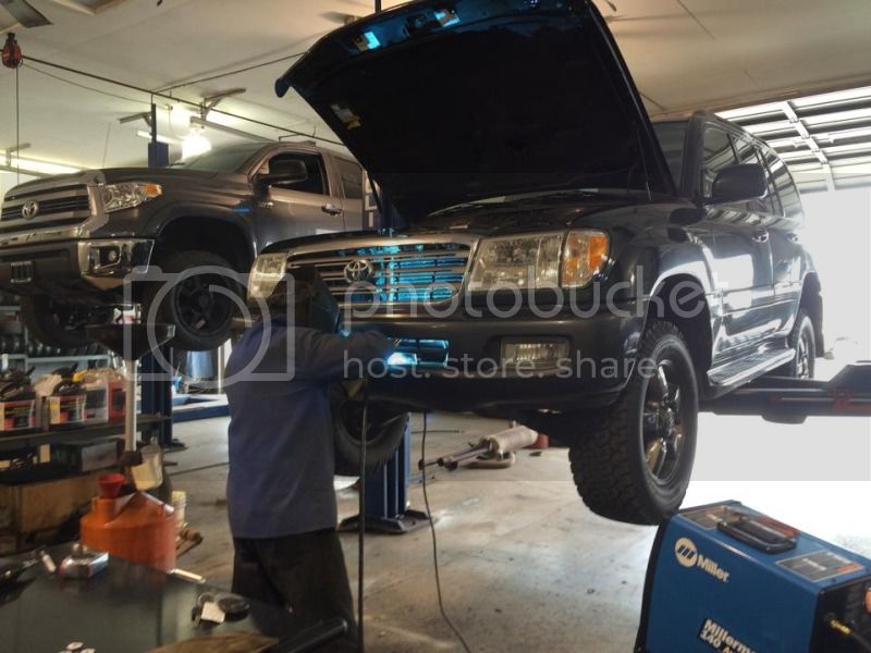

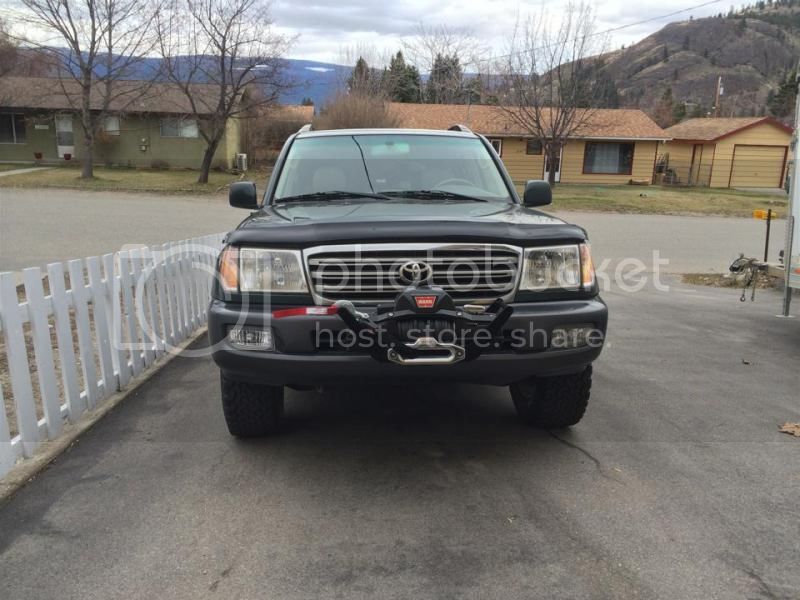

Hi guys, I have been scheming about this for over a year... If you want to keep the stock bumper cover it's very 3-dimensional. I keep working on other things...
^probably doesn't matter(?) sounds like it got chopped anyways, since it was welded to the frame or bumper mounts

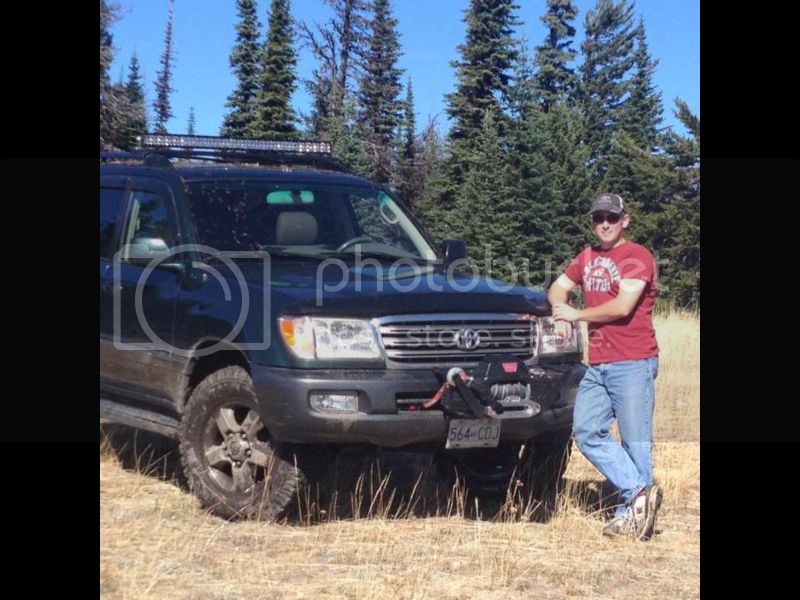

Cool! does this mod requre relocating the front license plate? I read somewhere where someone was talking about putting a hinge on the license plate to hide the front reciever. Any other pics of the installed hitch without the winch attached?
Licence plate fits fine below with 2 self taping bolts

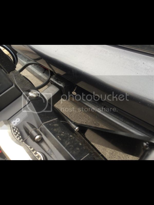

hello do you have any other pics of the hitch and the weld points attachments to the frame?? thanks
Pretty cool. So you cut the bumper cover reinforcement in the middle, and then welded the hitch receiver to the front crossmember?
I noticed your photos looked like it was being welded on in the truck, could you get a better weld on it by taking off the cover or was it pretty simple to access with the cover on? Have you tried pulling on it yet?
@TXLX100 look at posts #6982-6983 in the main photos thread and it shows him using the winch
