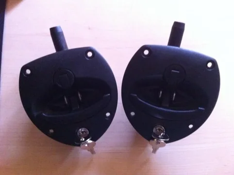

UPS came today. Yes they are keyed the same.
275021-90 http://www.allegiscorp.com/DisplayP...mp_4.jsp&cat=Single-Point+Compression+Latches

I've been at a standstill... Trying to get wood shop time. I've been working out mounting details, ordered and received latches, designing locking storage and sub woofer positioning.
