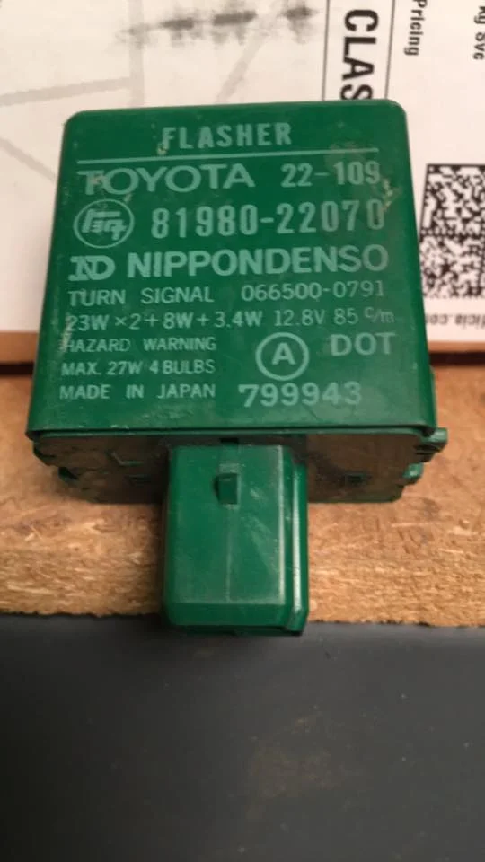

FJ62 flashers cannot be converted, you must use a pre 88 flasher from a 60 series. I have heard mini trucks of that time period pre 88 may also work but don't hold me to that. This has been documented in the 80 series forum but for those who do not frequent it here you go:
FJ60 Flasher P/N 81980-22070. It is green and rectangular compared to the smaller square black FJ62 one.

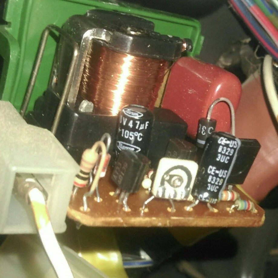

You carefully pop the cover off and I used needle nose pliers to bend the resistor back and forth until it came off. There is no de-soldering or technical work needed. The hardest part was getting under the driver's side to carefully unclip and remove my stock flasher using two small screwdrivers.
I found the flasher for $10 on eBay but there are many other ways to skin this cat. I like the stock looks and the way it clips back into the board.
I robbed this first picture from the 80-series forum.
Thanks. I'm using a aftermarket flasher that's a little faster than I like. Almost made one with a variable resistor but have better things to do with my 60 at this juncture. But I'm gonna go right home and do this!
Went ahead and installed a 1.2M variable resistor in that spot.
Original resister was a 160k ohm. Setting the pot to 240k produced a nice even duration on/off flash. Higher ohm made off interval longer.

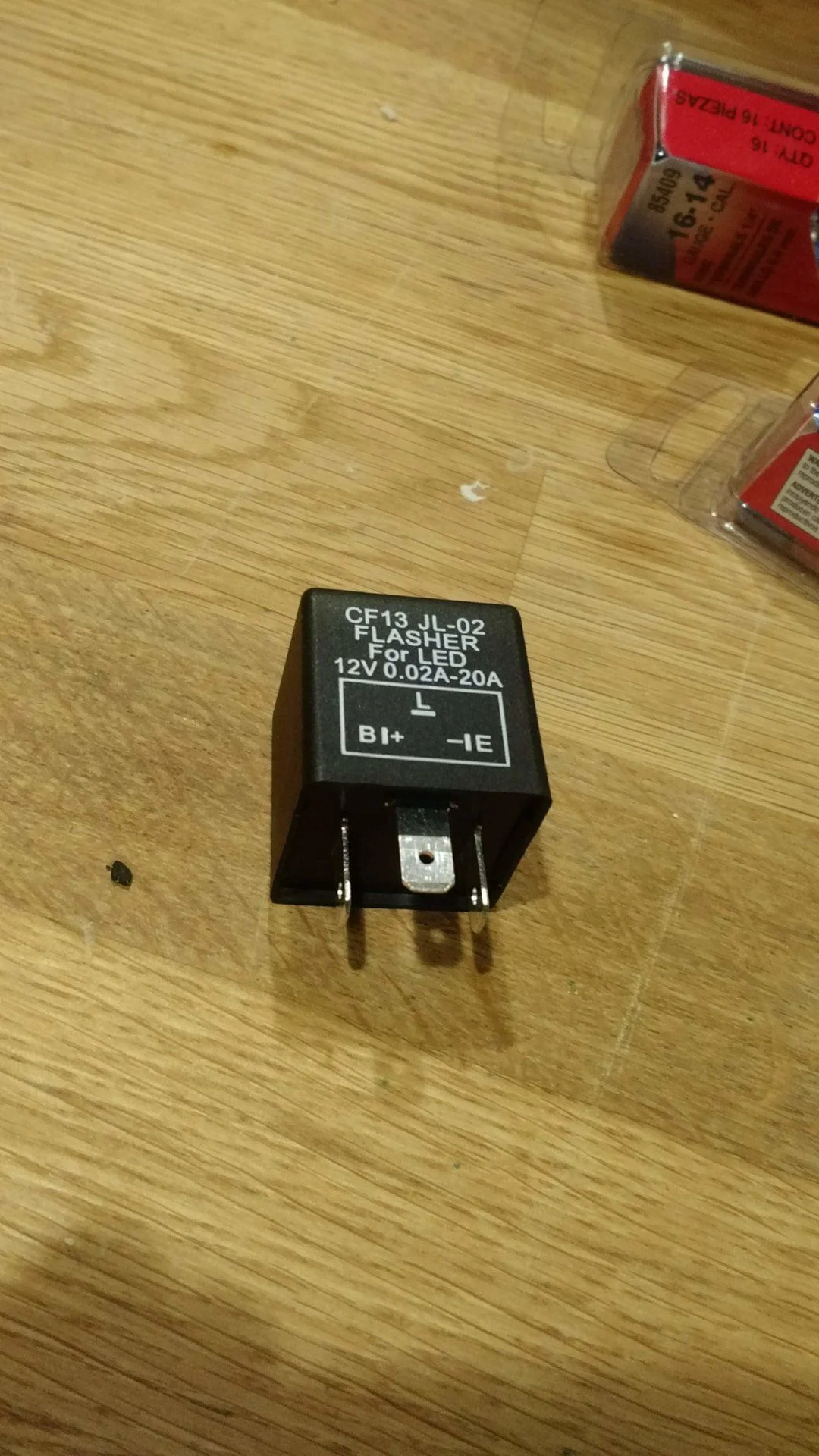

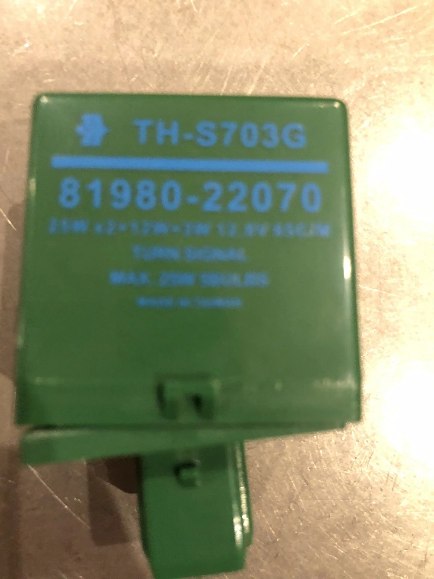

I have the flasher that I got off eBay. Which resistor do I remove? R1 or R2?
Your flasher is not like the ones above. What’s the part number on the housing? Is the housing green?
81980-22070
The new aftermarket one is electronic, not mechanical like the old toyota. See if it works with LED without modification
Will do. I get the 60 back next week. Will report back.
Yea, that’s an aftermarket flasher. They look similar at first glance. Almost did the same thing when I ordered mine of eBay. Keep us posted of it works
View attachment 1851468 Went ahead and installed a 1.2M variable resistor in that spot.

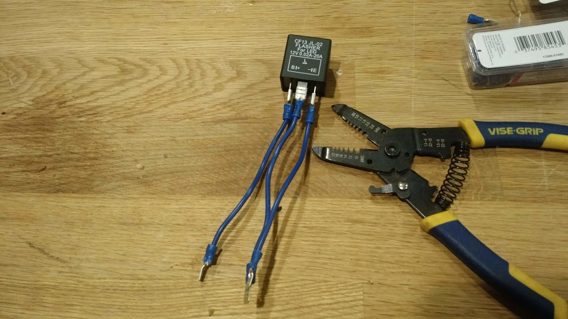

I bought this flasher and rigged it up for my 62. I still have a spare one. Works great with my superbrightleds.
If someone wants me to rig up the connectors and my spare I’ll sell for $10 plus USPS.
