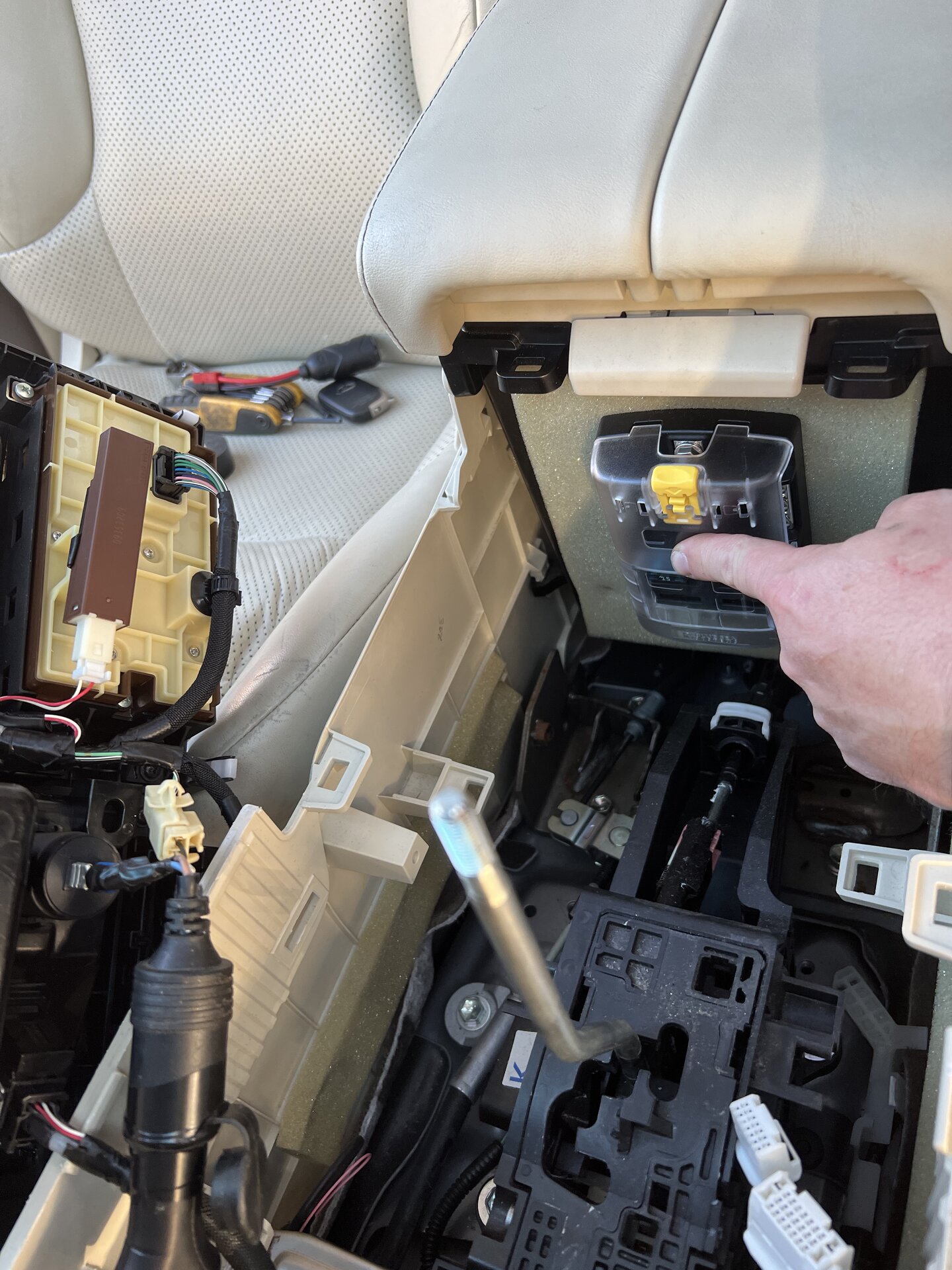

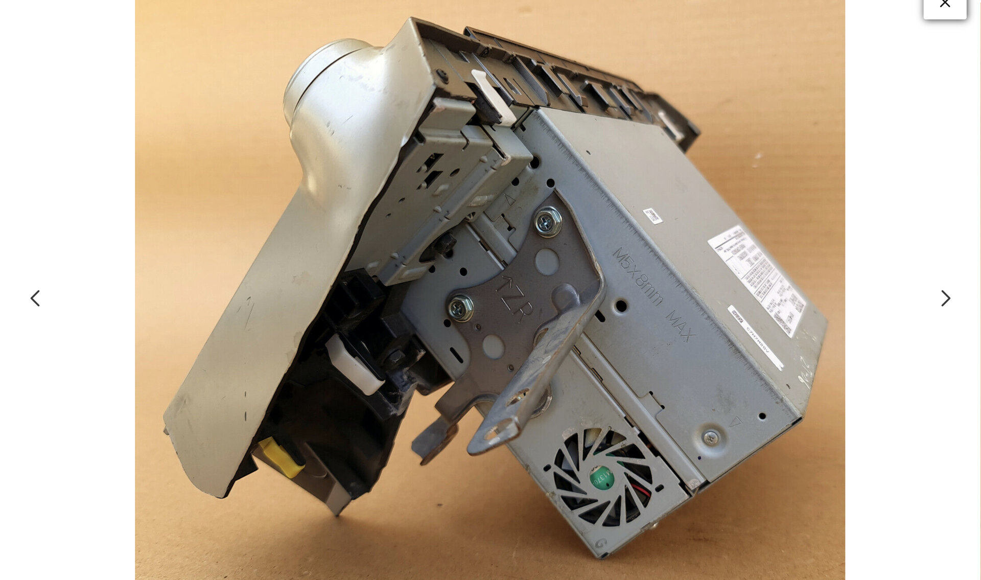

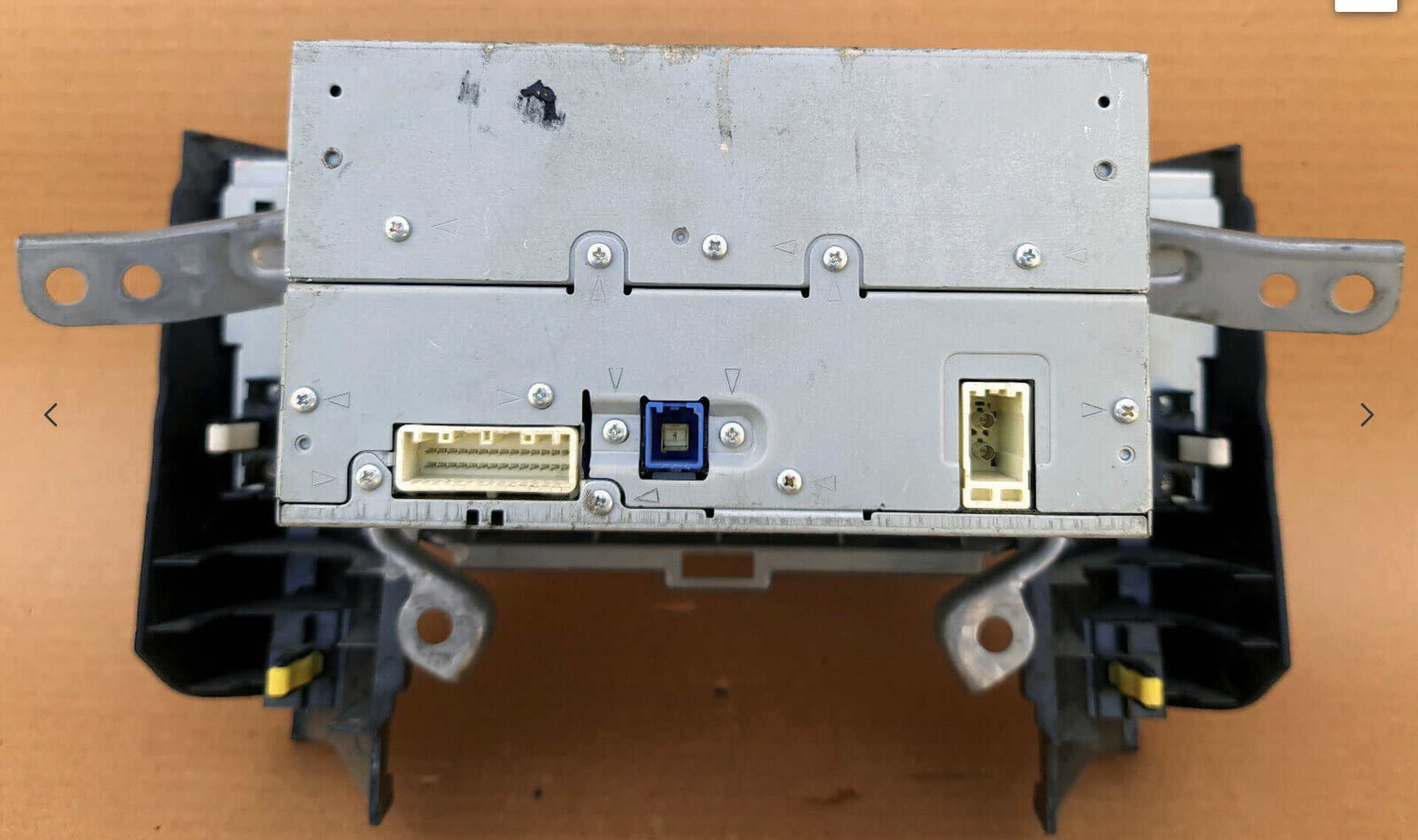

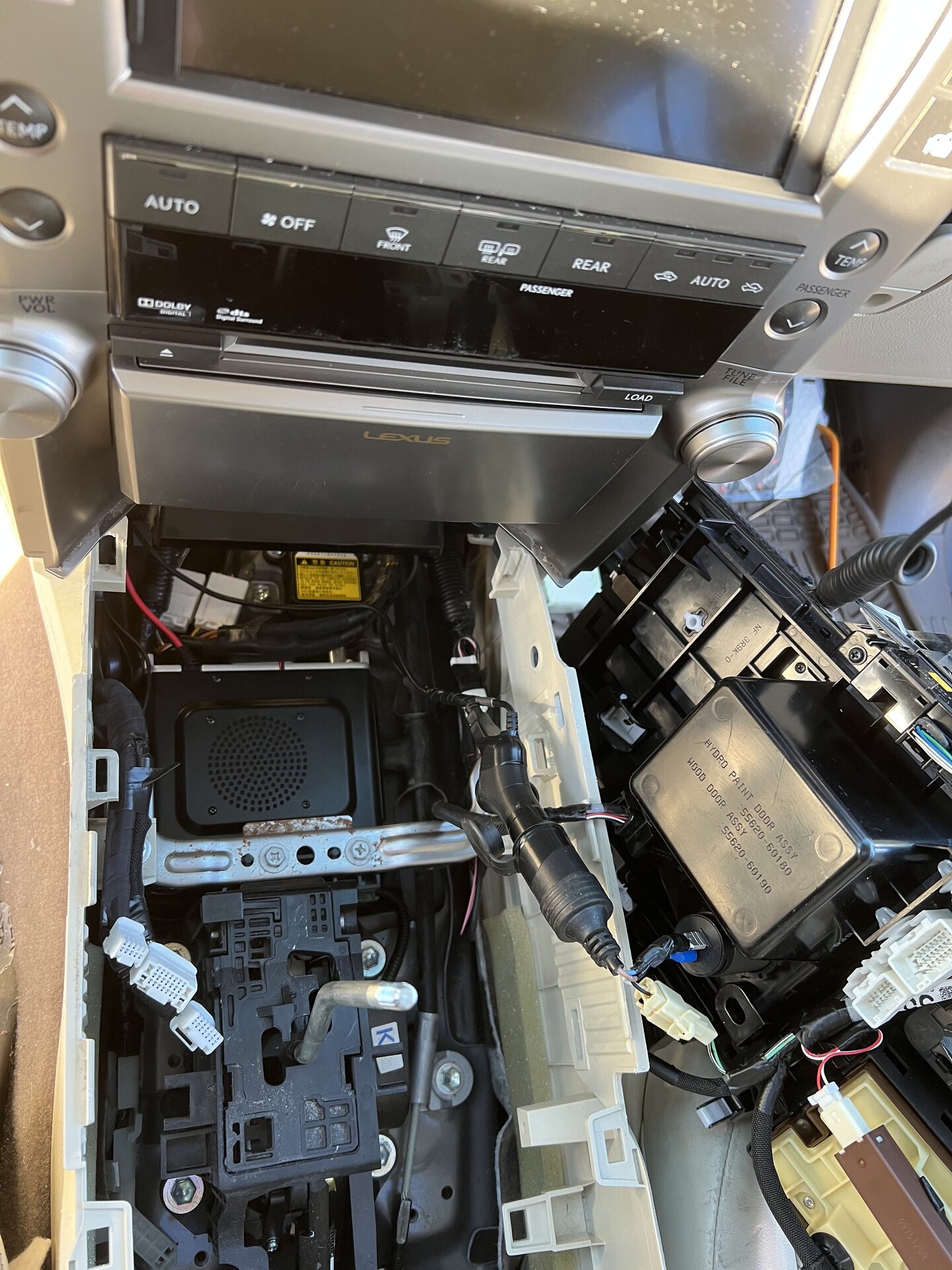

View attachment 3223570View attachment 3223572
No idea on effect.. I don’t recall anyone trying
This is all removed with a Tesla screen install but don’t know effects of missing changer with just stock setup.
It’s hard to tell from the pics but are the volume and tune knobs part of the cd changer?
To answer my own question…..
Removing the cd player disables ALL of the media systems including AM, FM, Xm, Aux and Bluetooth. That being said it is possible to fit a small Ham radio (yaesu ftm300) in the center console under the Cd player/ “Ashtray” area. Also there is room to mount a BlueSea 6 circuit fuse block between the cup holder and armrest. That fuse block will get connected to the house battery as soon as I figure out where that’s going.
Forgot to upload the pictures.
