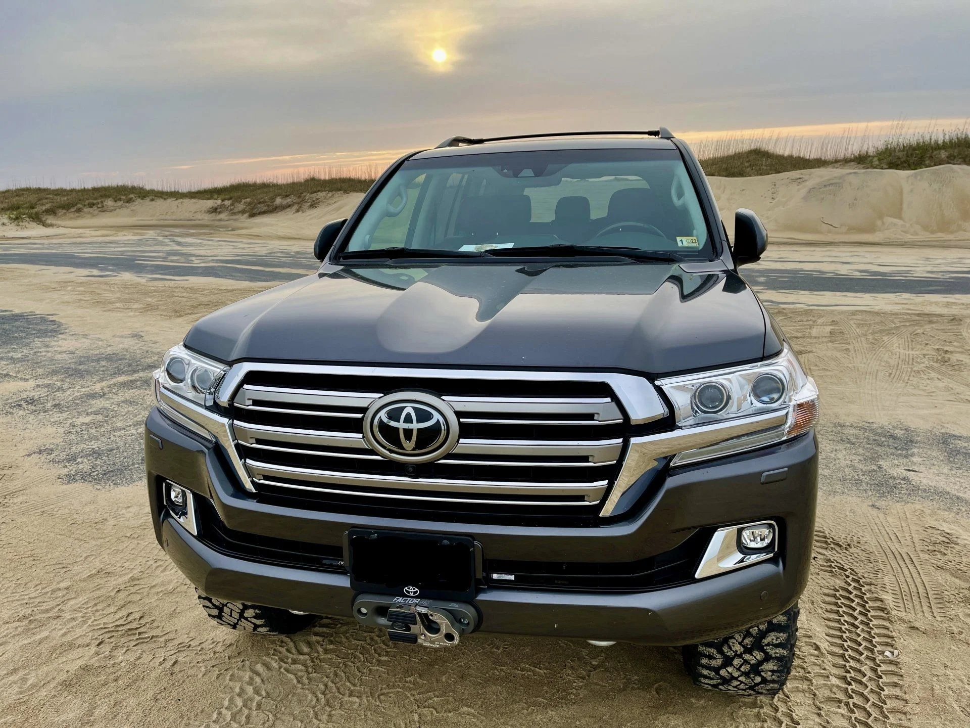

Great looking truck, by the way..

Love the pic ;)
