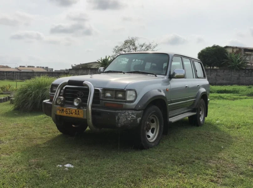

First time here and first time owner of HDJ80 !!!
- 1996 1 HD-T VX, 267 000 km!!!
I'm not a mechanic, but I will learn for sure. I'm located in central Africa and here, lots of the mechanics doesn't even know what a torque wrench is
and toyota dealership cost a fortune !!
So I would like to know your opinions on this Cruiser;
I bought it 2 weeks ago, and the Cruiser didn't get used a lot, sometimes up to 6 months not driven.
I did the oil change and timing belt and I intend to do the other belts and a radiator flush, plus change oil
of the transmission, transfer case and diffs. The driveshaft seals and transfers case seems to leak, so changing those soon too.
Yeah i know, what did I get into...eh...but here, the Cruisers gets used and Abused, so finding one with original paint still good and no dodgy mechanic in is rare !
So
There's a little bit of white-ish blue-ish smoke coming out of the exhaust at idle, and when you accelerate, there's quite a bit more.
There's a film of oil outside and inside the PCV hose and where it meets the air intake.
The intake hose inside is very oily and there's an 1/8" of oily sludge at the elbow where it meets the turbo.
The oil cap test is good, the cap is barely moving, but there's a bit of fumes/smoke out of the oil cap and dipstick.
So my research points me out on those;
-PCV hose and I need to clean all the air intake hose and put a catch can !?
-Or a turbo leaking oil !?
-Or Worn or bad piston ring !?
-Or worn or bad valve seals !?
-Or bad head gasket !?
Or is it something else ?? I intend to do a compression test today or tomorrow, as soon as I can find the fuel shut off valve...ahaha...
learning is a baby step procedure
Thank you All for all your inputs and IH8MUD !!!
I'm able to learn because there's guys like you !!!
