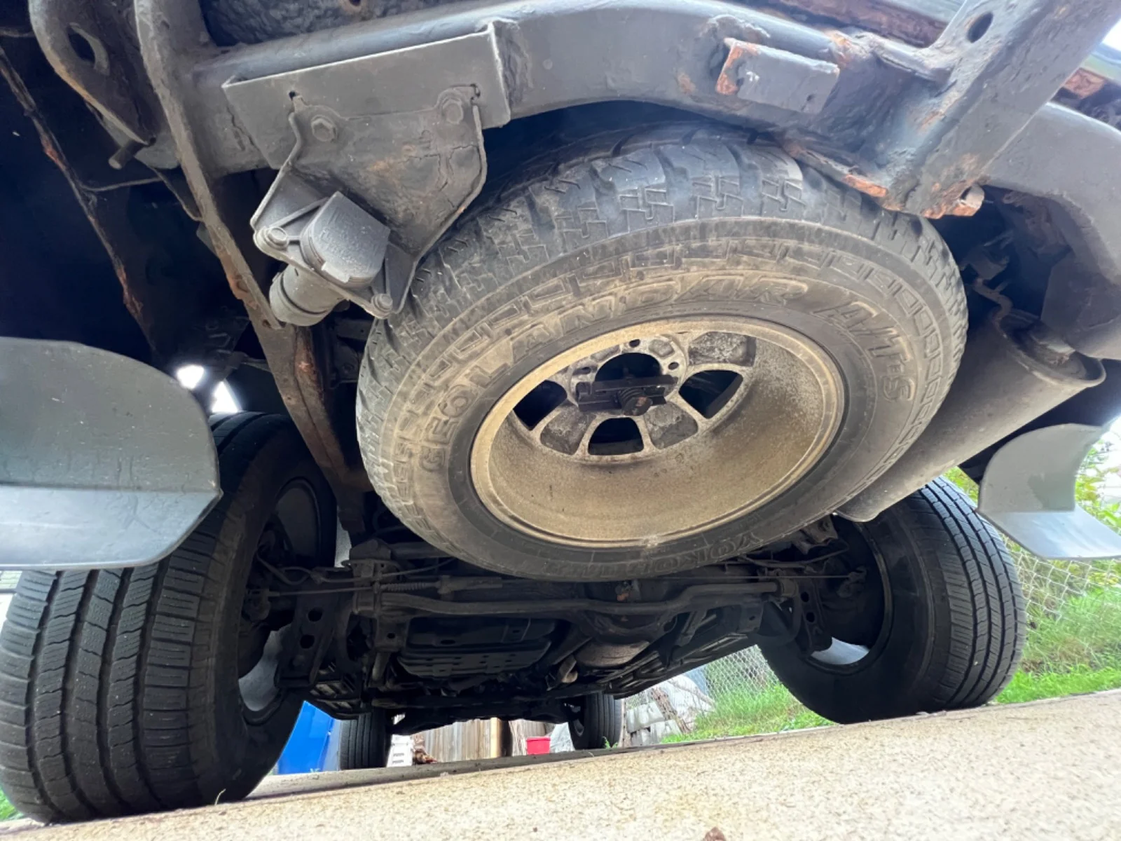

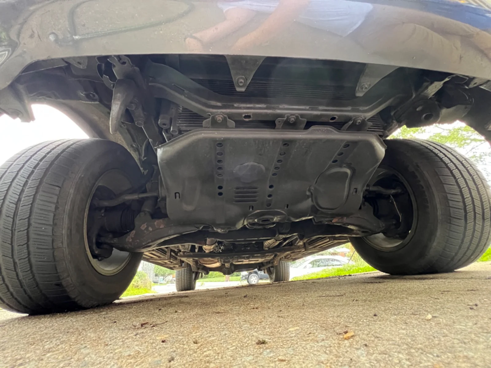

I am looking into purchasing an 07 LC, 173K miles. Fourth owner truck. I'm attaching pictures of the underside and the Carfax report - hoping you all could offer some advice on if it's a buy or a pass. Thanks.

Reaction to photos: Looks a little crusty, maybe painted the undercarriage black at some point. That's weird. Probably a NE car.
Checks Carfax: Bought in Ohio then sold to New Hampshire in 2020. Yuuup.
Depends on your level of rust comfort, but I'd pass.

doesnt look that bad to me, but some better pics would help. if there is any rust on any of the AHC lines or components, run from it
