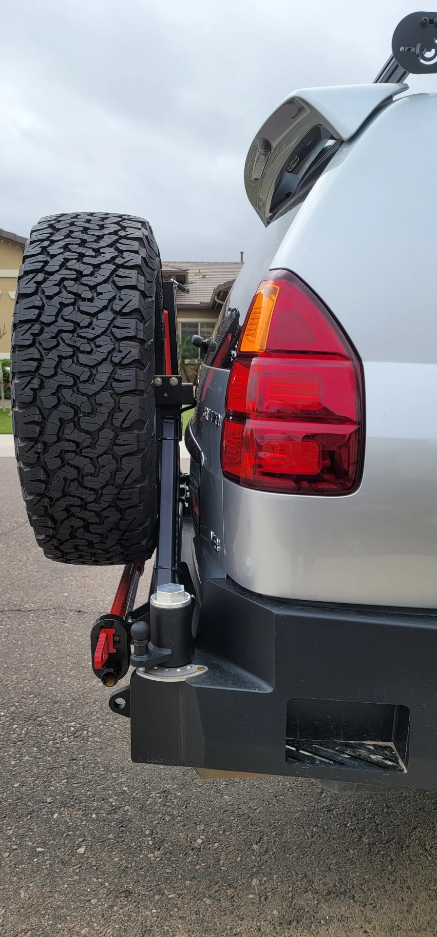

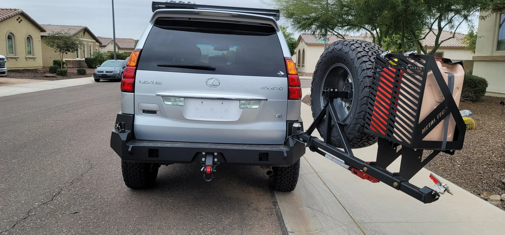

Thank you. I had looked at mods for the 4runner for a few years so I knew mostly what I wanted done. The rear bumper came sooner than planned because the bigger spare would not fit in the factory location. I figured if I was going to spend 1k on a tire carrier only I might as well get the full bumper. I needed the spare since this was the first summer of camping with my boy.

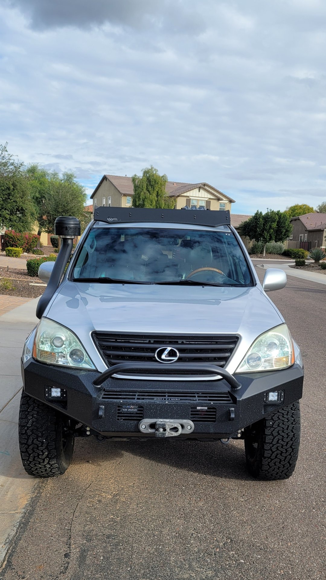

-Front bumper and snorkel

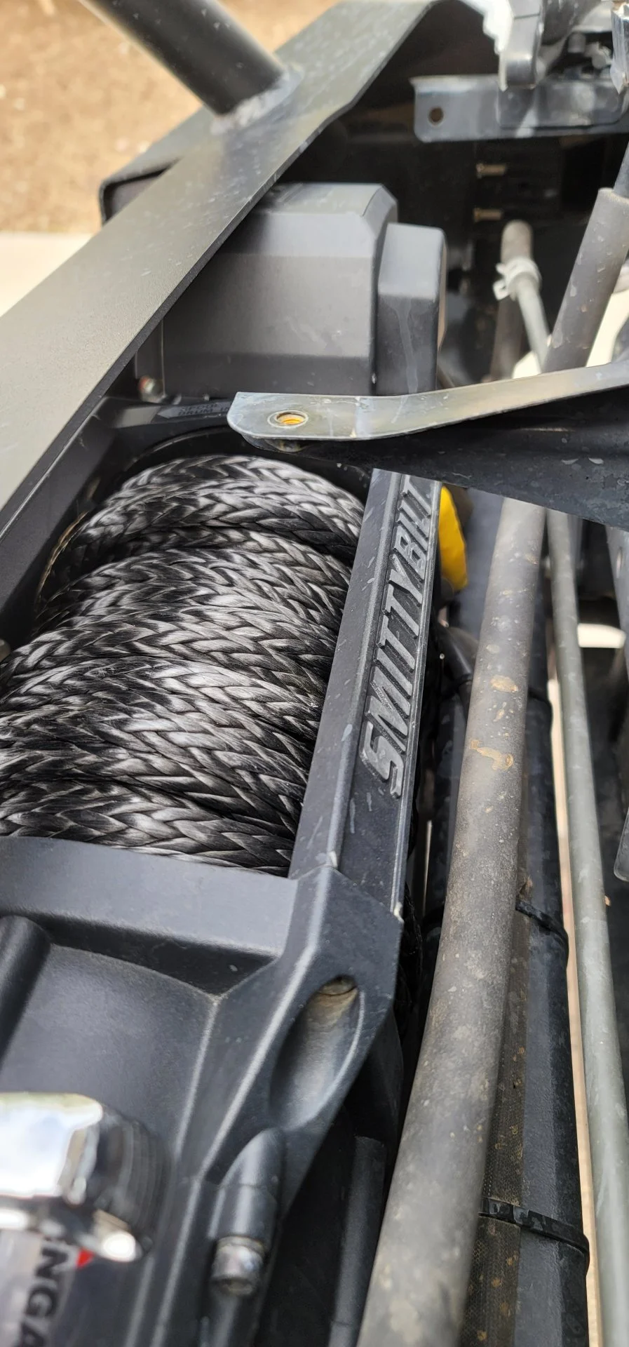

The front bumper fit nicely. The smittybilt winch just barely cleared with the solenoid moved to the side position.

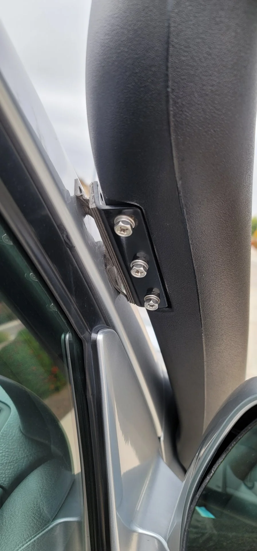

The Ironman snorkel fit great and the template was good. I just need to install the rivets in the pillar. I tried gorilla permanent tape and that did not hold up. The snorkel install was the hardest part of the build so far due to the lack of space to install the bolts that hold it to the body.

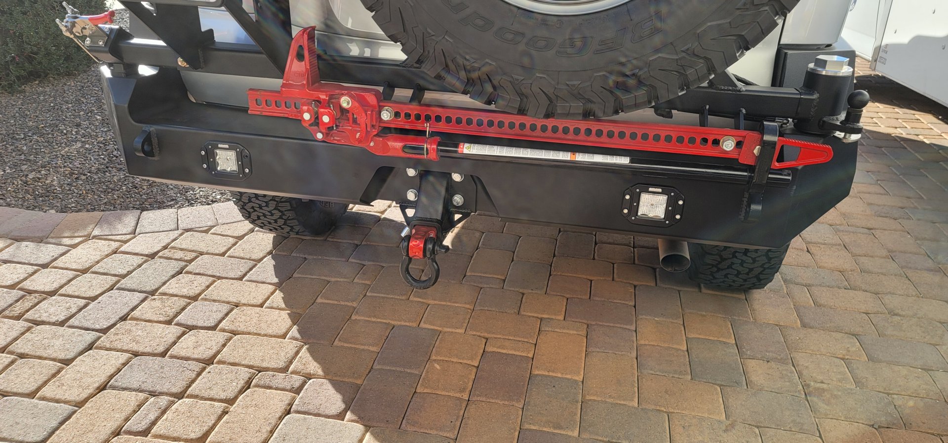

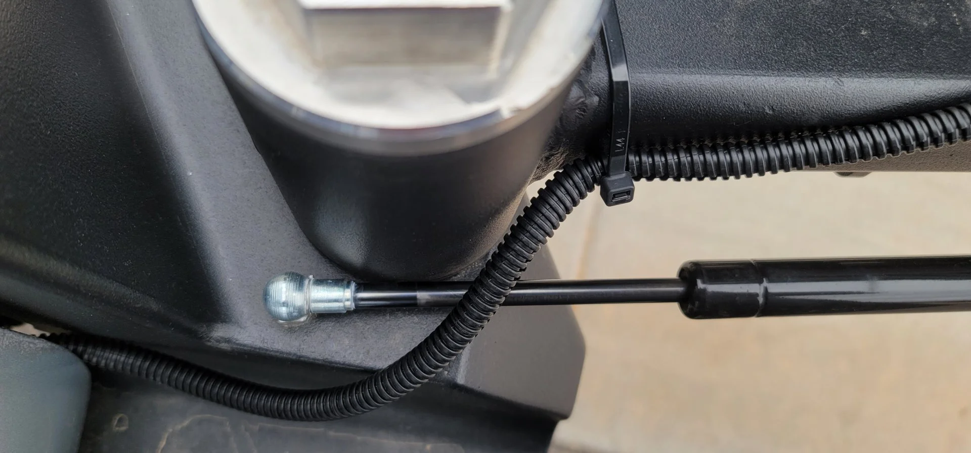

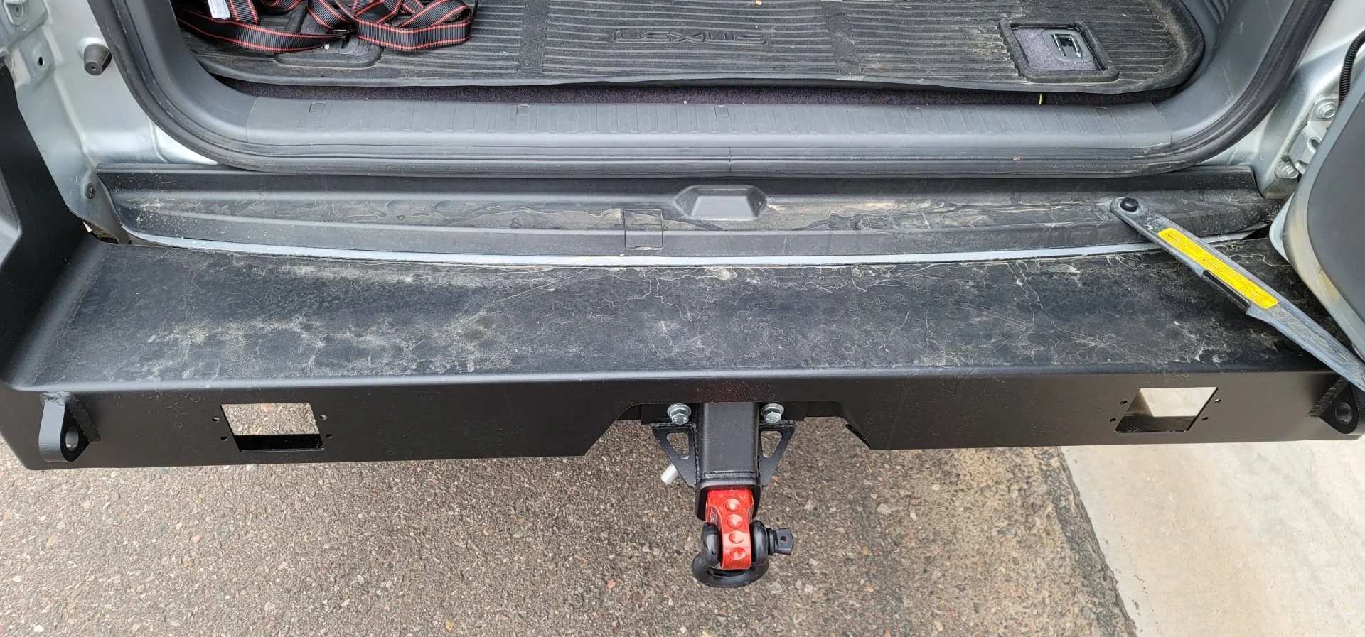

-Rear Bunper

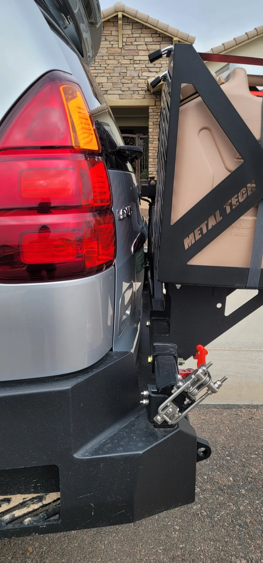

The rear bumper went on decent, just a little more work than the front. I did have manufacturing issues with the swing arm multiple times but finally was sent a working part. If you get this bumper make sure to order the $300 side wing supports. When opening the swing arm, the bumper had a good amount of flex on the sides with just the spare tire attached where it almost hit the fender. In my opinion it should be included with the purchase. After installing the supports it is much better.

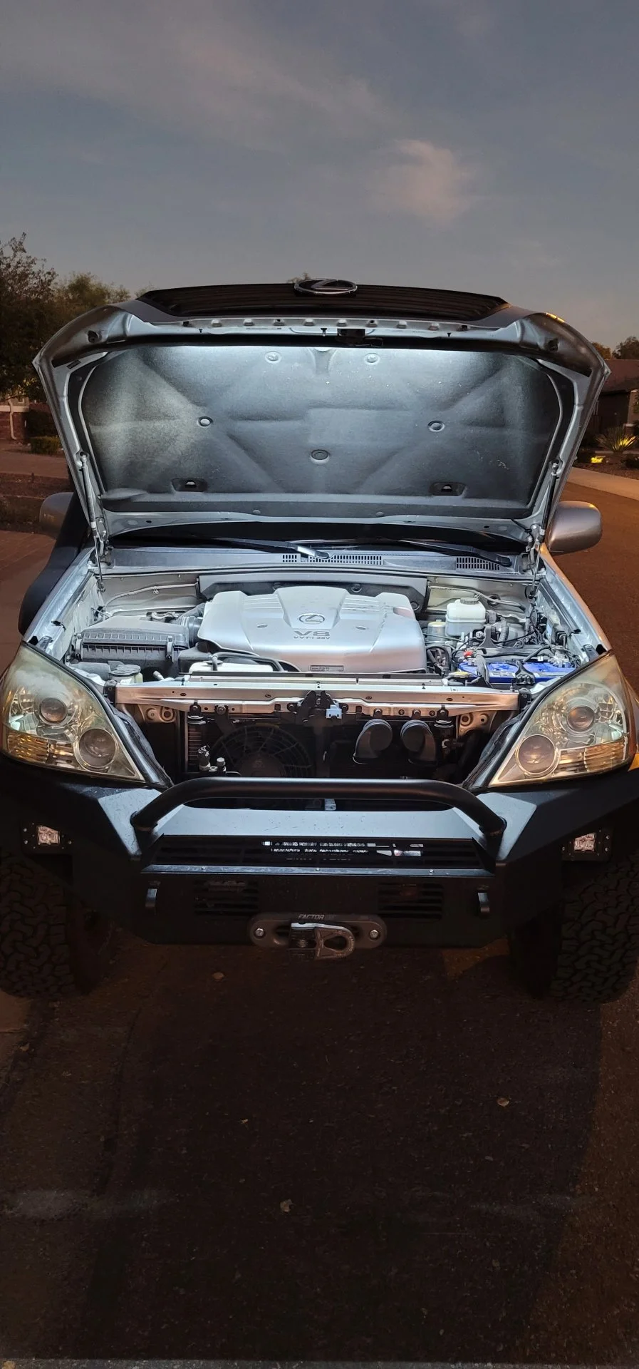

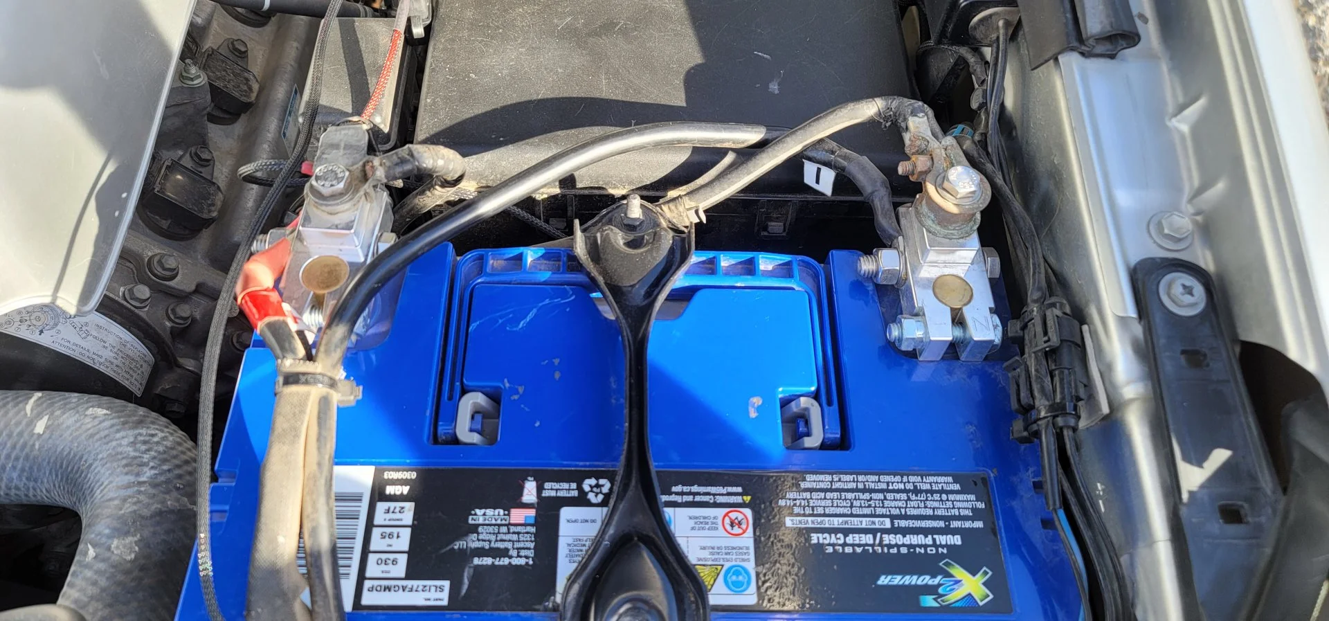

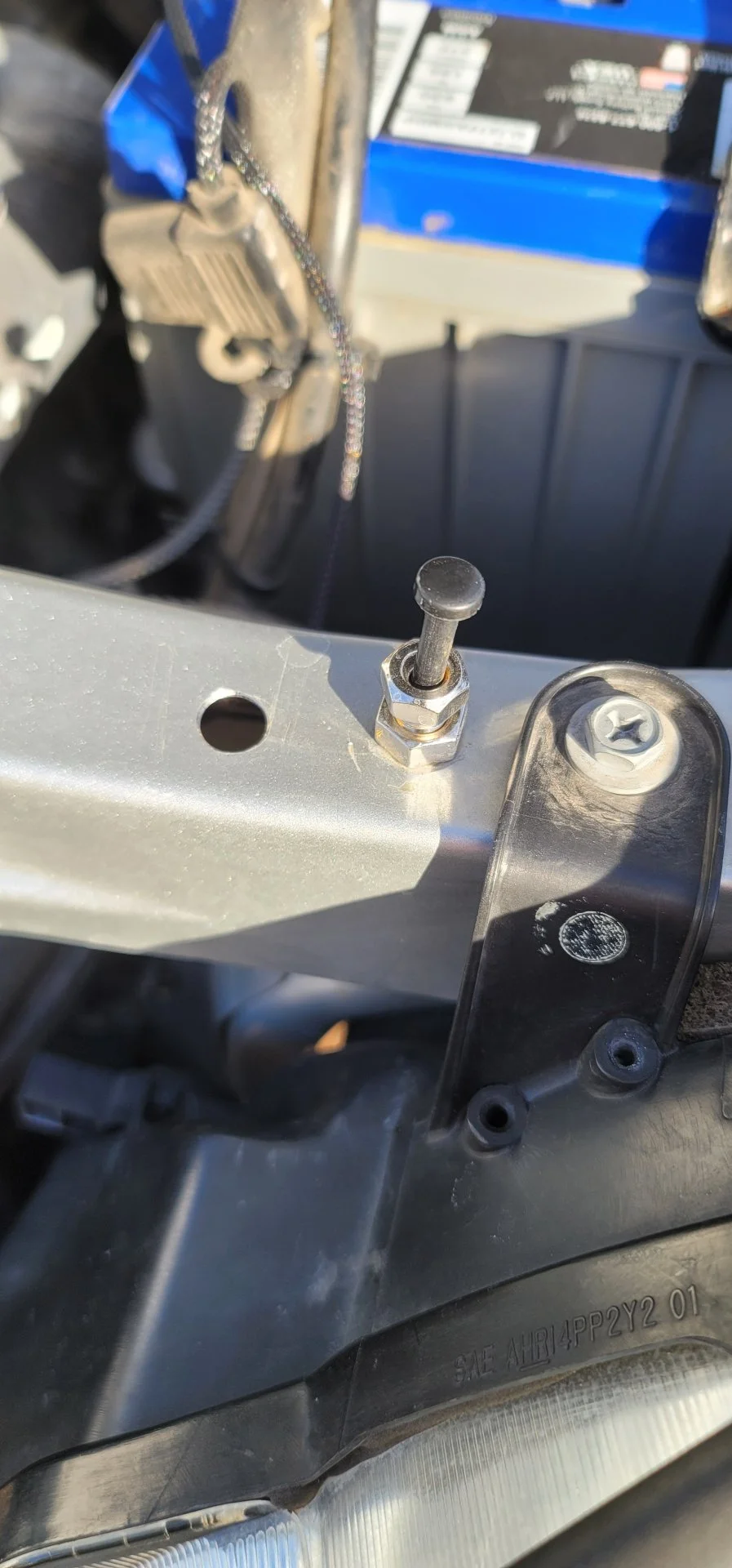

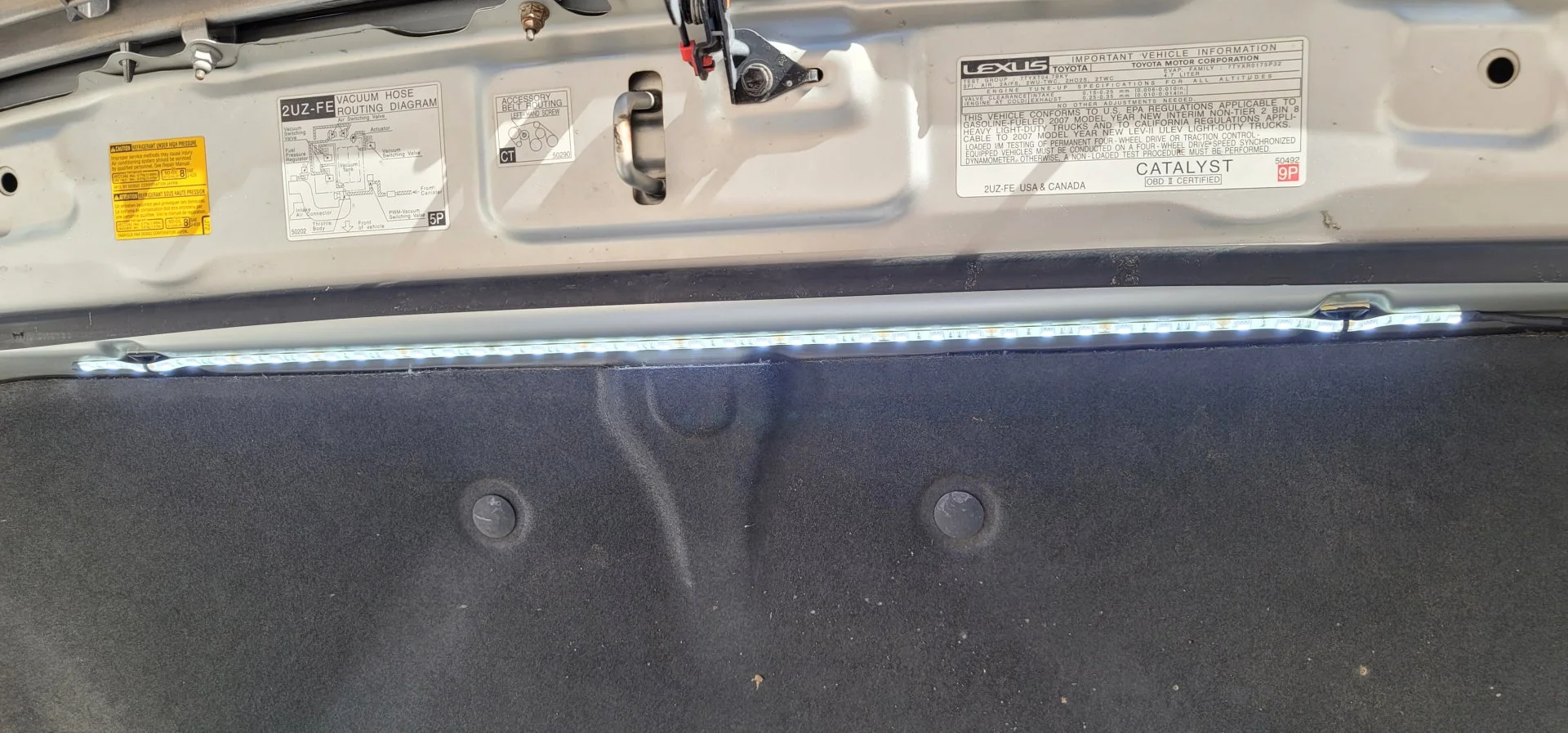

Installed the Yodateq hood light kit. Simple install and it provides a lot of light. I had to drill 1 hole for the switch to be mounted. Also showing the SDHQ battery terminal upgrade. It has multiple ports to make it easier to attach accessories.

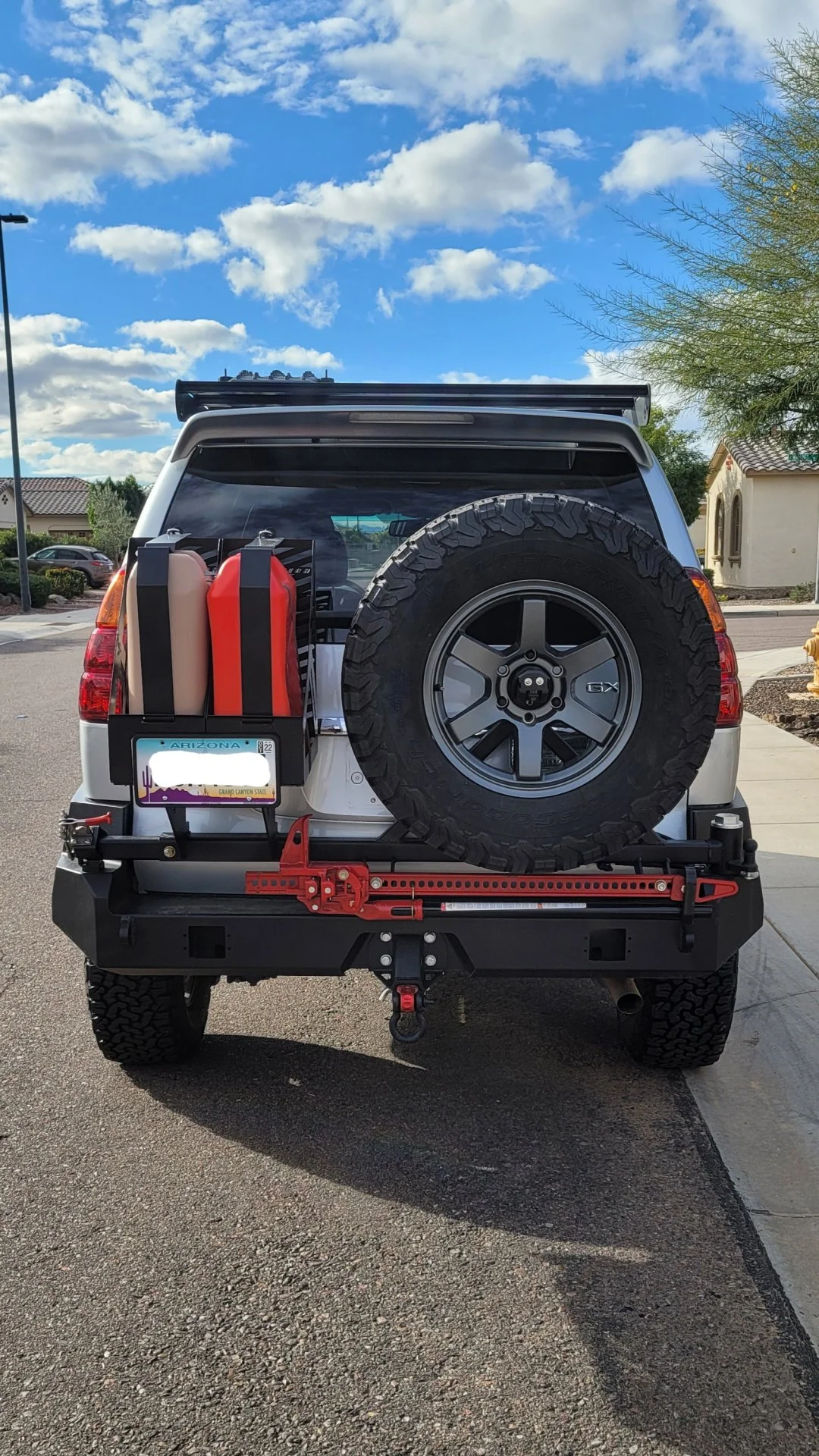

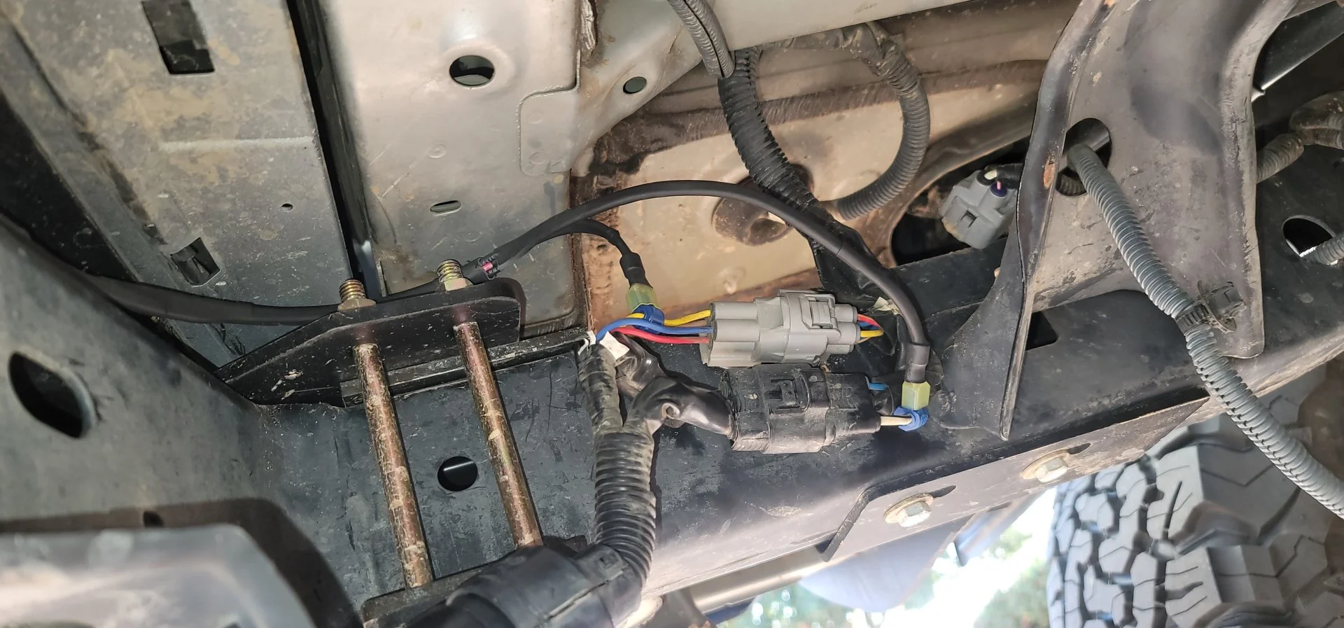

The wiring of the light for the rear bumper was pretty easy. They are the same lights that the front bumper has and are bright. I tapped in to the wires just before it goes into the trailer plug. My neighbor helped me and we used heat shring tubing the whole length. I used t tap connectors from Amazon. They are working good but I'm not sure about long term reliability. It seems to me that they are equivalent to what sharkbites are for plumbing, not something you want there long term.

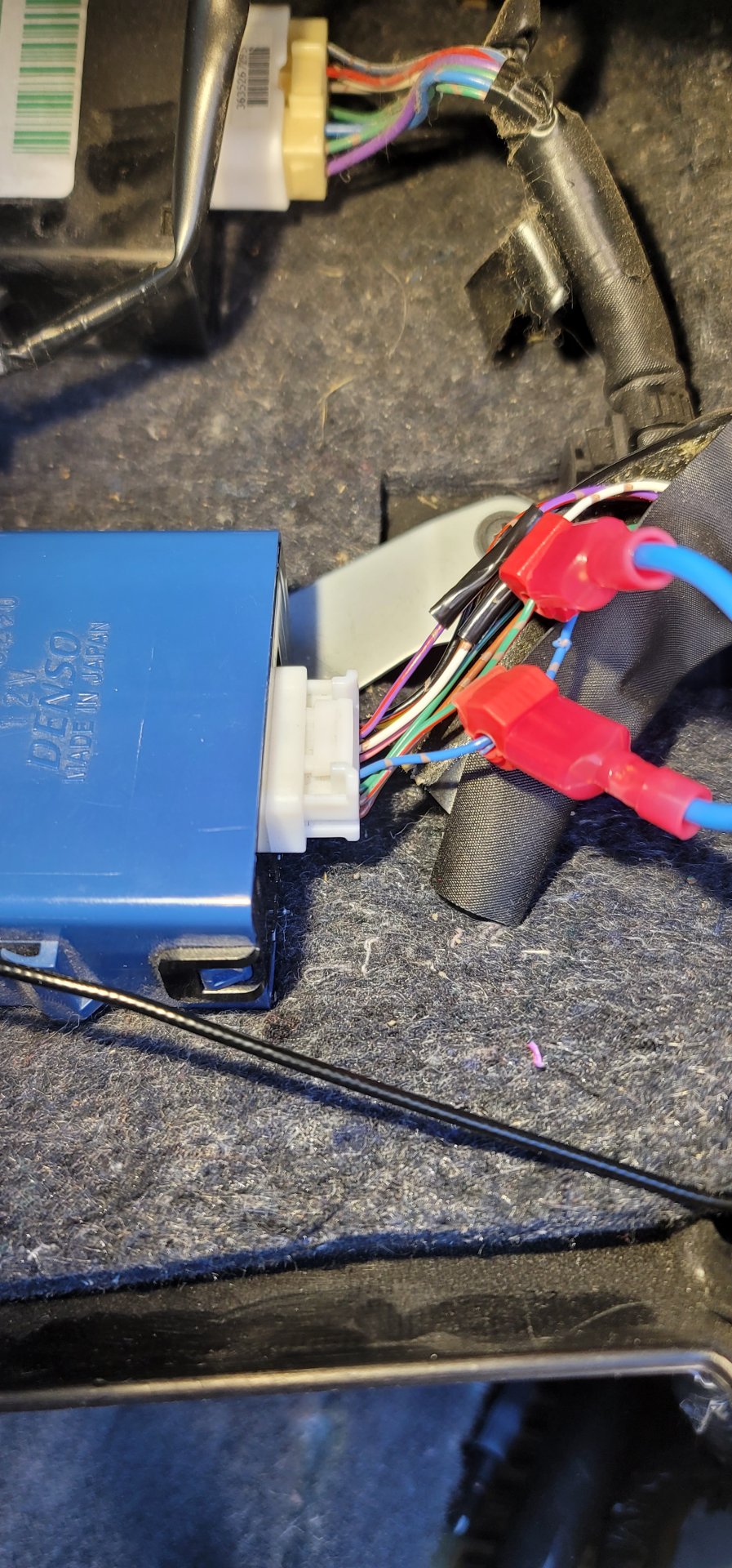

TPMS Disable

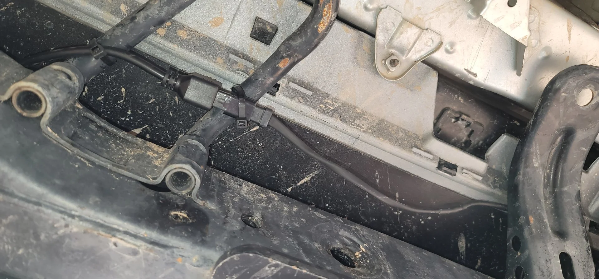

Finally got around to disabling the tpms light. I tried the grounding method and it did not work. The light went away for a few seconds and came back. I researched some more and found a post by RH22 that said that later models need to have a 5V source to disable the light which is the green/red wire in the same loom. I used a t tap connector to connect them and the light is gone. I drove the truck and everything working normal, no lights.

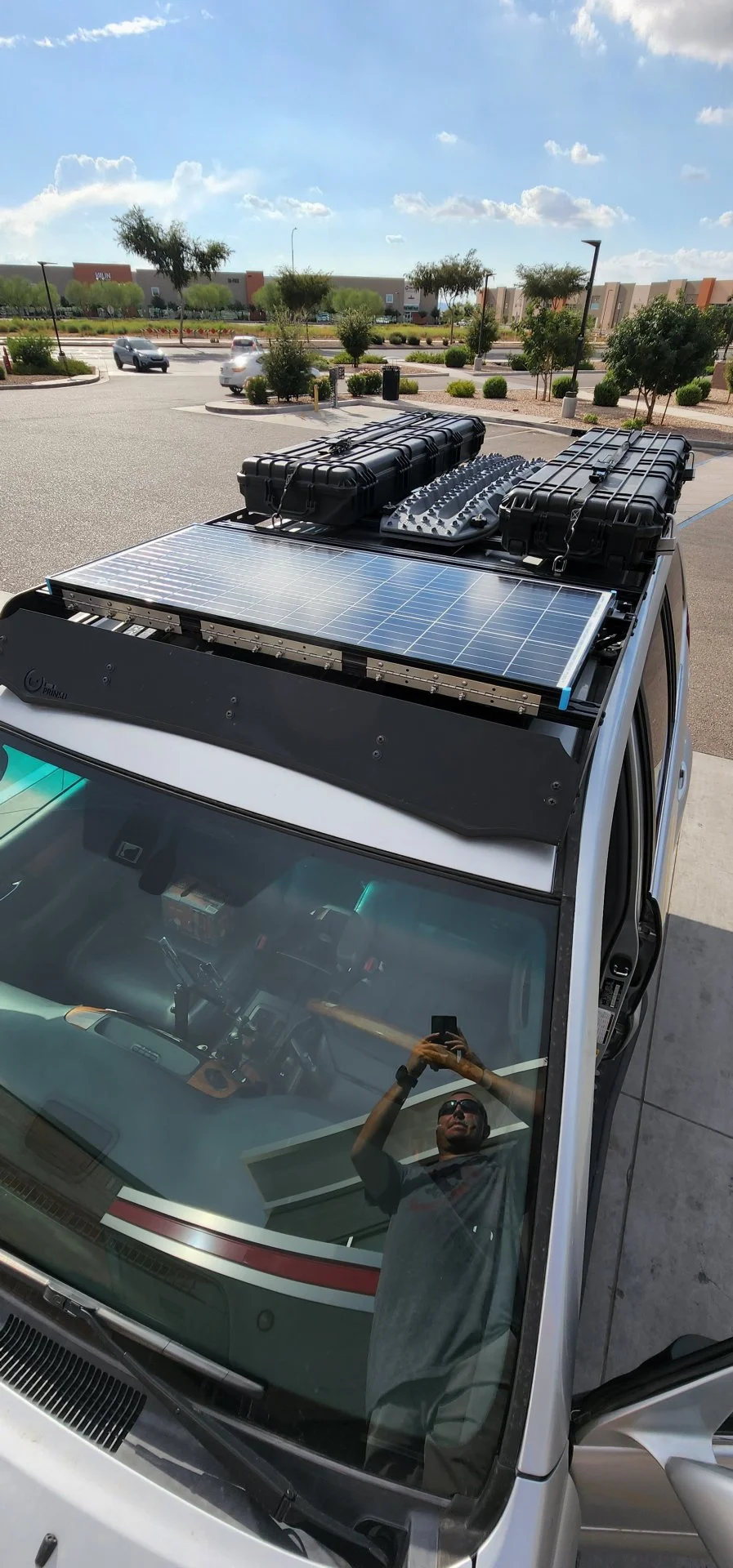

Decided to add some solar. It's a 100W Renogy solar panel. Installed on the roof rack with stainless hardware and hinges so it can tilt. Just need to figure put a bracket to hold it in place when tilted. I'm going to run my iceco jp40 fridge with this and a jackery 300.
