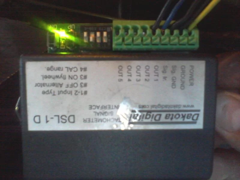

On my 80, the 4BT has the stock water temp, and oil pressure senders so you just plug those back into your main harness in the engine bay. The speedo/tach gets it's signal from a Dakota Digital module under the glove box that uses the stock harness to get the signal to the dash board instrumentation.
attachment.php
do you run this from the alt or from the crank? i wasnt sure if the factory guages were digital or analog signals. Is it possible to use one of these for the speedo as well?
This uses an induction pickup that counts the teeth on the flywheel. The signal from the flywheel pickup goes to the Signal In on the Dakota Box and then Signal Out to your tach in your dash.
Check out the installation manual in the link: http://www.dakotadigital.com/index....tegory_id=287/home_id=59/mode=prod/prd129.htm
