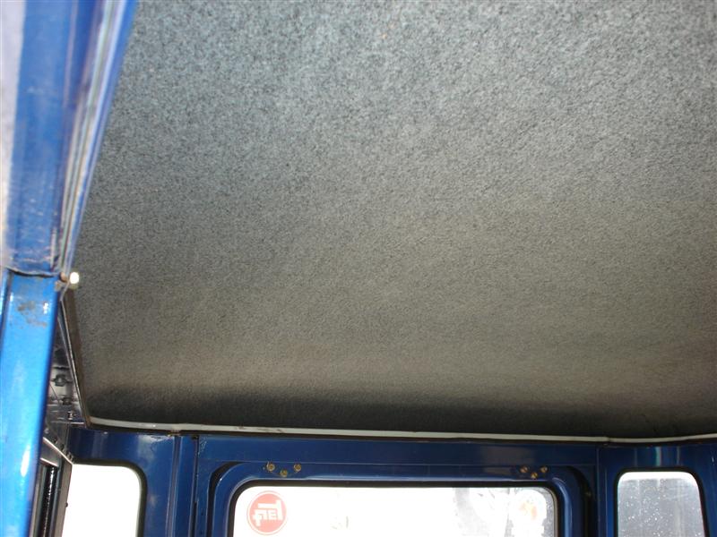

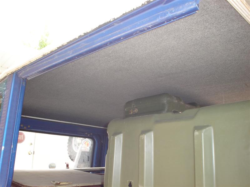

Here are the pics:
It works out very good in a 40. The top doesn't have any ribs to deal with (such as the 55). The top is place upside down, and you can easily fit the carpet before getting the glue out. I have been extremely happy with it.
This isn't outdoor "porch" style carpet like Home Depot sells, rather an actual upholstery carpet used for custom vans, boats, motorhomes, etc. Not sure if there is a difference or not? I got mine in a 6' width at a carpet supply wharehouse. Darrell and I loaded about 40' onto the top of his 45 :D

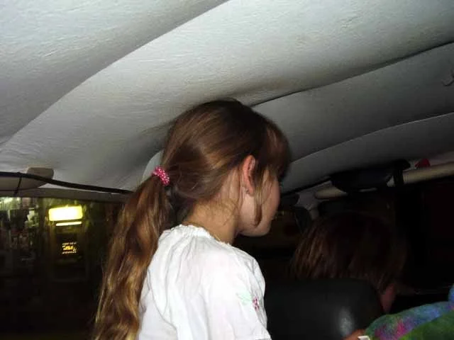

I made my own headliner from a large sheet of cheesecloth type material. We measured the gap between the rails, then hemmed a loop at the same spacing, then cut slits in the loop (you cant see them from inside the car) so that the rails slid through them and the edges hung down near the windows and doors. Then we tucked the edges into the door and window seals. Not as good as factory, but acceptable we think! P.s no shaping was required, the hems were streight and the material has some stretch to fit into shape. Only problem has been some moisture creep around the door frames -can act as wick if your seals are not keeping the rain out :(
