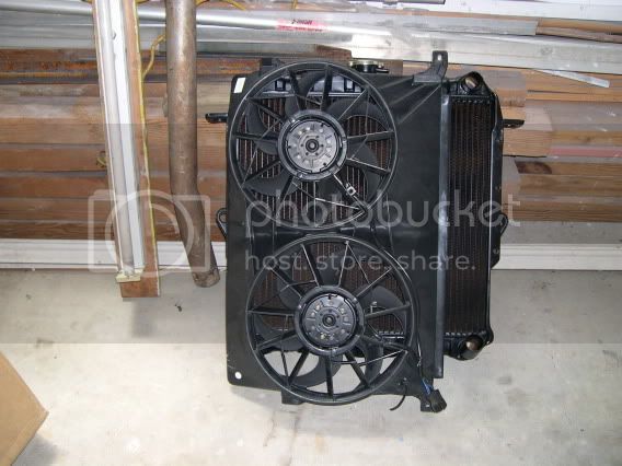

This is a picture of Oz AU Falcon thermos , they fit the early Commodore and H.S.V. 5 liter V8 radiators also , the later Commodore V8 fans are too large.
As you can see from the pic you would need to build a shroud from scratch to fit the HJ75 radiator shown.But as they say in Oz these things will blow a brick s***house down.LOL.:grinpimp: Perhaps some of the Yankee cars have a set that are a better fit for the Cruiser radiators. Also if you check the output of a big single electric fan and compare that to a cruiser fan in cubic feet per minute.
Also if you fit electric fans do it properly or else pay a deposit on a new motor. This will include an over ride switch with a warning light or buzzer, Temperature controller and the correct sized fan/s being in the proper position to the radiator.
