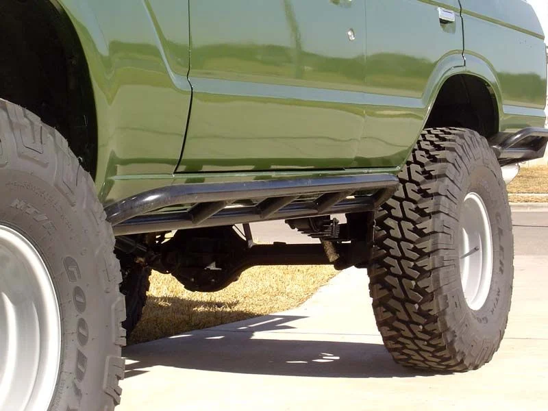

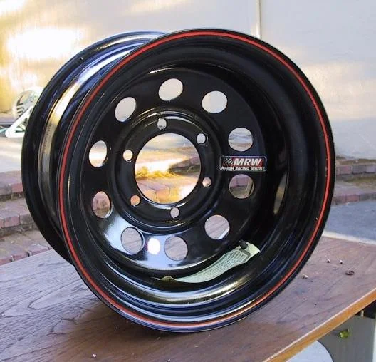

I purchased some wheels through www.fj60.com. It was over a year ago and I don't see them on his web site, so maybe he doesn't sell them any more. The vendor is MRW (marsh racing wheel). They are 15x8 w/ 3.5" back spacing. The holes in the rim are cut, not stamped, so there is no lip to rub on the caliper. I've been told you can also get a custom backspace white spoke wheel from US wheel through Summit Racing. Here's a pic of the wheels I got from FJ60.com/MRW
