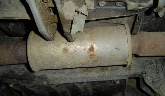

Some pictures of the culprit -
The main pipe measures 2 3/8" before it necks down for the resonator, and the OD going into the resonator is 1.9" !!!!

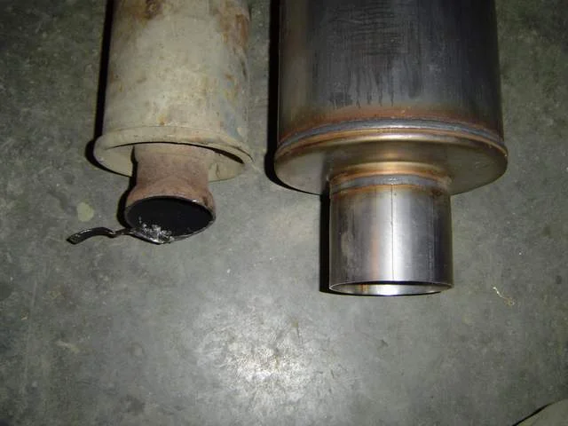

Well, I bucked that puppy out of there, and installed a 2 1/2" straight pipe in it's place temporarily, just for the heck of it. Here it is beside it's replacement.
The wall thickness of the pipe of the resonator is about .080 - so the id is in the 1 3/4" range
Well, took the Cruiser out to the same stretch of road as before - On the way there, noticed that the engine did not sound quite as subdued, and you can hear and feel it pull strongly after 3000 rpm. It is definately making more power! Ran the test a few times, and now it does 0-100 in 18 to 18.5 seconds - And I got it down to 16.5 once by loading the torque converter against the brakes.
So, the next step is to do the 3" system and test again!
