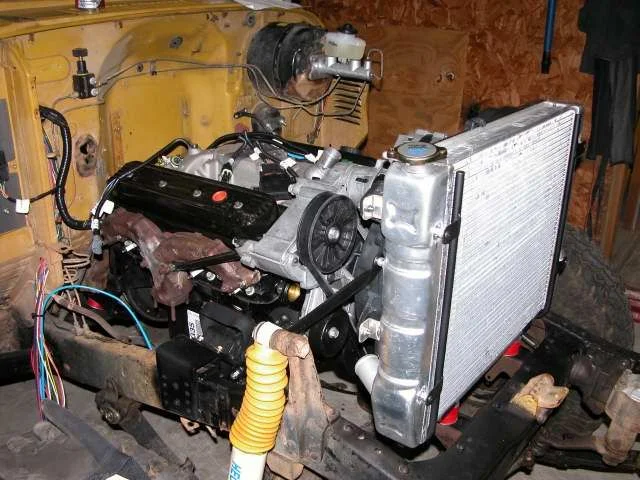

In my case, I run a large Griffin Aluminum radiator with 2 large powerful fans. (I live in Texas...it gets hot here...:D ) for my TBI 350. I got the biggest one I figured could fit. More volume, more surface area, better thermal conductivity. It stays at around 195 most of the time in very hot conditions with 1 fan on. Off road it can creep up to 210 or so with just the one fan, so I kick on the second one and it stays at 195.
Fans are from a Ford Contour SVO, and are similar to the Taurus fan with very high amounts of air movement. Core support is fabricated. I had Aluminum brackets for the fans and core support welded on by my friendly neighborhood racecar chassis builder, but any decent Aluminum welder can do the same.
Also, I am convinced engine position helps. Mine is as far forward as I can get without major structural changes, and I have a nice gap between the dist. and firewall where air can move around. The serpentine setup I run helps with that.
You can always cut some corners and take your chances. Or you can do it once and never have to worry about it again. Good luck! :cheers:
Here's a pic :doh:
