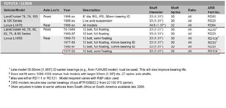

This is from the ARB Web site application guide. http://www.arbusa.com/alac/215110.pdf
Note how it would appear there is something different in the 77 - 92 that they don't require the larger 30mm carrier bearings. Or is there a mistake in the document? I may shoot them a email as I have a RD124 on the way and need to know if I need the new bearings or not. :confused:
How do you draw that conclusion?
I guess that I am missing something.....
ARB RD124 PDF <---- this is a link

...Note how it would appear there is something different in the 77 - 92 that they don't require the larger 30mm carrier bearings. Or is there a mistake in the document? I may shoot them a email as I have a RD124 on the way and need to know if I need the new bearings or not. :confused:
Spare yourself the email.... you DO need the 50mm carrier bearings for the RD124 UNLESS you have an unlocked 80 rear 3rd and you plan to reuse the existing 50mm carrier bearings ;)
