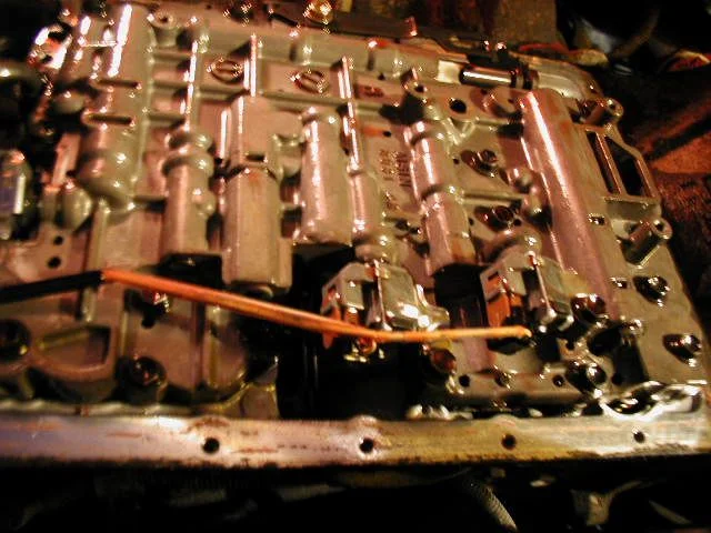

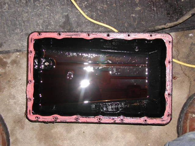

Here are some pics. of the old tranny pan after I dropped it. It was pretty clean inside with no metal pieces to be seen. There were a few metal shavings--really minute ones latched onto the last magnet before the drain plug. Cleaned the magnets, and put them in the new tranny pan. Pulled the filter attached to the tranny underneath the pan--backflushed according to Raven's suggestions--and everything looked and smelled good!!
This first pic. is one of the tranny pan out. The second is of the magnet that had some minute shavings--you can see them protruding from the magnet (sorry about the pic. qualities). The third is of the filter after I unscrewed it off the tranny housing underneath the pan.
Some more pics.
The first and second pics. are from underneath the truck looking up at where the tranny pan was. Everything looks real clean and just covered with the nice Mobil 1 red... :) Install pics. coming later after I try to figure out this thermo problem... :frown:

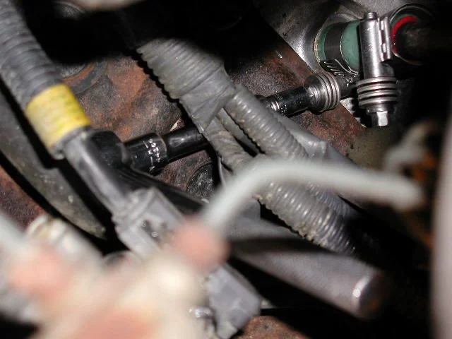

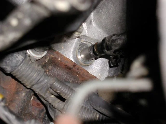

I first took the heater hose screw off so I could get some wiggle room on the hose...the second pic. is looking at the screw that you have to take off to get this wiggle room. This pic. is from the PS (US) looking at the area where the heater hose goes down--the heater valve is to the left with the throttle body towards the right. You will notice two screws in the middle of the pic--one rusty brown color, one a steel color--unscrew the steel colored one...IIRC 12 or 13mm socket.
The third pic is of the hose attached and the socket on the clamp getting ready to clamp down...notice the contorted position your body, your arms will have to be in to get the wrench/socket into the opening and to get it on the clamp...this was knarly and caused much pain trying to get an angle to be able to turn the wrench enough to get a couple of clicks, then to have it fall down and to start again...this took forever!! It helped to pull a bit on the bunch of wires bound in gray and then push the socket up underneath it, then use both hands to push and put the socket on to the clamp...
