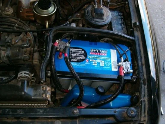

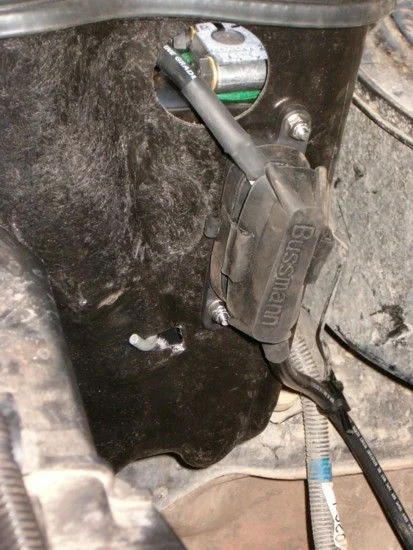

So the first step is to move the washer bottle with the excellent Slee kit, and mount the new battery tray-CDan even sent the appropriate OEM bolts that mount the tray to the body-a nice touch. The first real decision is where to mount the BIC. It is about the size of a deck of cards and needs to be protected from shorts. They reccomend vertical mounting to decrease the risk of accidental shorts to ground. That made sense, and I mounted mine on the back of the new battery box in the space between the box and the aircleaner. That is a perfect and well protected space with short wire runs, but you could mount to the firewall as well. I wanted to keep the wire runs as short as possible and the #2 battery has about 1 foot of 4 guage wire to the BIC.
Then from the BIC to the main battery it took about 5 feet of 2 guage cable. For the cables I used Marine spec wire from West Marine. It's expensive but each strand of the copper is tinned and their cable ends are nice tinned brass, so corrosion is not likely. The Marine heat shrink is really excellent, but pricy. I ran the 2 guage wire from the BIC, between the fender and the new battery box, then behind the overflow bottle and into the factory wire race just in front of the radiator. To get there, I had to dissassemble everything in front of the radiator and that took more time than anything else. The 2 guage wire then connects to the main battery-the BIC uses this connection for it's voltage signal and to pass the big currents associated with back up starting or winching. All the wires were sheethed in flexible conduit and tied down to prevent chafing.
To ground the new systen, I used an idea I got here. There is a 10mm threaded boss at the base of the right side of the engine block. The threads are 10 x 1.25mm and I cleaned up the threads and the boss and bolted in my #2 battery ground wire. I fused the ground side of the #2 battery and that protects all of the #2 batterys wiring in the event of a short. There are reasons not to fuse the ground of your main battery, but for a backup it works great.

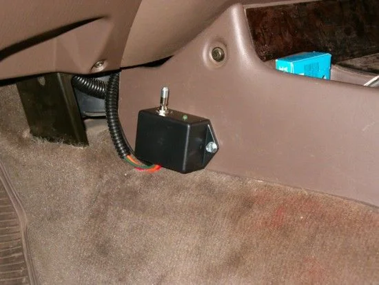

The next step was the controller. I mounted the switch to the center console tucked out of the way under the dash. The wires pass under and through the dash, then through the firewall grommet on the right side. This makes for short wire runs to the BIC. Everything again got sheethed in conduit and tied down with wire ties to prevent chafing.
You will also notice in the pictures that I converted to all military spec terminals. This makes the job of bolting the big cables together much easier though you do have to modify your fusible links-the wire connectors have a 5/16 hole but the military terminals have a 3/8 bolt-so you have to carefully drill out the center of the connectors. Be careful doing this as I destroyed one set of fusable links. I had a couple of spares (reccomended, only $12 or so) so no big deal.
The Pics are the BIC mounted in place, the remote controller, and the new battery tray with the cabling in place. I will post a few more pics in another post.
