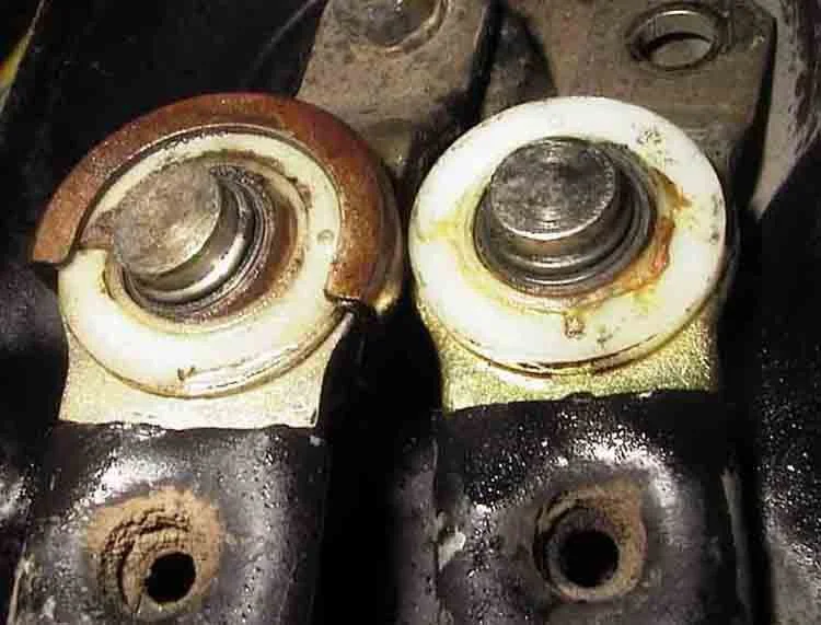

I did find another drawing of a part I made and totally forgot about. These are in my current 60 and have been for three years. It is another way to fix the broken plastic bearing in the motor relay rod. I reused the plastic part that snaps onto the brass ball from the original assembly. What breaks off is the plastic washer-like flange on the other side of the metal rod end. My fix is a metal clip to hold the usable part of the plastic bearing in place without the broken washer.
In the first pic, the bottom one is repaired, the top one is an unbroken original end.
The second pic is a front view. Left repaired, right is unbroken.
These I can make easily. Maybe you can too but maybe not. How’s $15 a pair sound, shipping included. You’ll have them by Christmas, maybe sooner.
Let me know what you think.

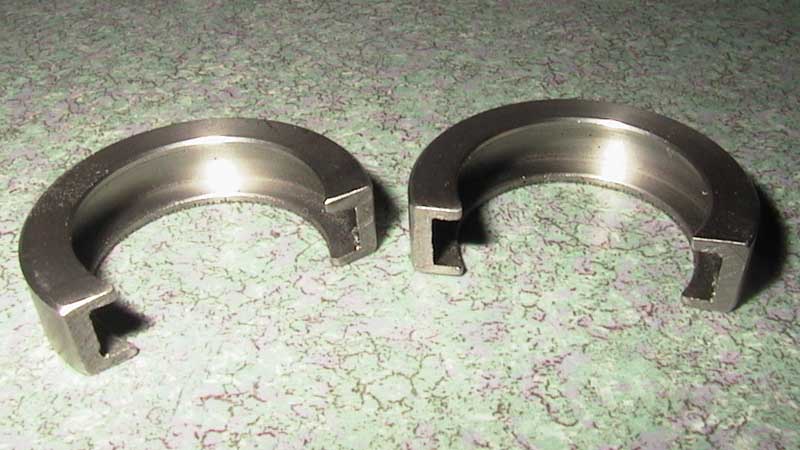

Plastic bearing repair clips
I made some of the OE plastic bearing repair clips over the weekend. They're made of 303 stainless steel so they won't rust. They snap onto the wiper linkage rod connecting the motor crank to the wiper pivots. $15/pair delivered. 100% refundable if you don't like them, just end them back. PM with questions.

Cold weather is returning, wipers will be freezing to windshields and plastic bearings will soon be breaking. Uh huh.... anyhow, I've still got the repair clips available. PM me if interested.
I got a set of those repair clips from 60wag. Worked well for me.
It sure beats spending $200 at the dealer for the whole assembly.
