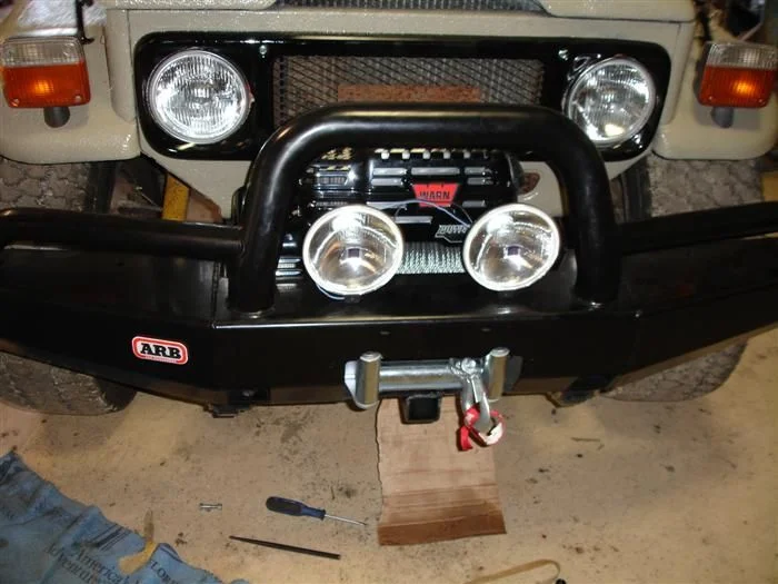

Installed a set of Hella 500s today........:cool:

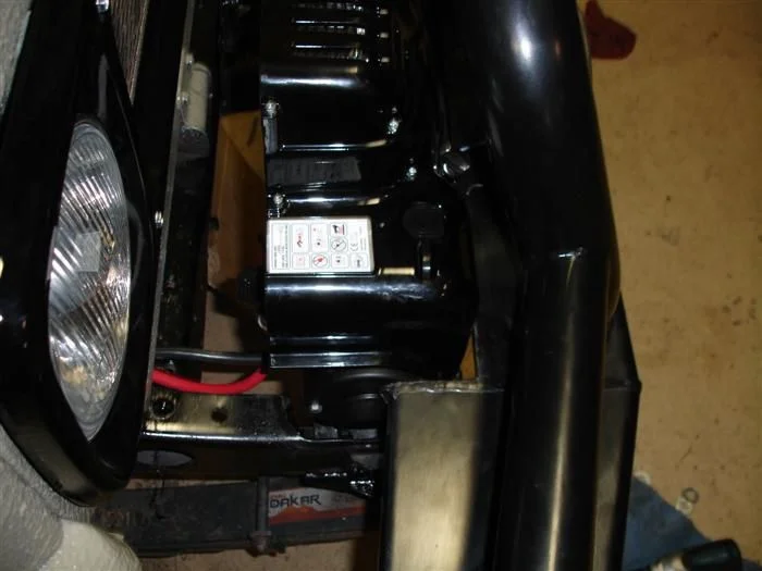

Won't fit?? true, its set up for a 8274 as you well know... it took some fab work to get'er done.... back later with some pics....;)

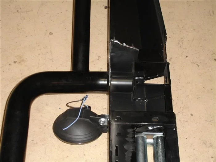

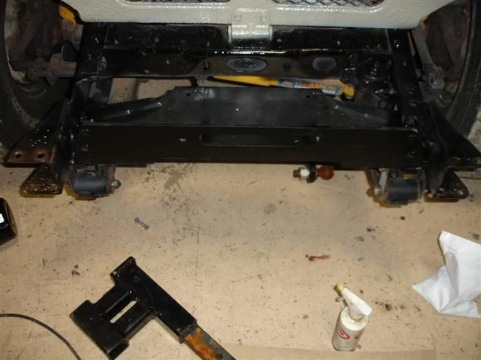

Just started off with the basic 8000 series mounting plate for a( j**p)... since the plate was too wide and the winch spool is off set, one end of the plate had to be chopped off and centered in the frame rails and mounting holes re-drilled, which also called for notching out a small section of the frame rail to gain clearance.... plus the bumper has to have a chunk cut out also... this is as far as it got on Friday... gonna pick back up next week for the tie down and mounting a 2" receiver for a removable hunting chair ...(some black magic will be needed from here on out):eek:
