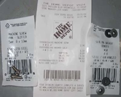

So I offer a solution.. Junk can I start an official factory roof rack post? If any of you have some of the other good ones bookmarked please post links to them in here, so we can have one solid resource for the FAQ's.. and in case you hadn't guessed by now, this is what I did today. got lucky that none of the "nutserts" were loose, so all of the screws came out of the rack no problem. Underneath the rack itself was just as I suspected... rusty threaded inserts, and grooves worn in the paint.
I know, looks like a big smily face, taunting you. what are you going to do about this, smart guy? :flipoff2: :flipoff2: not sure yet. Started with the holes. I know that some have used "marine quality" stainless screws and washers, but I don't see much water up here in the high desert, so what I know is the Home Depot. Here's what I bought to seal the threaded holes.. Stainless M5 screws, and some galvanized "sealing washers."

They don't seem to have the black-oxide finish in metric sizes. You will want a 5mm by 8 or 10mm screw.
Derek, you're right, it is a 5mm screw. :doh:
When I first went to the marine store, I didn't know the correct size but I tried the #10-32's and they worked fine without binding or being loose. Probably not a "perfect" fit though.

if the 5mm treads match the #10-32 (AKA 3/16"x32tpi national fine thread) might actually be better as is it slightly smaller and would have less drive resistance, here in GA I can get excellent SAE hardware, my metric selection is limited, but that is a big IF, need to find out what thread pitch the 5mm is
for the spinners I will probalby have to drill the heads off to get the roof rack off and then may still have to remove the headliner to get the leftovers of the screw out :(
OK somebody check my math becase this sounds to good to be true, from an online search 5mm is 0.8MM per thread
25.4/0.8 = 31.75 witch is very close to 32
