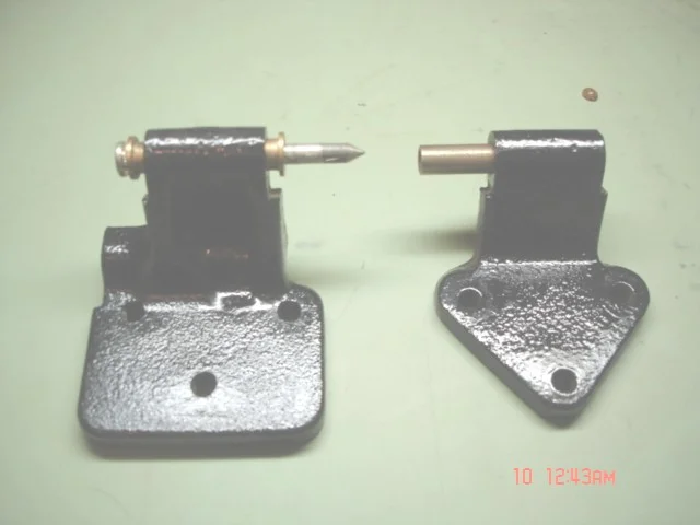

Okay, a couple of quick photos as an addendum to my last post.
The pair of hinges:
And here's an exploded view of the top hinge showing the oilite bushings and other hinge parts.
You can see the metal thickness surrounding the bushing on the outer hinge half (on the right). I think there's still plenty of strength in that area, but I guess I'll find out if my doors start snapping off.
The 1/4" bolt is also 11mm in size (7/16" imperial), so if you only carry a metric toolkit you'll still have the tools to tighten the bolts, if you need to.
I'm not sure what the total cost per hinge would be (in parts anyway), since I swiped the oilite bushings from work, but the bolt, nut and washer can't be more than $.50, and even if the bushings are a buck apiece that's still only $2.50 in parts.
It may not be 'purist', but it works.
