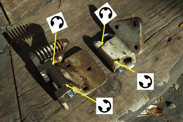

I only had a couple of hinges on mine that we wiggly, but I took a different approach. If the nylon washers (I think that's what they are) are gone, that makes the hinge much less stable. So my thought was if that space was filled, it would prevent the side to side movement enough to get that hinge solid.
I dug around and found that a 3/8" steel e-clip from home depot fits perfectly in that space on either side of where the pin goes. I'd take a pic, but I just sent the hinges off to be with the piggy at the shop. But, you just jam that eclip in there with a screwdriver and a hammer and it takes away a lot of the play.
This would work well for those that don't have hinges that are terrible, but want a little more snugness.
Here's what I did...
A picture is worth a thousand words.

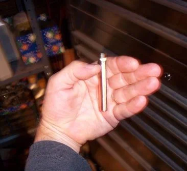

A different way, Jim if you can hold off a week I will show you how I did It. I've finished my driver door hinges with a different technique than what the other guys are talking about. About done with another commitment. Soon as I can I want to do the hinges on another door. I will post as I go. Try to post a picture of the pin tonight if I have time.
GREASABLE hinge pin piture. Here (for what it is worth) is a picture of the greasable hinge pin I made. Try and get a better picture and descriptin later.

I got the bushings from a company called Motion Industries- they're on the web and have stores around the country. If I did not already have them, I would have just used the bushings in the NAPA kit. They are also made of oil impregnated bronze, so you really don't need a greasable pin..
Make sure you post up some details. I may be able to get these made in bulk here in Guatemala for a reasonable price.
