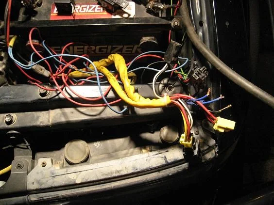

Ok, so I've owned my cruiser for almost exactly 2 years and I've added a few electrical accesories during that time, including the following:
Slee headlight harness ------- 2 relays No fuses(was unhappy about this)
Hella 4000's ------------------- 1 relay 1 fuse
4 roof rack lights ------------- 1 relay 1 fuse
4 rock llights ------------------ 1 relay 1 fuse
All of that amounted to a rats nest of wires, relays, and fuse holders(see pics below). Since these accesories were all added piece-meal they were not combined in any sort of organized manner. This eventually led to water shorting out the relay for my Hella 4000's and causing them to be on constantly until I pulled the relay.

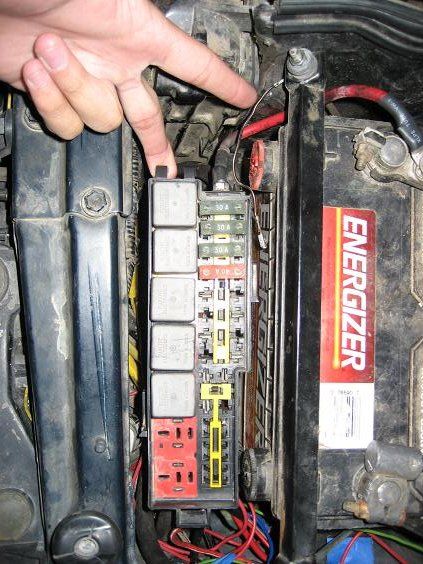

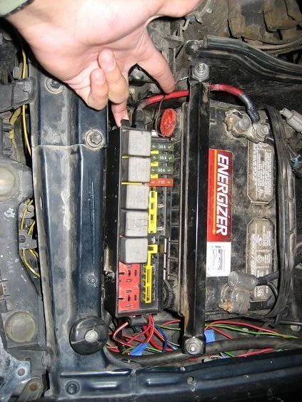

So I dismantled the entire fuse box using a terminal pick(i.e. removed all of the guts from the fuse box leaving it a plastic shell). From there, using shrink-tubed butt connectors I rewired the entire fuse box to the existing harnesses in the truck. This was the most time consuming part and took about 6 hours total. After all was said and done, this is what it looks like. I still have 2 extra relay slots, and enough room for 12 more fused circuits.
Here's how I wired it:
I wired the high beams and low beams to seperate relays, but ran them off the same fuse. The other relays all have their own seperate fuses.
I grounded all the relays through a common ground wire to the ground point on the body to the right of the battery.
The accessories are each grounded individually through their original harness ground points.

I still need to make a mounting bracket for the fuse box as it's currently free floating although it doesn't really have any room to move.
I also plan to turn the battery 90* and run the fuse box along side.
I also "stubbed out" an 8 gauge wire on it's own fused circuit to run to the interior for a smaller fuse box I intend to install under the shifter console.
Feel free to ask any questions. Sorry I didn't take any pics "in process" I kinda got carried away and didn't think about it till I was done.

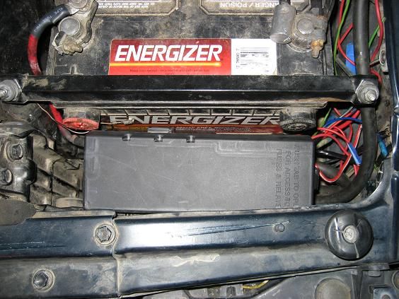

Sadly i didn't find one with a lid that isn't broken in at least one place.
Also the above pics show a box missing the cover that goes over the lug for the battery lead.
