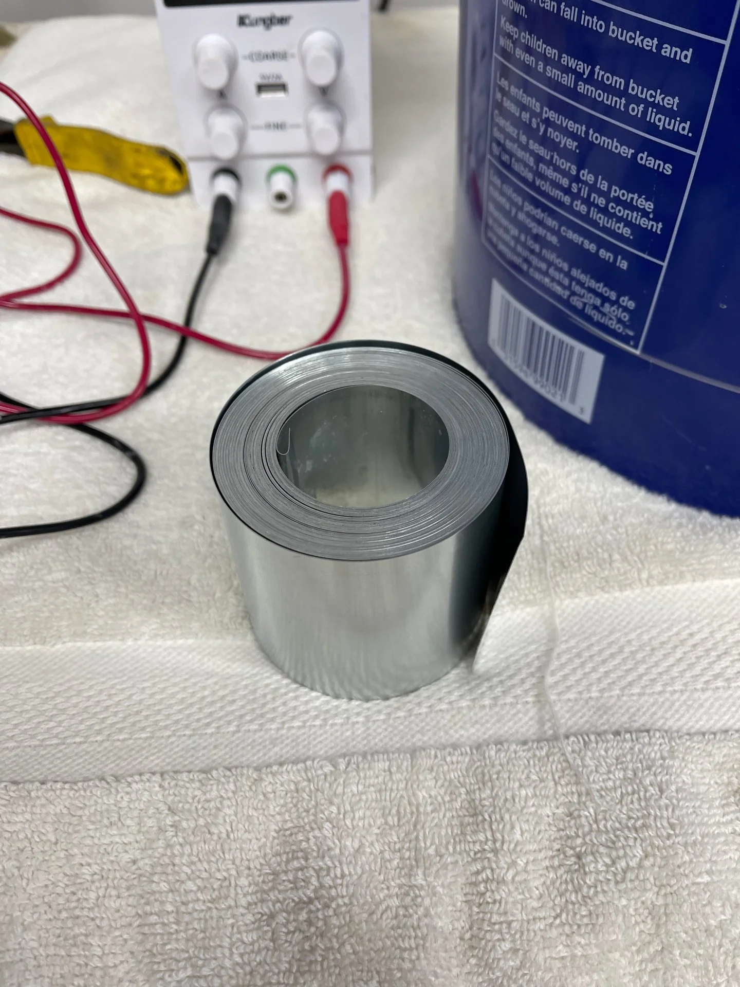

- Power supply: I bought mine from amazon for ~$70. I needed a power supply for my garage anyways so I didn't mind this. You can also plate with old adapters, but I haven't tried this myself.
- White vinegar: 5% distilled water, bought 2 gallons from Costco for ~$5 and it's more than enough.
- Salt: to increase conductivity, I don't know the benefit of one kind over the other, so if you do please leave a comment.
- Zinc strips: you can buy Zinc plating strips for a few bucks to start off, or just buy a roll of Zinc roofing strips that are much cheaper per foot. I bought 50 feet for ~$30 and it will last a long time

my Zinc roll:

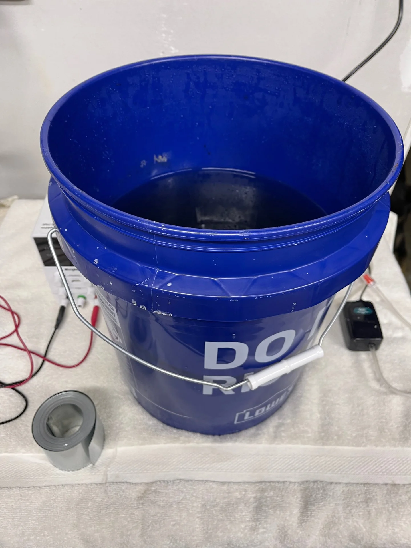

and the solution mixed (white vinegar + salt) in a bucket.

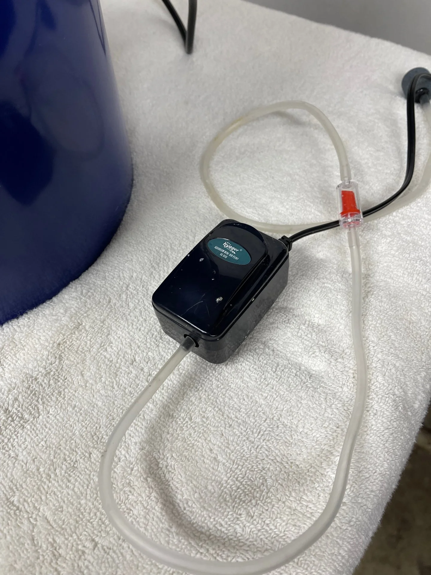

and the aquarium fish bubbler, which again is optional, this way I don't have to stir the solution every once in a while:

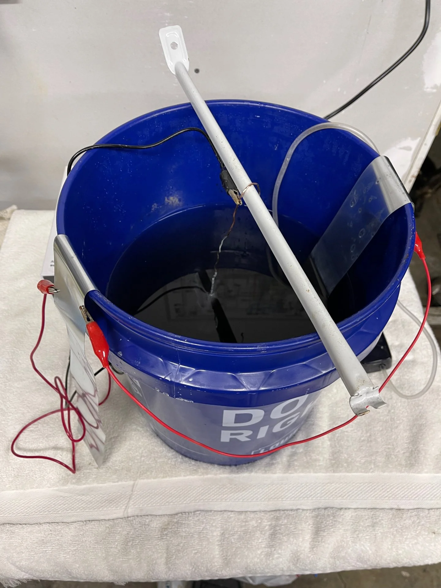

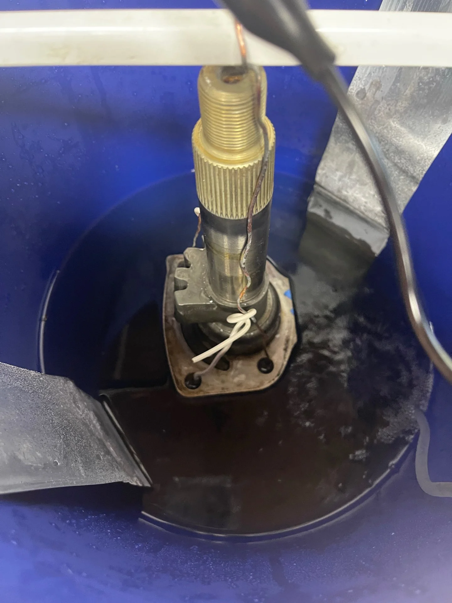

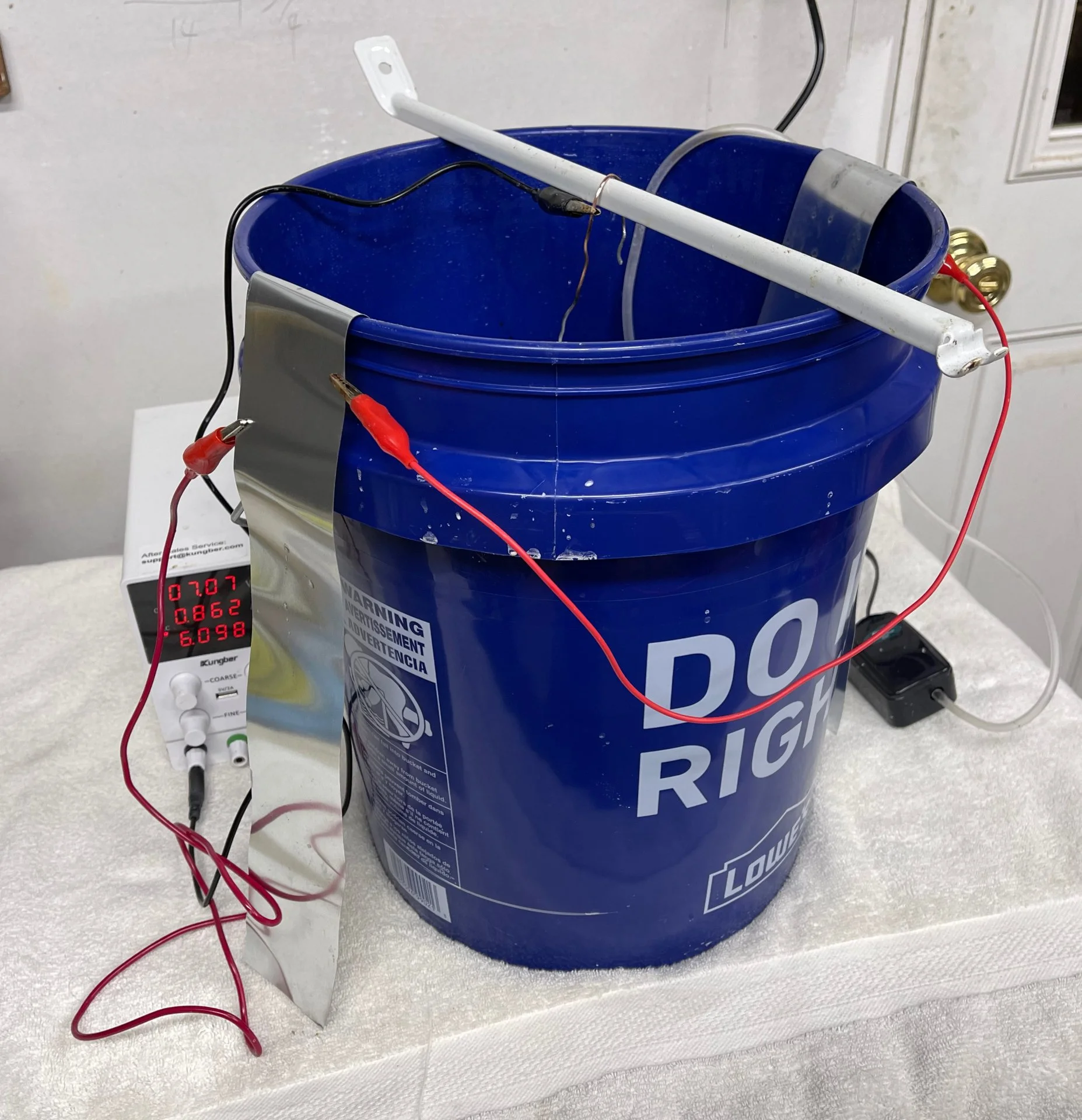

This is the setup: I cut two Zinc strips, dipped in on either side of the bucket and connected together by a wire then connected to the positive of the power supply. Negative is connected to a bare copper wire which the part is hanging from in the solution.
For a few bolts and screws start with 1 amps. The amount of current needed is a function of the surface area, but generally more current plates faster. I've read different answers on the recommended amps per square feet and am experimenting myself so I haven't mastered this part yet. Good thing is that you can tell when your part is plated.

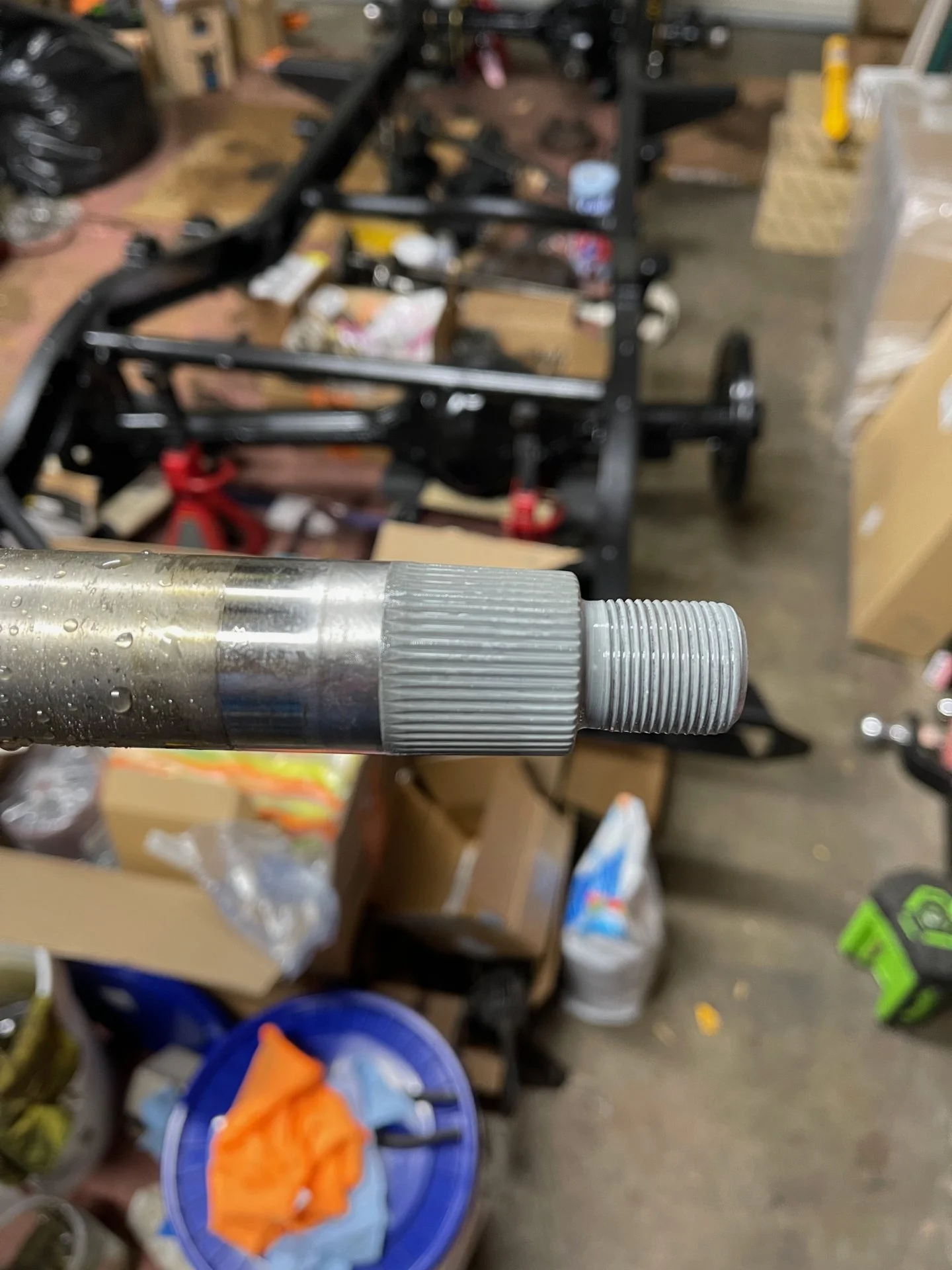

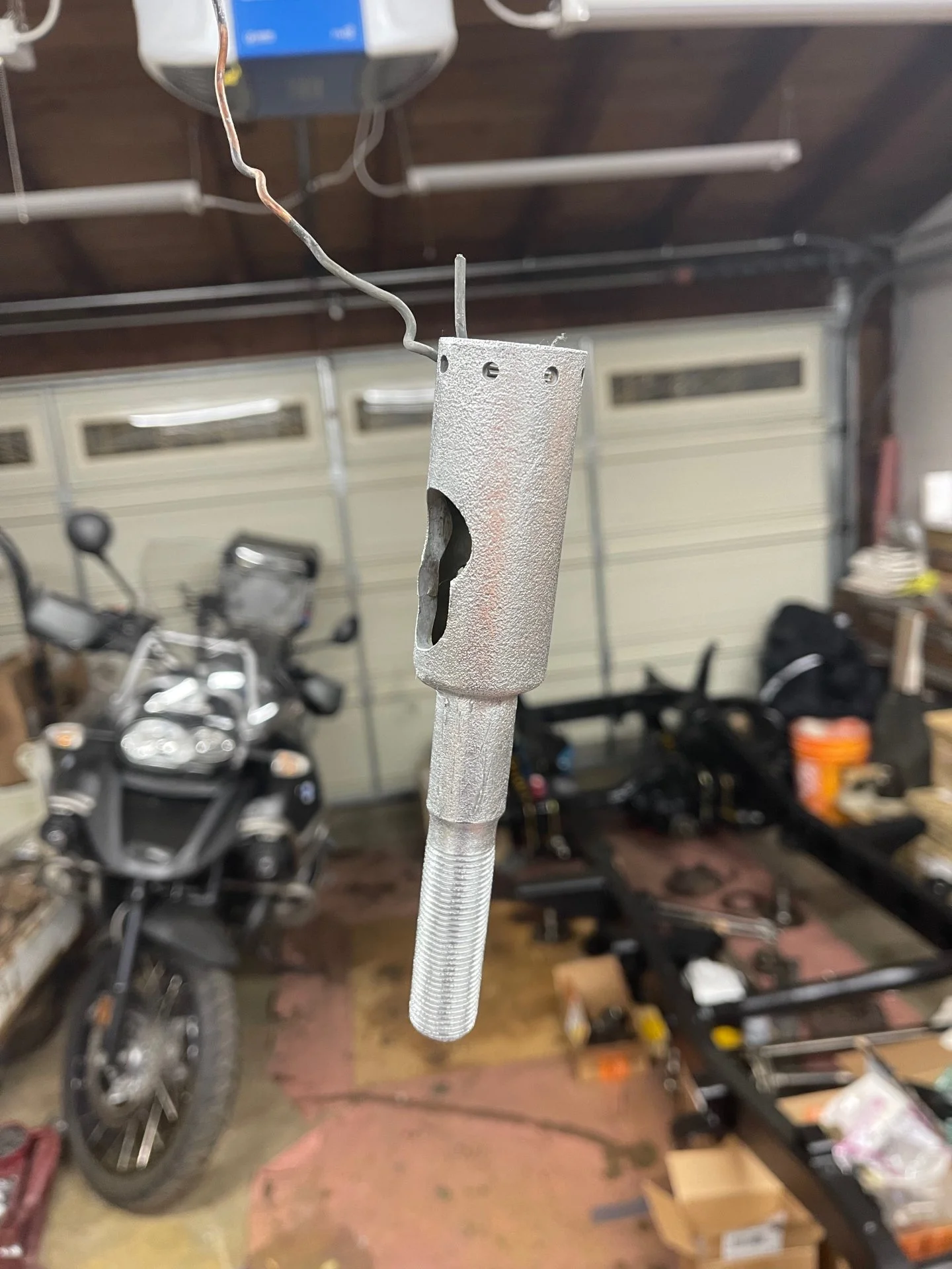

You'll see bubbles coming off the part you're plating. Let it go until you see the part becoming grey (takes between 20-40 min depending on the current). This is the result of plating (just the bottom portion of the part):

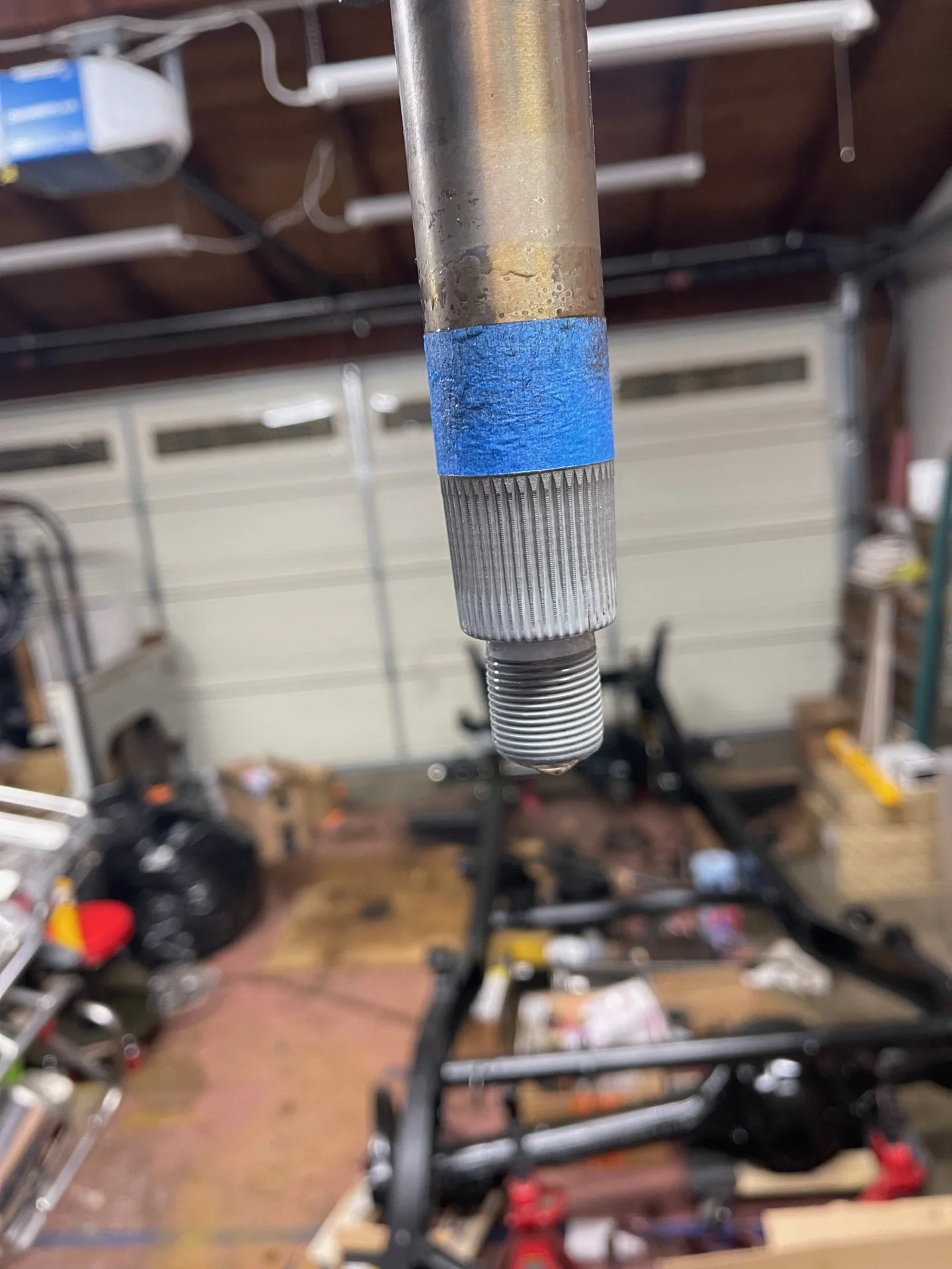

Only the portion of the part that is dipped in the solution will get plated, and the area to be plated needs to be exposed to the solution so masking will prevent plating. Masking removed:
Zinc is very easy to polish, I use fine steel wool and in seconds you get this:
and you're done, the piece is now Zinc plated.

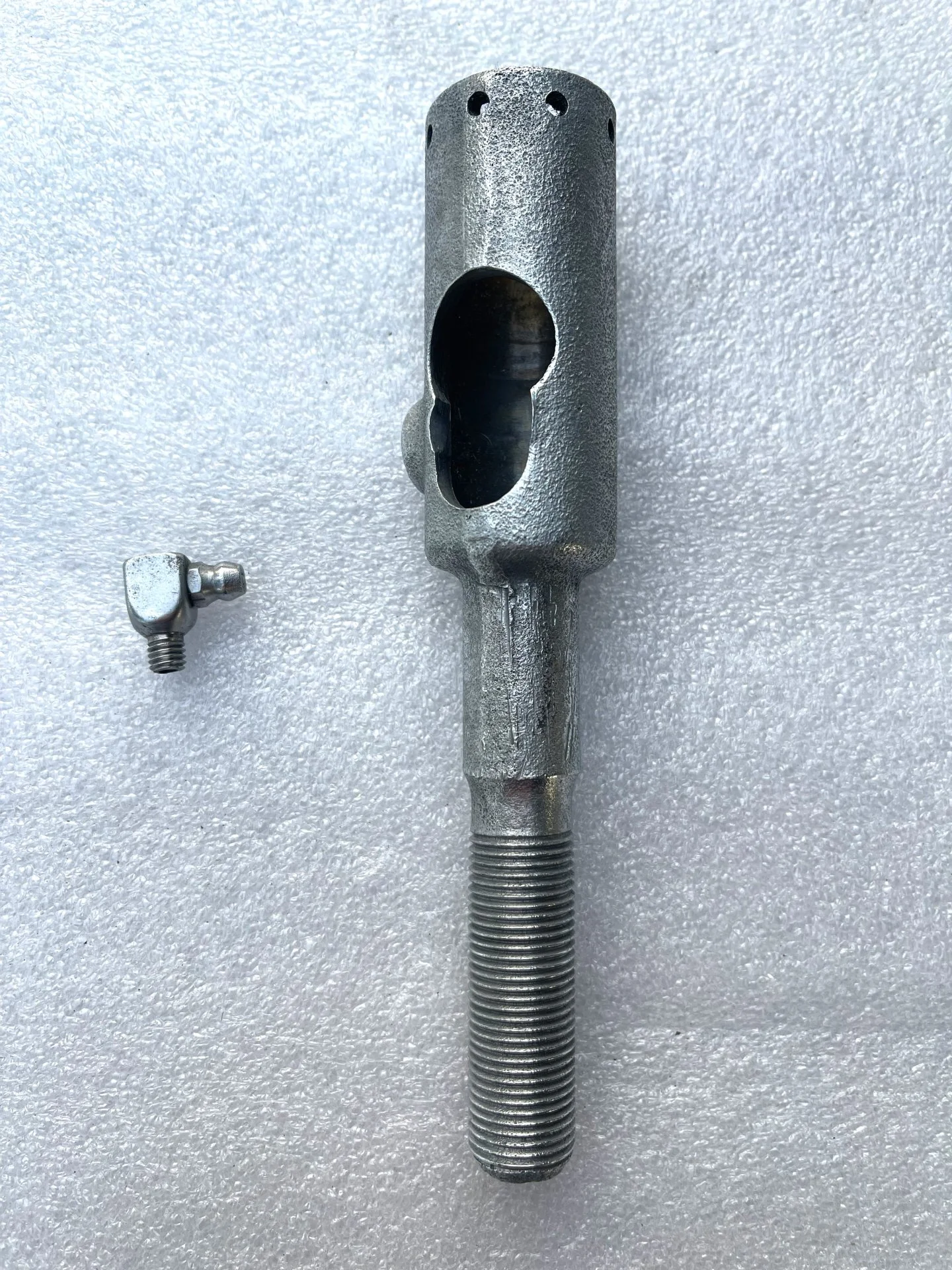

Here is another sample part all cleaned up:
Plated and polished:

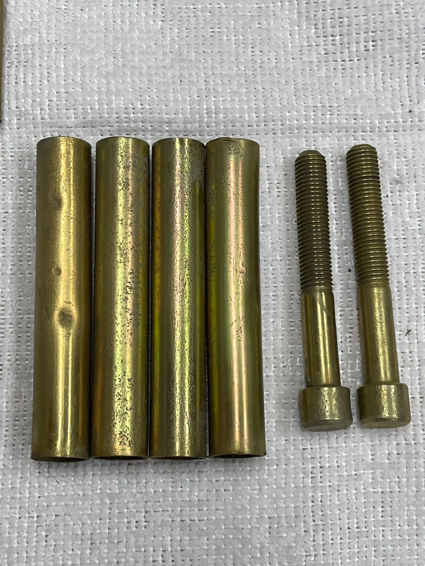

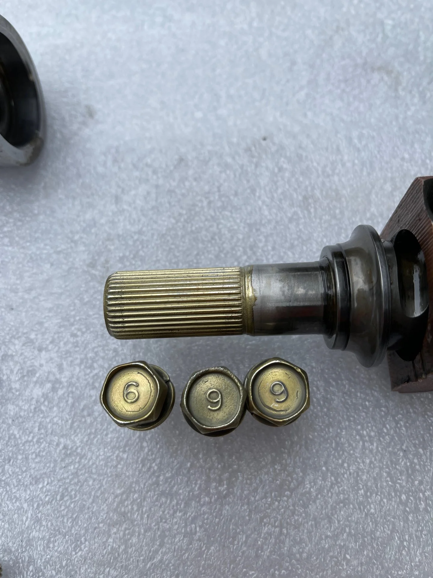

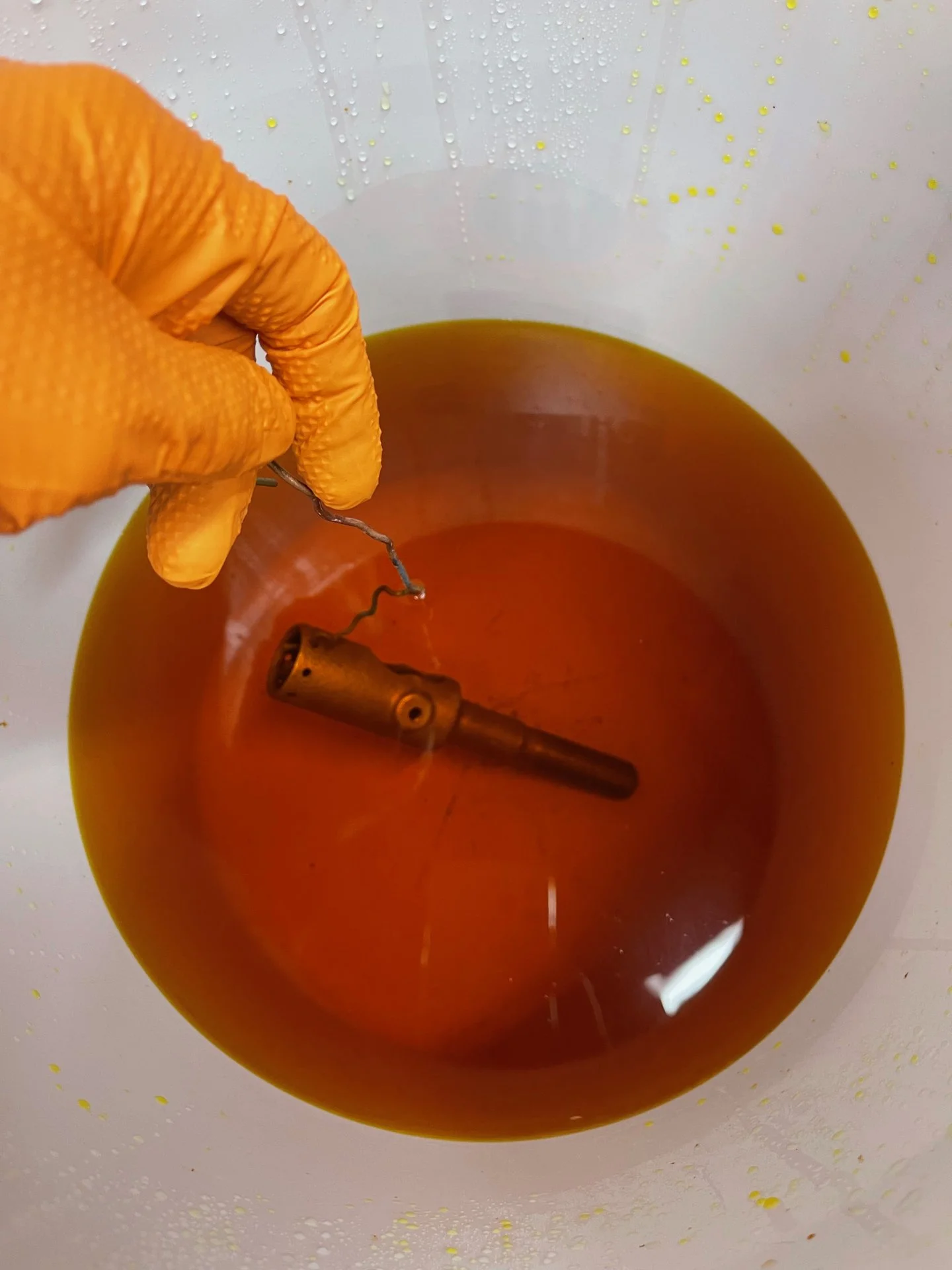

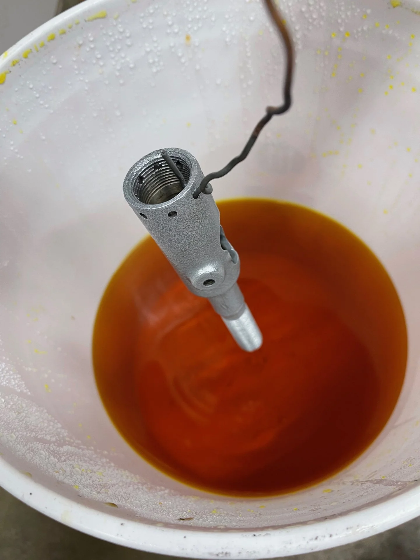

then degreased again, sprayed with distiller water and dipped in yellow chromate for about 30 seconds:

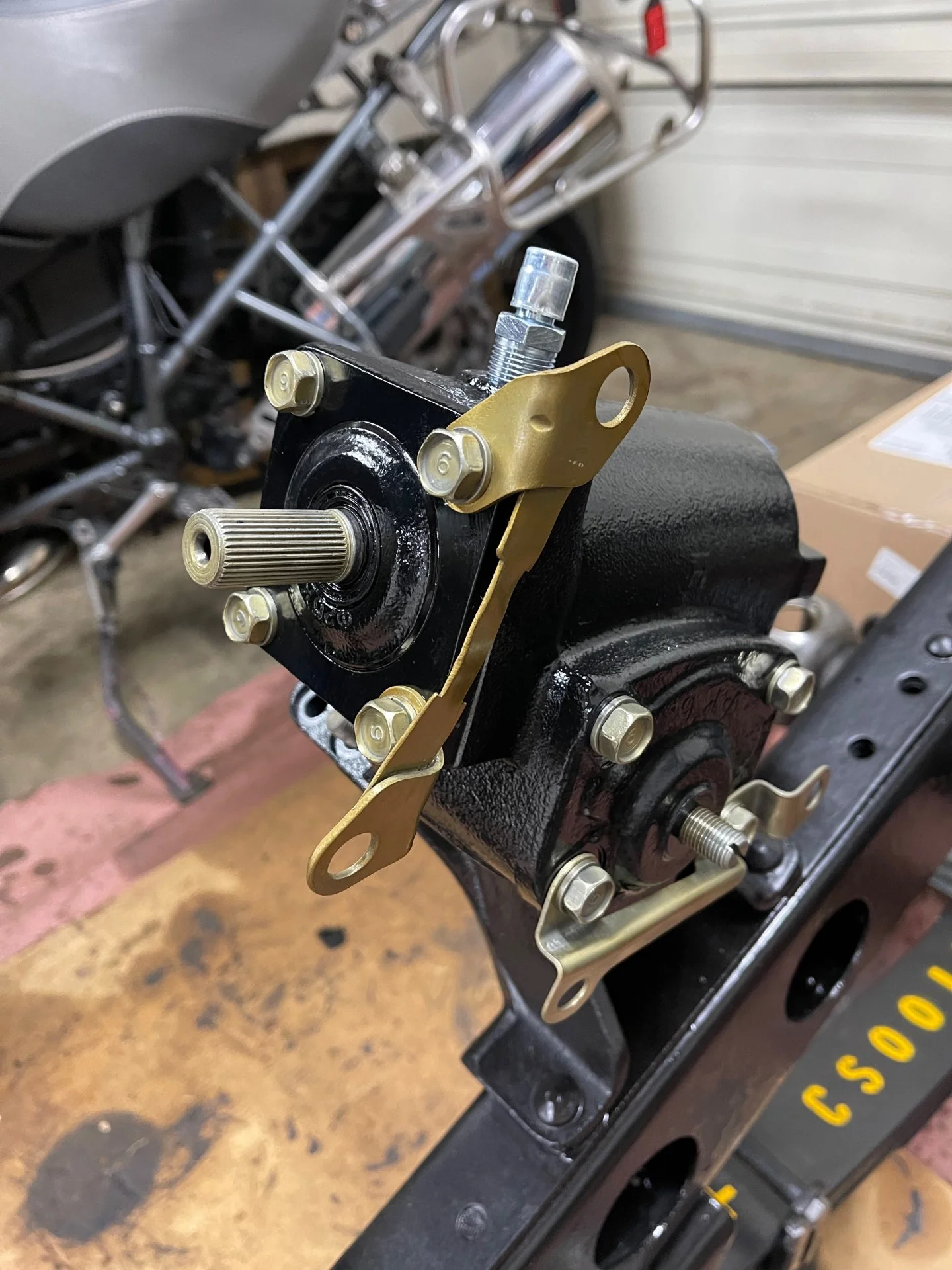

The part is taken out, sprayed with distilled water and hung to dry. This is the final results:

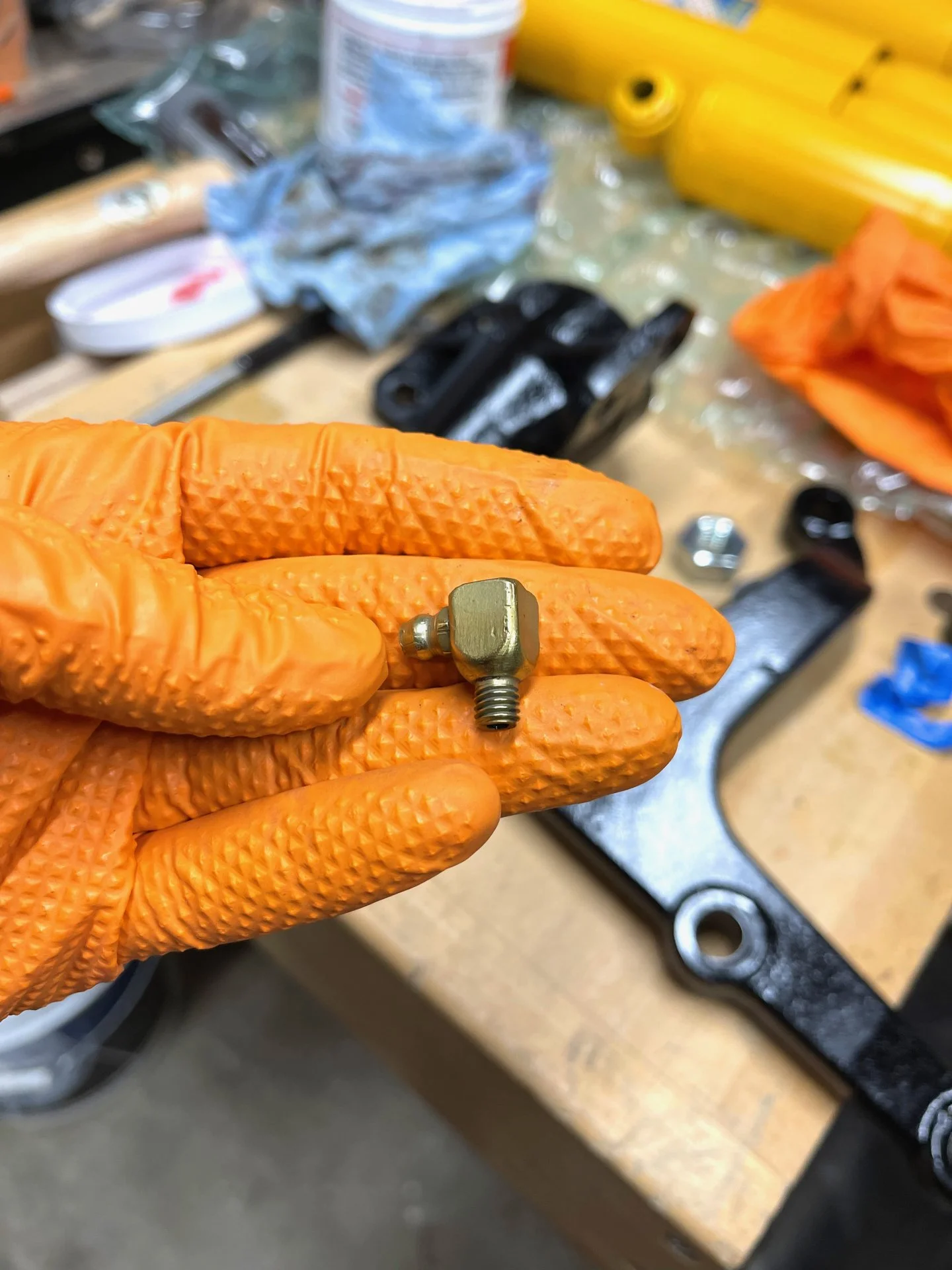

and the other piece (grease valve for center arm)
the yellow chromate solution I am using is from Caswell for ~$40 and I am happy with it.

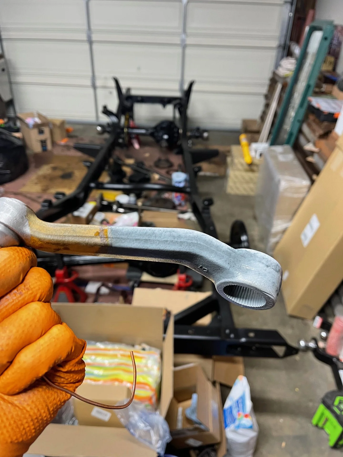

if only a portion of the part is dipped in the solution to plate, the other part of the piece will rust very quickly. This is because of vinegar and salt. Here is an example of this on a test piece:

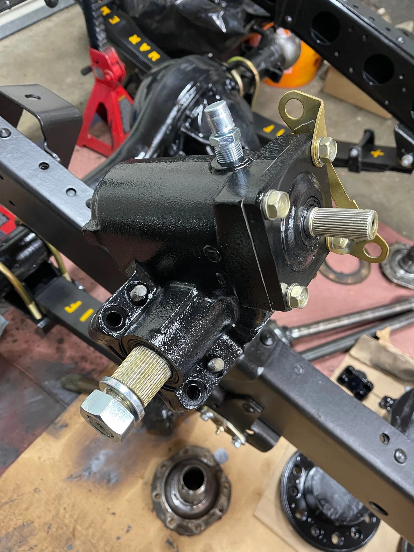

and all put together:

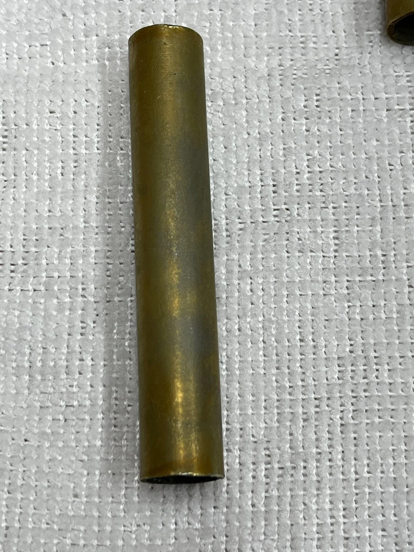

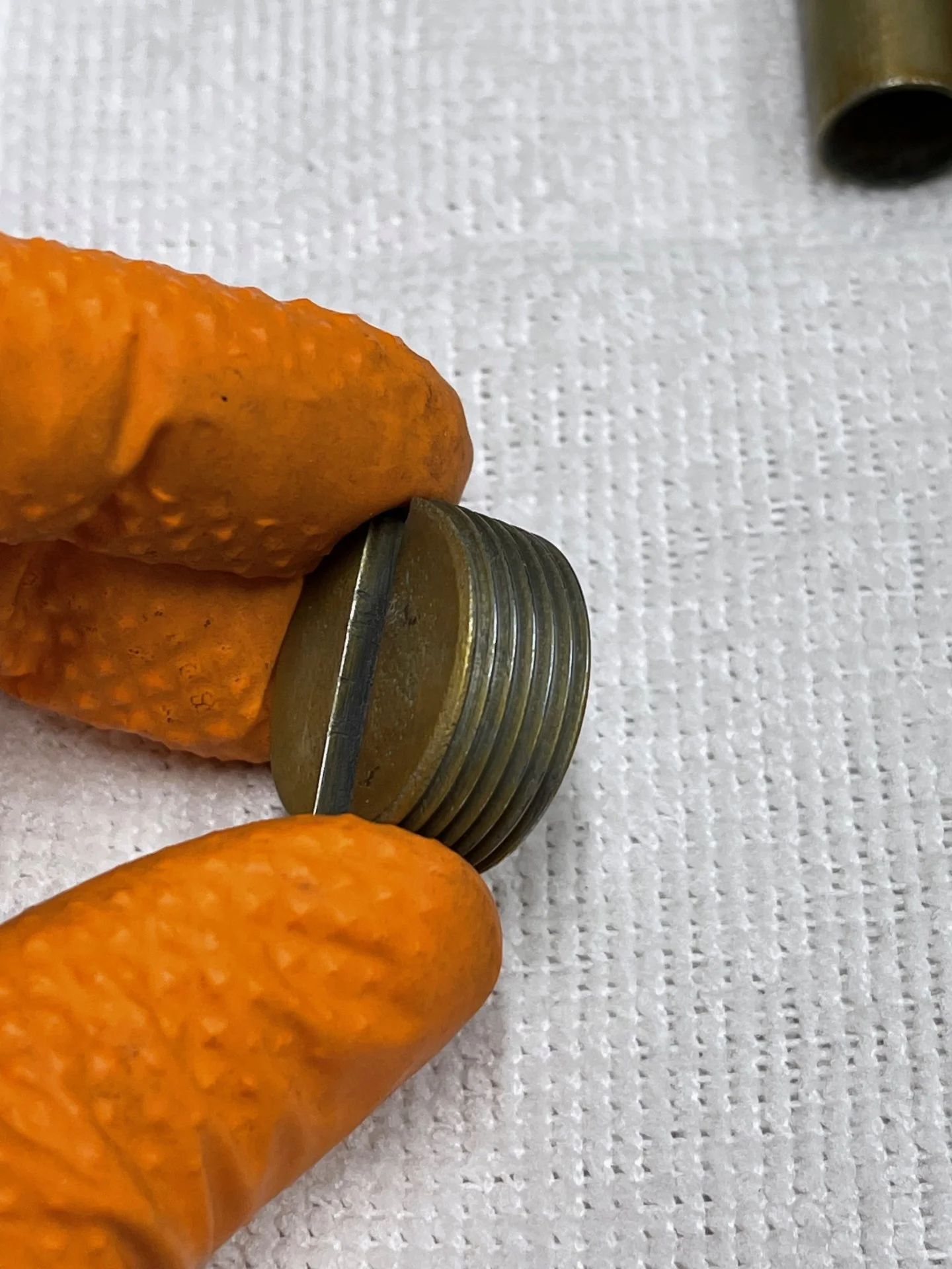

couple of more good plating:

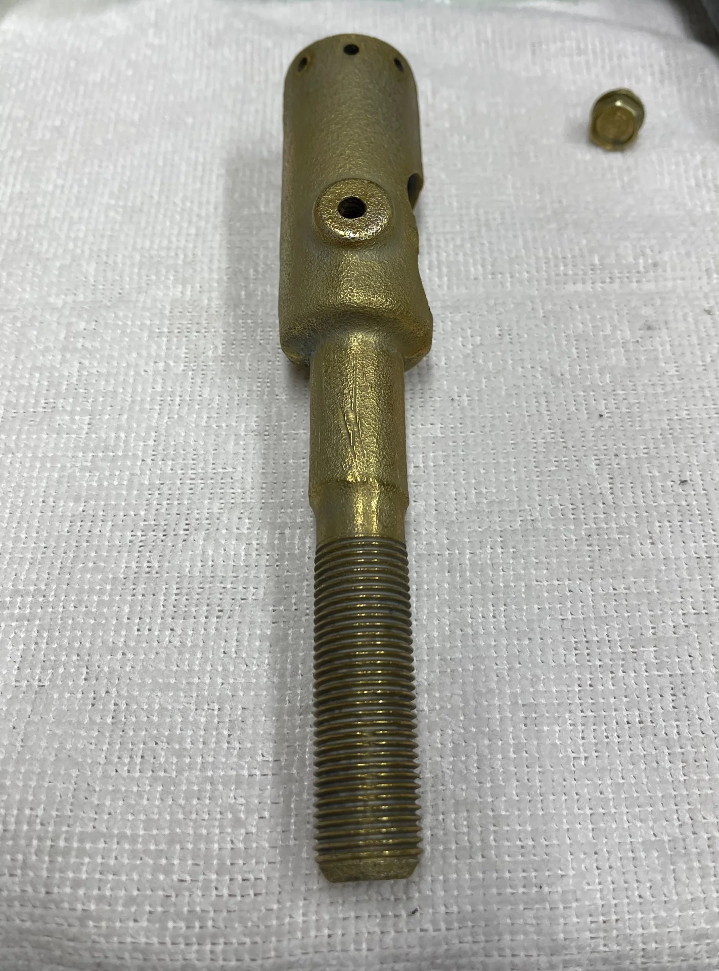

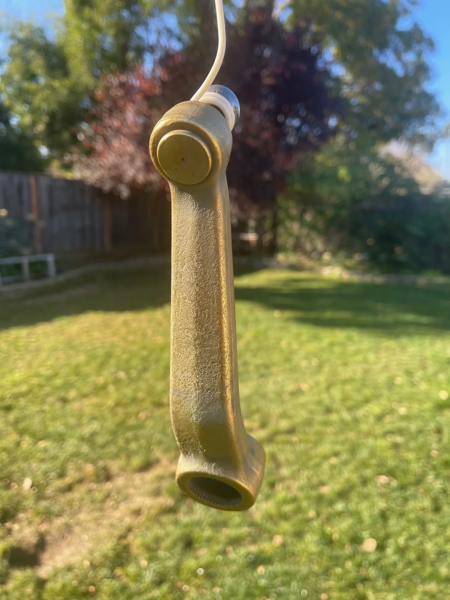

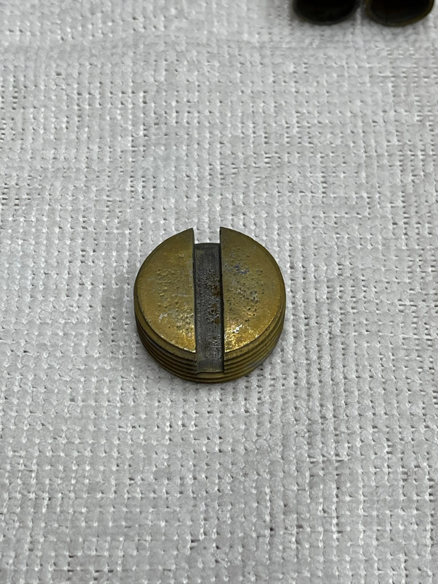

I'd say my success rate is about 85%. Sometimes the part is either not completely clean of rust, or grease prior to plating. And other times, after plating and polishing the yellow chromate doesn't stick to the part well, or has a darker color. I've discovered that if you're using acetone to clean the parts, you have to really make sure there is no residues left on the part. And after it's all done and you leave the part to dry for a bit you can usually see the portions you didn't do a good job with as the un-plated/exposed metal rusts pretty quickly as seen below.
dull yellow chromate:
unsuccessful plating:
in the last two pictures above there are two reasons (that I know of) the piece didn't plate well: 1- not cleaning the part well and 2- I haven't had luck with hard-to-reach areas of the part getting plating. By this I mean it seems that the portions that are not in direct line of sight with the electrodes don't get plated. So any inner piece of an object doesn't get plated in my experience. I've tried rotating the part but so far have not had any success. If you guys know more please leave comments below.

- this way I can plate portions of a piece, like the end of the steering worm, or where the pitman arm goes. I’m sure if you ask a plating company to do this they would but probably at a higher cost.

Zinc will cold weld easily, you may never get that pitman arm off again.
Thanks for the tip. But it also melts easily, so I’m sure it won’t be more difficult (if not easier) than the rusty one I just pulled off. I still prefer a non rusty pretty looking one.
But I’m curious, shouldn’t your point be valid about every single bolt and screw on the car? They’re all Zinc plated…
They are not all tapered splines under a great deal of compression.
Got it, thanks for pointing out something I didn’t know about. I will read up on it a bit. The Zinc layer in electro plating is very thin ( in microns) so I wouldn’t have thought it could potentially lead to cold welding and making it difficult to take things apart.
I am hoping I don’t have to take off the pitman arm anytime soon (leaving that next struggle to my son when he grows up) but meanwhile is there something I can do to reduce the likelihood of it ceasing? Like anti-cease or grease?

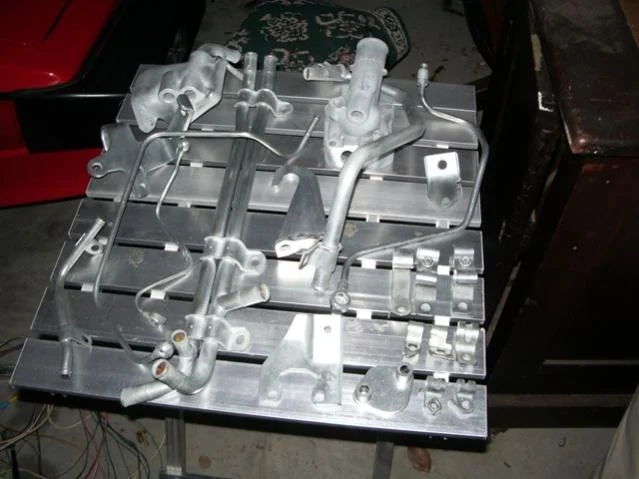

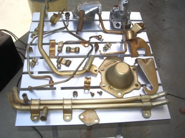

zinc plated some parts for the 3FE, I used a heater in the chromate bath to help it work better.
Very nice and very consistent color. Your bucket/container must be very big. I thought about using a plastic concrete mixing tub for the big pieces but haven’t got there yet.
I got a cheap aquarium heater to use with black chromate but haven’t used it with yellow chromate yet. I will give it a try.
Beautiful job! The yellow chromate looks great and is correct for many parts, if that is your thing. I'm sure if it is a Concourse restoration that won't be subjected to weather like a daily driver, it will be just fine. I am looking for a little more protection, however, and leaning toward nickel plating.
