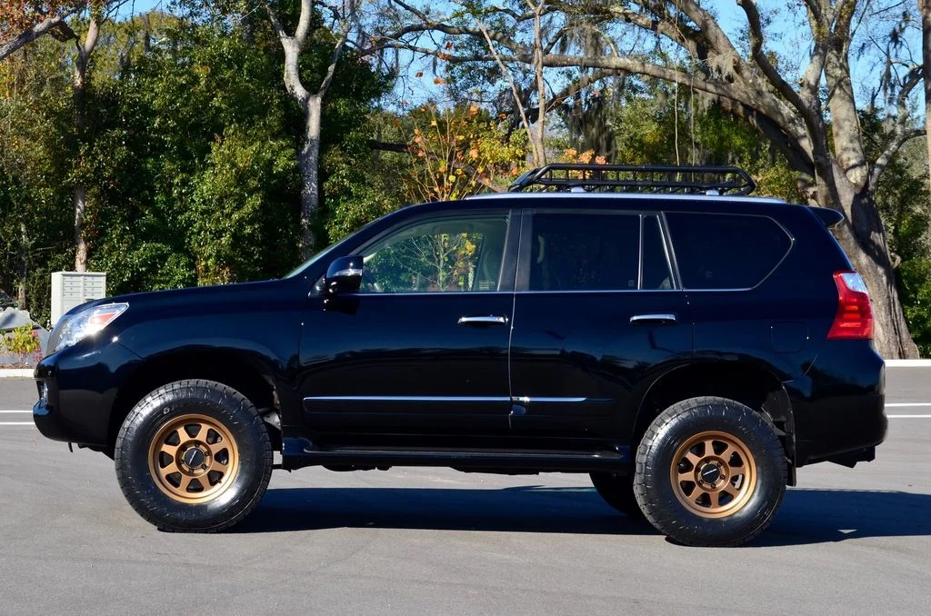

Most are running 285/70r17. If you do an image search of the gx460 with the method nv wheels that’ll give you a good idea of how it will look. I believe the nv is also 0mm offset.

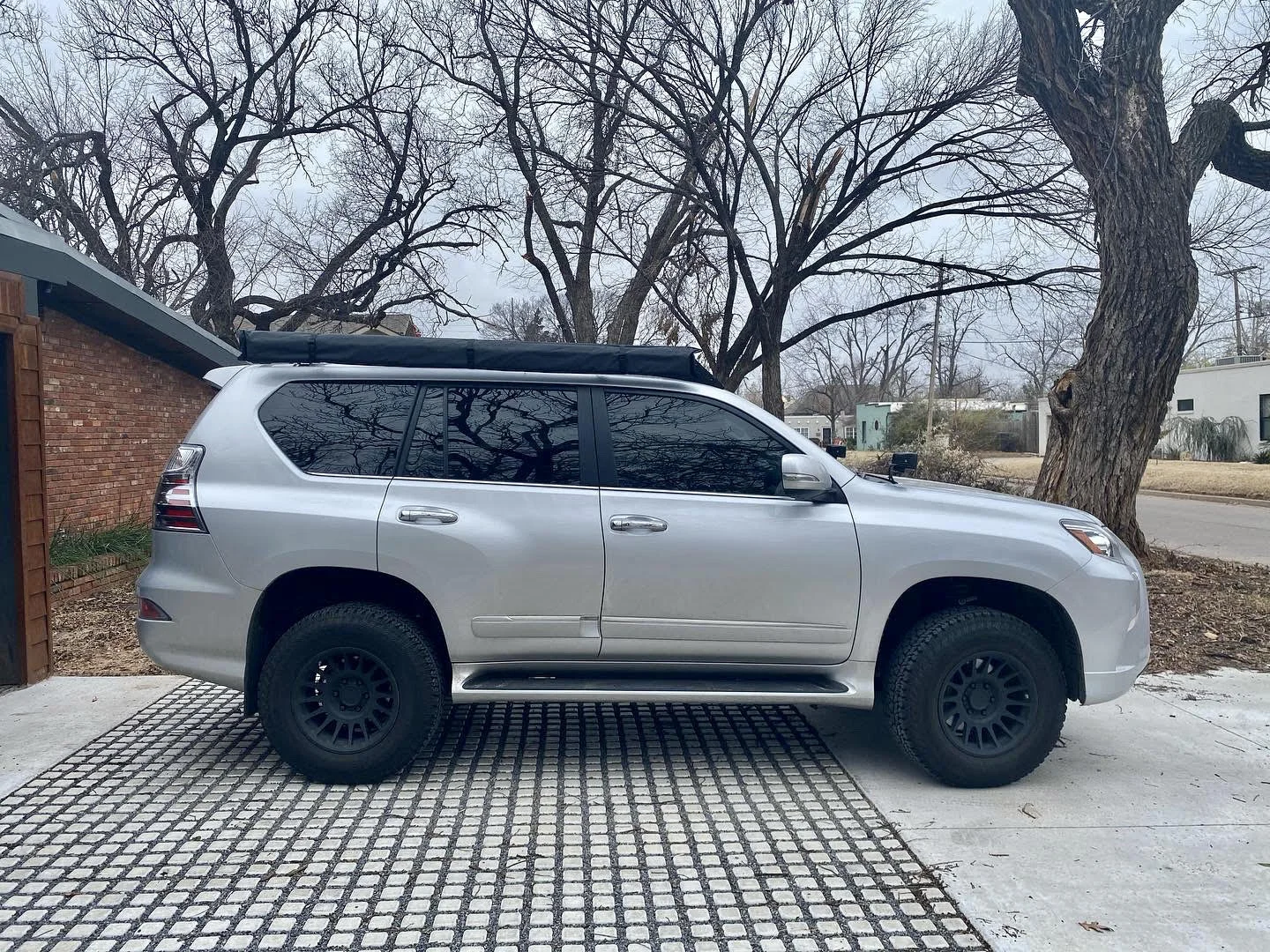

Here's mine on 17x9 ET0 Black Rhino Bullheads with 275/70R17's

Looks good. Did you have any issues mounting the spare 275 in the stock location?
Still running the stock spare until I get either the JW off-road door mount or a swing out
