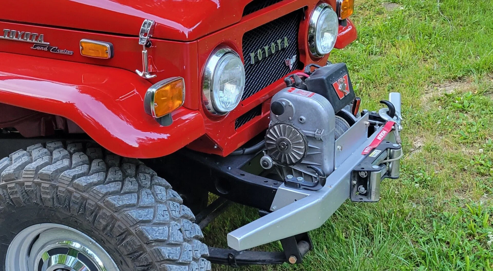

My accomplishments were not nearly as extensive as others. In the spring I installed a cam and lifters i had laying around into my 350 sbc, only to find that the po's idiot engine builder put 305 heads that had been decked to the max on the engine. On a positive note, I plugged the hole in my bumper with the winch I rebuilt. In 2024, 1st on the docket is upgrade to FJ60 knuckles, then install a set of Vortec heads. Time willing will be a drop down tailgate and repair and install a better windshield frame. Oh I almost forgot, I did get rid of the plate style tire carrier and painted and adapted the later tube style carrier.

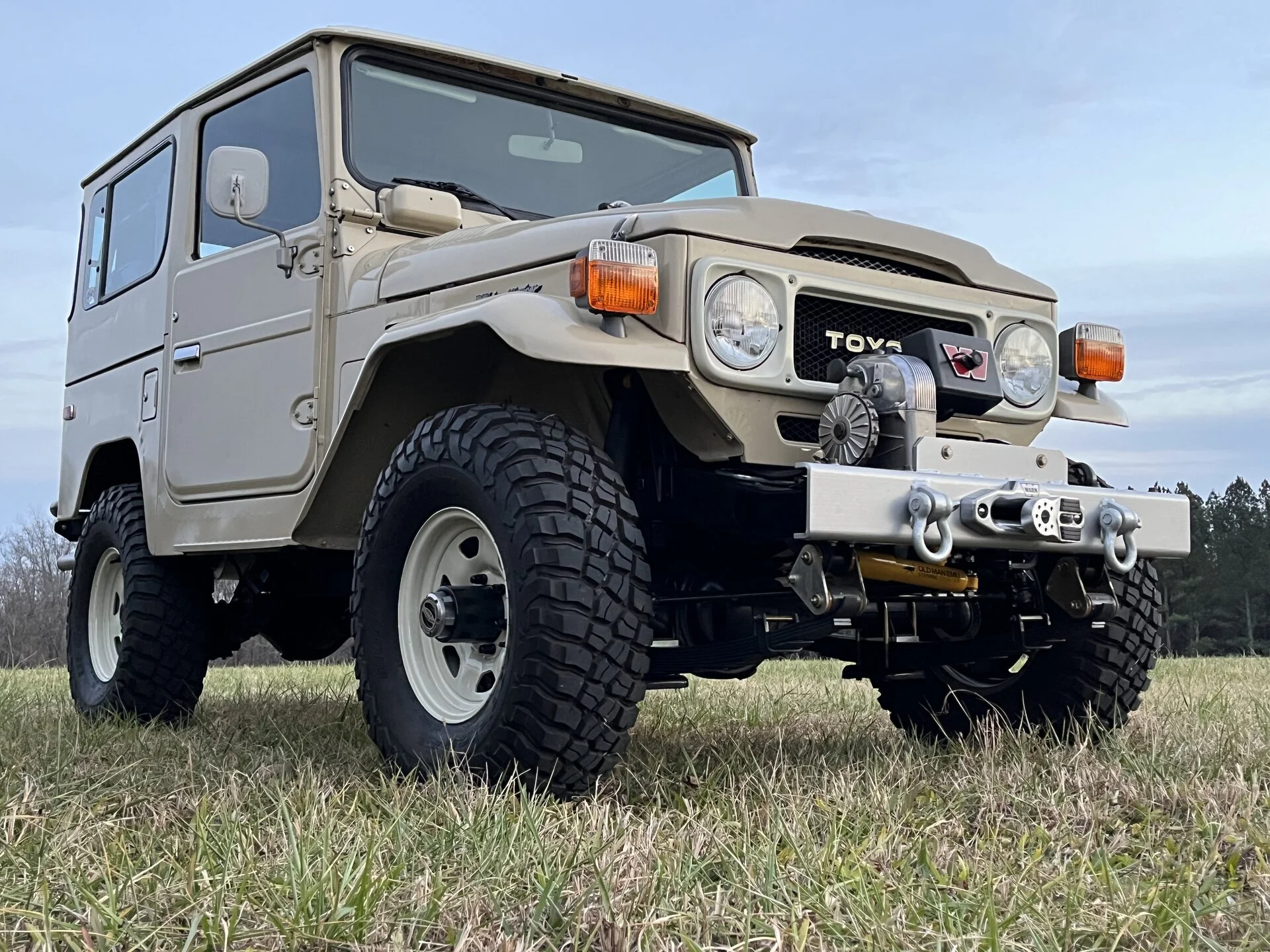

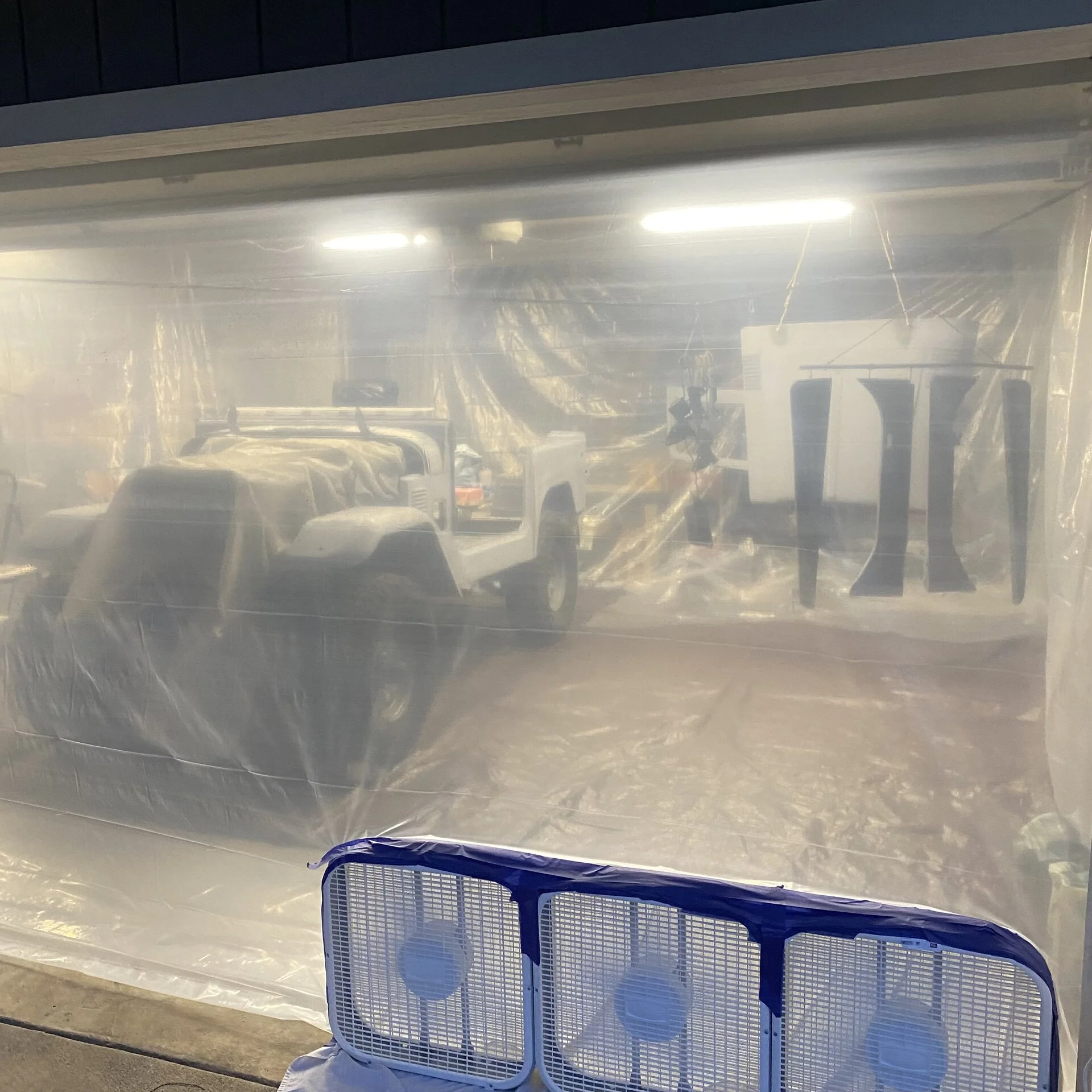

It’s been a big year for my 1975 Fj40 project. A couple of big accomplishments as well as some first time on the job training experiences revolved around the paint and bodywork.

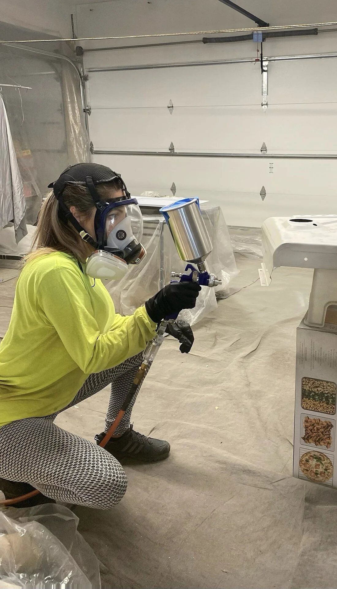

It was my first time helping to construct a garage paint booth

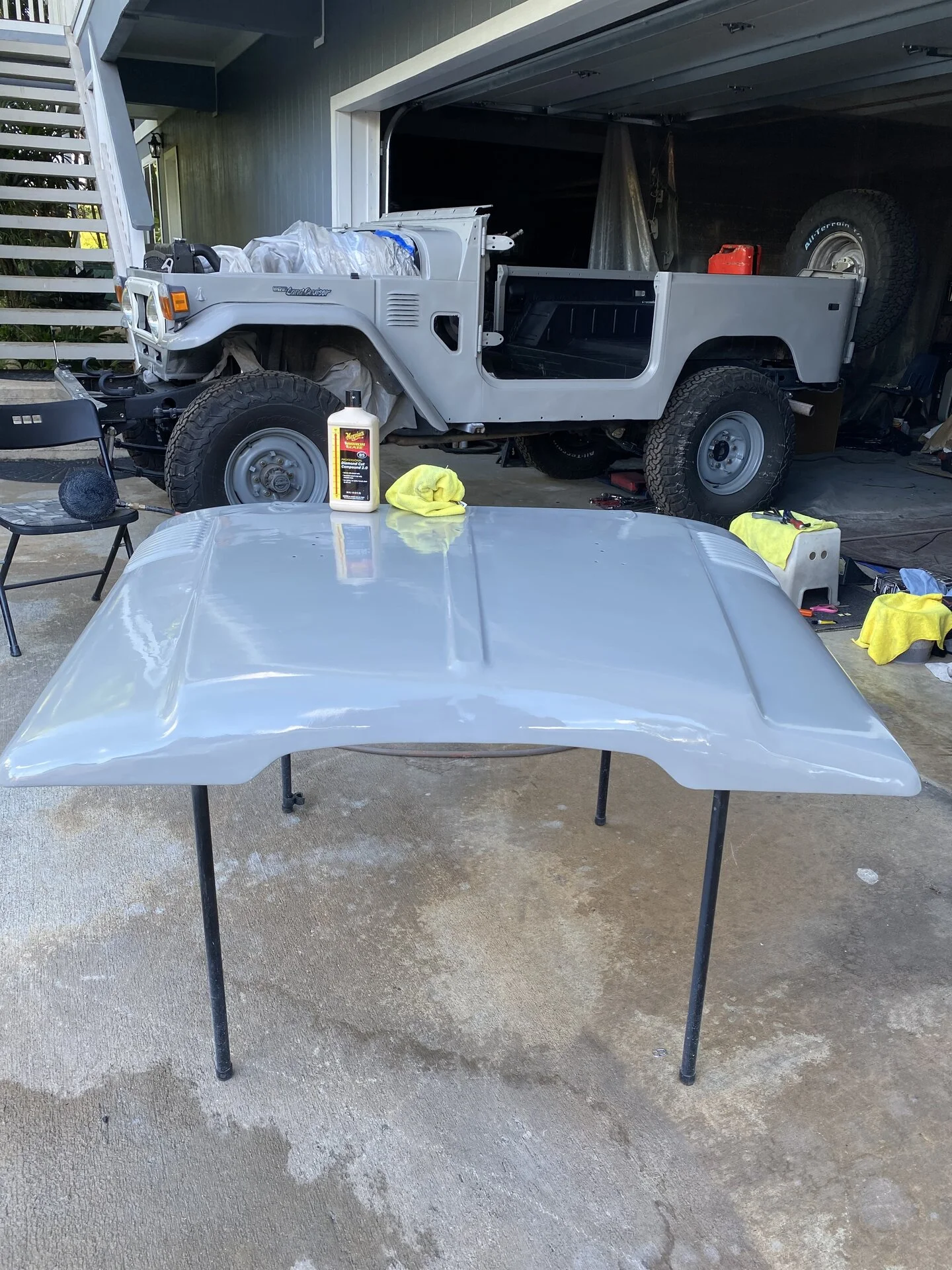

First time using an automotive paint sprayer, wet sanding (and more wet sanding), then cut/buffing single stage paint (Toyota Dune Beige in case it wasn’t clear from the pics).
I didn’t do it all of course, as I am very fortunate to have much more talented friends and family to teach me how to do these things. But the small part I contributed during painting was very fulfilling because I learned some new skills and gained a little more pride in this project. A project that is wrapping up and one that I will hopefully be driving very soon!!

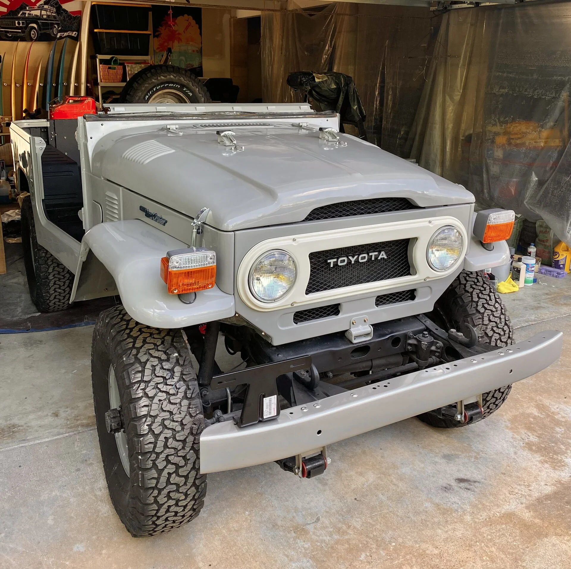

The finished paint job and some new OEM hardware

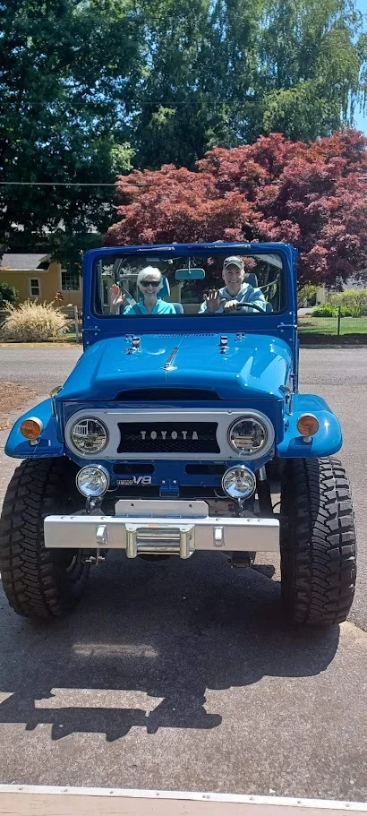

I like the small badge on the grill, a tasteful nod toward what's under the hood. Where'd you get it?

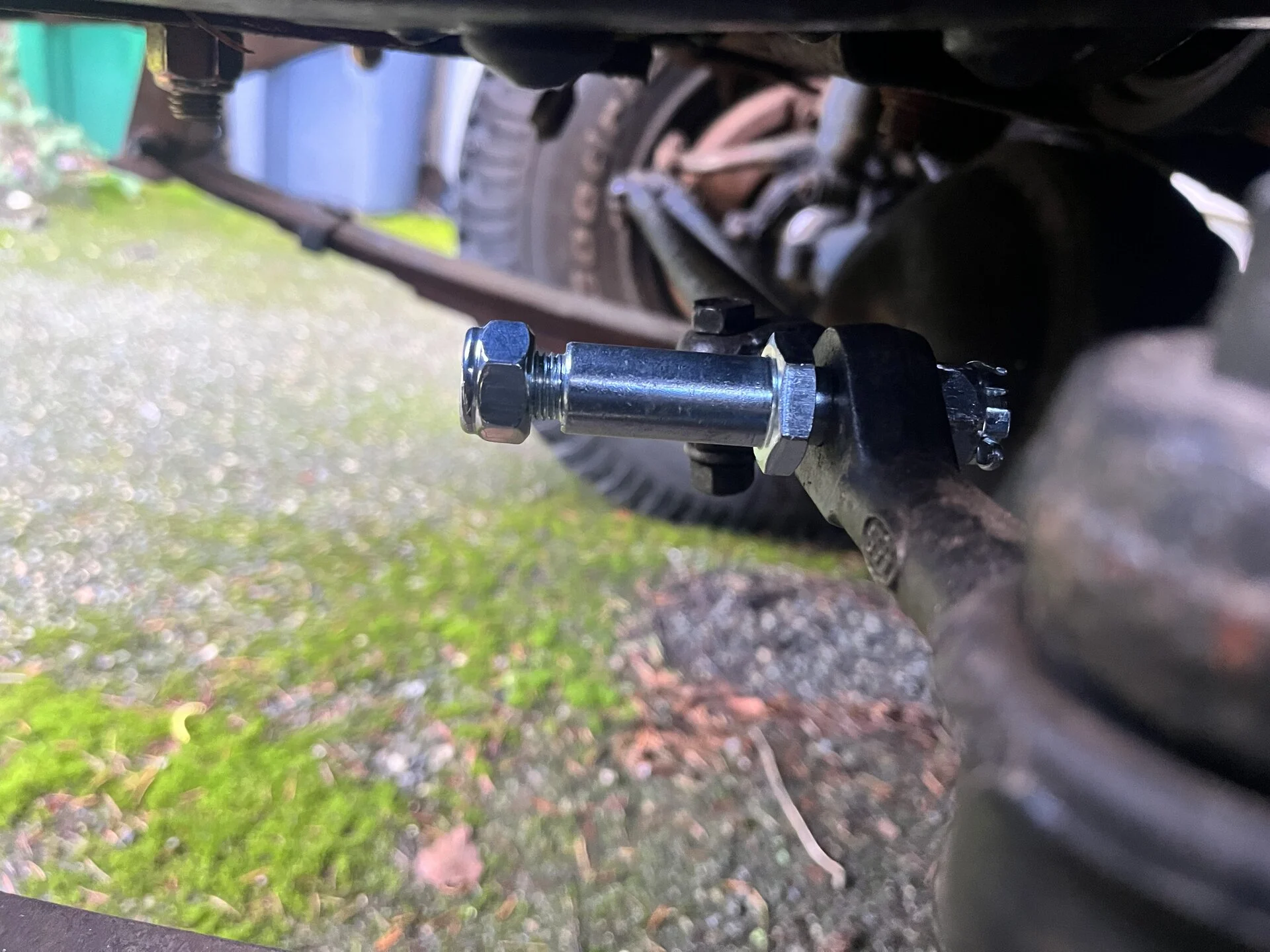

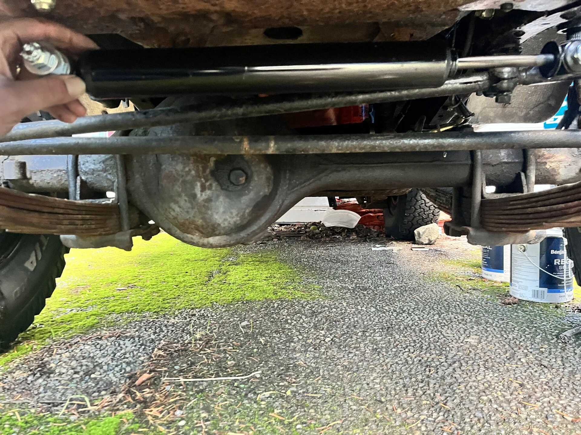

Finally a step closer towards finishing my p/s conversion. Bought a $10 1:10 tapered ream and reversed the taper in the mini truck TRE so that a “60 series” steering damper would mount to it. The HSS taper from Ali Express worked great till I broke it… fortunately the task was done.
