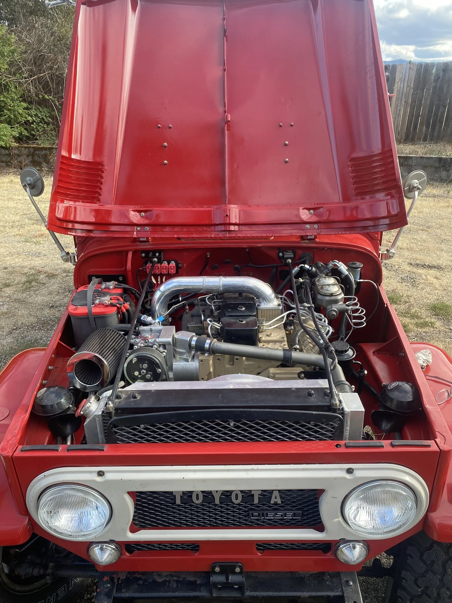

That is much improved over 11 with the F series motors. Plus it makes comparable horsepower and torque to a 7.3 IDI diesel that Ford used in the 90s in 3/4 and 1 tons. I had one that made 180 hp and ~300 ft pounds of torque and didn't get good milage.

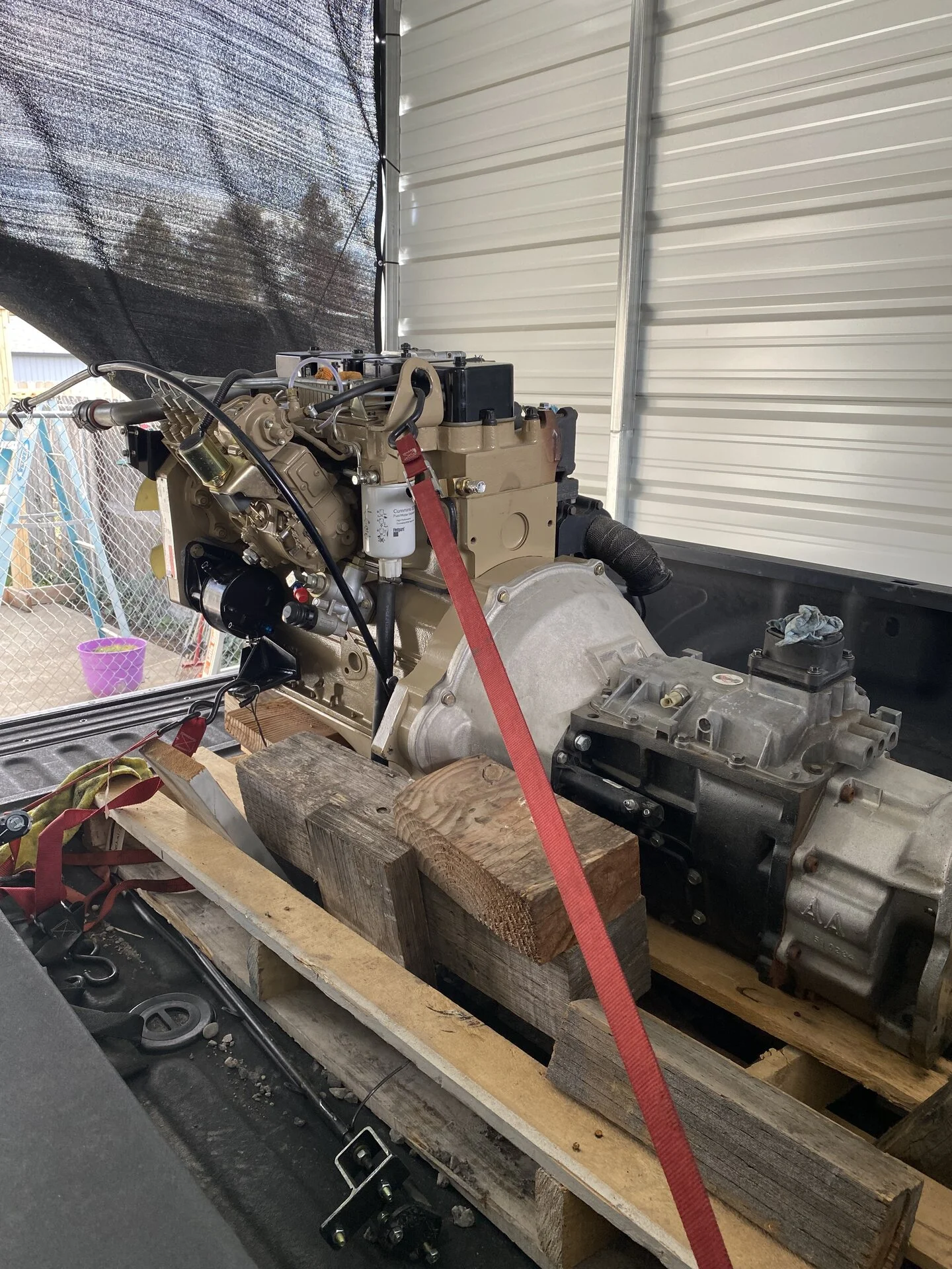

Completed a heart transplant in my 1966 FJ45 LPB. Out with the old F engine and in with the Cummins 4BT. New NV4500 transmission and a 87 FJ60 transfer case. Lots of other upgrades a well…FJ60 seats, FJ60 axels, Dakota Digital gauges, Vintage air and much more. Very pleased with the selective surgery 😀 waiting on my late model front window to be painted so I can get it installed.

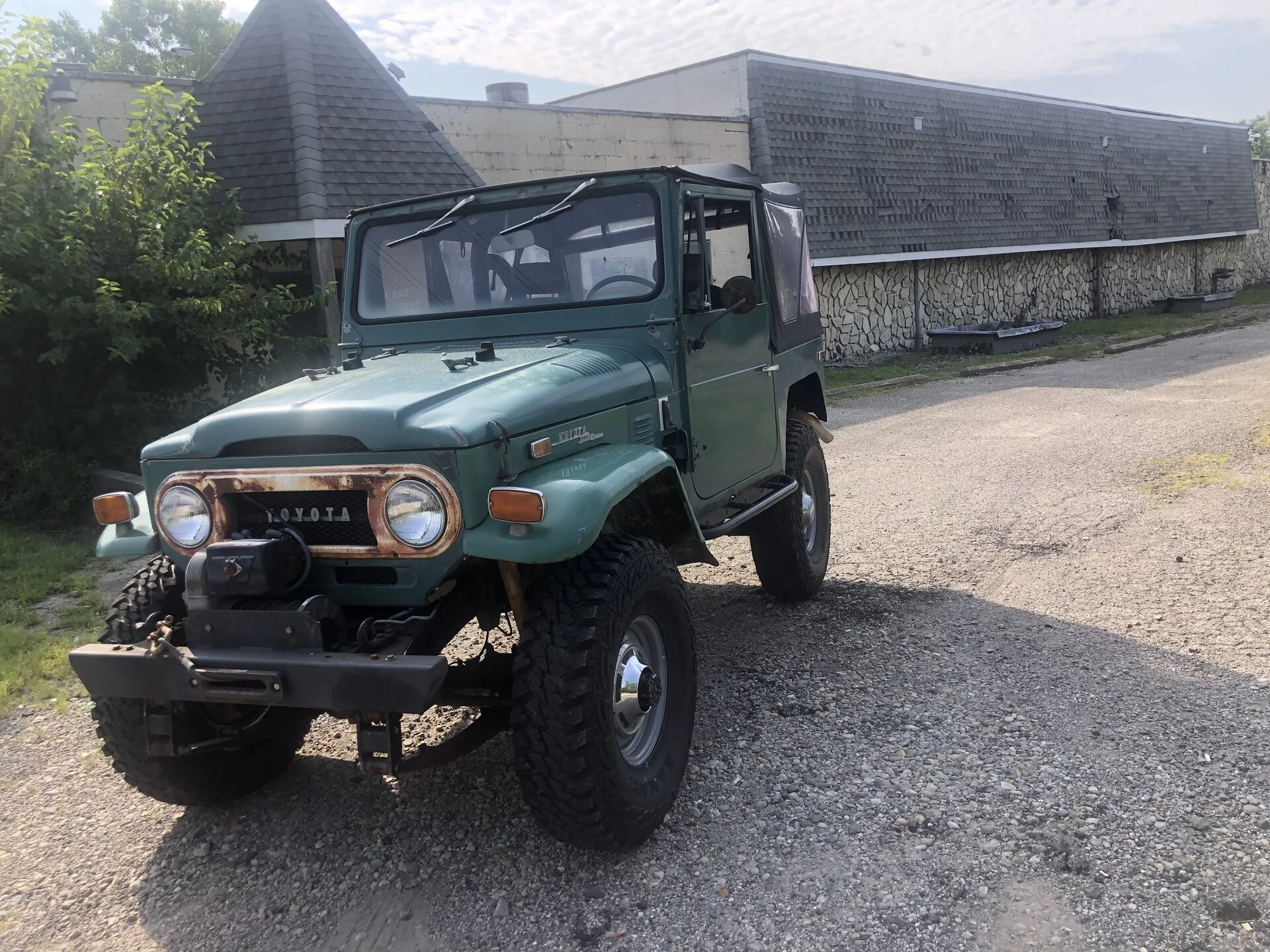

@lukefj80 helped me get it running after a couple of years being down. Swapped out the Krawlers for some 35x10.5 Kanati MTs. Bought and installed my 4plus tire carrier from @lcwizard before the doors closed. Found, bought and installed nos Kayline top on my old bows.
2024- fix my leaking rear diff cover, check out to see if my rear axle seal is leaking again or if it a wheel cylinder. Hopefully pull a leaf or get some shorter shackles to lower it down.

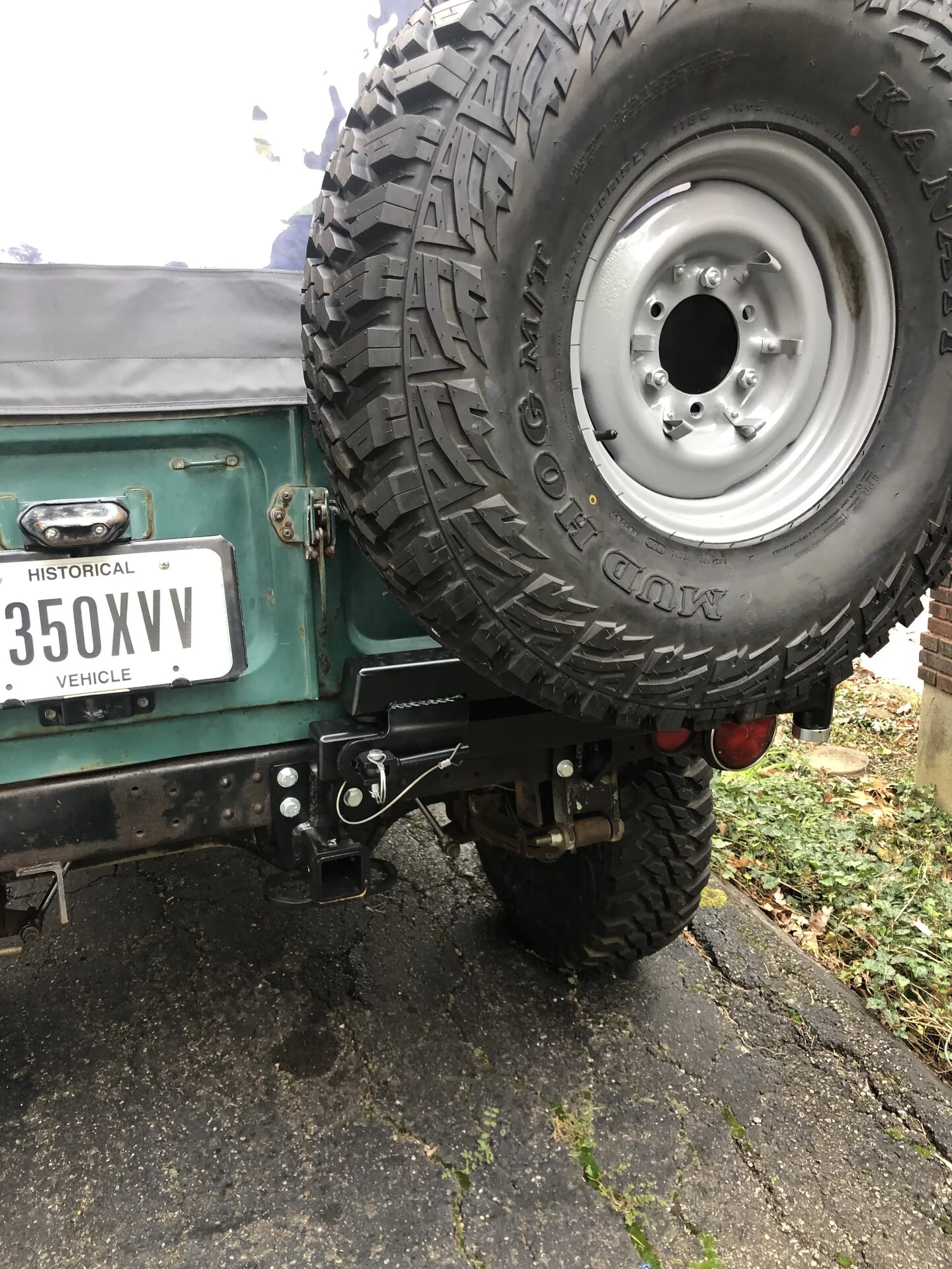

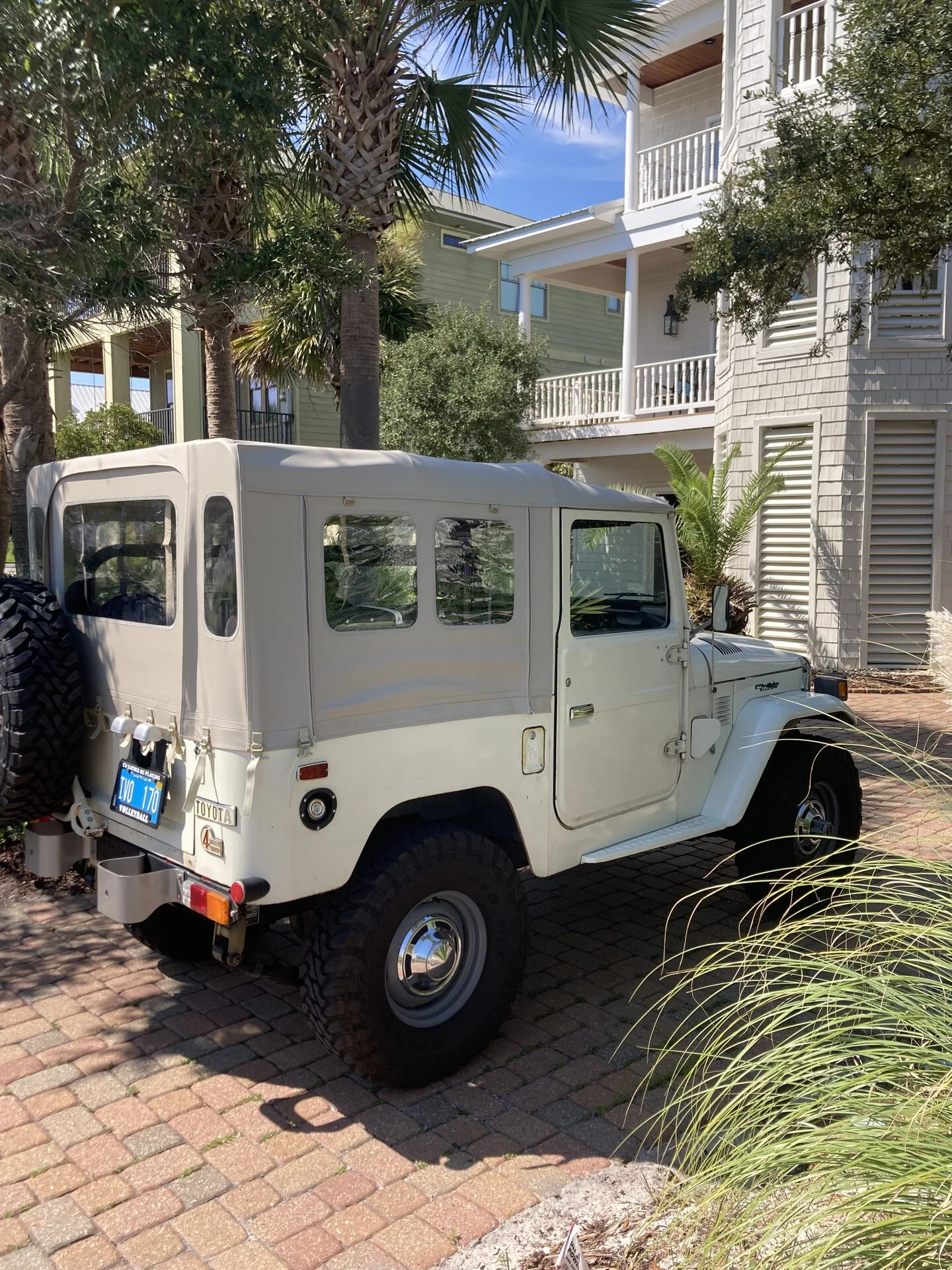

View attachment 3518998View attachment 3518999
I love the way it sits now. Great looking rig! Cheers

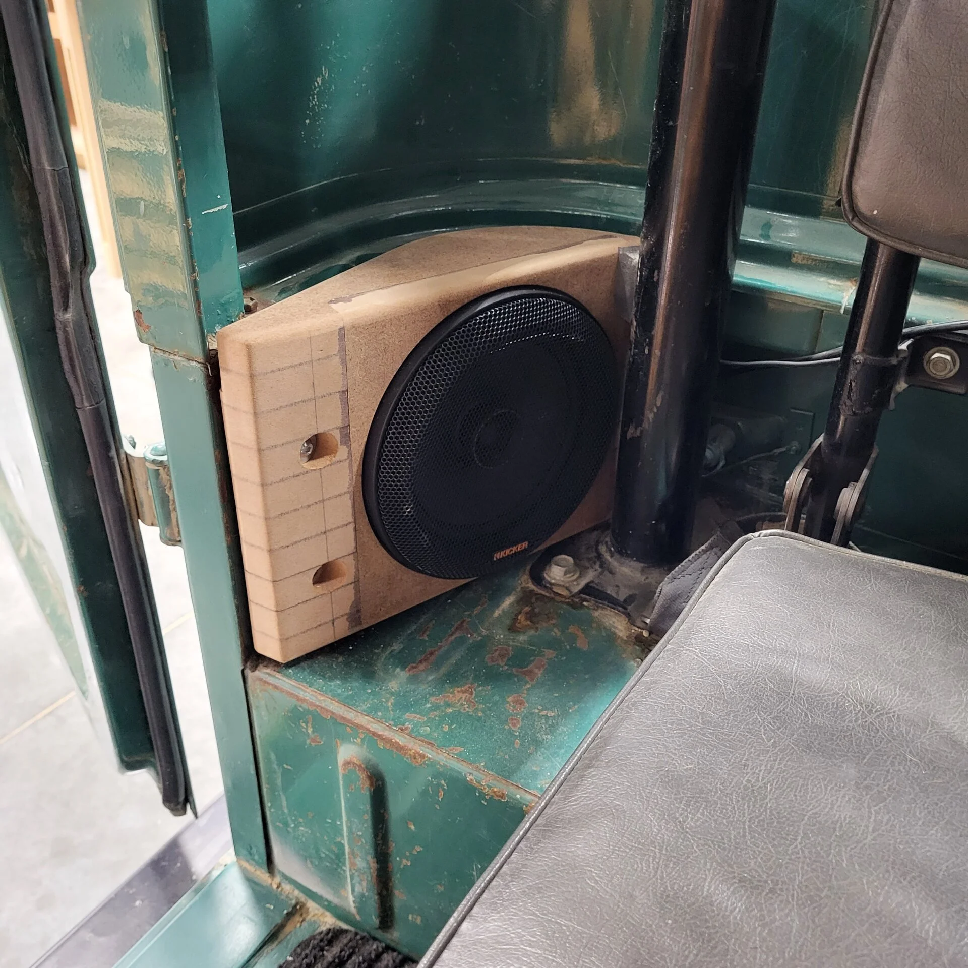

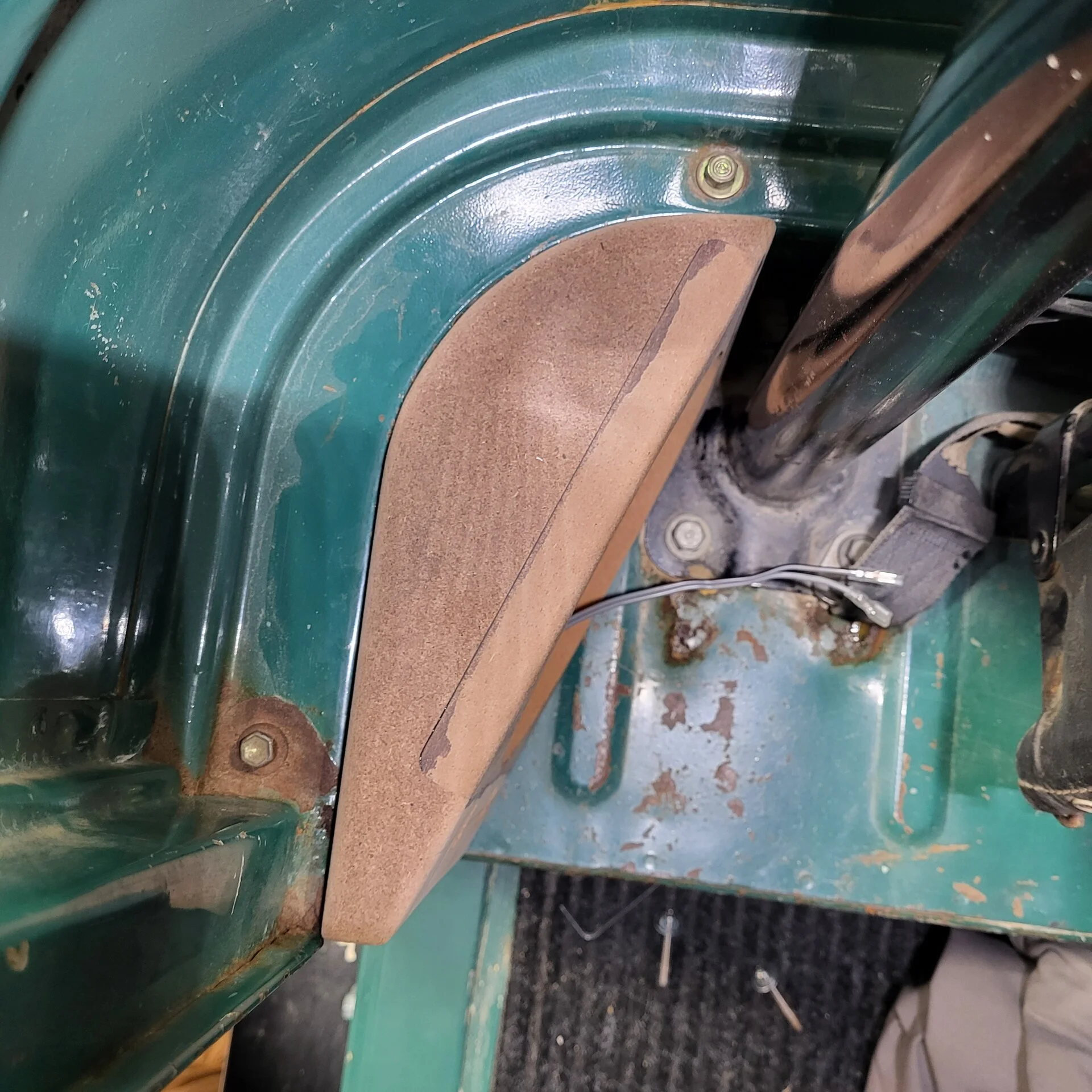

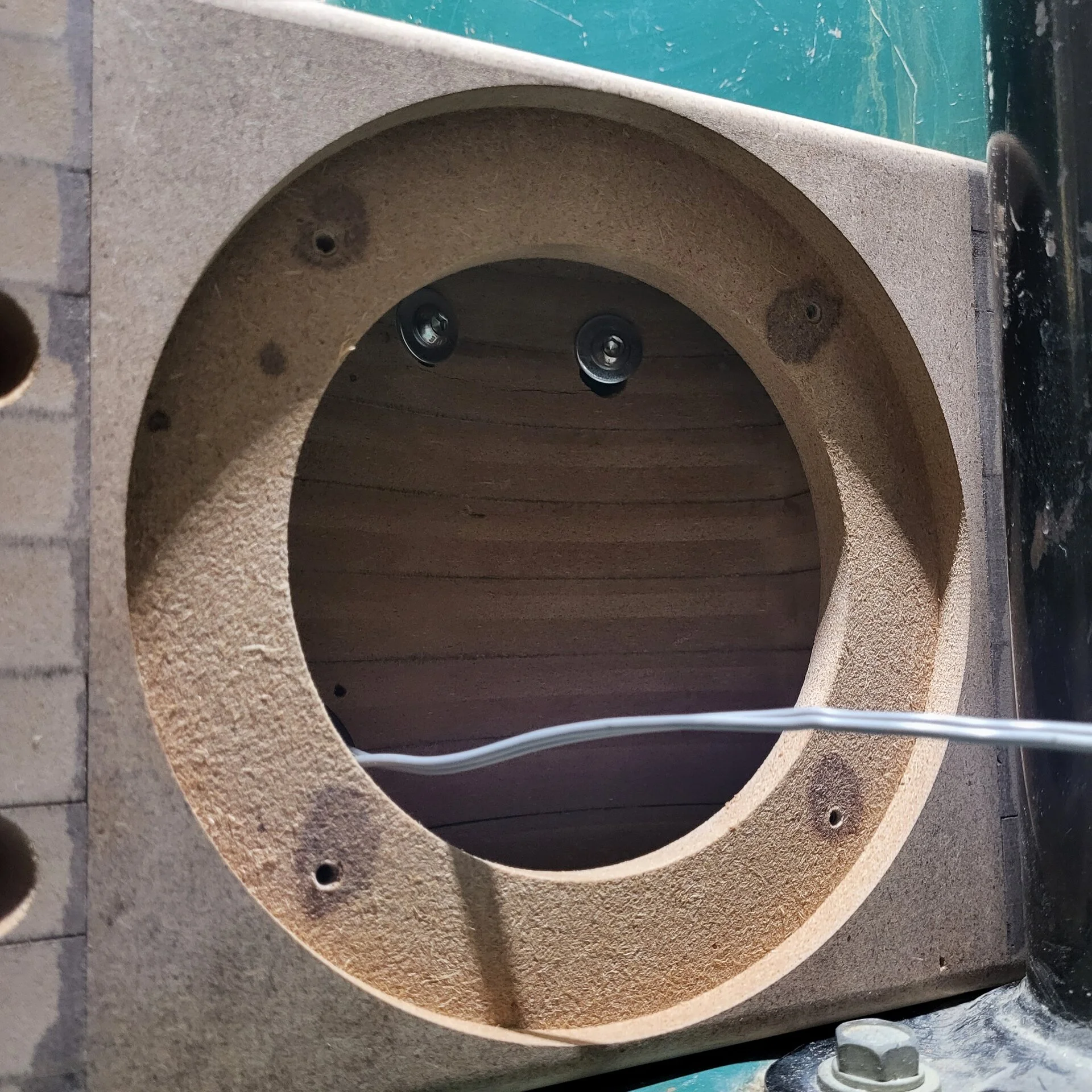

I think the only thing I really accomplished was pinning down a design for a mounting speakers in the back.
Other than that, had lots of adventures. Snow wheeling in Wisconsin. Solid Axle Summit. Wheeling in Missouri. Playing in the woods at my brother's. And a trip to Northern Minnesota
Congratulations! Gotta have some tunes, that was an important mission. Good job and I like the placement.
I think I was 118hp and 243 ft/lbs on the dyno, at the wheels.

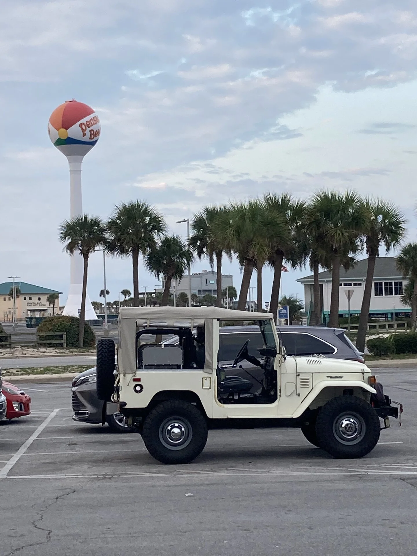

2023 -
Engine rebuilt with JimC performance pistons etc - took 2 years to get it all going right (firs
Some SMG pin replacements
Rebuilt center link, new TRE & drag link
Rebuilt steering gear box
4plus metal on front and back
powdered rear seat frames (roll bars and front seat backs to be the correct(ish) grey and uniform)
2024 - (steering and drivability)
knuckles, rebuild diffs
Dobinsons springs and shocks, etc.
4plus flip kit
4 degree shims
replace body mounts
replace worn rubber
Install correct roll bars
restore OEM front seats
finish SMG pins
some body work.
That is a big improvement over a 2F.

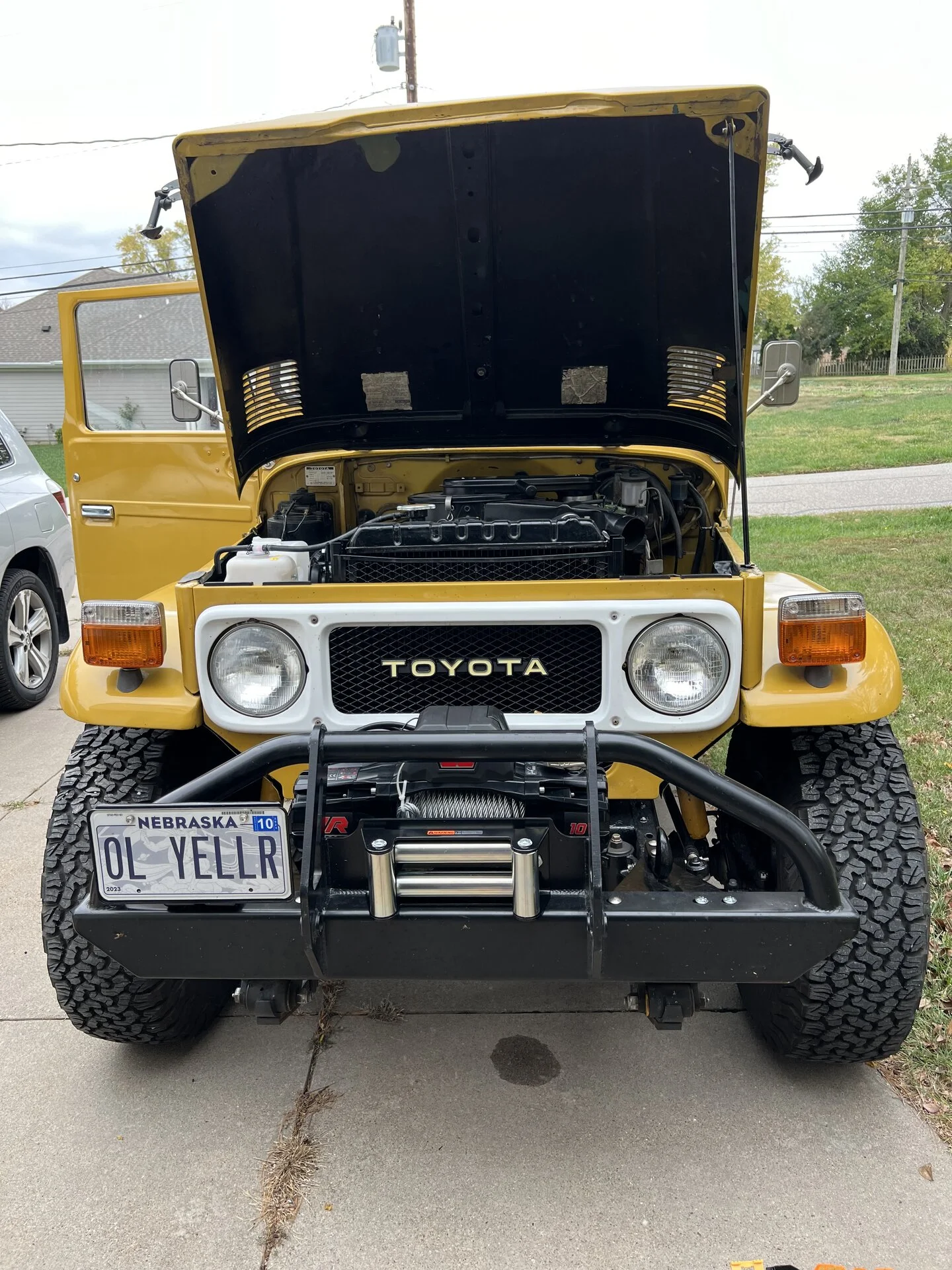

2023 -
4plus flip kit
4 degree shims
replace body mounts
replace worn rubber
finish SMG pins
some body work.
She’s a beaut.

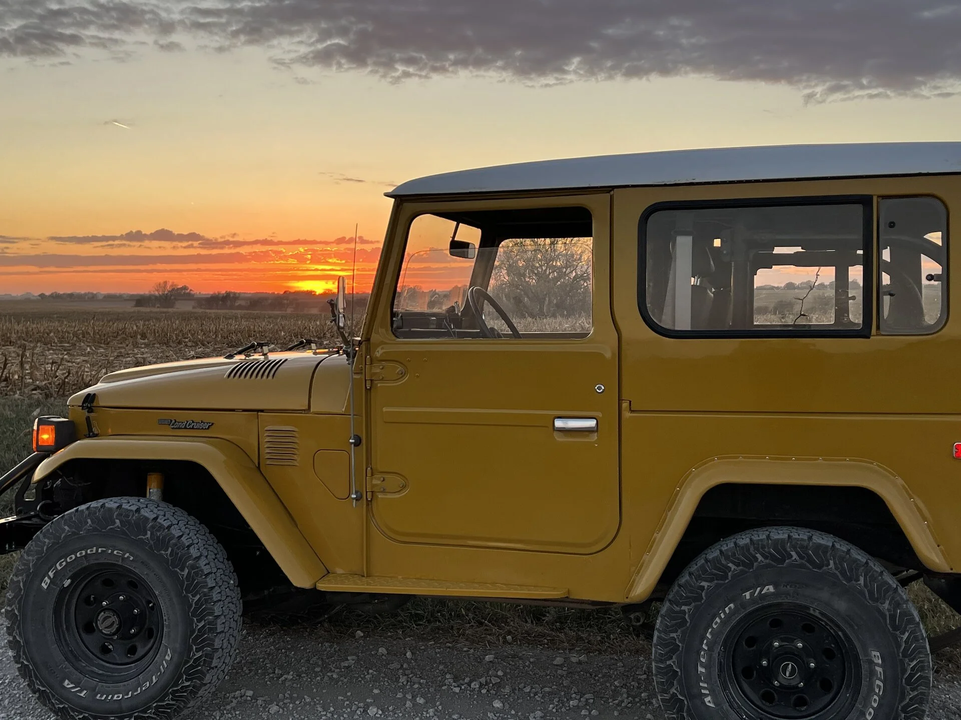

2023 -
4plus flip kit
4 degree shims
replace body mounts
replace worn rubber
finish SMG pins
some body work.
Wow, looking good. I've always loved this color on our trucks, now more than ever with that sunset! Bravo! Oh, love your license plate!

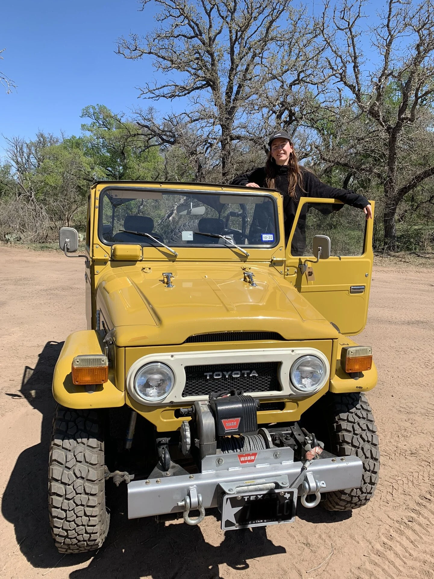

Surviving another year with the 40, let’s see that makes 37. Biggest mechanical accomplishment was rebuilding the mini-truck steering box. Best memory was having my youngest daughter make her first trip out to wheel it, we‘ve done a lot of hunting and camping but seeing her behind the wheel was great!
Kelly,
I remember this and remember thinking how much I want to do a trip with my daughter.
Inspirational and so glad to have seen it.

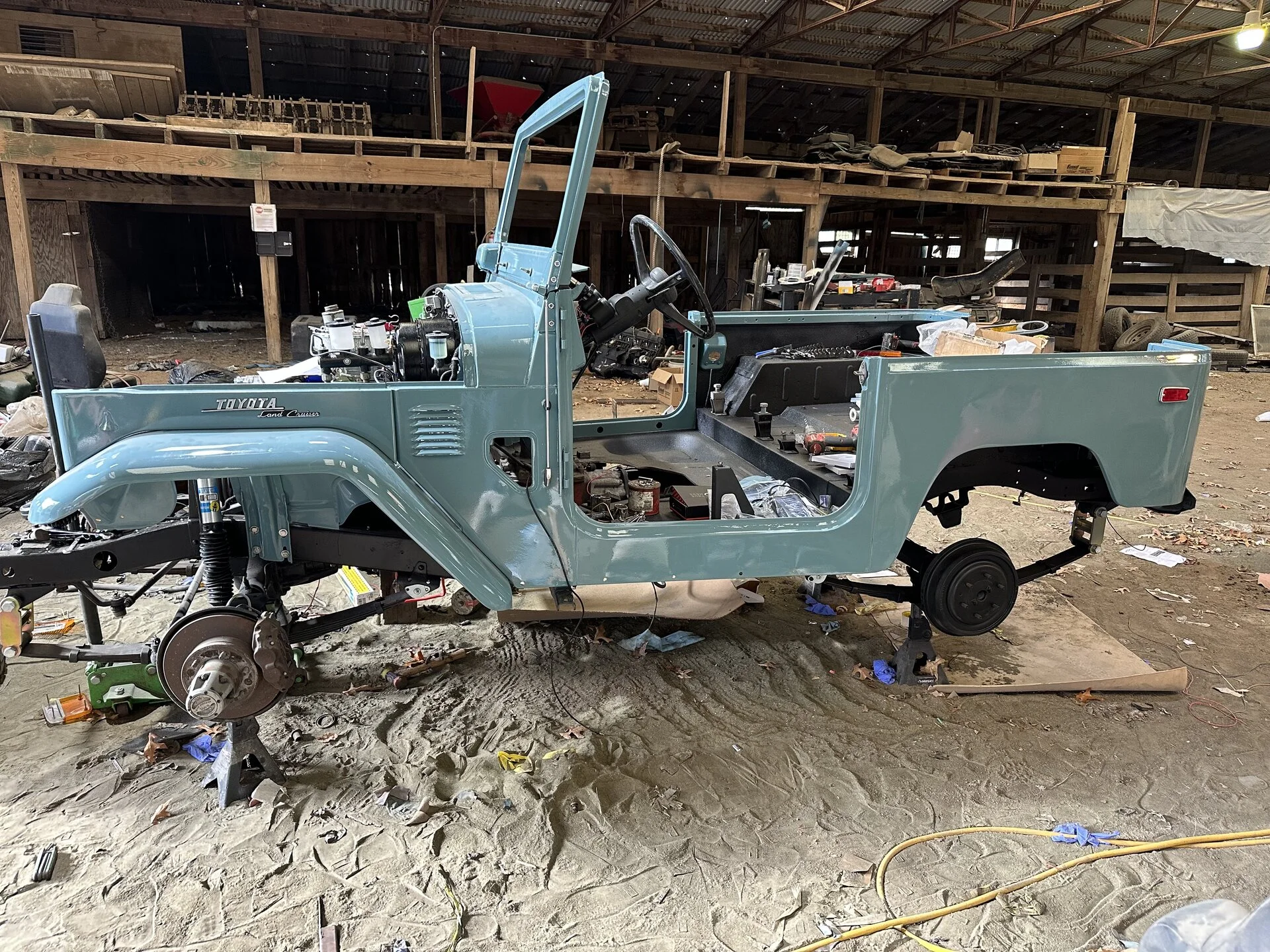

I ripped apart my 76, redid, pretty much everything and repainted it cut out all the rust just about done still a ways to go

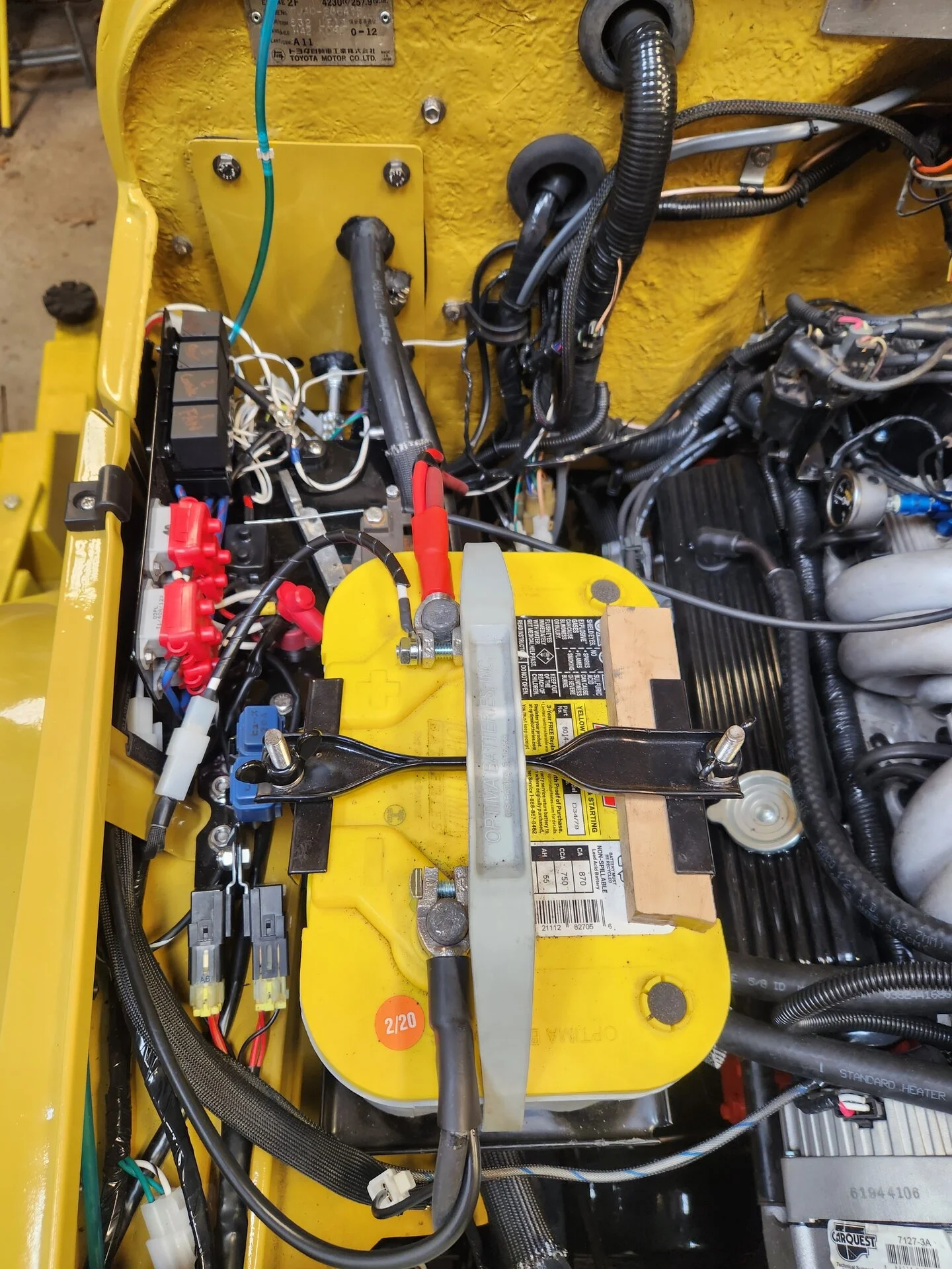

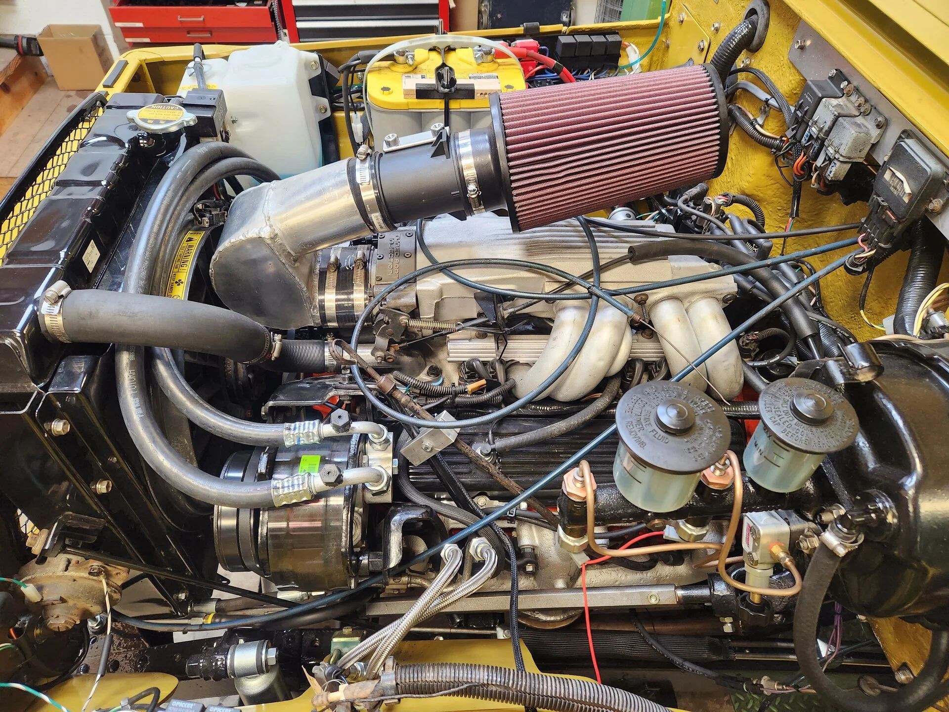

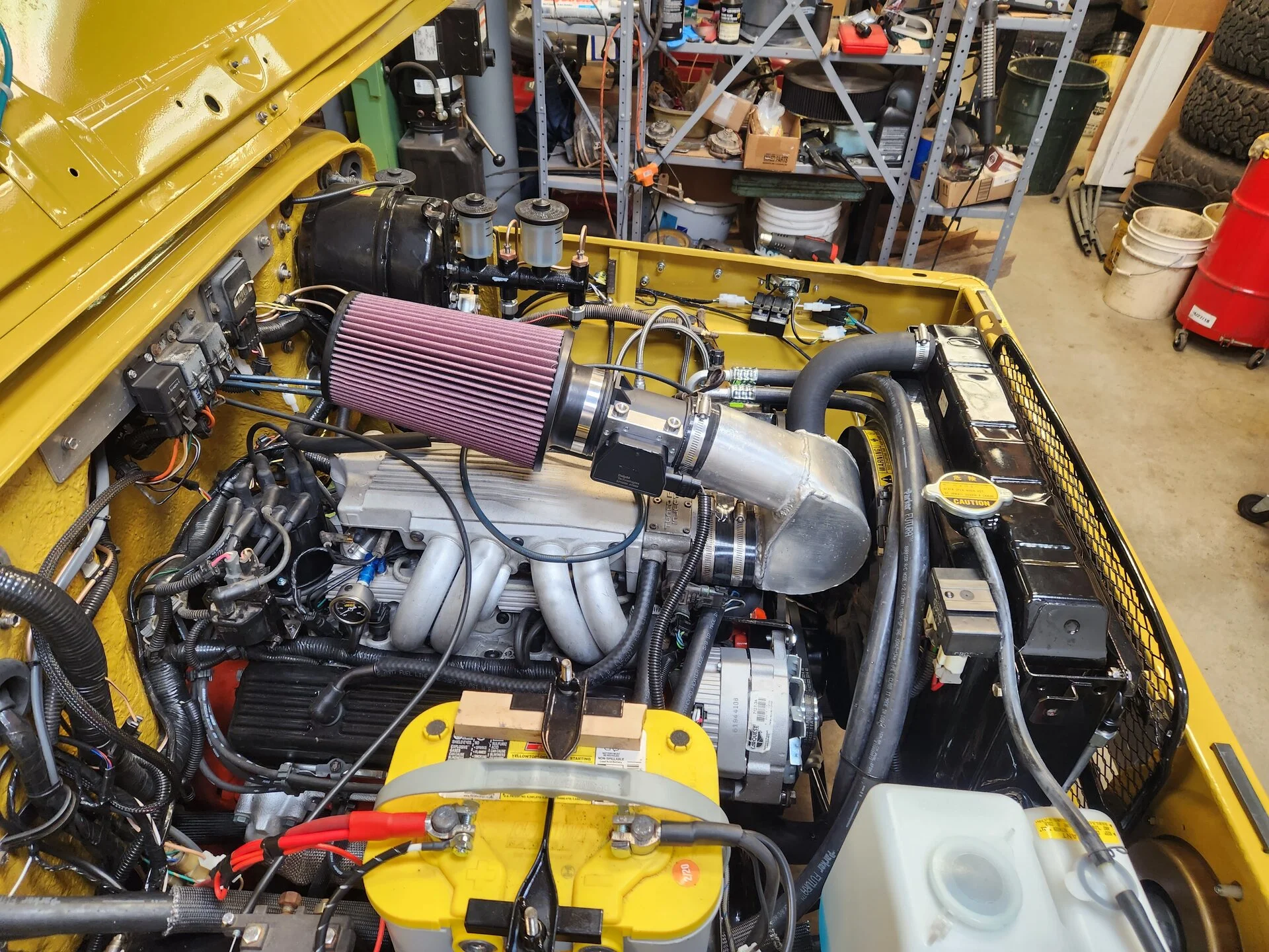

Finished up getting A/C lines and relays hooked up, now just a few things to clean up in the engine compartment. Still have to charge the system. On to rebuilding my winch so I can get it installed and cables routed through engine compartment.
View attachment 3521283View attachment 3521286View attachment 3521287
I’ve still got a TPI setup to bolt on… not this year.
Is that MAF? My setup is MAF and they’re more forgiving to changes from what I understand.
I had TBI on previously and decided I would switch over to TPI since I had it on the shelf over 10 years!
Yes, it is MAF, I heard speed density was better, but I guess everyone has a preference.
Mine is out of a 87 Firebird, mounted to my 72 350.
87 Camaro with a AA stand alone harness. I've heard some say MAP is better if the programming is right, but MAF is more forgiving to modified engines since it knows how much air is going in, how much fuel is going in, timing, and how much unburnt fuel comes out on the other end. Whereas MAP only knows how much vacuum there is and based on the displacement calculates the amount of air is coming in... but that's variable depending on compression, cam, etc.
