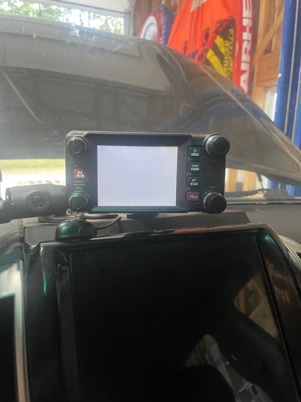

I now just noticed that my Yaesu’s screen, though off was still slightly backlit.
Maybe it’s always done this and I’ve just never noticed but that seems weird. I generally do not leave the control unit plugged in and mounted except for off road trips but I have had it plugged in for roughly the last month or so. The Yaesu is powered directly to the starter battery so I can use the radio w/o the truck running. That's never been an issue before, even when I've left the radio on over night. I think my lead acid starting battery is on its way out unrelated to the Yaesu but still the backlit controller screen seems odd and it also seems weird that I've never noticed that before. I think I only noticed it now though because it is overcast and raining here today. In the sun I don't think you'd see it. Anyone with a Yaesu FT400 noticed this same partially backlit screen?

In the "off" state my 400 pulls nothing.
I've never seen the screen backlit like that either

I have the same radio, directly wired to my battery. I do not have this issue. I think something is up with your radio.

Yes something funky is going on. I pulled the dead battery and replace it. Fired up the Yaesu and then turned it off and no backlit screen. I don’t understand how the bad battery would cause this on the Yaesu. Probably just totally disconnecting it from power and turning it on again reset something, like rebooting a computer. I’ll just have to keep an eye on it.

I think you're aware but to confirm I have the identical radio and that Yaesu behavior is not normal... when you turn it off by holding the power for a few seconds, it should go completely off. Mine is wired always-on, so I have to remember to turn it off. (I tried the APO function but was annoyed that on a long trip it would shut off because I wasn't actively using it, even though I wanted it to push GPS location via APRS in the background)

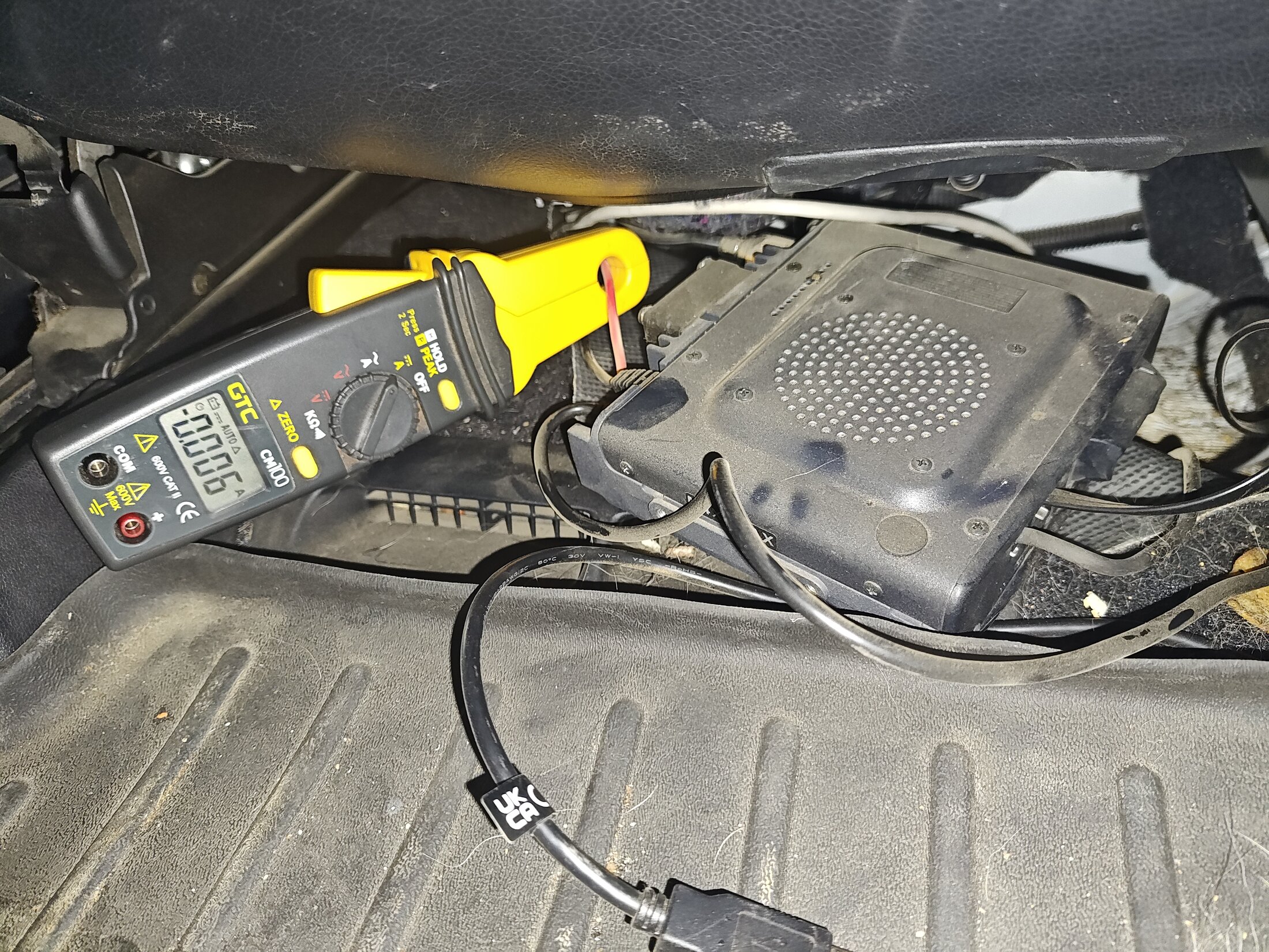

How do you like the GTC amp meter? Seems a little expensive but appears to be a quality unit. The super cheap ones don't read DC mA.

Same. NOT normal. My 400 draws nothing when powered off via it’s screen/button array.
