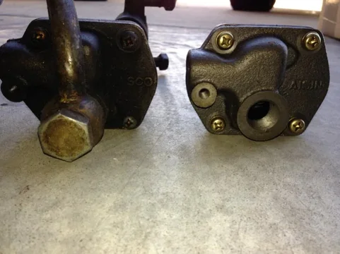

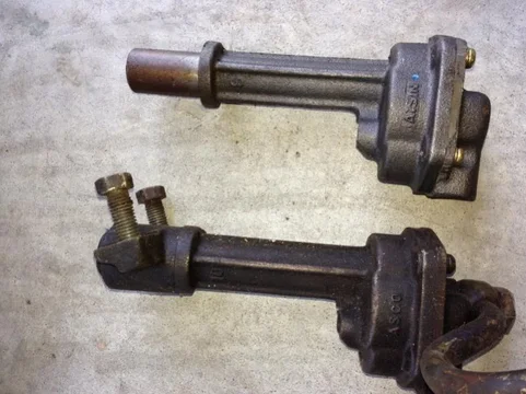

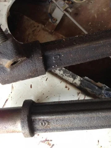

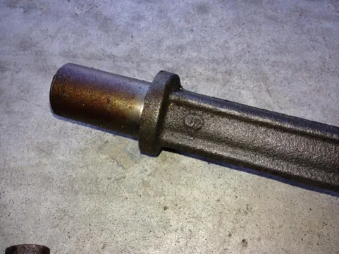

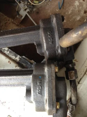

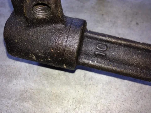

If you can verify that it should have a 9 cast on the neck, I have what the PO of the parts Pig claimed was a new pump.
The Aisan is, supposedly, new and has a 9 cast.
Haha.

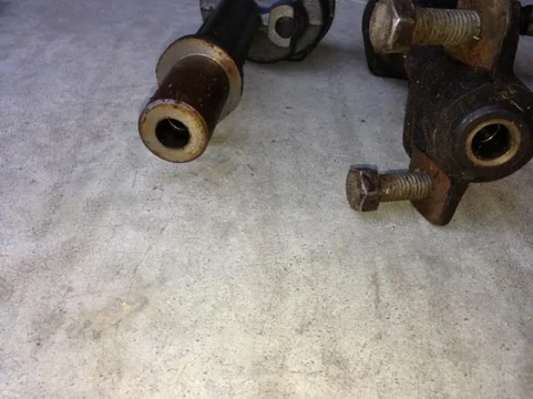

I will look at my cast # today. A problem with my old is that the pickup tube fits very loosely into the pump. That has to mean that oil flow is lost and returning to the pan. There were also Nicks in the tube where it has hit the crank. I would not feel good about reusing it.

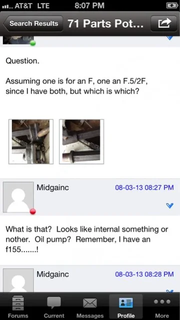

I'll find what I've got and depict, then can send your way immediately after confirming which you need.
What looks new very well may be, but I didn't pull it out of the box. Should be easy enough to determine usefulness and at the price point I have in mind, worth checking into.
