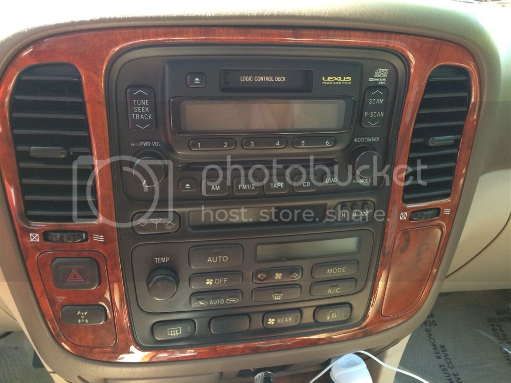

It's like sitting still in a parking lot, it's realllllllly hard to turn the wheel. But if you roll forward super slowly, it starts turning more easily. Still sound like CDL? I've never owned anything with any locking differentials...
Put both the tranny and transfer case into neutral.... Press the CDL button... Put the transfer case into high "h" and throw it in Drive... Does the light go on? Does it act any differently?
So I did as GKCArmory suggested: The light did NOT come on on the dash. I could hear it clicking in the passenger floor area, but no light on the dash.
I can't remember now if the CDL button was in the "in" or "out" position on my way home, but now with it in the "out" position, my steering feels better from a stop. My guess is that I drove the whole way home with the center diff locked. I hope I didn't damage anything.
Need to get that light fixed....My assumption is that when the button is pushed in, CDL is engaged, when it's left out, it's open.

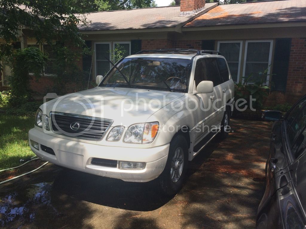

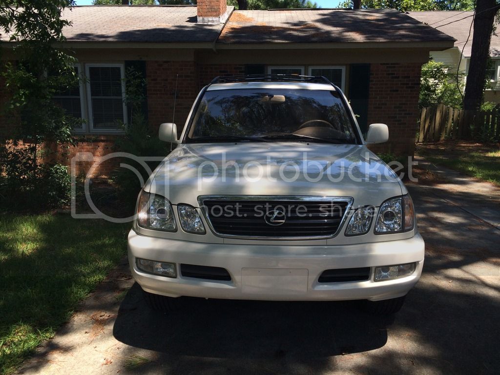

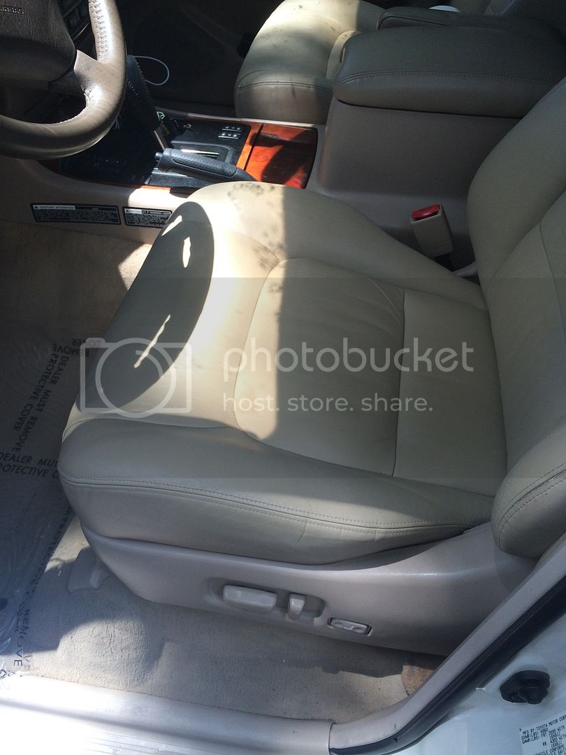

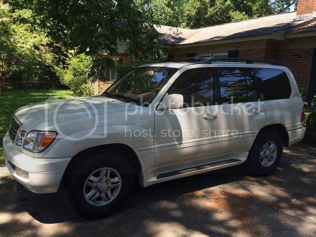

Washed it yesterday:
And tried to get some pics on my sweet iphone to give y'all an idea as to how ridiculously clean this thing is. I feel bad because I can clearly tell this thing has been garage kept it's entire life in West Texas, and I don't have a garage for it now :/ The leather of the seats is IMMACULATE, as is the wood grain trim. I've seen some others that don't look so good.
(last picture the bumper looks like it's sitting crooked, but I can assure you it's just the angle of the lighting!)
for 17-18ish years old......this thing i a BEAUTY :) and I am very happy with the purchase. I just need to figure out a few things here and there, but overall I'm happy to finally be a part of this community
