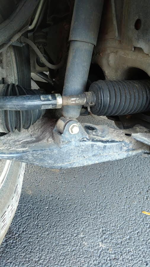

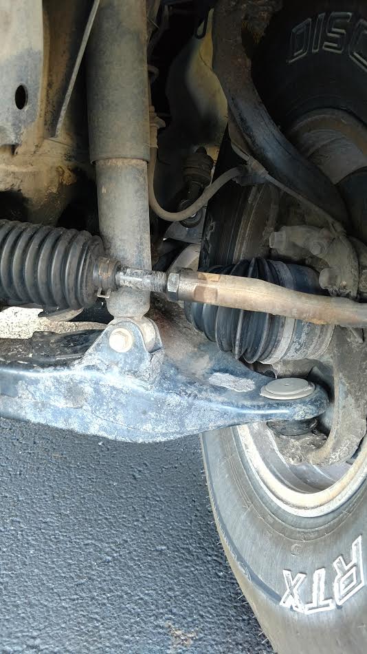

or lower shock mount
It visibly looks fine, how would I determine if it were bad?
busted shock absorber.
In cars I've had in the past, a bad shock is usually evident because it bounces a few times after a bump, like it's only on the spring with no shock. I haven't noticed this, but I've also never had a vehicle with torsion bar suspension. I also don't notice any oil leaking from the shock (another thing I noticed in my older cars). How can I determine if it's the shock?
pics of shock mounts (grey stuff is dirt/dried mud, no rust):

My 100 also had a clank sound that ended when I replaced the shocks. Upon inspection, I noticed the lower shock body would twist when the suspension cycled. A worn out lower bushing gave the shock enough movement the ear would twist and make contact with the lower mounting tabs, thus the noise. OEM replacement shocks are dirt cheap and just a few dollars more than a bushing kit.
Thanks. Though I can't be sure they're bad, the shocks are most definitely not new. Are there recommended brands? Or is the cheap stuff fine? I see some Pro Comps on amazon for $35-$45 each.
edit: Local O'Reilly has Monroes for $39.99, and KYBs for $99.99 each. Dealership has them for $62.96 each.
I went with OEM Toyota. At 249k miles the shocks still had a charge but the bushings were shot. They were about $30 a shock. The Toyota shocks were cheaper than I could buy aftermarket from the parts store and they are quality. I have no experience with other shocks for the 100, but I know there are a few threads on the discussion.
