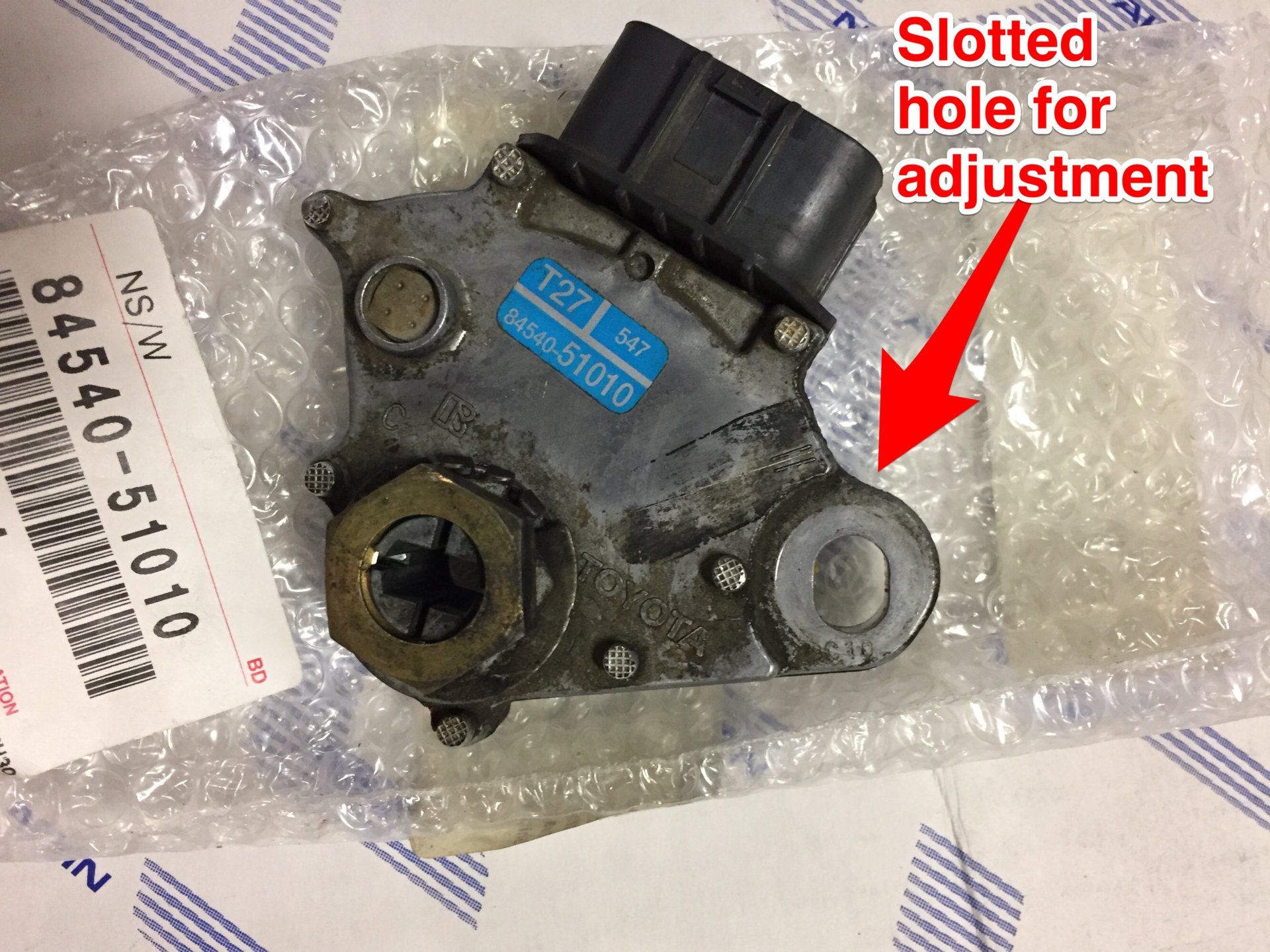

It looks like the Toyota name for the part is a Park/Neutral Position Switch and it is on the side of the transmission. I'll take a look at it
That switch is accessible from under the truck on the passenger side of the transmission. It is adjustable, but it would be hard to imagine it going out of adjustment slowly, by itself. Worth taking a look at.
In the pic below you can see the white line which is supposed to be set parallel to the tab that comes from the transmission into the switch. If that's out of whack, or the switch is bad, strange behavior will result.
You are right. It is also a pain in the butt to replace. Given the age it may actually break off on the transmission when you are removing it and then you are in a world of hurt. Take it to the dealer or find someone who has done it before.

It is not that hard to replace the neutral safety switch.
I would first check to see if it out of adjustment.
It took a few tries to get it adjusted after I replace the one on my 2001 LC to get it to start in park again.

I have had similar symptoms, but I'm not sure if it is the starter contacts / solenoid, or the neutral safety switch as described above.
Several months ago, I turned the key and the starter did not engage. Lights came on, but when I turned to engage the starter, nothing happened (no click or anything). After a few attempts, it started right up. This happened a few times, and then went away for several months.
Symptom re-appeared 2 weeks ago, occurring every 2 or 3 days. Then finally, it wouldn't start at all no matte how many attempts. I shifted to neutral and it started right up. I drove it home, put it in park and turned the key off. Then I tried to start again, and nothing. Then I tried again, and pulled a little on the gear shifter, and the starter engaged and it started right up.
I assumed it was the neutral safety switch as described above; either out of adjustment or maybe it has gone bad. HOWEVER, the symptoms are gone, and its starting great now!!!!
I can't decide if I need to replace the starter, or the neutral safety switch without more information. I don't want to wait until I'm stranded and can't get it started?
Any suggestions.

Bringing up an older thread. Anyone else that was having an issue with not starting find the solution? I have replaced the starter solenoid and starter. Symptom is still there. Insert key, turn and dash lights up but no clicking or starting. I can jiggle the shifter and it will start right up. Trying to avoid throwing more money at it if someone found the solution. Otherwise, neutral safety switch above would be next on the list of things to "try"...
Oct 11, 2011
95
@Mxndrnks , does it start when in neutral, if so I would assume neutral safety switch? The fact that your starts when you jiggle the shifter makes me think neutral safety switch
Regardless, my issue WAS the neutral safety switch. I purchased one on aliexpress (either it is genuine or a fake/clone), and had a local shop install it (I think it is fairly easy, but there was something about moving a trans line and was just too lazy), and everything has been fine since.

Nope! No problems whatsoever. I'm sure the switch was my problem. Adjusting it seems like good advice, but it really doesn't look like there is much room for adjustment... I did a quick search and looks like you can now get a genuine switch online from parts dealers from around $120 (mine was from aliexpress and about $50. Let me know if you put it in yourself, I'd like to know how hard/easy it is... I think I paid for one hour of labor to install to a local indy shop (less than $100)...
